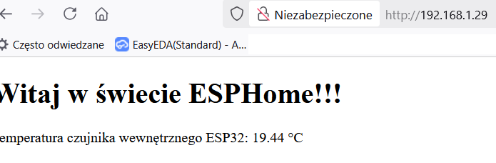

    Let me start by answering myself. Successfully replaced the default page via js_include and reading the internal esp32 temperature.
    Browser screenshot showing “Witaj w świecie ESPHome!!!” and ESP32 internal sensor temperature: 19.44 °C
