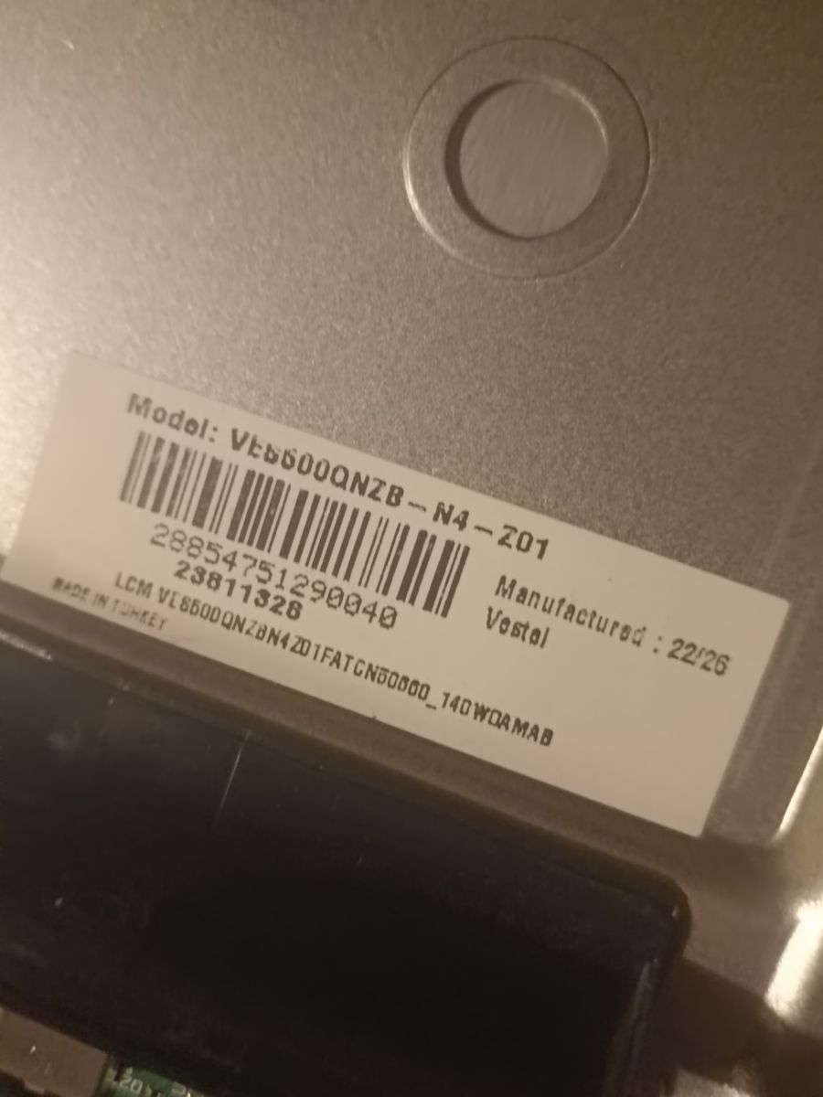

    NOKIA UNA50GV210I
    product code 10136128? right?
    panel code should be VES500, not VES600: it's a 50 inch, not a 60 inch

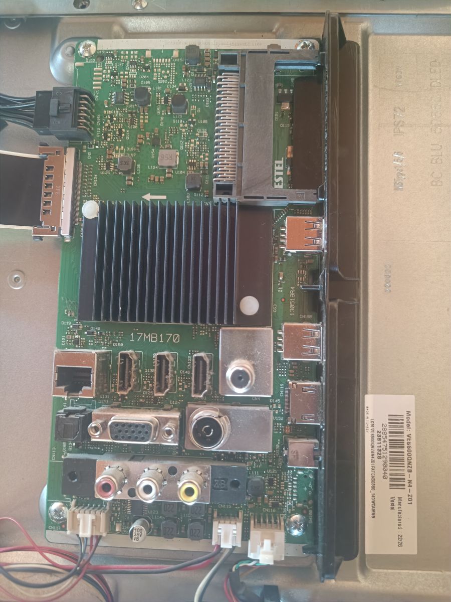

  • #3 21886121
    ModularBase
    >>21886108
    I can't find that specific product code on the television, I'll attach a picture of the motherboard (and the sticker with the panel code).
    The panel code could be VES500, the 5/6, it's not that clear on the sticker.
    Please let me know if you need some other codes/images
