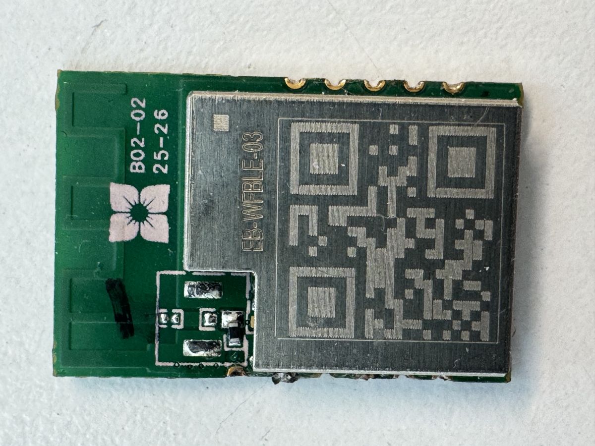

    And what kind of Wi-Fi module is sitting there from the factory? Maybe there is an SDK for it? The name EB-WFBLE-03 says little, do you have any pictures?

    >>21878332
    Green PCB module with RF shield marked IB‑WIFIBLE‑03 and a large QR-code-like pattern

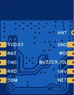

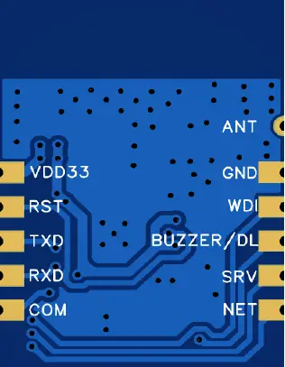

    And it's probably pre-programmed to transmit to their cloud curve, as of the pins it only has vdd, gnd, rx, tx (rs232 to the inverter) and antenna. I don't think it can be easily re-flashed.
    Close-up of PCB area with labeled pins: VDD33, RST, TXD, RXD, COM, ANT, GND, BUZZER/DL, SRV, NET

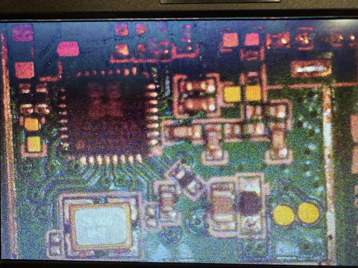

    Do you have the ability to take a picture of the screen to look there? Even if there is no SDK, maybe there is a flash bone to solder? Or is it something , which is already supported by our electrode project?

    I've soldered it out to be thrown away anyway, so when I find a moment I'll unsolder that screen, then I'll post what's inside.

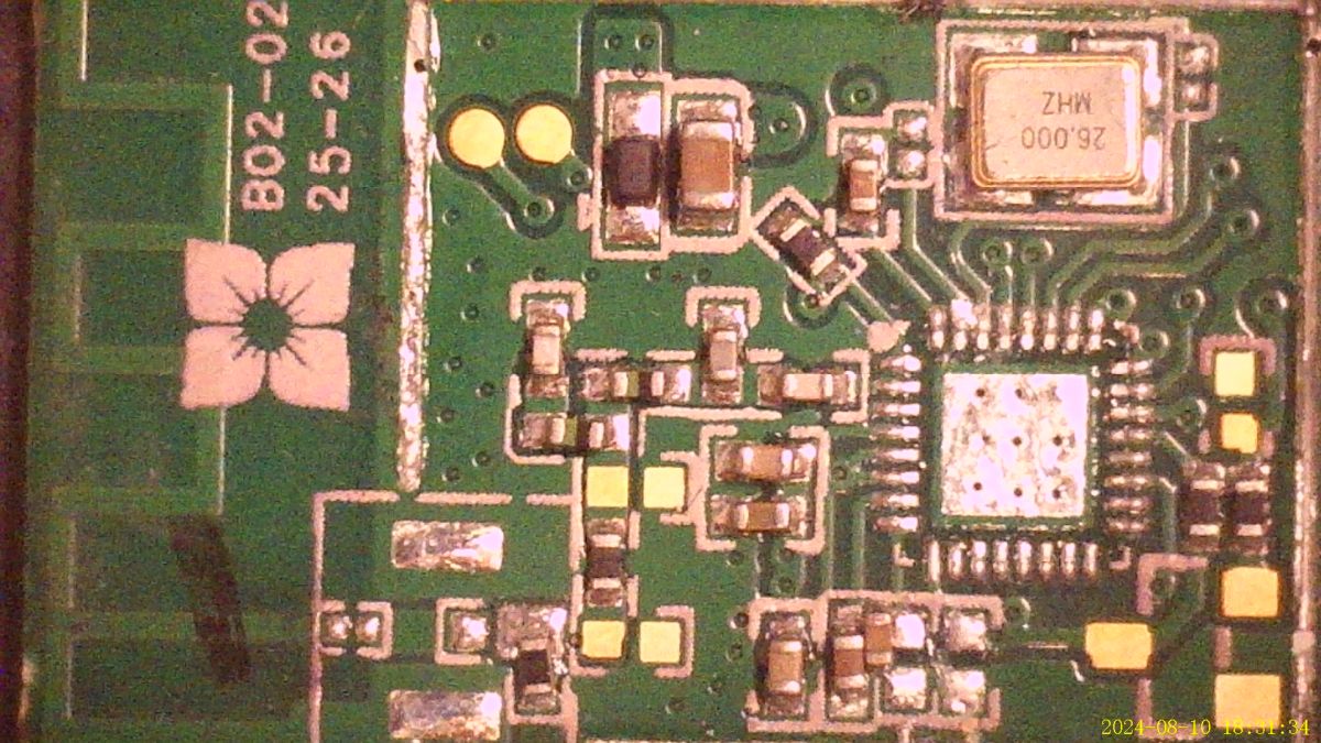

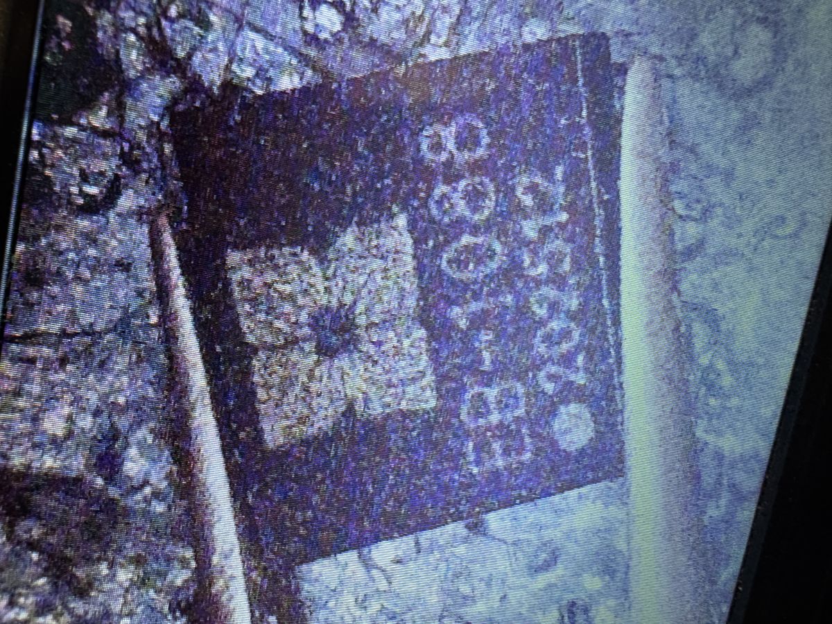

    Macro view of electronics on a green PCB with an integrated circuit and SMD components Close-up of a purple label with a code-like white print on a rough surface
  • #8 21878369
    Posts: 14770
    Rate: 12913
    Very interesting, at first glance this layout does not even exist on Google. EB-1088
  • EYBOND module identified as likely OEM Beken chip
    #9 21878370
    psalkiewicz
    Posts: 8
    >>21878366 Sorry for the ugly pics, but I took a picture of a Chinese microscope with my phone. Inside is a 26 MHz quartz and some unknown processor. But it looks like some total crap - now I understand why it took ages to read the data from the inverter.
    Added after 4 [minutes]:
    That EB could mean EYBOND, the manufacturer of that whole Wi-Fi module. They could have printed their marks on some curvy chip. And below it looks like the date 2025-12, so it's possible this was made for a specific product a while back. That's how Anenji released the inverter at the end of the year, which had this crap instead of a derived RS-232.
    Added after 8 [minutes]:
    >>21878370 The logo matches the EYBOND logo. And the chip is probably OEM. Some kind of Beken 7231 or something like that, looking at the eye by the features, the number of pins and judging that it's rather nothing particularly new.

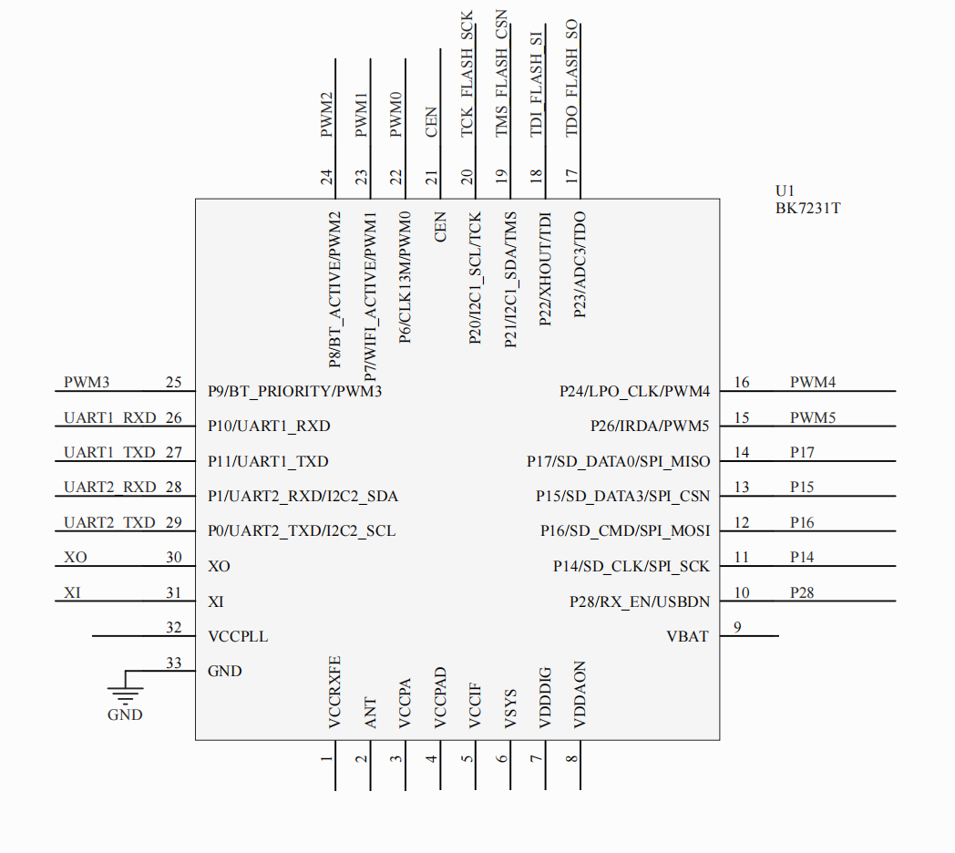

    And does the 'fingerprint' match? Beken has an oscillator on pins 30 and 31 (XO and XI):
    Pinout diagram of BK7231T showing XO and XI pins labeled 30 and 31

    >>21878380
    Close-up of a PCB with a QFN IC, 26.000 MHz crystal can, and surrounding SMD components
    As far as I can see, 31,32 go to the quartz.

    oh. you've unsoldered main IC :(
    did you capture boot log or anything from uarts?

    But is 33 GND? It goes to the capacitor, which is more likely to have ground on the other side, so isn't that it?
