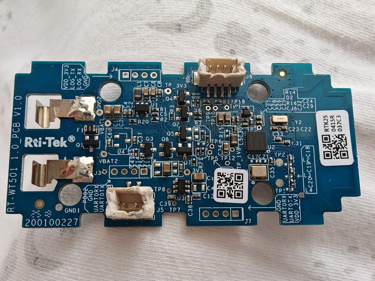

How can I troubleshoot an XR806-based RT-WT501 that flashes OpenXR806 but does not start an AP or output any serial logs?
Your RT-WT501 likely needs the INT DCDC OpenXR806 build instead of the current INT LDO build, because some XR806 boards use an internal DCDC power setup that the existing image does not handle [#21886202][#21886226] A DCDC build was later provided as an untested variant, and a matching XR806DCDC branch was created after confirming both power modes boot on WXU [#21886509][#21886514] Also check both UARTs: the original firmware may print boot logs on LOG_TX, while OpenXR806 output is on UART0TX [#21886509] Before reflashing further, make a firmware and KV backup so you can restore the device if needed [#21885180]
  • Need further troubleshooting for XR806 flashing and boot logs
    #1 21885119
    mkrum001
    Posts: 38
    I know it's for a different board, but if you don't mind I'll ask here. its a RT-WT501. I have access to the board and it has XR806af2e. I was able to flash it with
    OpenXR806_1.18.287.img
    but it does not start any AP or I can't get any logs with
    minicom
    under ubintu. Can you advice how to troubleshoot further?

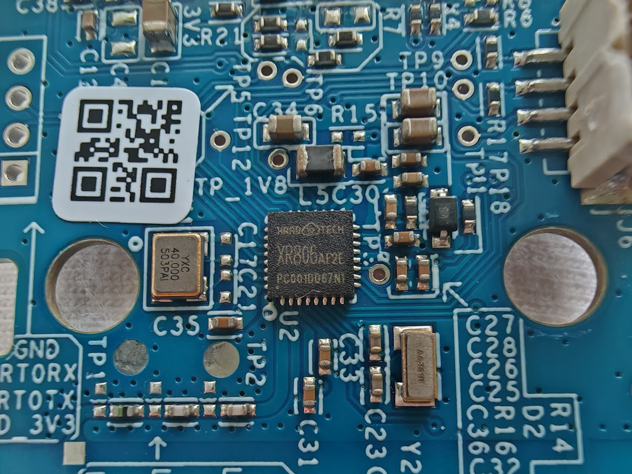

  • DCDC and xtal variants may explain XR806 failures
    #5 21885157
    Posts: 5182
    Help: 445
    Rate: 912
    we've seen it in a couple of XR806s. @jmkrzyszt was playing with a build. The factory boot log gives away the DCDC/LDO type
    https://www.elektroda.com/rtvforum/topic4115856.html#21746224

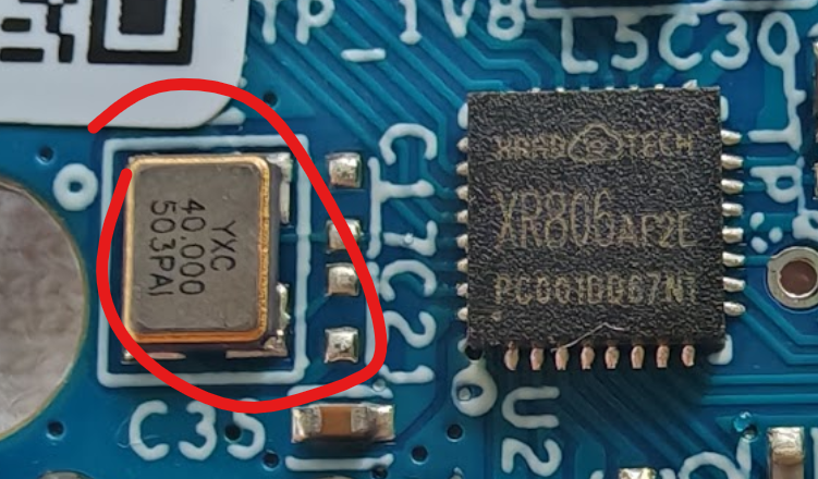

    or maybe it's an xtal variant: https://www.elektroda.com/rtvforum/topic4115856.html#21779853 - as highlighted by @insmod
    We have a couple of DCDC dumps that I haven't been able to test. The Avatto smart watering device was DCDC and its image (the OTA file from Tuya which includes bootloader) is what killed my 1st XR806 5v dev board,
    https://www.elektroda.com/rtvforum/topic4064188.html
    https://github.com/openshwprojects/OpenBK7231T_App/pull/1893
    Added after 3 [minutes]:
    :) maybe not

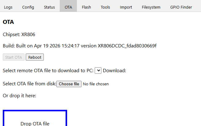

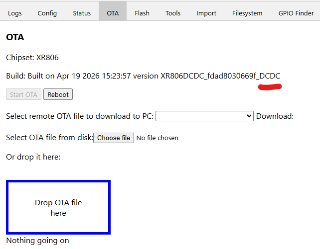

    I made a variant for DCDC too. both boot on WXU.
    https://github.com/divadiow/OpenBK7231T_App/tree/XR806DCDC
    Tuya XR806 RT-WT501 flashed with OpenXR806 via phoenixMC, no AP or logs?
    Added after 7 [minutes]:
    boot log power bits on WXU for me
    INT LDO
    INT DCDC

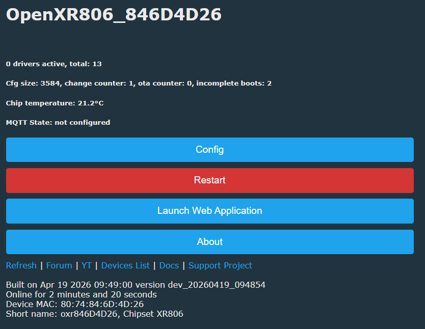

  • OpenXR806 boots and registers MQTT callbacks
    #24 21886712
    Posts: 5182
    Help: 445
    Rate: 912
    insmod wrote:
    DCDC build (not tested)

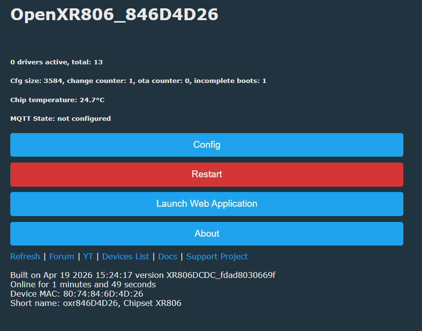

    this build running on WXU

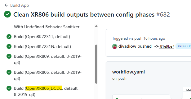

    Added after 46 [minutes]:
    @p.kaczmarek2 hope this is OK
    https://github.com/openshwprojects/OpenXR806/pull/5
    https://github.com/openshwprojects/OpenBK7231T_App/pull/2093

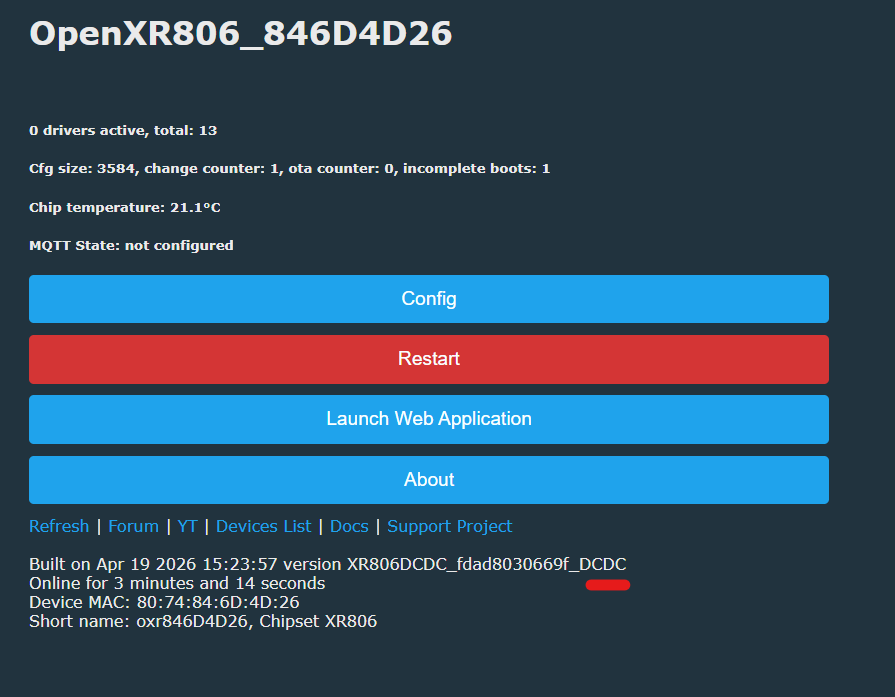

    Added after 11 [minutes]:
    oh hang on. it won't be known internally as "OpenXR806_DCDC". I'll fix.
    Added after 1 [hours] 34 [minutes]:
    better I believe
  • #25 21887168
    mkrum001
    Posts: 38
    Sorry, I was away for a while and now just tested the
    OpenXR806_dev_20260419_094854.img
    but still doesn't produce any logs. I tried the LOG_TX and the UARTOTX ports. I see there are new changes on a branch but at the moment I'm not sure how to build image from there.
  • #26 21887188
    Posts: 5182
    Help: 445
    Rate: 912
    and no AP broadcasts? How are you powering the device after flashing?
  • #27 21887205
    mkrum001
    Posts: 38
    Powered from the TTL adapter or over the battery - no AP.
