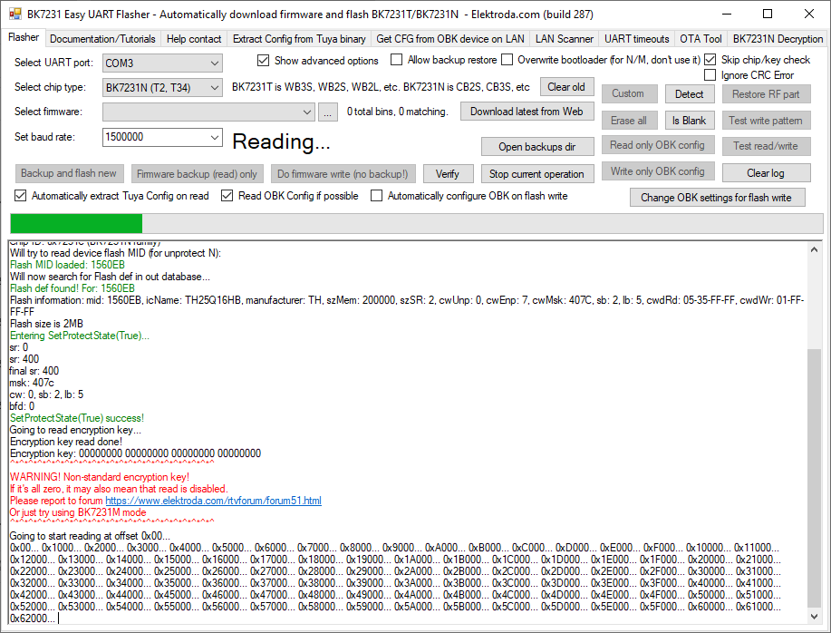

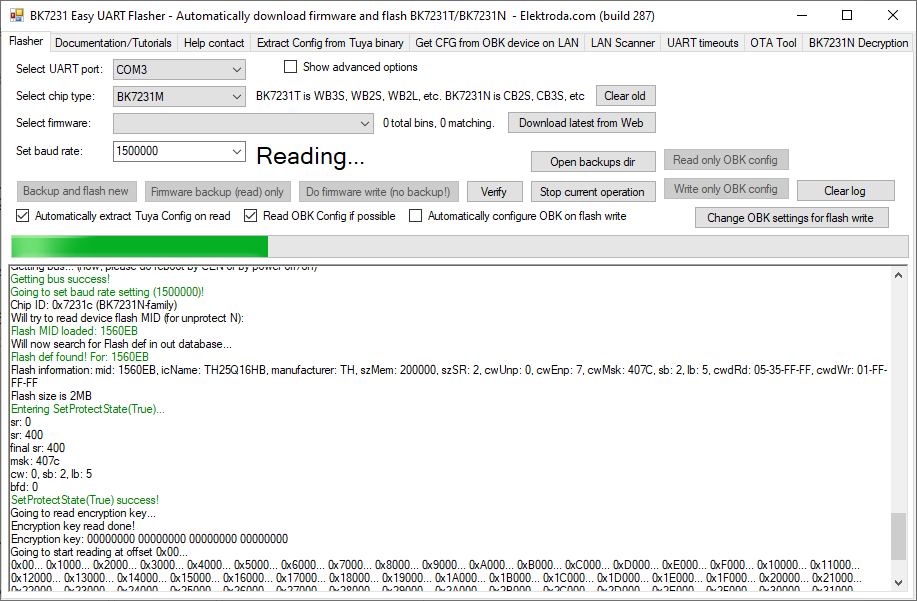

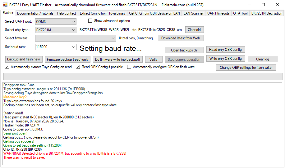

    @DeDaMrAz suggested a more robust chip ID check in EF so in the cases where mislabelled CB2S may actually be a BK7231T and not a BK7231N, Easy Flasher will flag and stop current operation before starting. This suggestion was based on real recent experience.
    So maybe something like https://github.com/openshwprojects/BK7231GUIFlashTool/pull/118/changes?w=1
    -move chipID stuff into new file Flashers\BKChipIdentity.cs
    -chipid dictionary for supported and a couple of OBK-unsupported BK chips

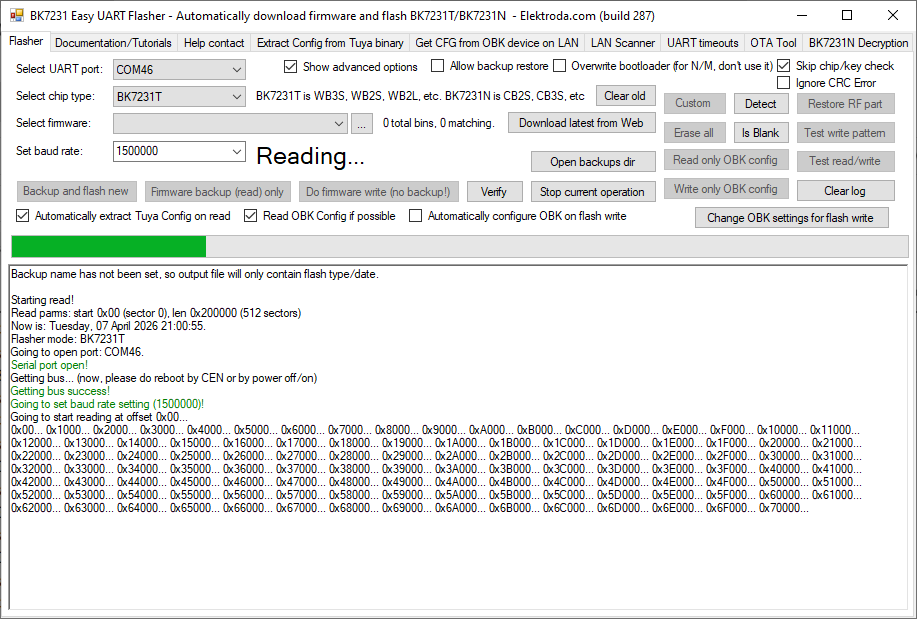

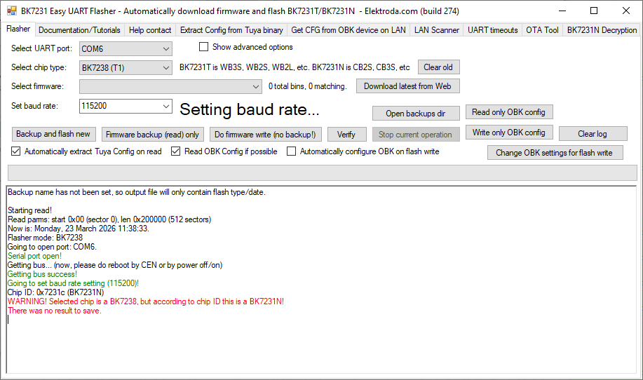

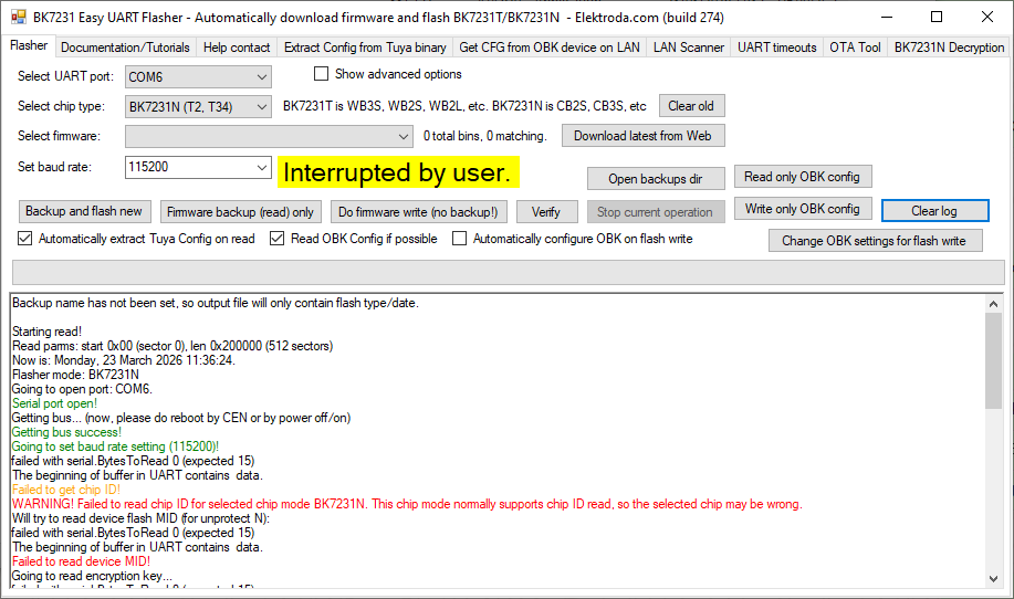

    -if chip should return chip ID but fails to, log warning to suggest wrong chip may be selected. eg, BK7231N selected, BK7231T device:
    Screenshot of BK7231 Easy UART Flasher showing “Interrupted by user” and read error logs.

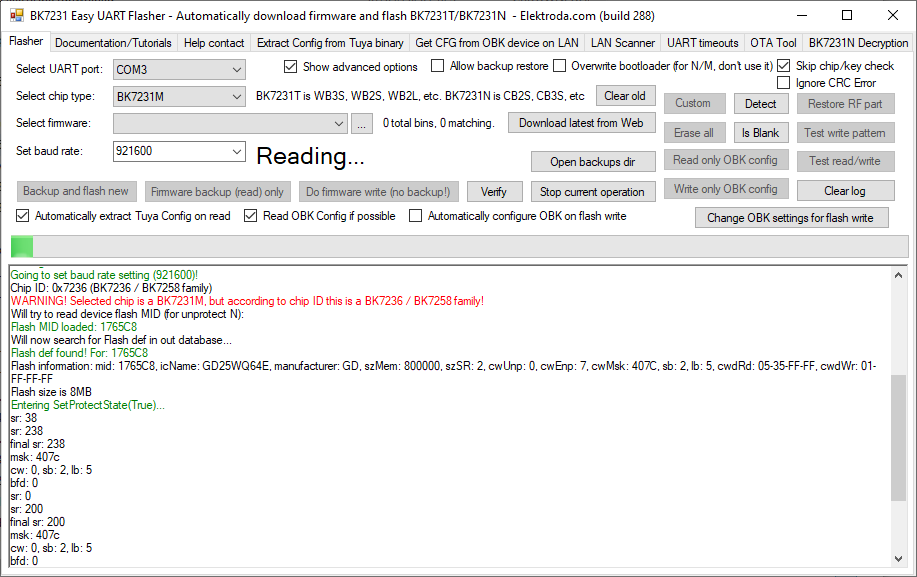

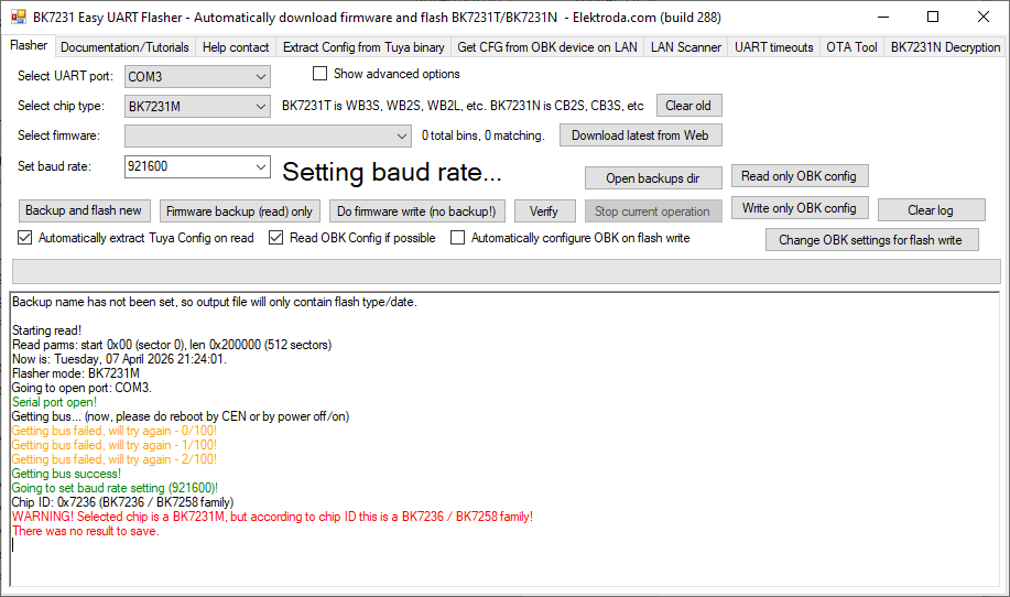

    -if chip returns ID not matched to selected chip, log fail and stop. eg, BK7238 selected but BK7231N device:
    Screenshot of BK7231 Easy UART Flasher showing a warning that the selected chip type is wrong.

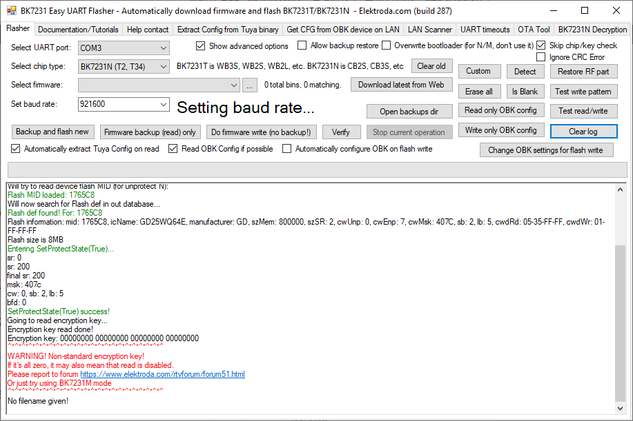

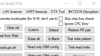

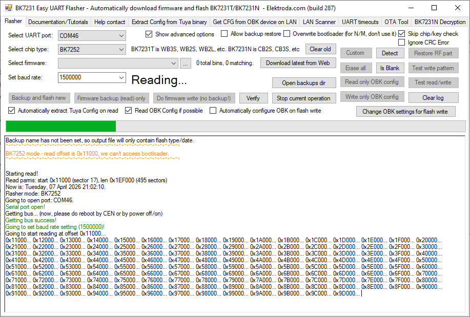

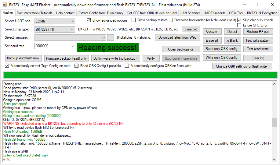

    -expand use of 'skip key check' to 'skip chip/key check'
    Screenshot of a tool window with tabs “LAN Scanner”, “UART timeouts”, and “BK7231N Decryption”.

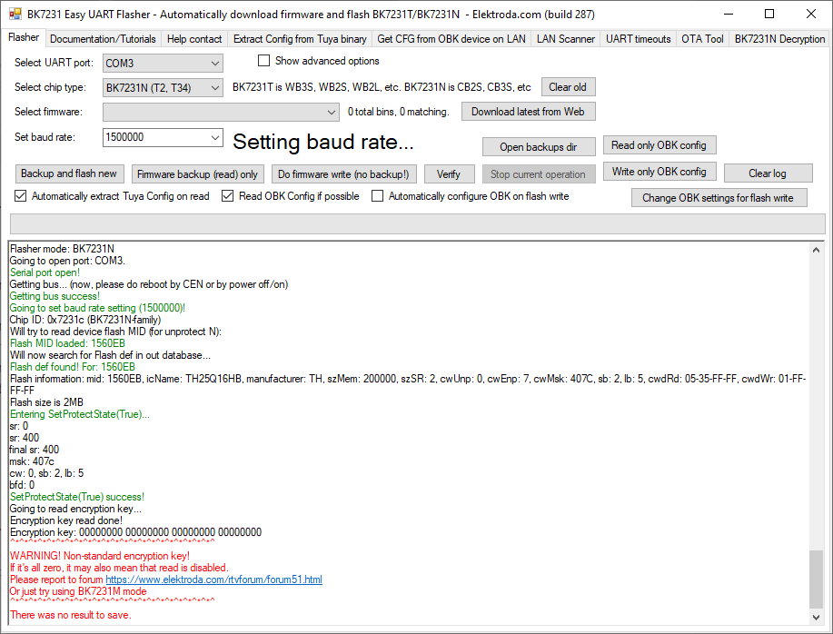

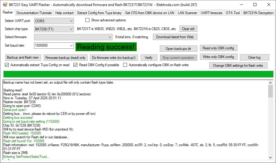

    eg, BK7238 selected, BK7231N device, skip checked:
    Screenshot of BK7231 Easy UART Flasher showing “Reading success!” and COM6 settings

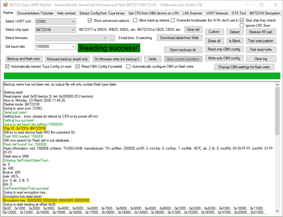

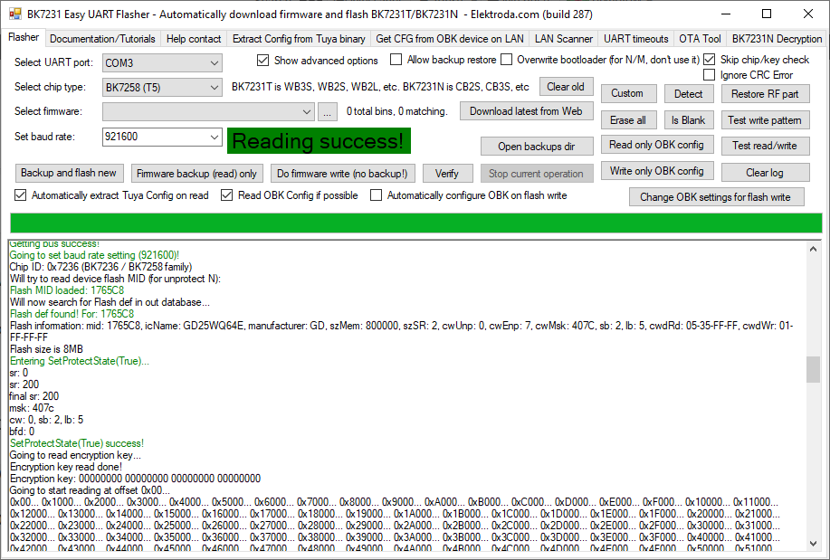

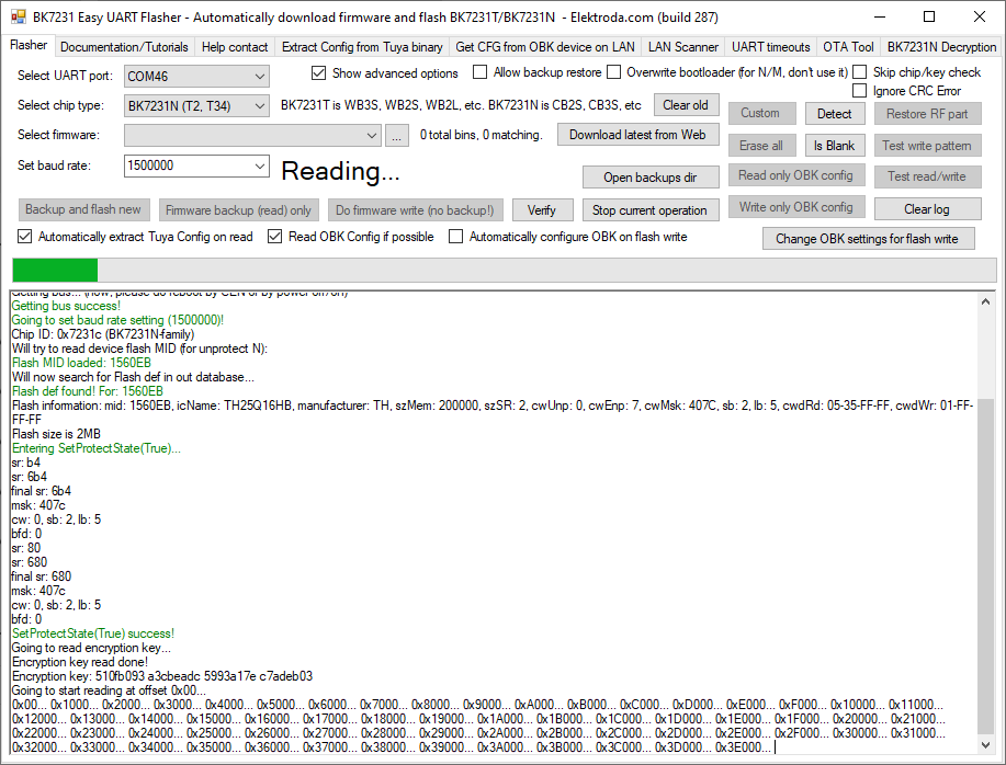

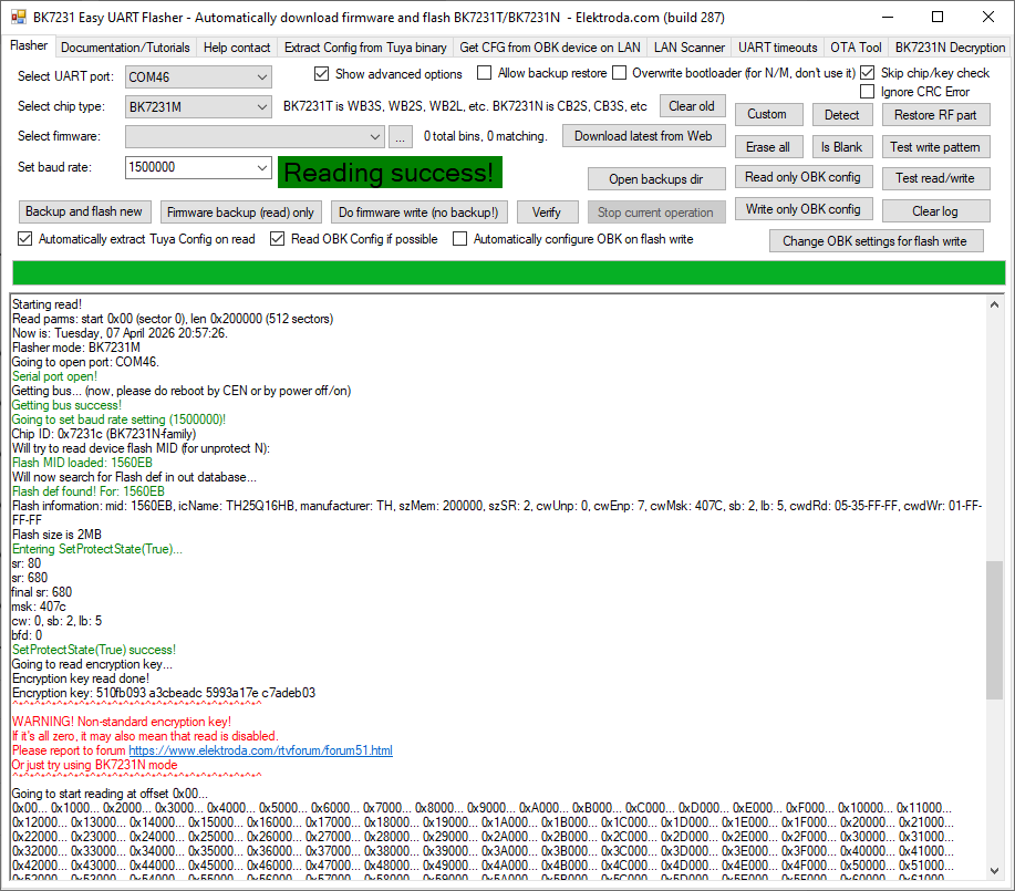

    -BK7231M behaviour remains as no key check enabled by default but does log chip ID:
    Screenshot of BK7231 Easy UART Flasher showing “Reading success!” and a flash read log.
    I do not have BK7258/BK7236.

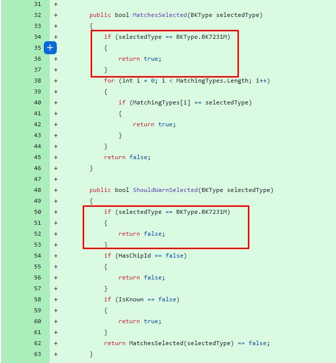

    It looks like you've added override check for BK7231M?
    Screenshot of C# code with MatchesSelected and ShouldWarnSelected methods, with red boxes around if statements
  • #3 21877808
    Posts: 5125
    Help: 442
    Rate: 905
    I'll check it all over. BK7258 behaviour isn't right for checks. Is this even something you'd want added to EF1? I know @DeDaMrAz would like something..
  • #4 21878046
    Posts: 14683
    Help: 656
    Rate: 12711
    Yes I think we can add it if it works reliably and has no drawbacks.
    the thinking was that BK7231M should remain free and easy in case it's ever NOT a BK7231N, but I guess that's not ever going to the case? Also, one BK that doesn't do a ChipID check might be useful if a new variant ID is tried on EF. If the checks were for every chipset it would fail at the first hurdle if the device returned an ID not matched. Would you rather BK7231M had ID check to match BK7231N?
    but that's what the skip key/ID check checkbox can be used for, so .. dunno

    reinstated BK7231M key check to match BK7231N -
    7231c
    BK7231M mode with BK7238 connected

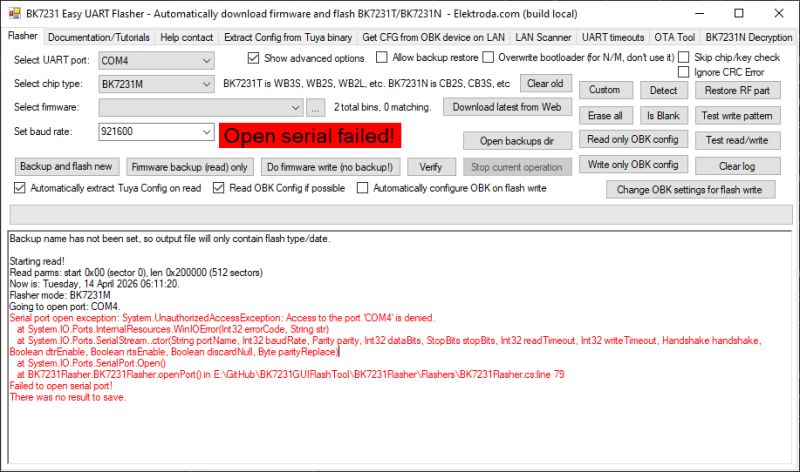

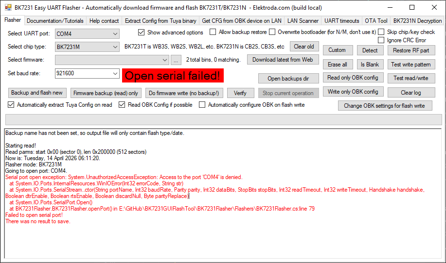

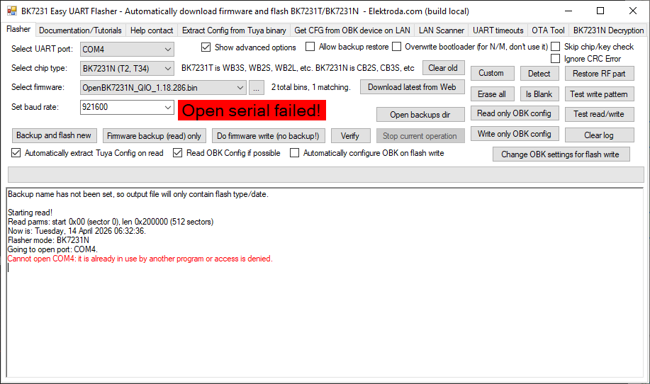

  • Cleaner COM port failure handling in flasher
    #16 21883499
    Posts: 5125
    Help: 442
    Rate: 905
    divadiow wrote:
    current state of play on branch:

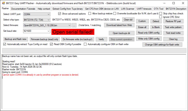

    also, busy COM port open attempt looks messy
    Easy Flasher: BK7231N/T/BK7238 etc chip ID check for Beken devices?
    standardised messages, cleaner UX and removed 'there was no result to save' message if com port failed to open on flash read
    https://github.com/openshwprojects/BK7231GUIF...mmit/c2e7b13244ec1beb8dc3e3f77f96ca1721ede17d

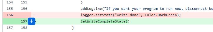

    That's lot of changes.
    Some of the things are very nice:
    But I am not sure how can we review and test it welll.
    maybe in future we should try step by step, adding small changes?
    What do you think, @insmod, any crucial mistakes in this PR?
    Added after 52 [seconds]:

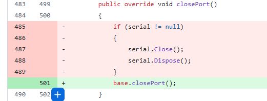

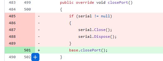

    This is reduntant:
    If you are trying to refactor it, maybe this:
    could be in separate function, that receives exception, and checks is it cancelation...

Selected mode Detected reality Default result Override path
BK7231N BK7231T or BK7231M Warn or fail on ID mismatch Use skip chip/key check
BK7238 BK7231N Fail and stop before flashing Use skip chip/key check
BK7231M BK7231N or BK7258 Now checked like BK7231N Use skip chip/key check
BK7258 BK7258 Detection works, but behavior still needed review Proceed carefully

How can Easy Flasher use chip ID checks to stop you from flashing the wrong Beken chip like a mislabeled CB2S with BK7231T instead of BK7231N?
Easy Flasher can read the chip ID before any write starts and compare it with the mode you selected. If you pick BK7231N but the device identifies as BK7231T, the tool logs the mismatch and stops the current operation early. That directly targets mislabeled modules, including cases where a CB2S label hides a different BK72xx chip. The proposed implementation also moved chip identity handling into a dedicated file so the check stays consistent across supported Beken targets. [#21876721]
Why does Easy Flasher warn or fail when the selected platform chip doesn’t match the detected chip ID on BK7231N, BK7231T, BK7238, or BK7258 devices?
It warns or fails because the selected flasher logic must match the real silicon. In the thread, BK7238 mode connected to a BK7231N device was treated as a fail-and-stop case, while a chip that should return an ID but does not can trigger a warning. That design protects write, erase, and key-handling steps from running against the wrong target. It is a pre-flight compatibility check, not just a cosmetic message. [#21876721]
What is the 'skip chip/key check' option in Easy Flasher, and when should you use it for BK72xx devices?
The “skip chip/key check” is a user override that bypasses pre-flash identity and key validation, allowing advanced testing on mismatched or newly observed BK72xx variants. Use it only when you intentionally want to proceed despite a warning or a failed match.
  1. Select the closest target mode.
  2. Confirm the mismatch or failed ID read.
  3. Enable skip chip/key check only for deliberate testing.
The thread explicitly treats that checkbox as the right escape hatch for unusual cases. [#21879350]

How can Easy Flasher standardize stop, cancel, COM-port cleanup, and final read/write/erase messages across BK, RTL8710B, RTL87X0C, XR, ESP, and other platforms?
It can centralize worker-thread finalization in the GUI and make platform flashers report a shared set of end states. The branch described in the thread standardizes how cleanup finishes, how cancellation is surfaced, and how read, write, and erase results appear after success, failure, or cancel. It also preserves detailed platform-specific log messages, including verification success where supported. That reduces message drift such as “Write success!”, “Write complete!”, “Flash complete!”, “Erase done,” and other inconsistent endings across many flashers. [#21881183]
What causes Easy Flasher to leave the COM port stuck or the stop button unresponsive after RTL-B failures, and how can that be fixed?
The issue comes from inconsistent stop, close-port, and error-handling paths, especially around RTL-B blocking waits and serial cleanup. The thread identifies cases where the COM port was not released after failures and the stop button could become unresponsive. The proposed fix was concrete: make blocking read and wait paths cancellation-aware, harden cancellation, and ensure operations close the port more reliably. Centralized worker cleanup then restores buttons and state after success, failure, or cancel. [#21881183]
How do cleaner busy COM-port error messages and centralized worker cleanup improve the user experience in Easy Flasher?
They make failures readable and recovery predictable. The thread shows that a busy COM-port open attempt looked messy, then reports a cleaner UX after standardizing messages and removing the misleading “there was no result to save” notice when a port failed to open during flash read. Centralized worker cleanup also helps buttons and state recover reliably instead of leaving the app stuck after an exception or cancel. Users get one clear failure cause, then a usable GUI again. [#21883499]
