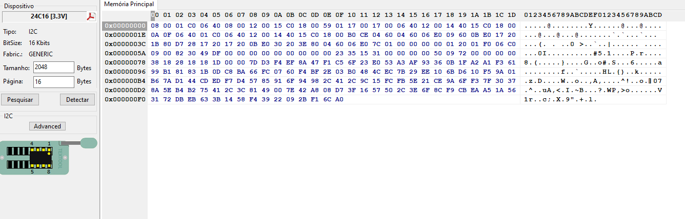

    Can anyone help me? I have a car radio GM Famar DC441 that is blocked with a code. I've tried using a CH341a to read the IC 24C02CB6 and AI to read the dump in order to find the code, but didn't have success.
    Can anyone check the dump I have or have any other idea how I can unlock this device?

    Please post this screenshot.

    andyrs
    >>21893787
    GM Famar DC441 code unlock from 24C02CB6 dump, serial 1305007
    Added after 45 [s]:
    @rutra111 Done

    Please check code 3353.
    I see that you are learning. So I'll give you a hint - in the programmer menu, please select the memory type specific to the memory you are reading - here NOT 24C16 but 2402 or 24C02.
    Additionally, in the editor, there should not be 30 bytes in a line as in your case - that is 00-1D but ONLY 16 - that is 00-0F. For example - the 2402 memory readout is 16 lines of 16 bytes and this is an understandable readout for all.
    One last note - your programmer has a selectable voltage for the memory. While reading is successful even when a lower voltage is selected (here it was 3.3V) it is better to select 5V when writing older memories. To be safe, you can always check the power supply of the memory in the device or its catalogue note.

    According to what you wrote @adam white the file should look like this :
    • phildc441.rar (226 Bytes) You must be logged in to download this attachment.
    E2p file must be converted to bin
    Well unfortunately adamwhite must correct. rutra111 - there is an e2p format file in the archive. There used to be such a popular program called PonyProg and it, among other things, also saved binary files that way (it was probably the default choice and was often saved that way, not knowing that you could do otherwise). It created files in which, in addition to the actual data dump from memory, some description could be added. Such a file was, of course, of a different size and thus had different addresses.
    The typical notation understood and recognised by all is this - your file converted from e2p to bin format.
    • DC441 CODE 0761.zip (231 Bytes) You must be logged in to download this attachment.

    adam white wrote:
    I see that you are learning. So I'll give you a hint - in the programmer menu, please select the memory type specific to the memory you are reading - here, not 24C16 but 2402 or 24C02.
    Yes, I started to learn how to unlock this kind of device in order to install a Bluetooth module on it, but it's the first one that I don't have the code.
    adam white wrote:
    One last note - your programmer has a selectable voltage for the memory. While reading is successful even when a lower voltage is selected (here it was 3.3 V) it is better to select 5 V when writing older memories
    I saw in the software, but I thought it could damage the chip. My reading device has the option to change between 3.3 V or 5 V. So, if the memory chip can handle 5 V, it's better for write?
    By the way, I've used the .bin file with code 0761 and it worked nicely. Thank you very much!
