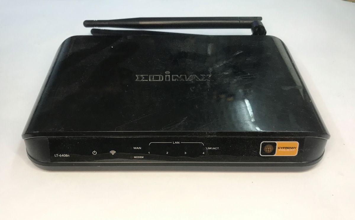

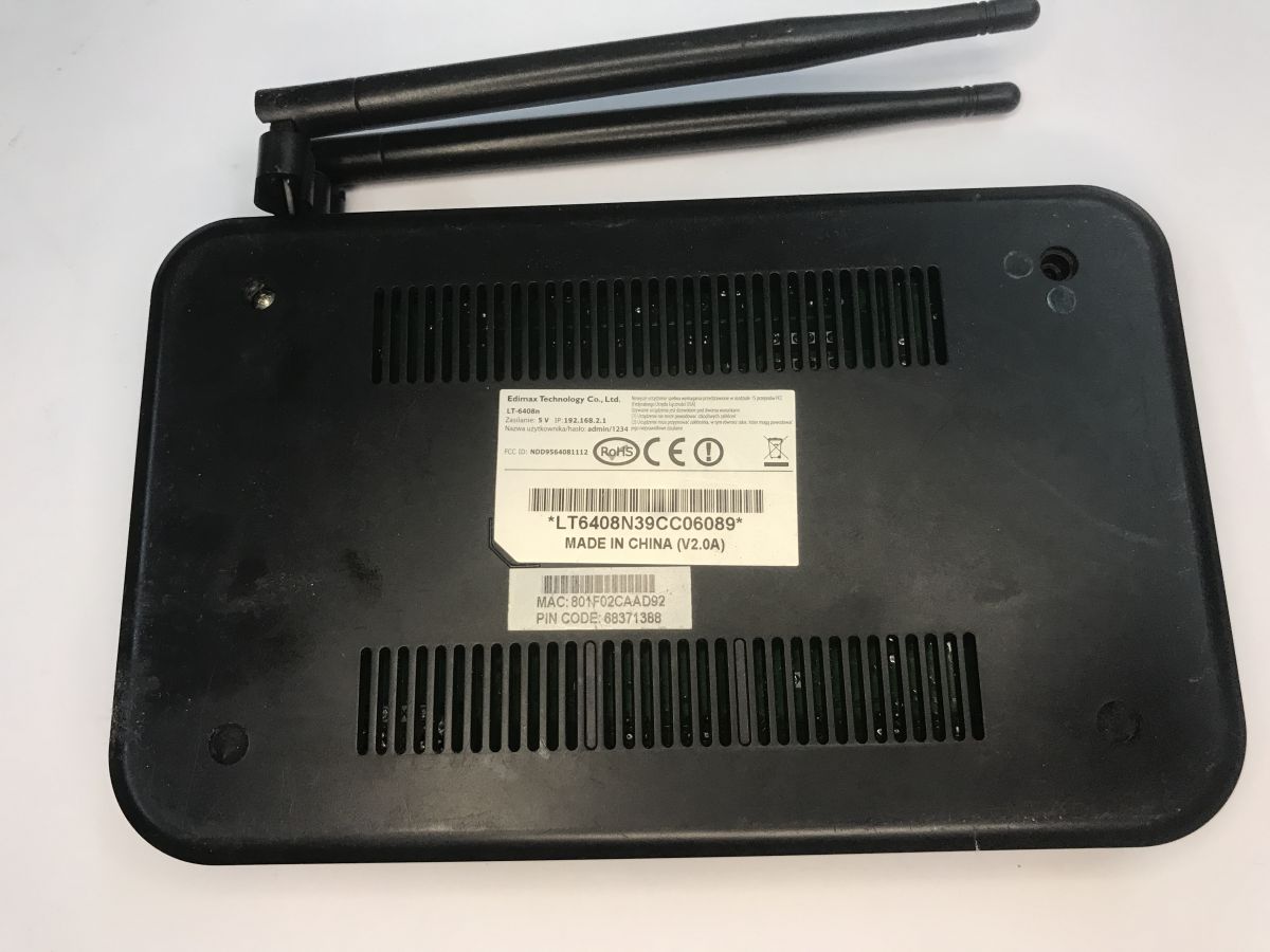

    This time we take a look inside the Cyfrowy Polsat LT-6408n router. This is actually a model manufactured by Edimax and sold to the operator as the Edimax LT-6408n with its branding. The router was primarily developed to share internet from LTE or HSPA+ modems connected via USB.
    Analysis of the inside of the router, memory ripping, bootloader, custom program for UART
    The whole thing works with a 5 V power supply, which is typical of slightly newer hardware already. The bottom sticker shows the default IP, name and administrative password. The FCC ID of the device is NDD9564081112.

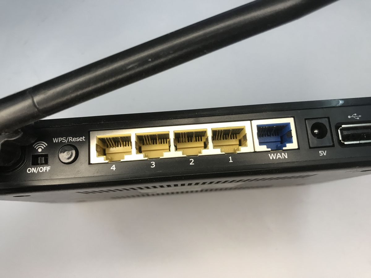

    On the back we have an On/Off button, WPS/Reset, four LAN ports, one WAN port, a power supply input (DC Jack) and a USB port, this is often used to connect the aforementioned LTE/4G modem (Huawei E3372s-153 as an example).

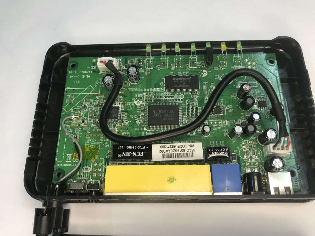

    Interior of the router
    Simply unscrew the screws on the underside. These can be hidden under the feet.
    The first thing that catches the eye is the USB cable routed through the centre of the board. Someone seems to have changed their mind about the location of the port. It was supposed to be on the front, but has been moved to the back.

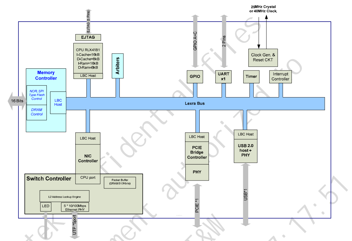

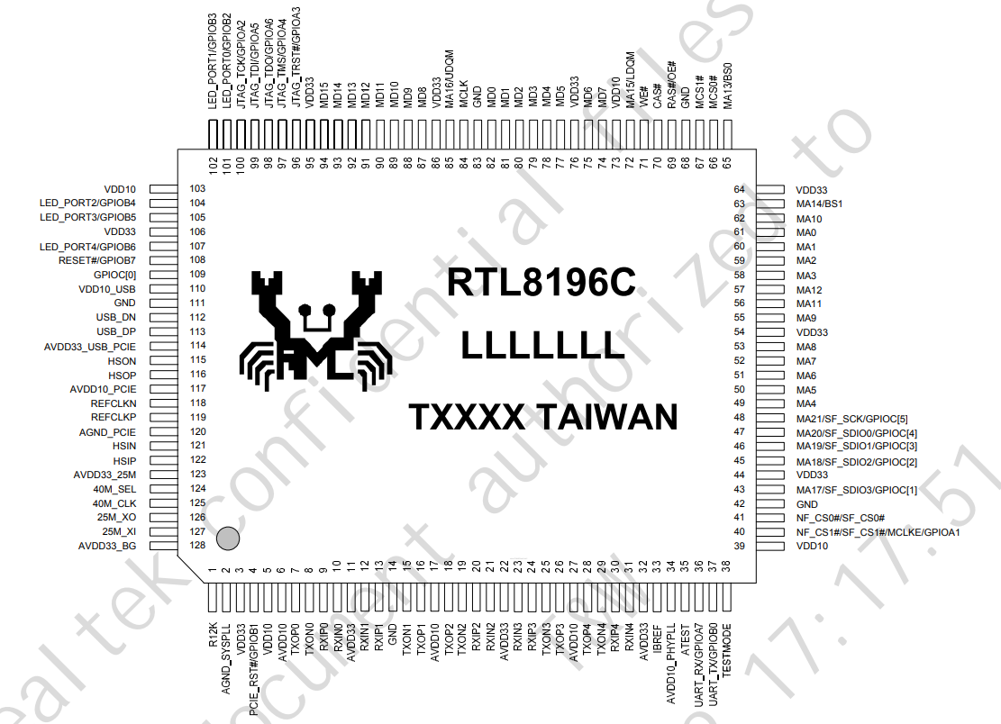

    The router is based on the RTL8196C together with the W9825G6JH memory (4194304 words * 4 banks * 16 bits, or 32 MB).
    The memory connects to the main controller via a 16-bit interface. The whole unit additionally has GPIO, USB 2.0, EJTAG, UART and Switch and PCIE controllers.

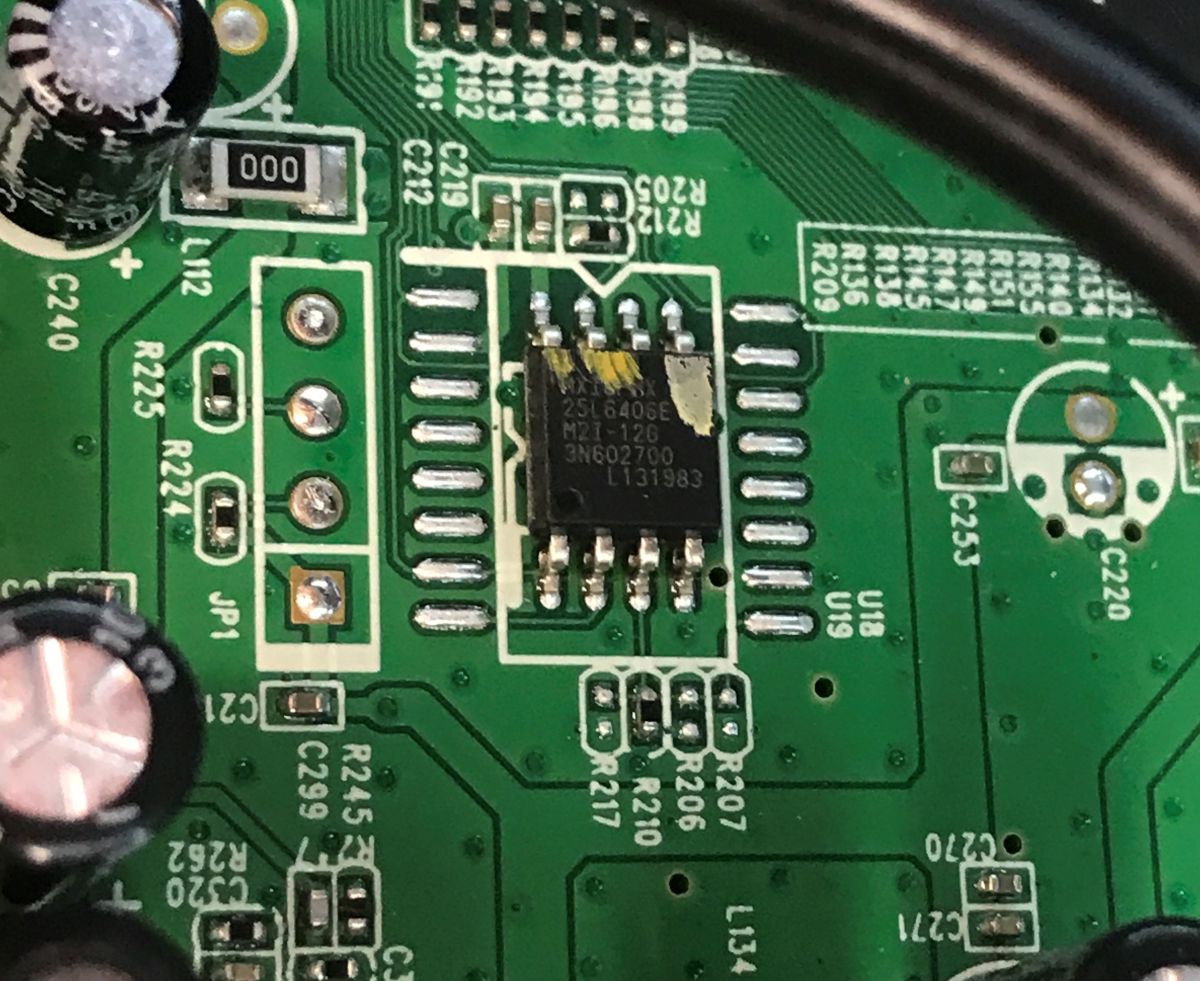

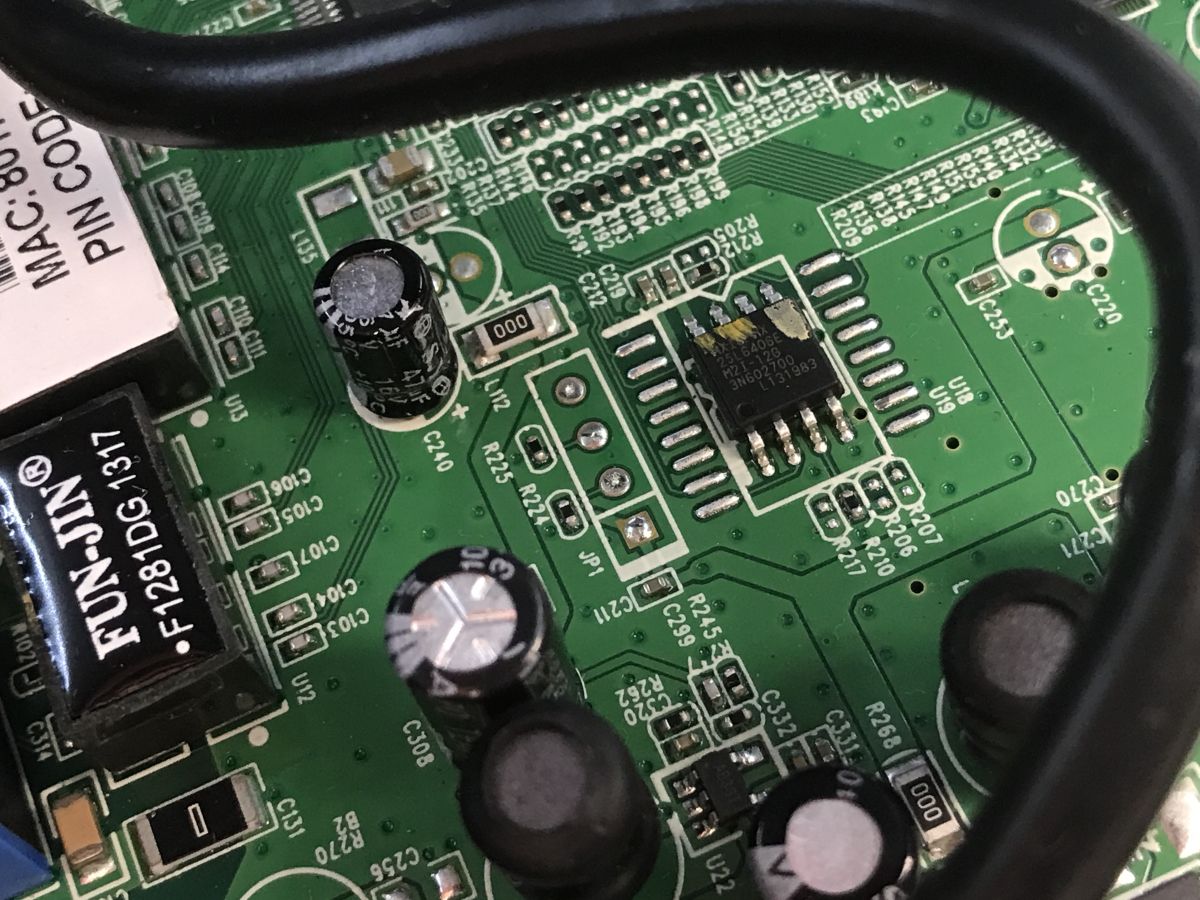

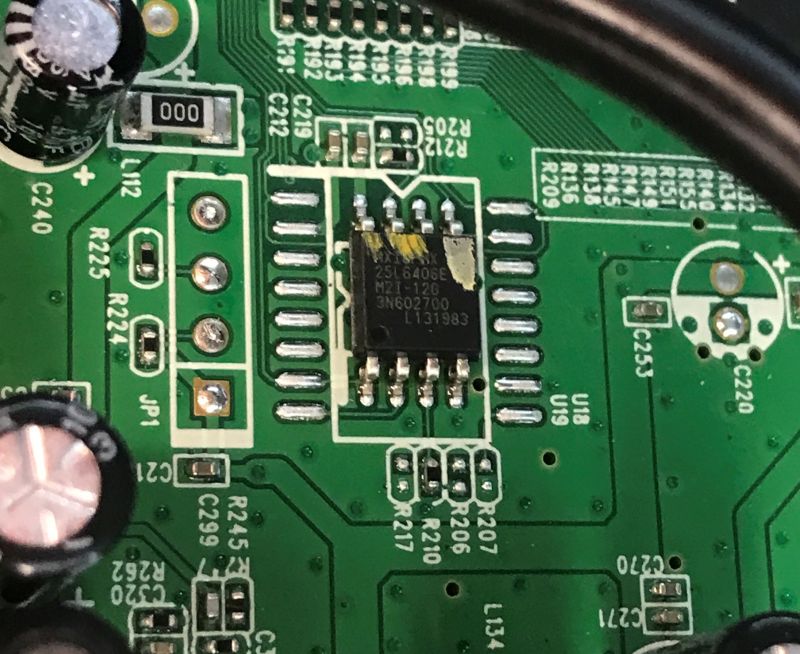

    The actual program is on a separate flash memory, the 25L6406E. The 64 in the name suggests a large size - 64 megabits, or 8 megabytes.
    Next to the memory are four pads, which look like a UART-derived location.

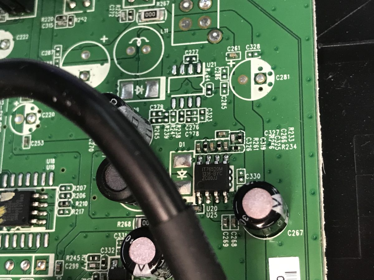

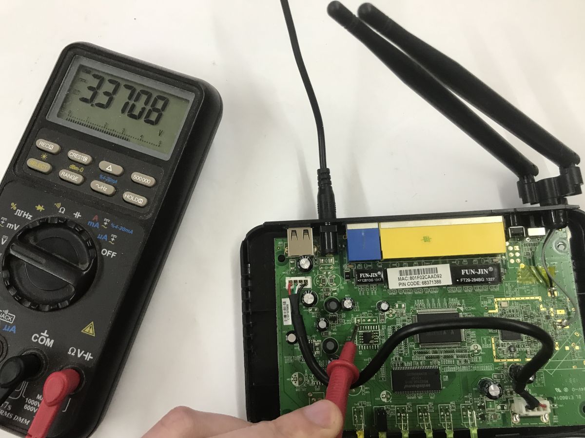

    In the power section, I can see the IT76520M voltage drop inverter. There is also room for a second inverter, but it is not soldered in. One would think that the whole thing runs on a single voltage.
    Measurement confirms that the whole thing is running at 3.3 volts:

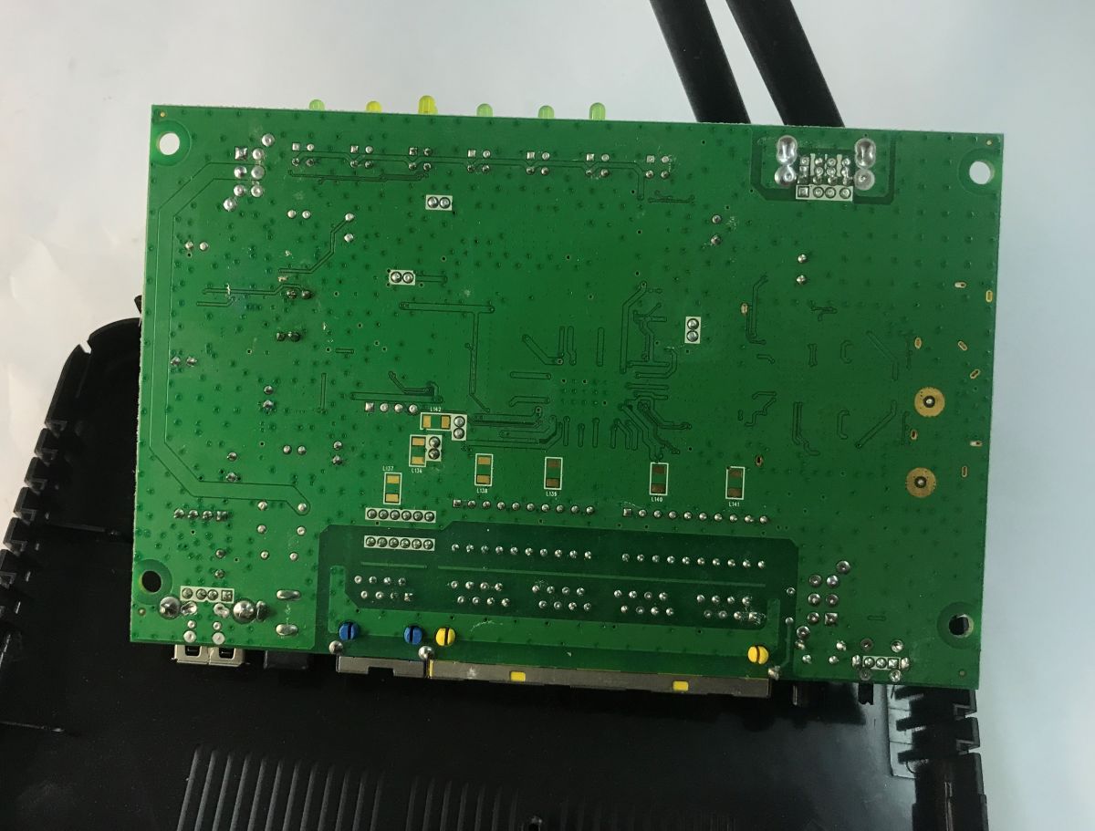

    There are no additional components on the bottom of the board, although you can see that someone planned to put coils there.

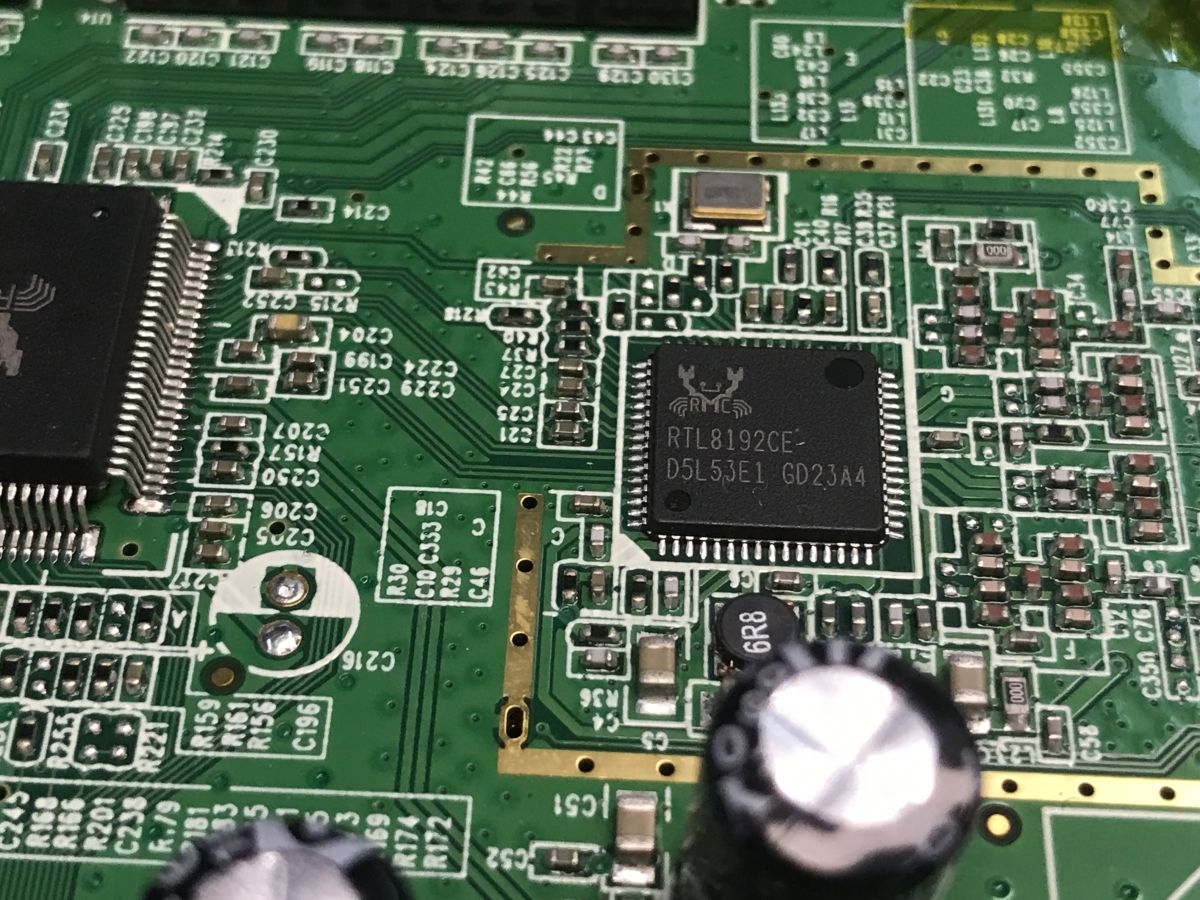

    That leaves the RTL8192CE - a WLAN controller with PCI-Express miniCard, or Wi-Fi. Interestingly, despite a border suggesting a screen, that screen is not there.

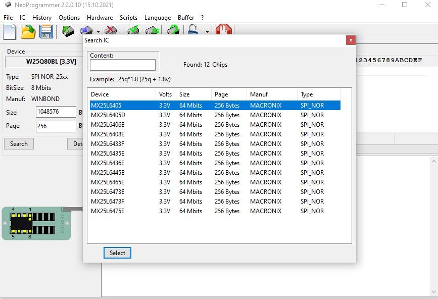

    Reading Flash memory via CH341
    The first thing I always do is a full fair copy of the Flash memory via the CH341 programmer. I don't use a clip, it's not reliable, I think I find it fails more often than it works, so I prefer to solder the chip with flux and hot air instead. Then I still remove the lead-free solder from the pads and re-solder it with lead, then subsequent soldering operations will be easier. For subsequent operations I don't even clean the pads anymore, I just use the binder what is there.
    I used to remove such circuits with a regular soldering iron, but now I have hot air on hand all the time.
    NeoProgrammer recognises the memory:
    The reading is carried out without any problems. To be sure, I still performed the verify operation. I saved a copy on my repository:

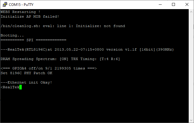

    UART connection - boot log
    You can now connect to the UART and view the router boot log. First you need to find the pins - there are usually four pads next to the main CPU. Most commonly these are: GND, TX, RX and VCC (3.3 V). For communication, I used a USB-UART converter (CH340) set to 3.3 V. There is no need to connect VCC, three wires are enough: GND, TX, RX (TX from router to RX of the converter and vice versa).
    I selected the baud experimentally. In routers, the most common values are the same, such as 57600, 38400, less often 115200 - in the case of Realtek chips, the 38400 8N1 is very common.
    This is how I managed to pick up the first characters. I saved them to a file via "Capture to file" in Realterm.
    Booting...
    ========== SPI =============
    ---RealTek(RTL8196C)at 2013.05.22-07:15+0800 version v1.1f [16bit](390MHz)
    DRAM Spreading Spectrum: [ON] TRX Timing: [T:4 R:6]
    <=== GPIOA4 off/on 9/1 2197619 times ===>
    Jump to image start=0x80500000...
    decompressing kernel:
    Uncompressing Linux... done, booting the kernel.
    done decompressing kernel.
    start address: 0x80003770
    Dentry cache hash table entries: 4096 (order: 2, 16384 bytes)
    Inode-cache hash table entries: 2048 (order: 1, 8192 bytes)
    Memory: 26632k/32768k available (2696k kernel code, 6136k reserved, 697k data, 108k init, 0k highmem)
    Calibrating delay loop... 388.30 BogoMIPS (lpj=1941504)
    Mount-cache hash table entries: 512
    net_namespace: 528 bytes
    NET: Registered protocol family 16
    bio: create slab <bio-0> at 0
    SCSI subsystem initialized
    usbcore: registered new interface driver usbfs
    usbcore: registered new interface driver hub
    usbcore: registered new device driver usb
    NET: Registered protocol family 2
    IP route cache hash table entries: 1024 (order: 0, 4096 bytes)
    The log shows information about the boot process of the device, including decompression of the Linux kernel. After that, however, the router limps on:
    WEBS Restarting !
    Initialize AP MIB failed!
    It appears to fail to correctly initialise the configuration stored in flash memory (the so-called MIB - Management Information Base in Realtek's implementation).

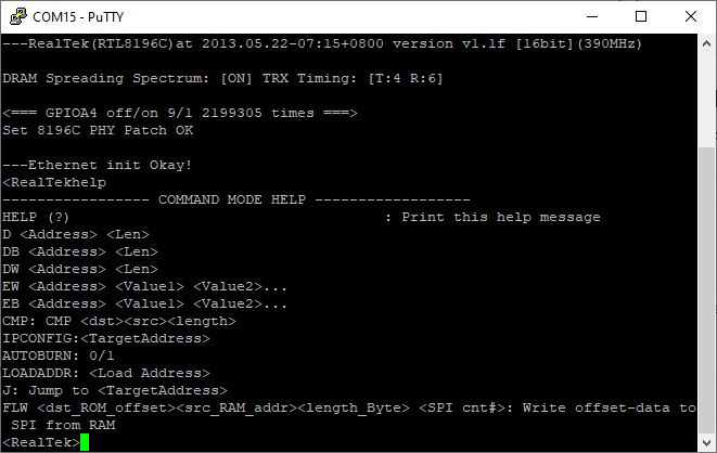

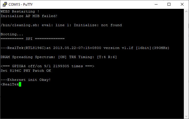

    UART connection - command line
    After the MIB message, the process stalls and the router does not start. It also does not respond to commands. Could it be that the command line is blocked? Nothing could be further from the truth. I quickly discovered that pressing the Escape key at boot time locks the process and frees the command line:

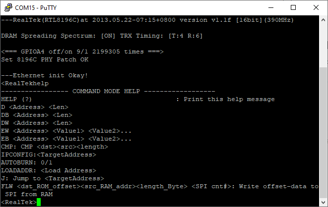

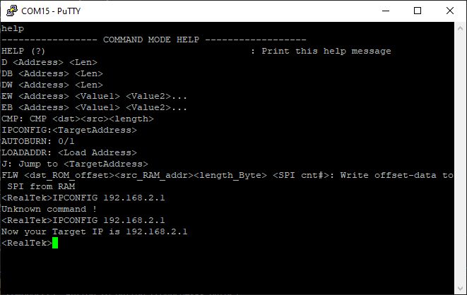

    Furthermore, the help command works - it provides us with a list of commands:
    The commands seem to be already known, I see that the OpenWRT guys have documented them:
    https://openwrt.org/docs/techref/bootloader/realtek
    In a nutshell, here we have:
    - D <Address> <Len> - memory dump (preview of RAM/flash area)
    - DB <Address> <Len> - byte dump
    - DW <Address> <Len> - word dump
    - EB <Address> <Value1> ... - writing bytes into memory
    - EW <Address> <Value1> ... - word write
    - CMP <dst> <src> <length> - comparison of two memory areas
    - IPCONFIG <TargetAddress> - IP configuration (e.g. for TFTP / recovery)
    - AUTOBURN 0/1 - enables/disables automatic flash programming (so called "autoflash")
    - LOADADDR <Load Address> - sets the address to which the data is loaded (e.g. from the network or the UART)
    - J <TargetAddress> - jumps to the address (starting the code in RAM)
    - FLW ... - write to flash via SPI (from RAM to SPI flash)
    Satisfied with the results, I started testing the commands on my own. IPCONFIG was the first to go:

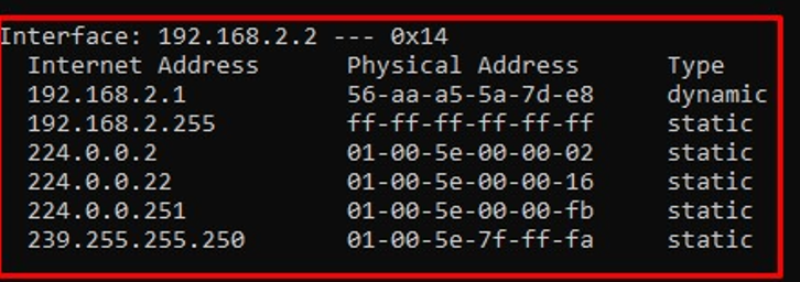

    From what I understand, it sets the destination IP of the router where the firmware can be uploaded via a PUT request. Interestingly, this IP doesn't even respond to pings, but arp seems to see it:

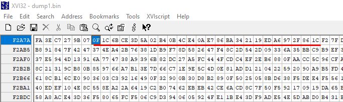

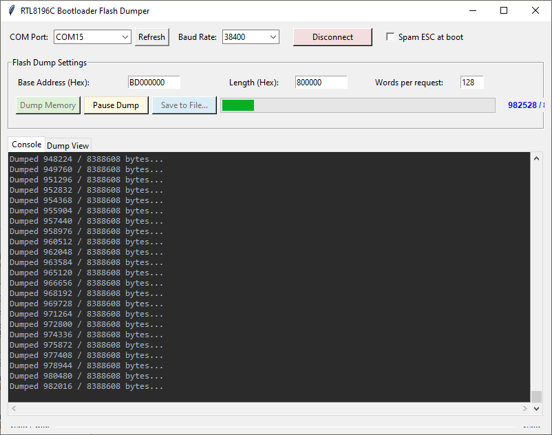

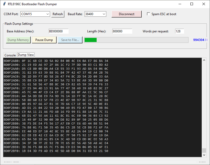

    UART connection - custom flash dumper
    The dump command response consists of the data address and the contents of consecutive 32-bit words in hexadecimal format:
    80008000:       00001021        0800200D        00000000        8FA40014
    This can be easily parsed and saved to a file. The only puzzle remains the offset - where is the flash memory mapped? I checked this experimentally, with a script. The batch read from CH341 starts at 0xBD000000. In this way I was able to develop a simple tool to read data over the UART:

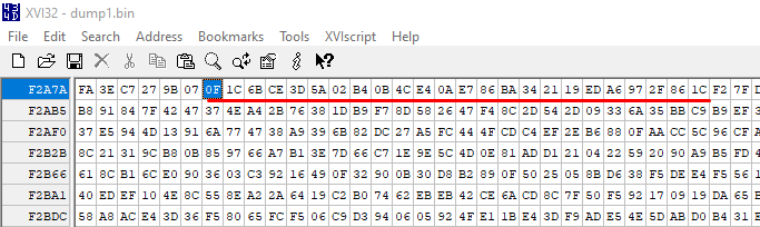

    The screenshot shows the offset $F2A80 with the data available there. What is in the ripped file under this offset?
    The data matches and the ripped memory is 1:1 compatible with the contents of the Flash.

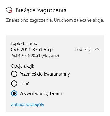

    In addition, and even more interestingly, the antivirus was responding at the same time:

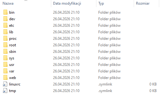

    I tackled it with a Python script:
    Code: Python
    The extracted system turned out to be.... quite rich:
    Analysis of the inside of the router, memory ripping, bootloader, custom program for UART Analysis of the inside of the router, memory ripping, bootloader, custom program for UART Analysis of the inside of the router, memory ripping, bootloader, custom program for UART

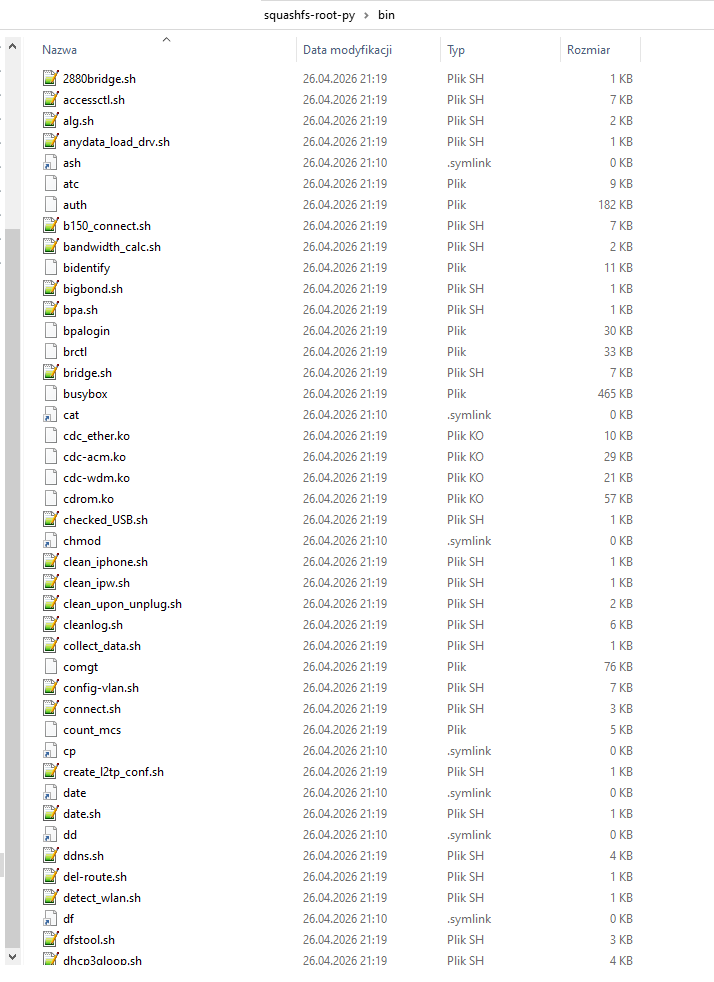

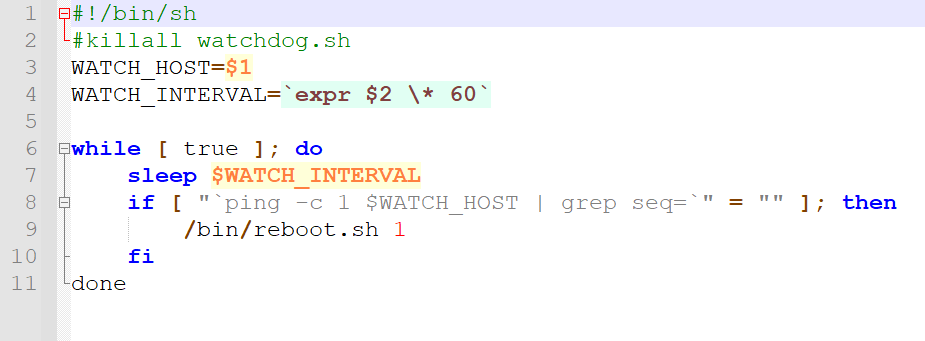

    In /bin itself we have interesting files such as:
    - scripts to manage the router (e.g. firewall.sh, init.sh)
    - files and drivers for 3G/LTE modem support (cdc-acm.ko, cdc-wdm.ko, usb_modeswitch, qmicli, comgt, bpalogin)
    - and even scripts and daemons designed for tethering from iOS devices (iPhones)! These include iphone_connect.sh, ipheth-pair, usbmuxd or ideviceinfo
    - the webserver, which is the main process responsible for the configuration and communication side

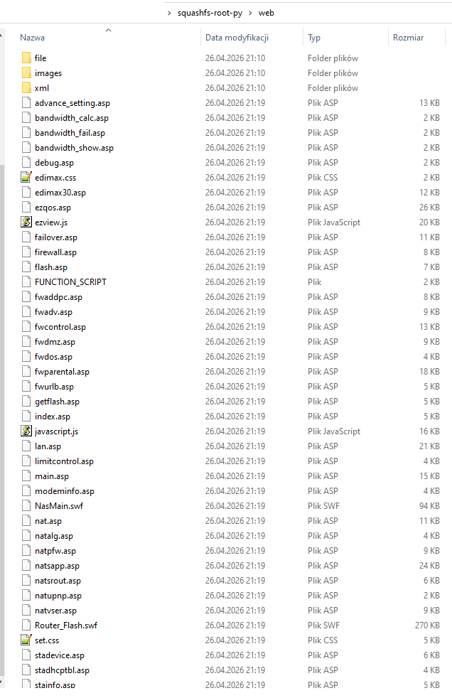

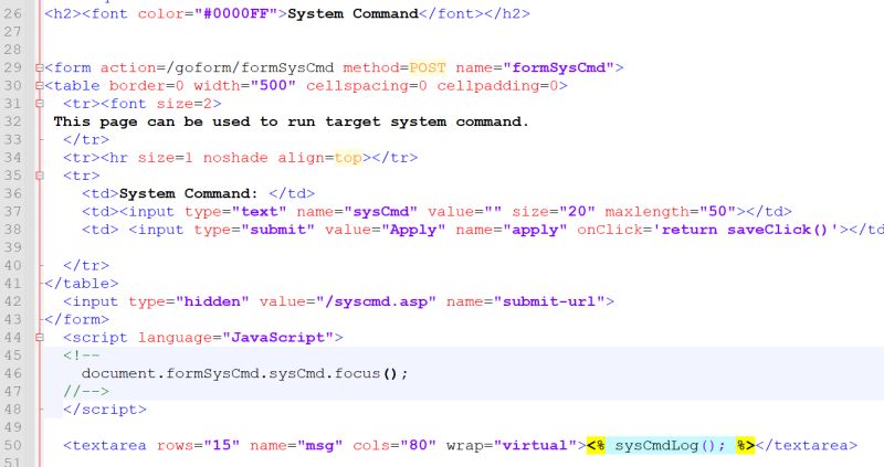

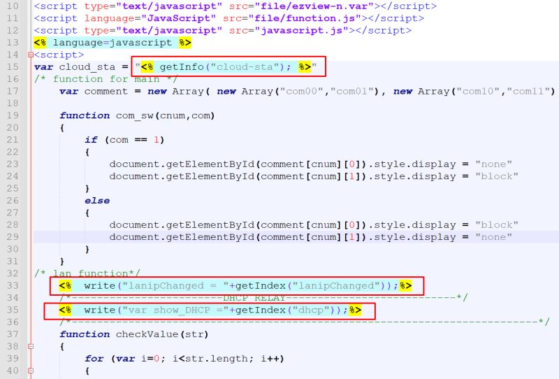

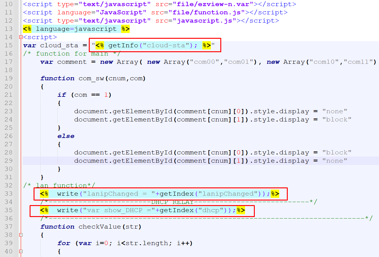

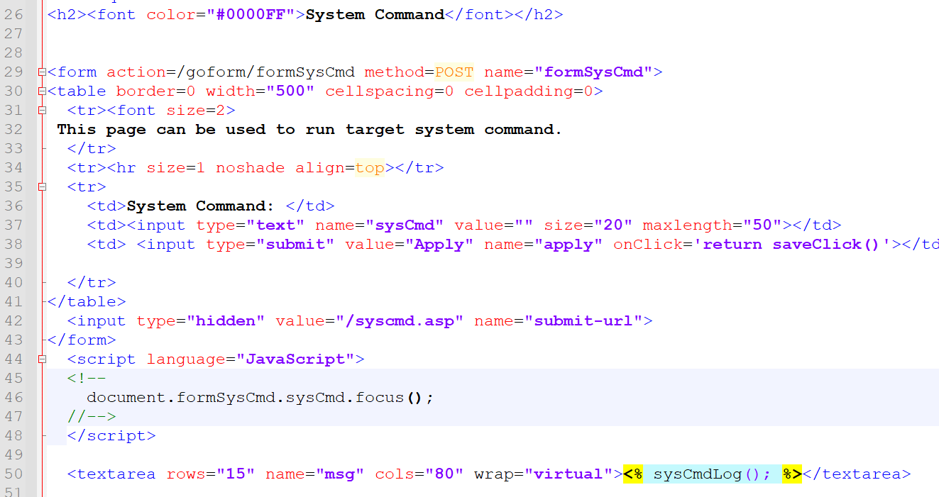

    The second interesting directory is /web, there are the server sources themselves. Immediately striking:
    - an overabundance of .asp files - at first I thought this was Active Server Pages (ASP) technology from Microsoft, but it doesn't look like it - it's a different solution, also containing HTML, Javascript, but also special tags, retrieving variables from the system. For example:
    - among the .asp I see the command interface:

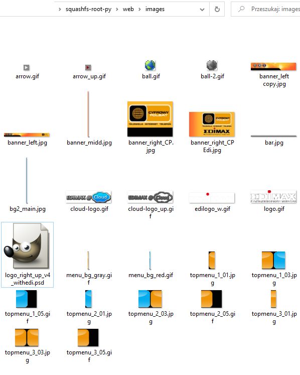

    - image files - gif, jpg and even by some miracle also PSD:

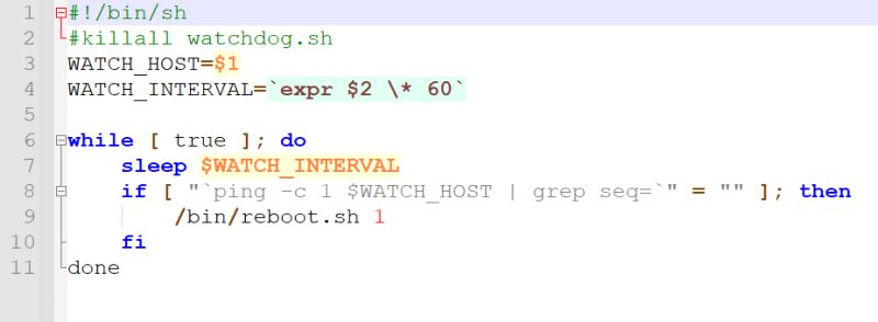

    Looking in the /etc directory, on the other hand, one comes across the default passwd account file. In addition to root and network services, there are some strange account names in there, "john", "dliu", "odysseus", "ygtai" or "hcjong", could they belong to developers?
    The compilation date of all software appearing in the compiler_date file - Thu Jan 2 09:13:20 CST 2014 - indicates 2 January 2014.

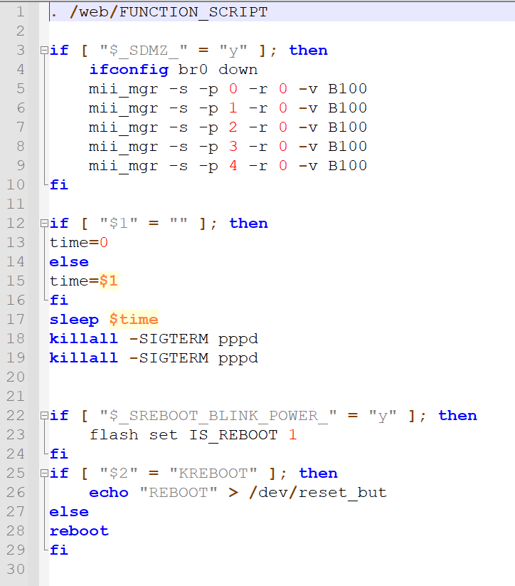

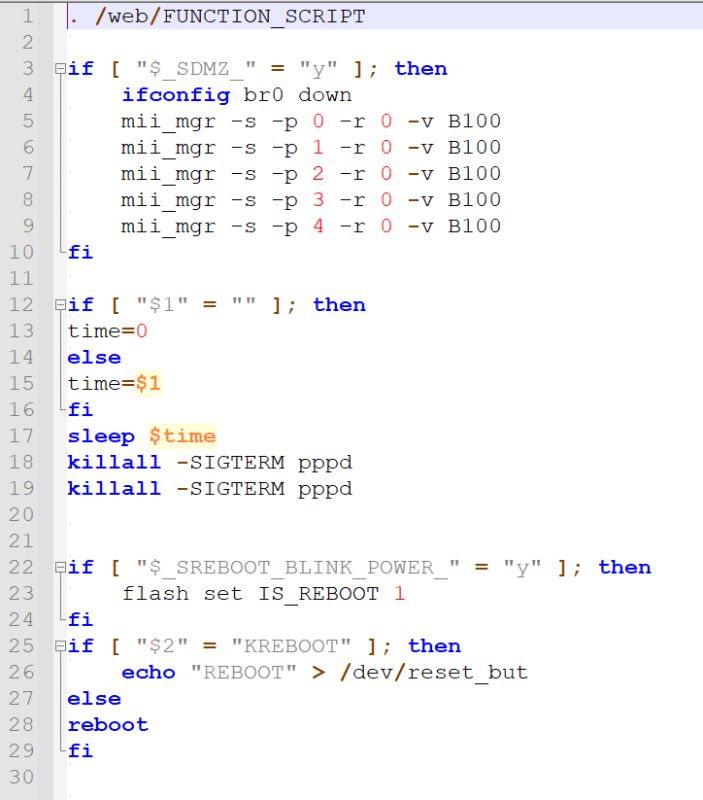

    The main boot script operating on all these systems is /bin/init.sh. This is a very comprehensive file dealing with initialising network interfaces, loading settings (including MIB configurations using calls to the built-in system flash utility, e.g. flash test-hwconf) and running a whole range of services - from dhcpd, to the pppoe client, to WPS and watchdog support ("wps_daemon", "watchdog.sh").

    The screenshot shows the watchdog - when a particular host does not respond, the router is rebooted. Below is the reboot script:
    Screenshot of a code editor showing a shell script fragment in /web/FUNCTION_SCRIPT
    Summary
    The adventure turned out to be more interesting than I thought. The router, although already quite old, could still be useful for hobbyist and educational purposes as well. There is a lot of potential for changing the batch and running a program uploaded to RAM. I'll try to show this in a separate topic, although I don't know yet how successful it will be. I've seen some of the sources from Realtek on GitHub, but will they really fit on this board? We'll find out! The whole thing doesn't look officially supported by OpenWRT, but that doesn't mean you have to cross it off straight away.
    Do you see any use for the old router? Feel free to discuss.

    I was able to get this router to execute simple machine code, including displaying text on the UART and flashing LEDs. I also managed to get GCC to compile a program for me, which is then uploaded via the bootloader to RAM. I have, however, problems with the stability of the whole thing, and it's not clear what's wrong. Anyway, the rest of the adventures will be in a separate topic.

    gregor124
    Posts: 1616
    Help: 99
    Rate: 857
    This RTL8196 is based on the MIPS RLX4181 processor and documentation is available.
    It is compatible with the MIPS-1, MIPS16 specification.
    So you can develop software on it without any problem.
    I add the documentation where its registers are described, with addresses and description of functions.
    Opcodes:
    https://student.cs.uwaterloo.ca/~isg/res/mips/opcodes
    • A 16-bit MIPS Based Instruction Set Architecture.pdf (146.77 KB) You must be logged in to download this attachment.
    • RTL8196C.pdf (599.12 KB) You must be logged in to download this attachment.

  • Power input is 5 V, but the measured board operating rail is 3.3 V, which also matches the required UART logic level for a CH340 USB-UART adapter. [#21903591]

How can I dump the 25L6406E SPI flash from an Edimax LT-6408n with a CH341 programmer step by step?
Use a CH341 after removing the 25L6406E from the board. 1. Desolder the SPI flash with flux and hot air. 2. Read it in NeoProgrammer and run verify. 3. Save the full dump before any other modification. The chip is a 64 Mbit part, so the backup size is 8 MB. [#21903591]
CH341 clip vs desoldering with hot air for SPI flash reading: which method is more reliable for router firmware backup?
Desoldering with hot air is presented as the more reliable method. The author explicitly says the clip fails more often than it works, so he prefers removing the chip, cleaning the lead-free solder from pads, and resoldering with leaded solder for easier later work. For a first backup, reliability matters more than speed. [#21903591]

How can I read flash memory over UART on an RTL8196C router by parsing the bootloader dump command output?
You can automate flash reading by sending the bootloader dump command and parsing each returned line. The thread shows output in 32-bit hexadecimal words, such as an address followed by four values. A script can capture those words, strip formatting, and write bytes to a file. It is slower than CH341, but it verifies the flash mapping and bootloader access path. [#21903591]
Where is SPI flash mapped in memory on the RTL8196C, and how do I match UART dump addresses like 0xBD000000 to file offsets?
In this router, the flash dump aligns with memory starting at 0xBD000000. The author verified it experimentally by comparing UART dump data with the CH341 backup. To match an address to a file offset, subtract 0xBD000000 from the UART address. For example, data shown at offset 0xF2A80 matched the same location inside the flash file. [#21903591]

How do I extract the SquashFS filesystem from an LT-6408n flash dump using Python and PySquashfsImage when binwalk extraction fails?
Use Python to open the dump directly at the SquashFS offset and register an LZMA decompressor for method 2. In the thread, the script loads dump1.bin, opens SquashFsImage(..., offset=1179648), walks the root tree, and writes files into an output directory. That bypasses binwalk’s failed external extraction path and successfully recovers the filesystem. [#21903591]
Why would antivirus react during firmware extraction from a router image, and how can I safely analyze the dump?
Antivirus can react because firmware dumps contain packed binaries, scripts, and executable blobs that resemble malware signatures during extraction. The thread shows an antivirus alert appearing while the image was being unpacked. A safer workflow is to keep the dump unchanged, extract in an isolated analysis environment, and compare recovered files against the original 8 MB flash image before trusting any result. [#21903591]
What interesting files and services are stored in the LT-6408n firmware, such as LTE modem support, iPhone tethering tools, web ASP pages, and watchdog scripts?
The firmware is unusually rich for a 2014-era router. /bin contains LTE and 3G support tools like usb_modeswitch, qmicli, comgt, bpalogin, and modem drivers. It also includes iPhone tethering tools such as iphone_connect.sh, ipheth-pair, usbmuxd, and ideviceinfo. /web holds many .asp pages, images, and translation files, while /bin/init.sh starts services like DHCP, PPPoE, WPS, and watchdog logic. [#21903591]
