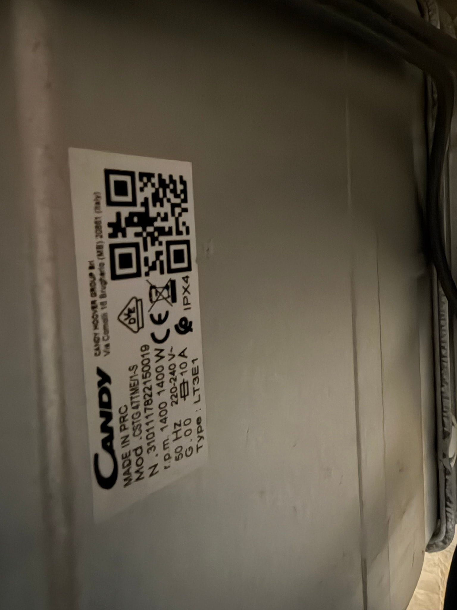

    Hi,
    I would to ask you. I have Candy CSTG 47TME/1-S and I have issue with the bearing on the right side (without pulley/belt). How is the easiest way to remove the cover and get to the bearing? Left side is OK. If anyone has a service manual, I will be glad for this.
    I want to minimize unnecessary disassembly.
    Thank you for your help :-)

    Thank you for answer. However I want to exchange other side and I dont know how easier get to them. There is no cover with two screw for easy access. Thanks.
  • #5 21916869
    Jeenass
    Posts: 7
    Here is the photo of the washing machine.

    #6 21916928
    Kenworth 18
    Posts: 11266
    Help: 2442
    Rate: 3749
    You are looking for parts by this number: 31011178. No access to the passive side. I don't recommend this method, but you can and by the simplest line of resistance: https://youtu.be/pegpGM0fpHc?is=cqzyze_LW37_47IE

    #8 21917183
    Kenworth 18
    Posts: 11266
    Help: 2442
    Rate: 3749
    Well, unfortunately. The tank has to be dismantled.
    #9 21917191
    mrice
    Moderator of Home appliances
    Posts: 13955
    Help: 2213
    Rate: 6951
    There are two methods, either you cut a hole in the housing and then seal it with something, or, if it is to be smooth, you have to remove the tank top from the housing.

  • #11 21936346
    Jeenass
    Posts: 7
    OK guys, thank you for your reply. I made a hole into the cover and exchanged the bearings. Thank you.
  • #12 21936349
    Jeenass
    Posts: 7
    I make a hole into the cover and then I'm was able to change a bearing.
