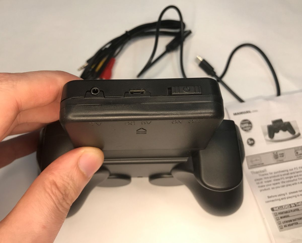

    The pad doesn't have many buttons, and on the back we only have the obvious charging input and video output. Apart from that, there is of course an on/off button.
    Minitest: S10/G10 520 in 1 portable console/gamepad, interior presentation
    The pad is powered by a BL-5C battery, the same one used in Nokia phones.

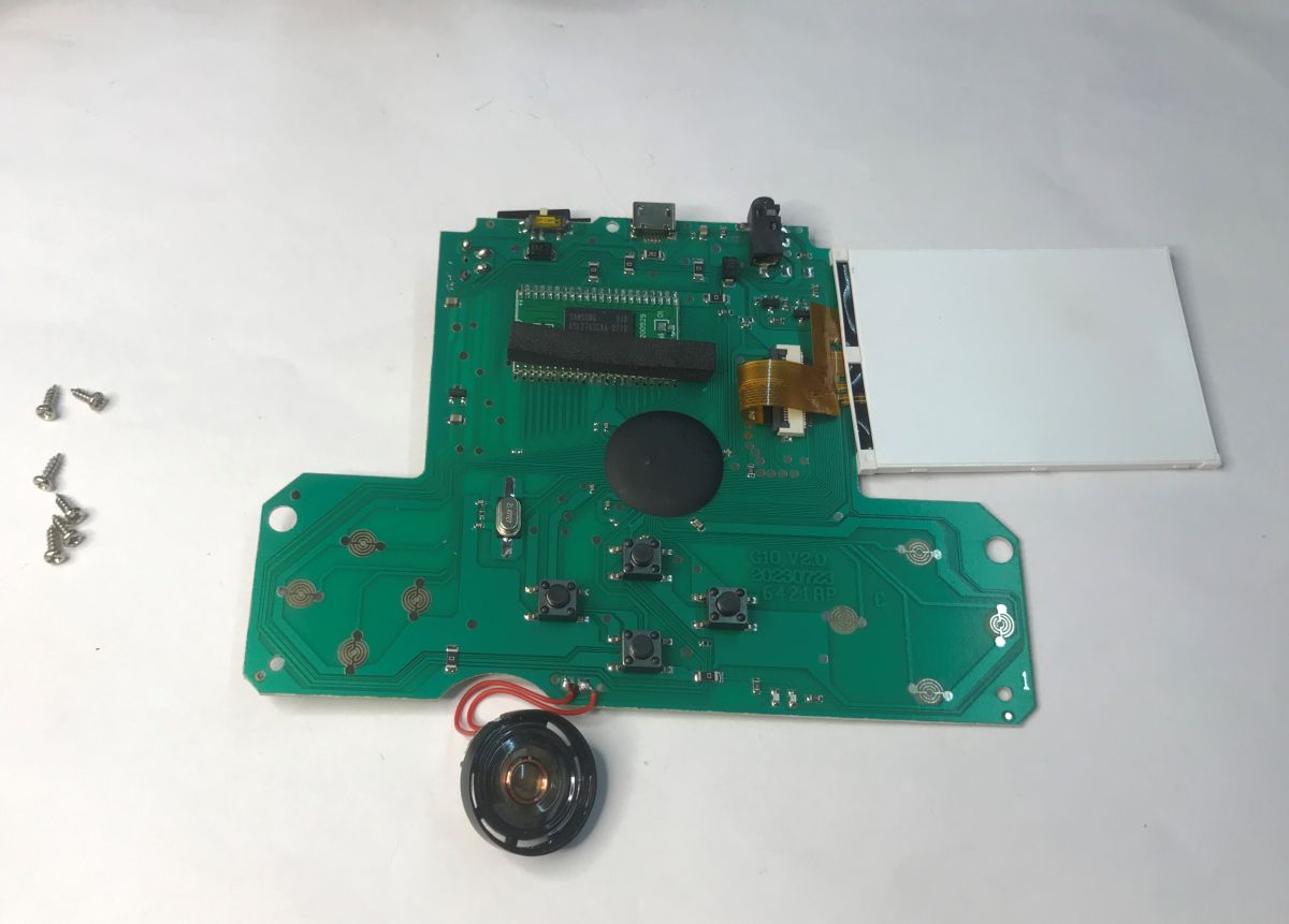

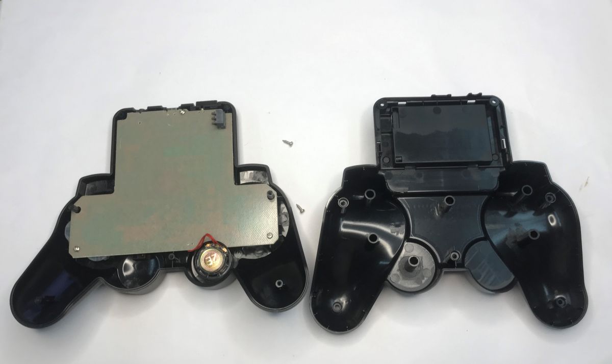

    It is now time to check the inside of the console.
    Unscrew the screws - there is a simple, single-sided plate inside.
    PCB designation: G10 V2.0 20230723 Unfortunately there's not much else here. Probably the main circuit hides under the 'black dot'.
    The K5L2763CAA-D770 is the memory, I couldn't find its datasheet, but it looks like it's an integrated Flash + RAM solution.
    That's basically it - no wonder it's so cheap.

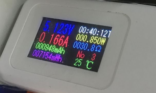

    The first thing that was important to me was whether the console would run without a battery, when powered by USB. The answer is yes - less than 0.2A is drawn.

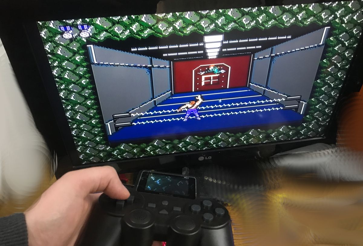

    The second issue is TV mode - everything works, worse is that when you connect the TV the console blank out the normal screen and then won't go back to it, even when you remove the cable. It's not needed for normal operation though, so there's no reason to complain.

    I wonder if it would be possible to read the flash and if there would be something interpretable there.
  • #3 21916562
    Posts: 14724
    Rate: 12807
    Good idea, but that would mean I guess I need to think about a better programmer for ripping memory. For this type of bone the CH341 is unlikely to be sufficient.
    Flash analysis alone could potentially determine what's sitting there, as long as there's an emulator and not some native solution?
  • #4 21916574
    E8600
    Posts: 8961
    Help: 529
    Rate: 2518
    I wonder if it is flash or emmc after all?
    As for the battery from Nokia, in a similar console the intended capacity is 200 mAh.
  • K5L2763CAA-D770 likely matches K5L2731CAM-D770
    #5 21916583
    gregor124
    Posts: 1646
    Help: 99
    Rate: 869
    It is likely that this K5L2763CAA-D770 is almost the same as the K5L2731CAM-D770, i.e. "128Mb NOR Flash + 32Mb UtRAM".
    Only that with 64Mb UtRAM.
    Probably the way it reads, writes will be very similar.
    If one is keen, it looks like the programmer can be designed quite easily.
    The letter "M" on this item at Samsung indicates the generation of the chip.
    It would be good to determine what this console actually emulates, in case of difficulties I suggest showing on a video, a photo some well-known game, maybe someone will recognise.
    • K5L2731CAM.pdf (929.88 KB) You must be logged in to download this attachment.
  • #6 21916616
    TechEkspert
    Editor
    Posts: 7277
    Help: 17
    Rate: 5660
    I wonder if under the black dot is an ASIC or a microcontroller/microprocessor, of the less likely options under the dot are two structures.
  • #7 21916626
    gregor124
    Posts: 1646
    Help: 99
    Rate: 869
    >>21916616
    You should be able to tell by the frequency of the quartz.
    Could be an ASIC, it seems, they already made NES clones in glucet many years ago ;)
    In general, this memory looks like something like a big cartridge ;)
    21.47727 MHz for NTSC
    26.601712 MHz for PAL
  • #8 21916717
    TechEkspert
    Editor
    Posts: 7277
    Help: 17
    Rate: 5660
    Quartz - photo indicates a possible NES-on-a-Chip (NOAC) NTSC.
  • #10 21916755
    gregor124
    Posts: 1646
    Help: 99
    Rate: 869
    Such chips are made by Taiwanese company VRtechnology, there are several versions and it looks like they are ASICs with CPU6502.
    These chips (at least some of them) even have PAL/NTSC selectable
    More chips (versions) here
    http://www.vrt.com.tw/datasheet.htm
    Found without AI ;)
    • VT01 Data Sheet RevisionA2_ENG_.pdf (464.5 KB) You must be logged in to download this attachment.
