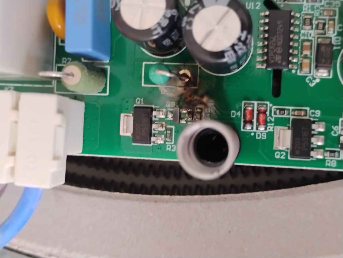

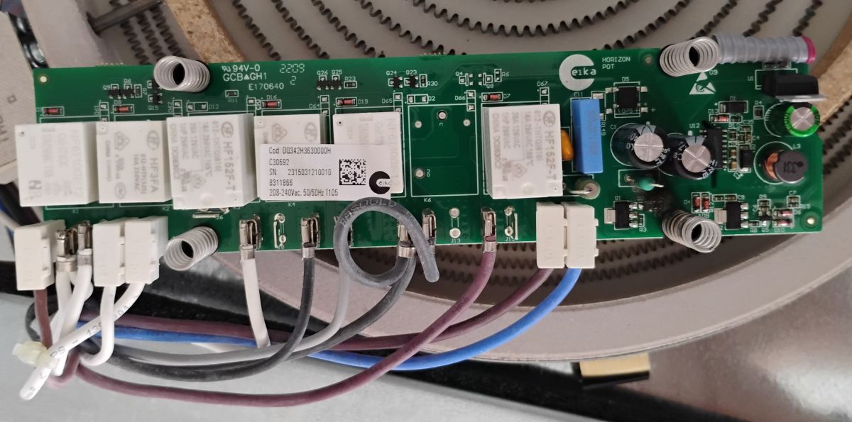

    I have a Teka TB6315 motherboard that won't turn on. I've found several burnt components on the controller board that I can't identify.
    Can you tell me what replacements are for Q3, C8, and R10?
    Thank you very much for your help.

    Can you upload clear, close-up photos of the controller board, especially the burnt Q3, C8, and R10 area, plus a photo of the whole board and the back side?

    Perhaps I should sketch out this circuit – the one next to it is similar. It’s about controlling this triac; there’s a similar module discussed in this thread:
    https://www.elektroda.pl/rtvforum/topic4147426.html#21710155
    Clean the area thoroughly – there are probably some standard control components there. You’d better check the processor port, as it may have been damaged by those burnt-out components.

    testedpublic wrote:
    What is the mains voltage?
    I don’t understand the question – are you asking what the mains voltage is here, or what’s the issue?
    Have you checked the processor? Is the port OK – is it not damaged?
