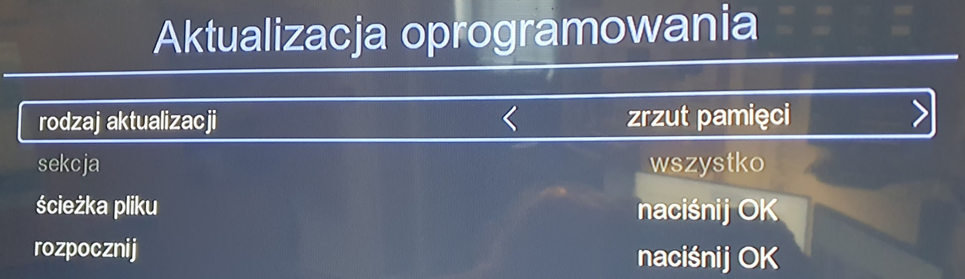

    On set-top boxes with this menu, you can copy the flash content to a USB stick directly from the menu. It’s simple, but you need to make a small change in the update settings first.
    “Software update” menu showing “memory dump” option and “press OK” prompts
    I hadn’t thought of that myself, and previously I’d been copying it using a programmer.
    But a fellow forum member, Funzen, pointed this option out to me here on the forum, for which I thank him once again.

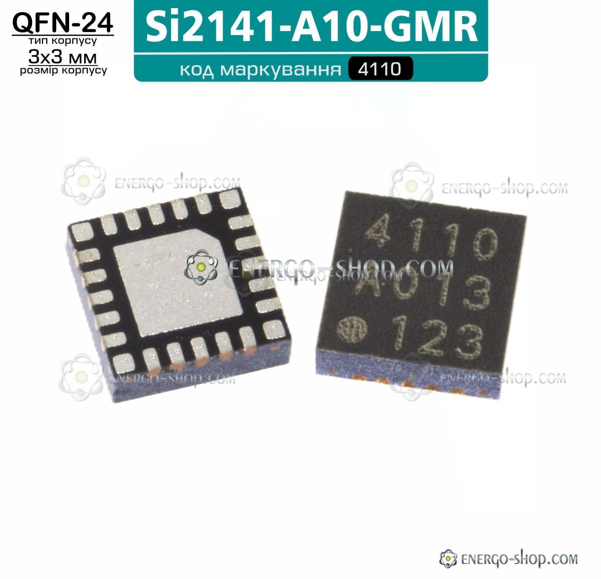

    There’s still a chip from the head unit left – I can’t identify it: 4110 A009
    It looks like an interesting chip. I can’t identify it either, but there aren’t many lines between the SoC and this chip in the head unit. That would suggest it isn’t outputting MPEG-TS, just a standard IF or perhaps ZERO IF. It’s another matter how simple these tuners have become these days.
  • #4 21920340
    funzen
    Level 25  
    Posts: 527
    Help: 73
    Rate: 255
    The printhead model is SI2141
    SI2141
    Two QFN-24 3×3 mm ICs; label “Si2141-A10-GMR” and marking code “4110”.
    SI2141.PDF (206.9 kB)You must be logged in to download this attachment.

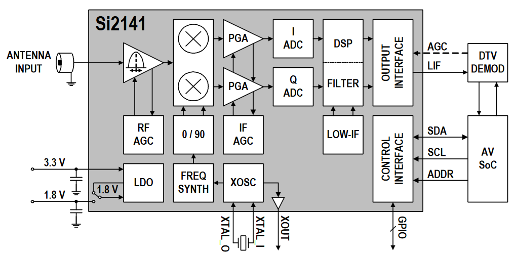

  • Si2141 appears supported by universal tuner driver
    #7 21920451
    Posts: 14791
    Rate: 12937

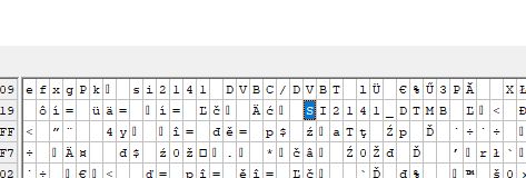

    The Si2141 would be suitable; it’s mentioned in ecos.bin:
    DVB-T2 HEVC H.265 Full HD terrestrial TV tuner and set-top box – internal components, firmware
    I can see that this is probably some sort of universal driver, as it also mentions the ATBM2040 and others.
    - Rafael Micro: R836 & R850
    - MaxLinear: MxL608
    - Silicon Labs: Si2141
    - AltoBeam: ATBM2040, ATBM253, ATBM6032

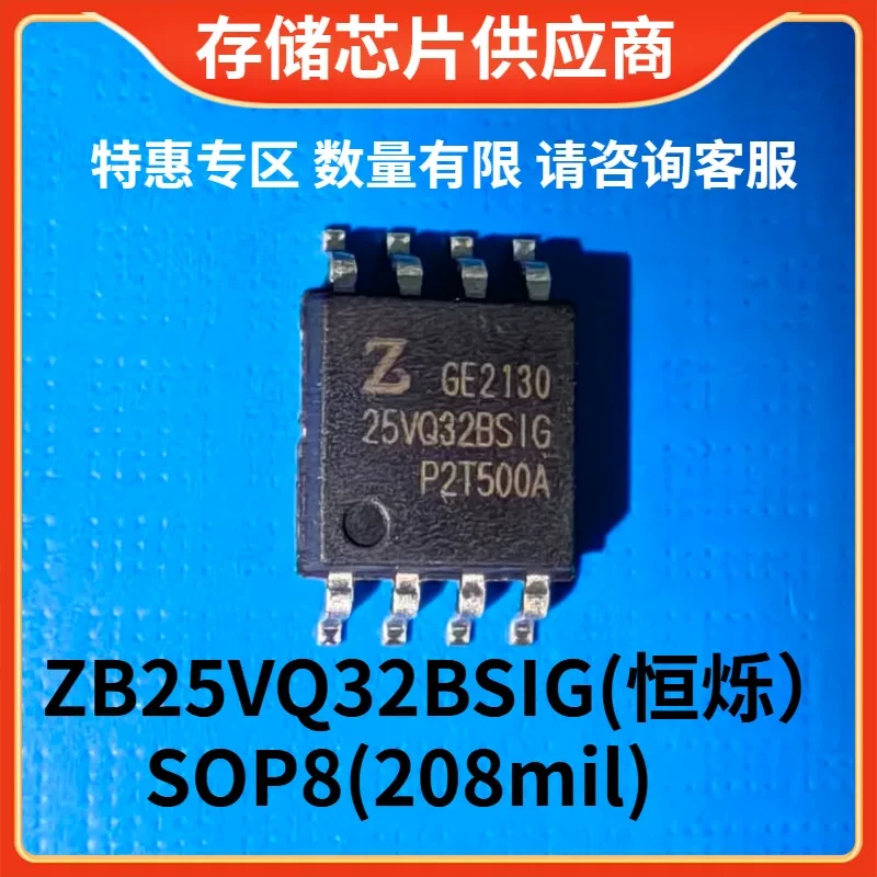

    These new DVB-T2 set-top boxes may contain memory modules that are not supported by the CH341.
  • #10 21921191
    Posts: 14791
    Rate: 12937
    I wonder if you could specify exactly which types of memory you’re referring to? Are you talking about those with a parallel interface?

  • CH341 cannot read this Manta memory chip
    #12 21921208
    E8600
    Posts: 9001
    Help: 529
    Rate: 2529
    I once wanted to read data from a Manta; I desoldered the memory module but couldn’t get it to work. I thought the programmer was faulty, but then I found out somewhere that this particular memory module couldn’t be read using that programmer. I don’t remember what type of memory it was, but it’s possible I posted about it on a forum. It was a Manta with DVB-T2 that I was repairing for a friend.
    It’s possible it was the software, as I only tried using the CH341.

    If you’re referring to the memory mentioned in this post 20173560
    then it can be read without any problems using the "SiberiaProg CH341A v1.43" programme
  • #14 21921251
    Posts: 14791
    Rate: 12937
    I recently had an issue with a memory module, and it turned out that the JEDEC ID read function was simply blocked, but all other Flash operations on it were still supported. Because of this, the software wouldn’t read it.
    Flash memory connected but the programmer can’t see it? Solving the CH341 NeoProgrammer issue
