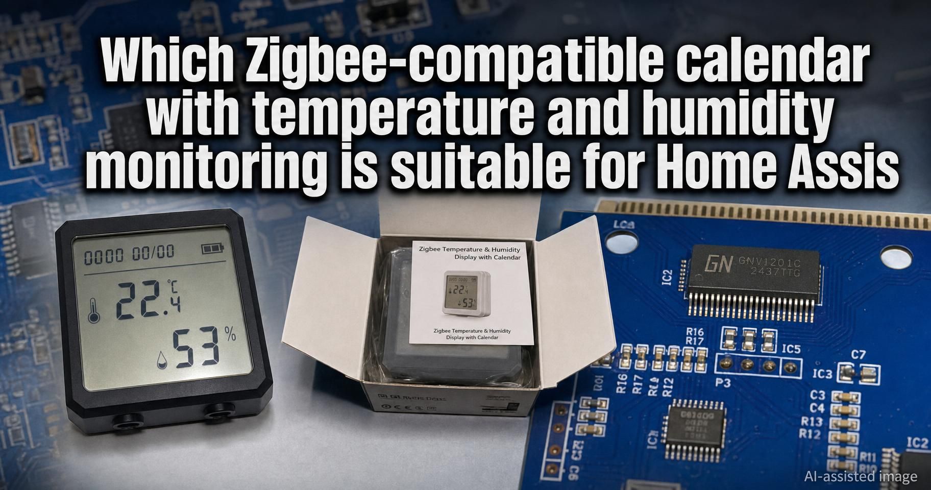

  • The TH01Z-Black is a Zigbee calendar-style display with date, temperature, and humidity readings, offered in white or black.
  • It pairs through a separate gateway and was tested with Home Assistant using a CC2531 antenna and Zigbee2MQTT, where HA identified it as TS0601.
  • The housing measures 60 × 63 × 25 mm and runs on three LR03 batteries.
  • Home Assistant exposes reporting frequency, units, alarms, and alarm thresholds, but the date appears only after pairing and batteries are not included.
  • Which Zigbee-compatible calendar with temperature and humidity monitoring is suitable for Home Assis
    The TH01Z-Black shown here features a large, easy-to-read display which shows the current date and the temperature and humidity readings taken by the device. The unit measures 60 × 63 × 25 mm, is powered by 3 LR03 batteries and communicates with the gateway wirelessly via Zigbee.
