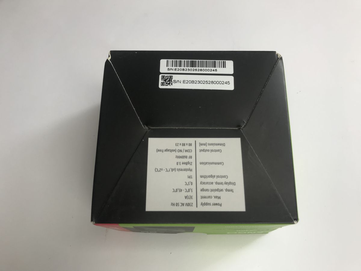

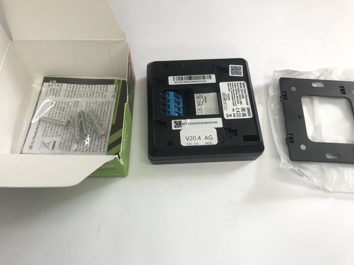

    The pack includes the device itself, a mounting bracket and screws. The rear of the device features screw terminals – a 230 V power supply and a voltage-free relay with a load capacity of up to 3 A. In addition, the importer includes a Polish-language manual which describes the device’s configuration in detail:
    The E25-230B thermostat and experiments with Zigbee support in Python via the CC2531 The E25-230B thermostat and experiments with Zigbee support in Python via the CC2531
    The display is clear and easy to read. You can then put the device into pairing mode. I wanted to pair it with Home Assistant using Zigbee2MQTT, but it turned out that this isn’t supported.

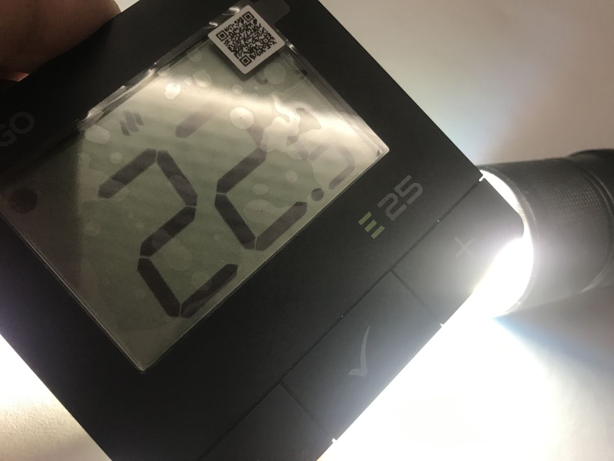

    First off – a quick look inside. Where’s the temperature sensor?

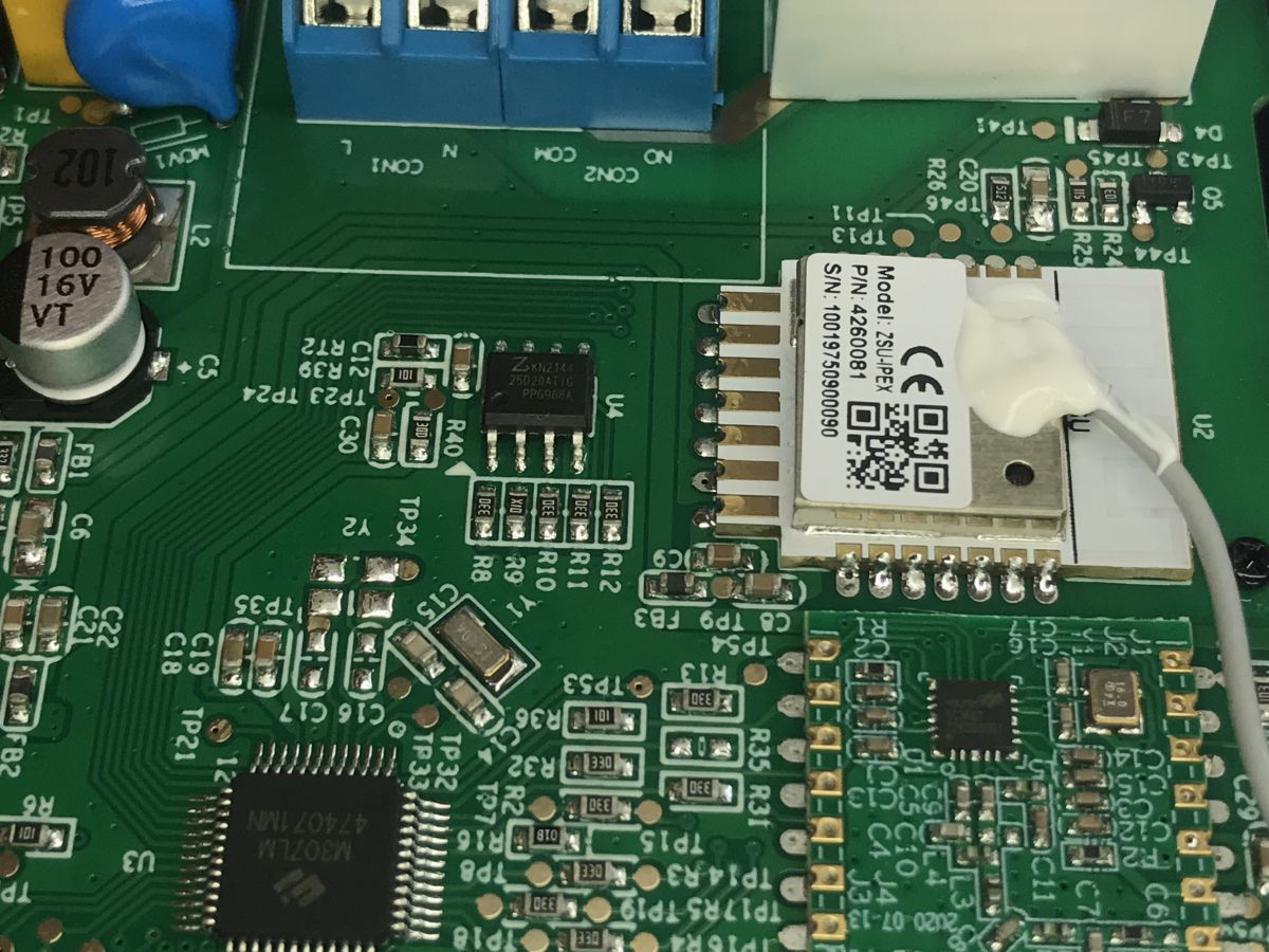

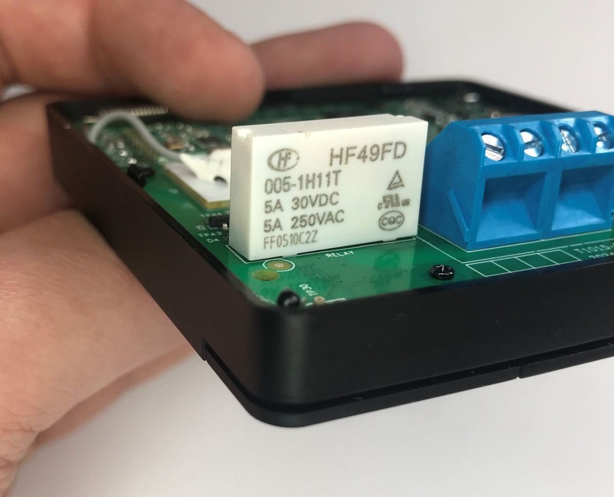

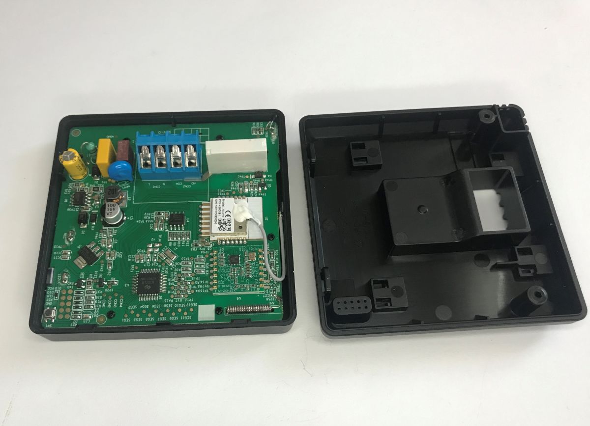

    The interior appears to be quite complex. This isn’t exactly a typical example of miniaturisation. Inside, there is a separate main microcontroller – here in a TQFP package – a Zigbee module (ZTU from Tuya), and an RF module.
    The E25-230B thermostat and experiments with Zigbee support in Python via the CC2531 The E25-230B thermostat and experiments with Zigbee support in Python via the CC2531 The E25-230B thermostat and experiments with Zigbee support in Python via the CC2531

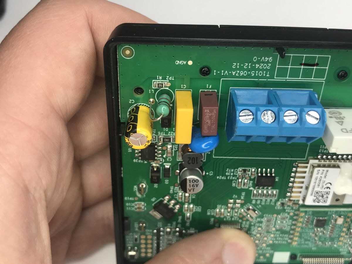

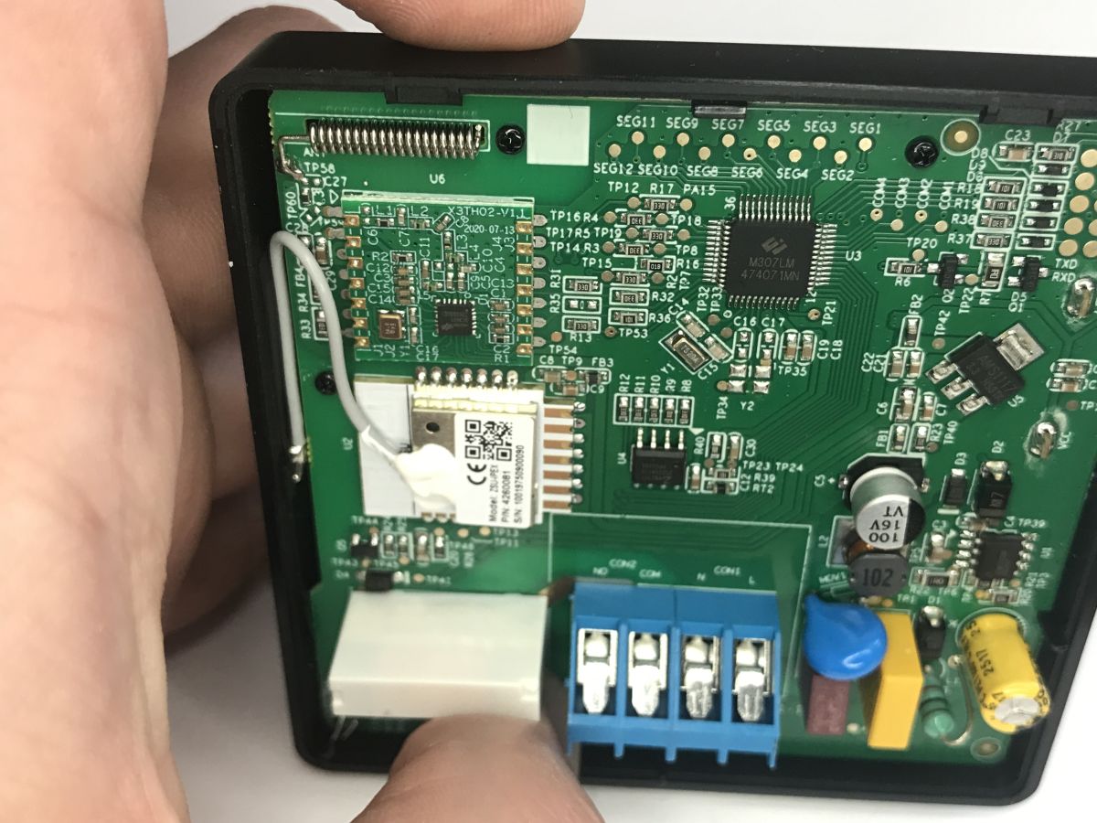

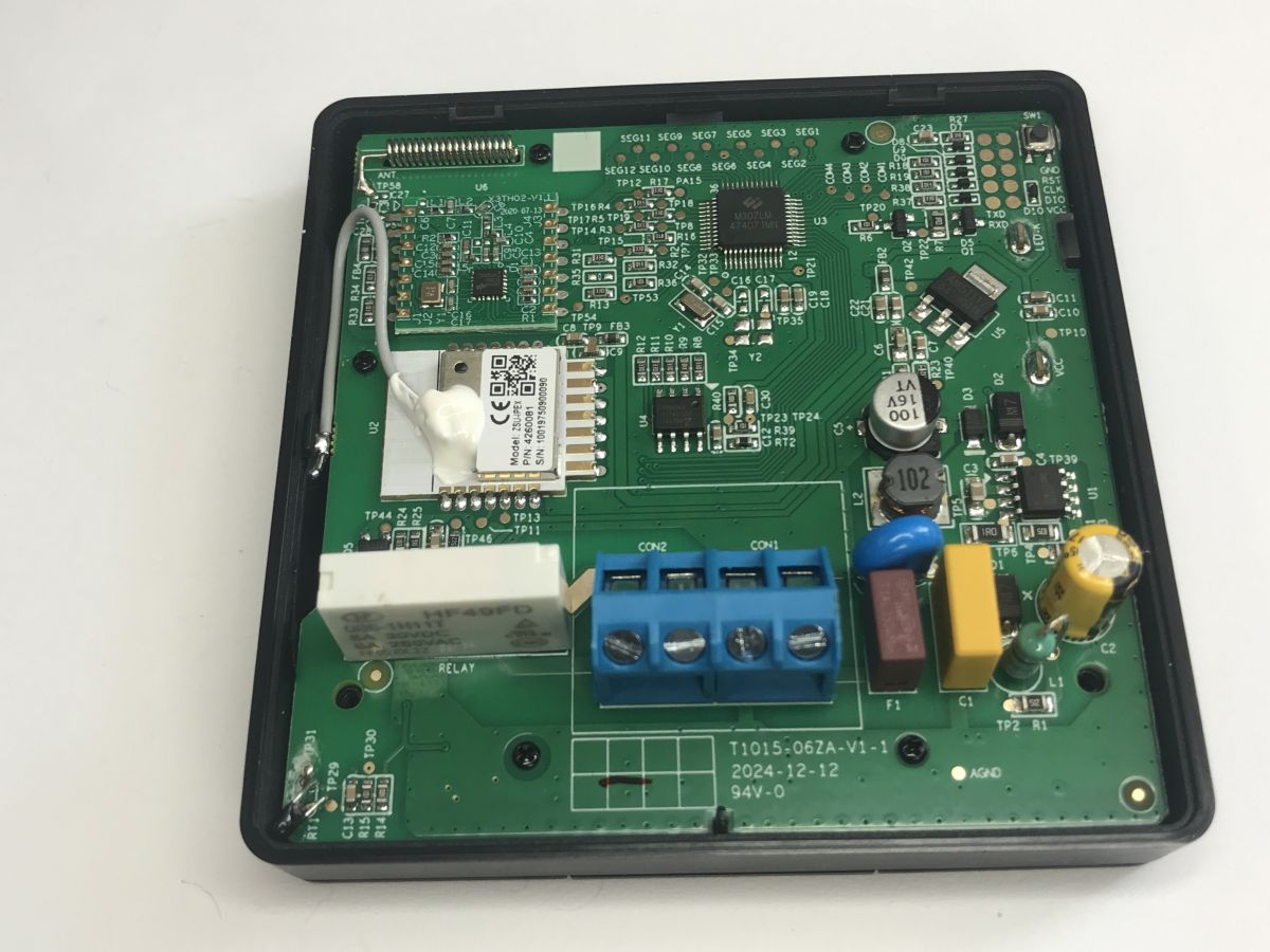

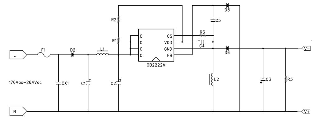

    The board is designated T1015-06ZA-V1-1, dated 12 December 2024. The whole thing is powered by a tiny step-down converter based on the OB2222MCP. Interestingly, I can even see filters and a varistor there. It seems the manufacturer hasn’t skimped on components this time.

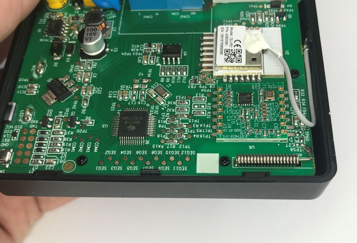

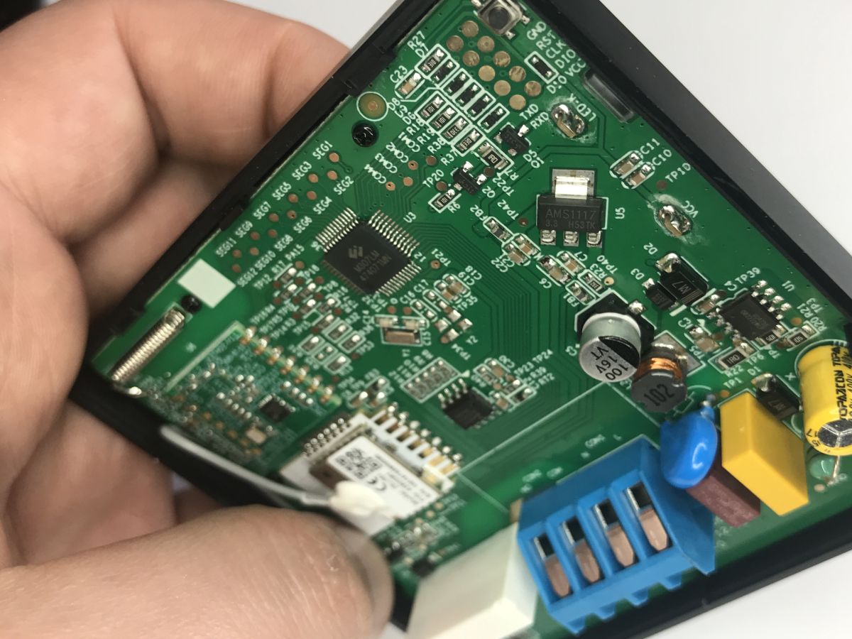

    Behind the converter is a 3.3 V LDO (AMS1117-3.3), followed by the chips – the M307LM MCU (RM® Cortex™-M0 core), the RF module is the Holtek BC3601 (CMOS RF FSK/GFSK transceiver), and there’s also some Flash memory (25D20ATIG) in there. I wonder what it’s for?

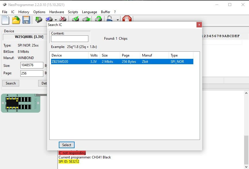

    My curiosity got the better of me, so I desoldered the memory chip and copied its contents using a CH341 (there’s supposedly a method using a clip, but it works so rarely for me that I don’t even bother trying). It turned out to be empty.The E25-230B thermostat and experiments with Zigbee support in Python via the CC2531

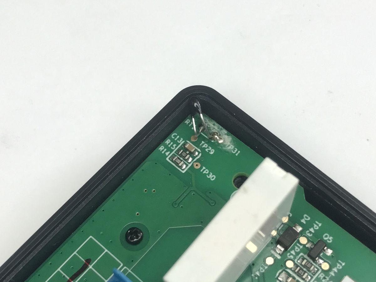

    Finally, I’ll show you the temperature sensor – it’s located in the corner of the casing:

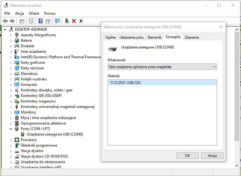

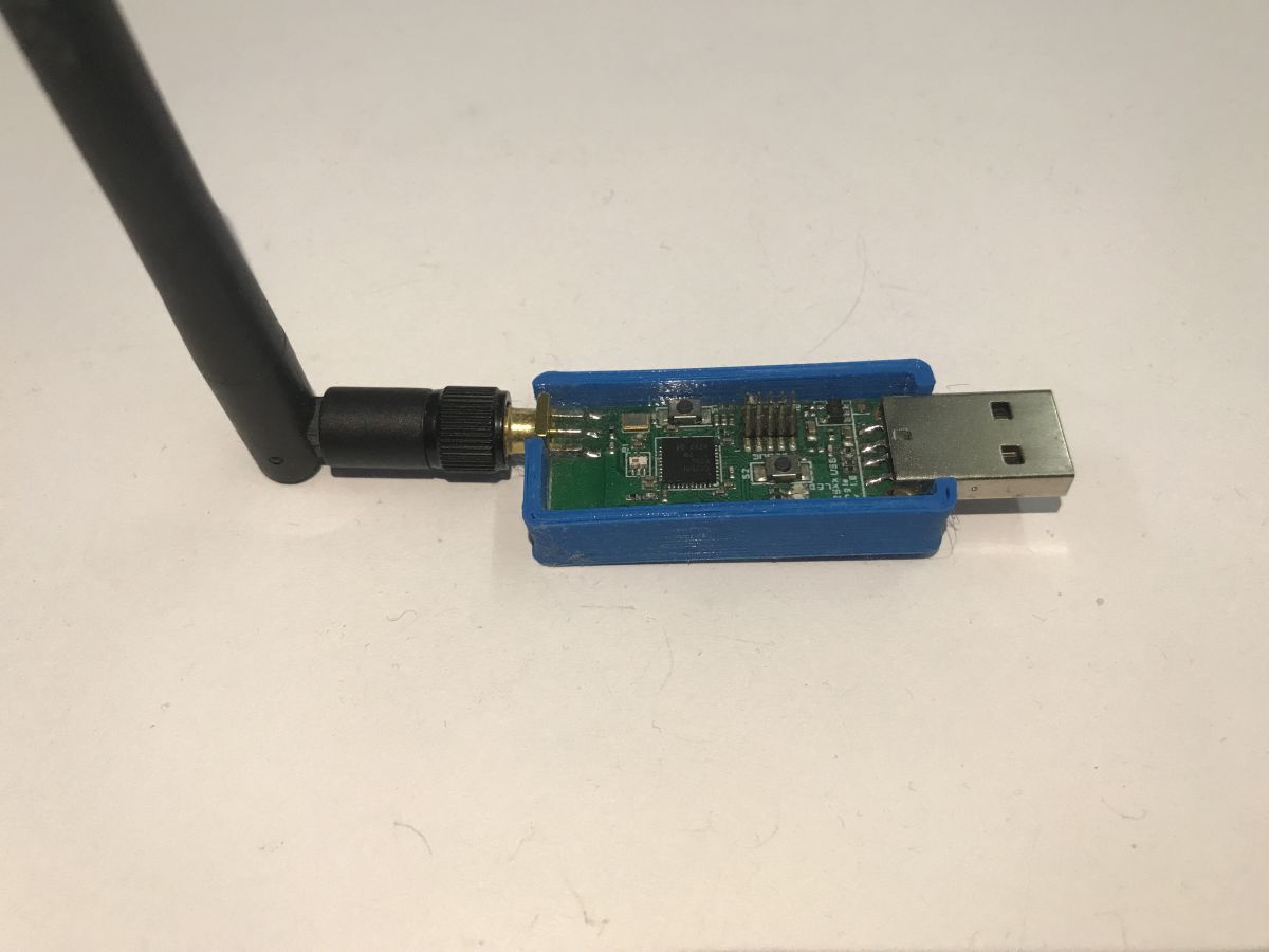

    Let’s start with an important fact about the CC2531 chip: depending on the firmware loaded, this module may be visible to the operating system as a standard virtual serial port (CDC mode – Communication Device Class). This provides us with a simple and convenient way to control the Zigbee stack (Z-Stack) using precise binary commands sent directly via the UART interface.
    Whilst searching online, I found a document from Texas Instruments describing the Z-Stack API on the Tasmota repository:
    https://tasmota.github.io/docs/_media/zigbee/Z-Stack_API_1_2.pdf
    However, the whole thing is rather complex, so it proved helpful to search GitHub for implementations of specific commands and constants (such as ZDO_STARTUP_FROM_APP). This allowed me to see how to quickly establish communication with the module:
    https://github.com/search?q=ZDO_STARTUP_FROM_APP&type=code
    Based on the above resources, I wrote a small test script in Python. It initialises the CC2531 and starts listening for incoming frames on the Zigbee network:
    Code: Python
    Full code:
    https://github.com/openshwprojects/CC2531test/blob/main/test1.py
    Result, after data pairing:
    [*] READY! The script is fully listening.
    [*] 1. If it's already paired, just press a button on the thermostat.
    [*] 2. If it's not paired, put it in PAIRING MODE now.
    [*] (Press Ctrl+C to stop)
    [ZNP] Cmd: 64:00 | Length: 1 | Data: 00
    [ZNP] Cmd: 65:40 | Length: 1 | Data: 00
    [ZNP] Cmd: 45:C0 | Length: 1 | Data: 09
    [ZNP] Cmd: 65:36 | Length: 1 | Data: 00
    [ZNP] Cmd: 45:B6 | Length: 3 | Data: 000000
    [ZNP] Cmd: 45:CA | Length: 12 | Data: ab32e10e39feff9d1c780000
    [ZNP] Cmd: 45:C1 | Length: 13 | Data: ab32ab32e10e39feff9d1c788e
    [ZNP] Cmd: 45:C4 | Length: 3 | Data: ab3200
    [inContentAd]
    📦 INCOMING ZIGBEE PACKET!
    📍 Device Network Addr: 0x32AB
    🎯 Zigbee Cluster ID  : 0xEF00 (identifies if it's Temp, HVAC, etc.)
    📄 Raw Data (Hex)     : 0900240600

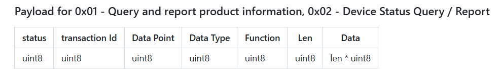

    So this Zigbee frame contains a TuyaMCU frame; even the data types match – 0x01 is a boolean, 0x03 is a string… we can try to parse it, starting with a filter for 0xEF00:
    Code: Python
    Then the actual parsing (of types 0x01 and 0x02 from the image):
    Code: Python

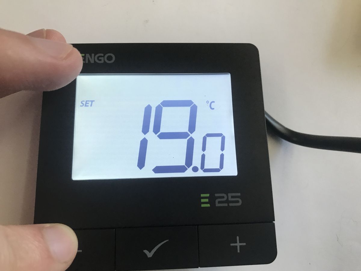

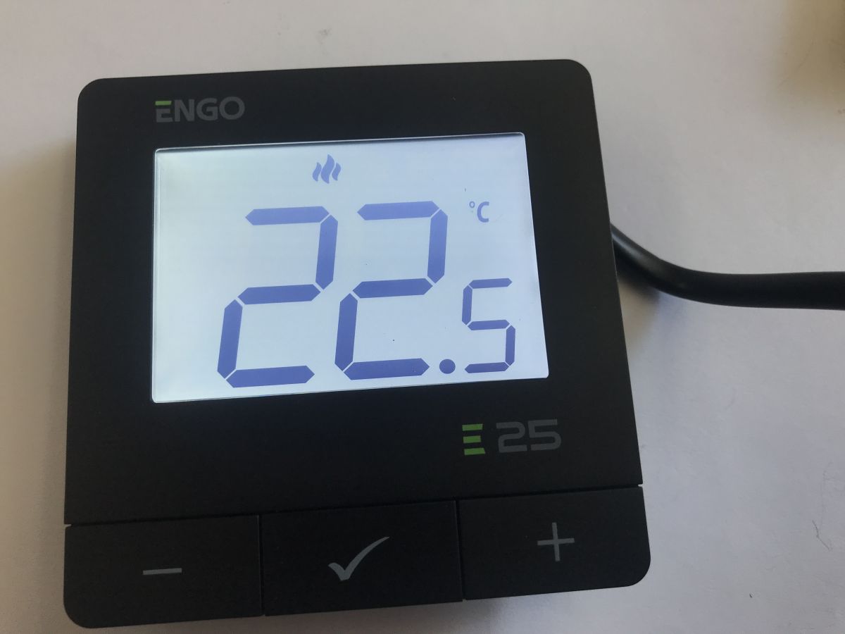

    Time for the final test – let’s heat up the sensor:
    It works – here’s the final confirmation. The temperature has risen to 24°C and the simple programme has read it correctly.
    📍 Device Network Addr: 0x5362
    📄 Raw Data (Hex)     : 096502006418020004000000f0
       -> [Tuya Data] DP ID: 24 | Type: 2 | Value: 240 (Raw Value)
