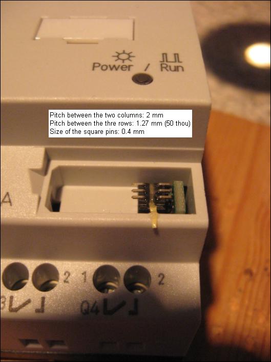

    I bought some EASY relays from ELFA and found a lot of useful information from your forum postings regarding the programming cable and the electronics. I am working on a schematic for the cable based on the information you provided at the forum, thank you for sharing. Regarding the strange connector, in my electronics collecting boxes I found some old 1.27 mm pitch header connectors i had bought from ELFA (see attached picture with item number and info) which actually fitted quite good regarding the dimension of the square pin (0.4 mm), and the pitch of the rows (1.27 mm) into the relay. But the dimention of the column spacing seems to be around 2 mm.
    I split my dual 1.27 x 1.27 header into single columns (very careful work using a sharp knife) and inserted the parts into the relay (see picture). Then I dropped two drops of epoxy in between the connector columns and the 1.27 x 2.00 mm connector is hopefully going to work.

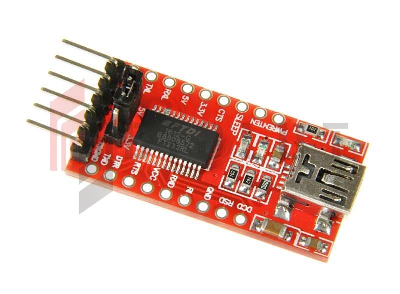

    Hello, I know that a lot of time has passed, but has anyone tried if it will work with a usb rs ttl adapter of this type:
    EASY 512-DC-R Driver: Creating DIY EASY-PC-CAB (Moeller) Cable with MAX232 Schematic
    connecting + 5V, GND, TxD, RxD?
  • #19 19669649
    lucastg
    Posts: 114
    Hello, if this particular one works, I do not confirm but personally I have been using the red ft232rl for several years without any problems.

    I confirm the operation, after connecting the TxD RxD and GND

    why can't I connect eas 512-AC-RCX?
    I use Prolific USB to serial. and connect
    RX - TX - GND.

    Codetrr wrote:
    pietrek345 wrote:
    I confirm the operation after connecting TxD RxD and GND
    why can't the eas 512-AC-RCX connect?
    I am using a serial Prolific USB To. and connect
    RX - TX - GND.
    TTL?

    usb to ttl?
  • #24 19858926
    pietrek345
    Posts: 192
    Rate: 12
    Yes. I've used one like this

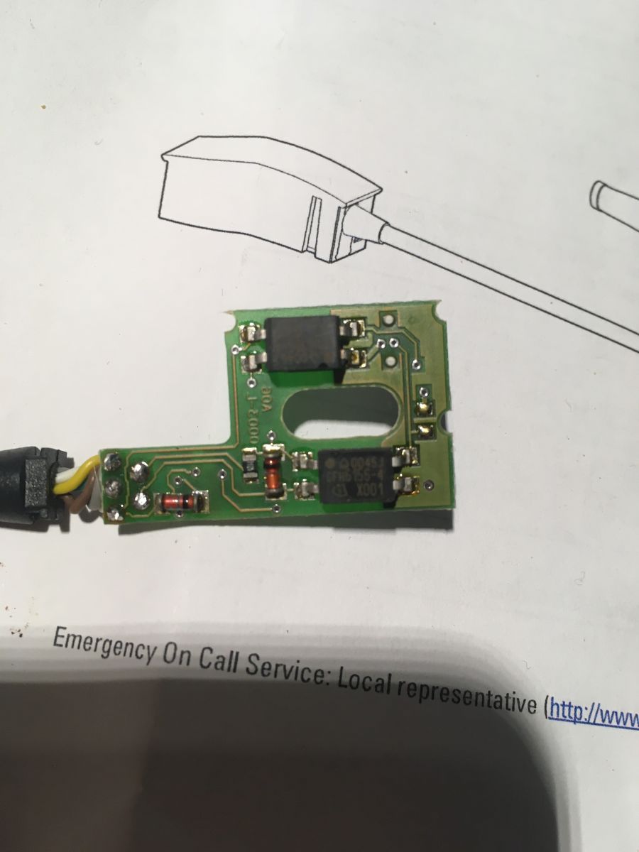

    info_serwis
    Posts: 37
    Hello. I have the cable in question and I am posting a photo of what it looks like inside. However, I have a request. There is no plug on the PC side (DB9). Does anyone have a list of which color to which pin? Or at least how to track GND? Thank you in advance.
    EASY 512-DC-R Driver: Creating DIY EASY-PC-CAB (Moeller) Cable with MAX232 Schematic EASY 512-DC-R Driver: Creating DIY EASY-PC-CAB (Moeller) Cable with MAX232 Schematic EASY 512-DC-R Driver: Creating DIY EASY-PC-CAB (Moeller) Cable with MAX232 Schematic

    It would be nice if you could draw a diagram of this tile to make it easier to identify the gnd.

    CH340 to TTL works well.
