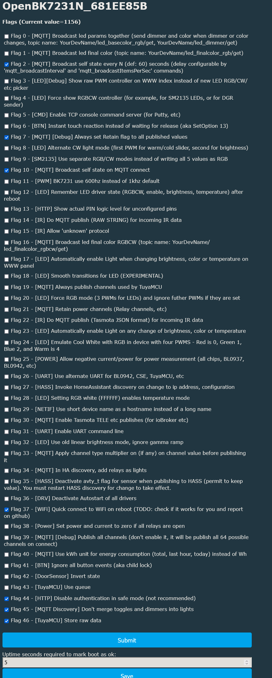

  • Flashing OBK with BK7231Flasher.exe worked easily, all GPIOs were recognized correctly, and the 433 MHz remote operated the three buttons.

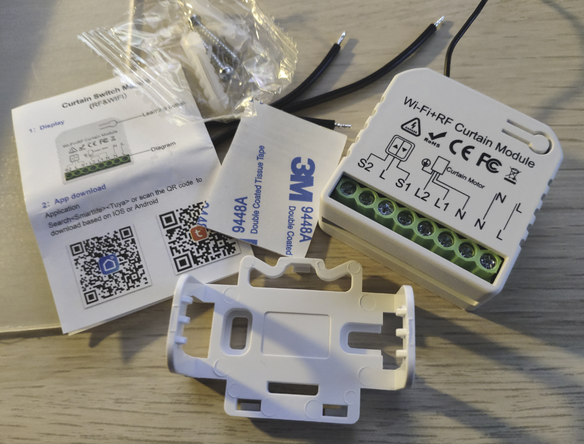

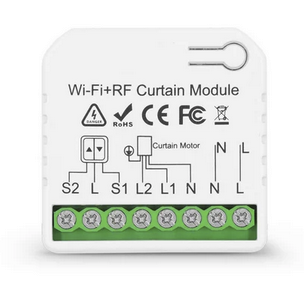

  • I bought a Wifi module with additional 433 MHz RF remote control from Aliexpress to be able to control our sunblind with HA.
    In contrast to the even cheaper models, it has eight instead of six terminals, so you don't need any additional connectors for the neutral conductor (and phase if you want to use the hardware buttons). This allows simpler, cleaner and safer cabling.
    WiFi+RF 433 MHz Module for Blinds with Remote on AliExpress
    The following was delivered w/o a box:
    Wi-Fi+RF curtain module with manual and accessories.

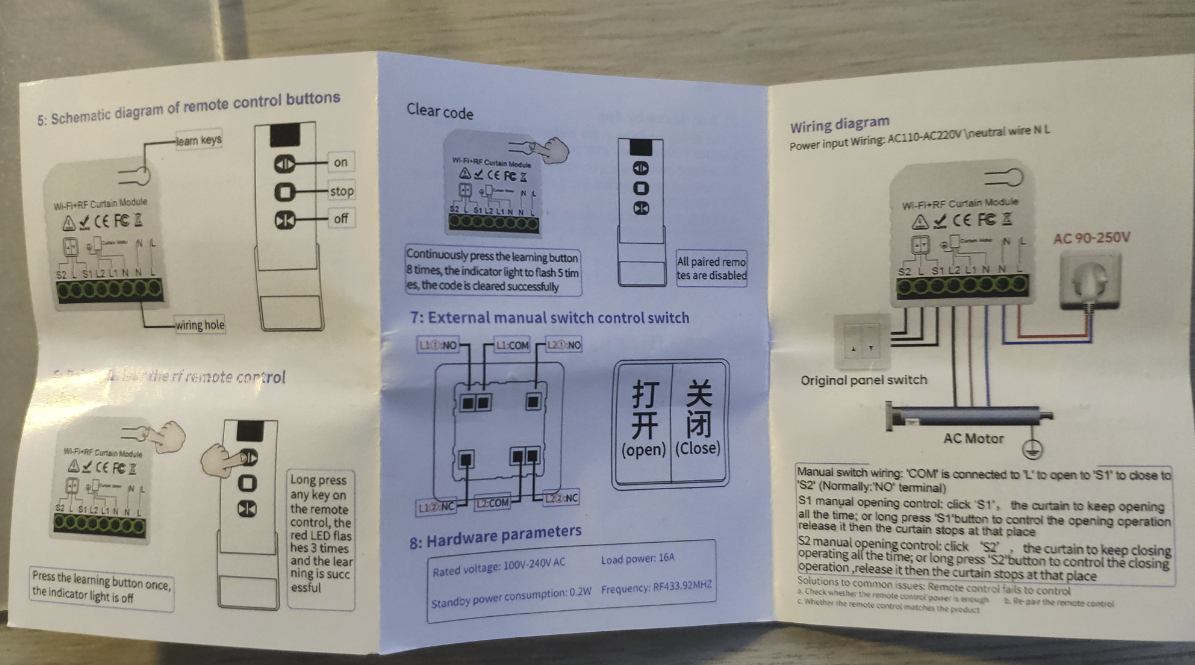

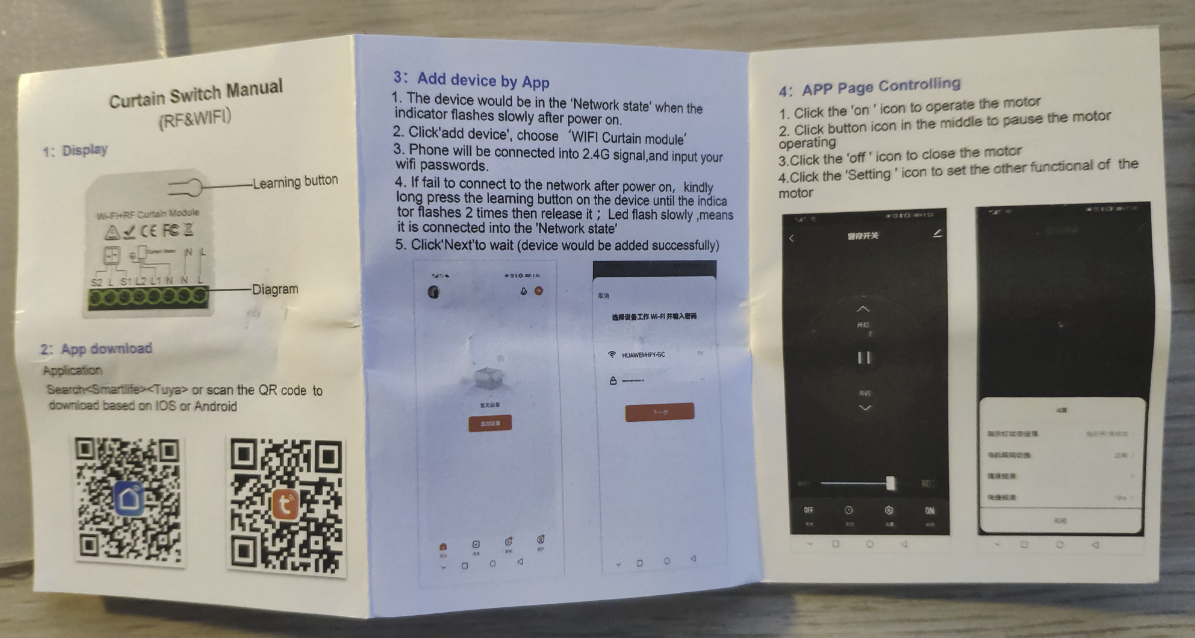

    Manual:
    Wi-Fi and RF curtain control module instruction manual Manual for WiFi module with RF 433 MHz remote control for blind operation.

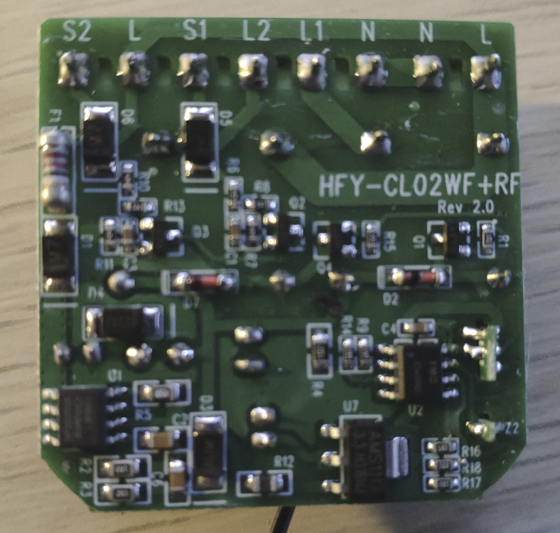

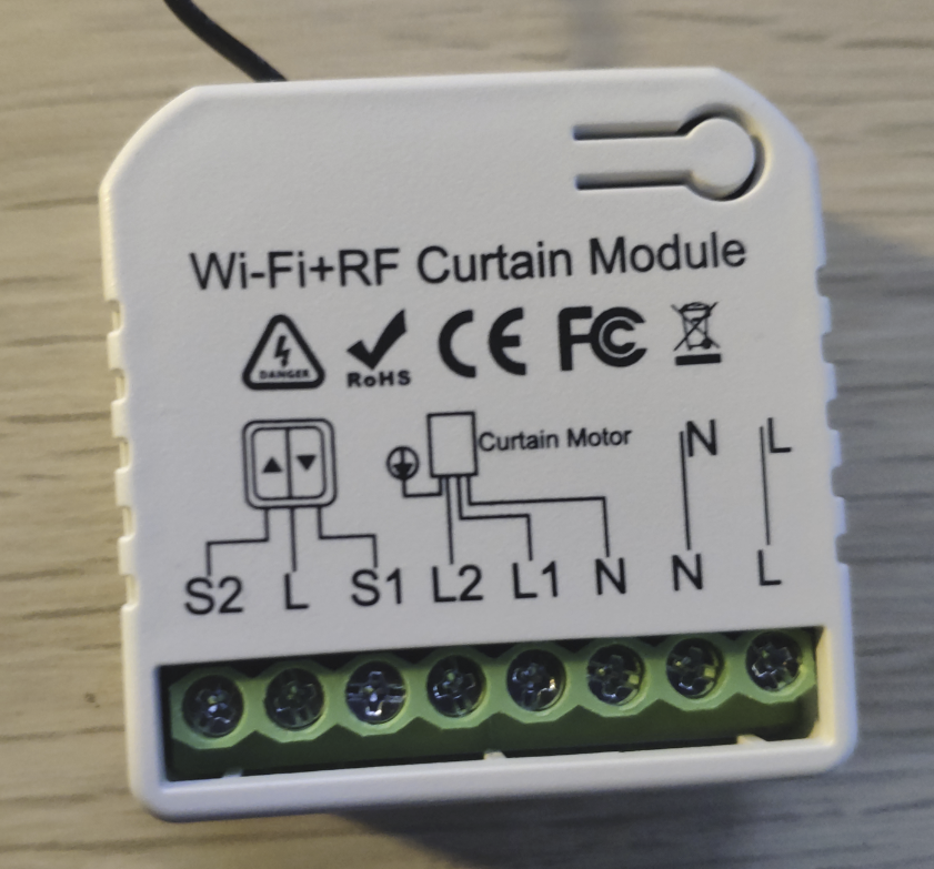

    The module from the outside and inside:
    Wi-Fi and RF curtain control module with visible connectors and labels. WiFi module with additional terminals and capacitors on the circuit board. Close-up of the PCB board of the HFY-CL02WF+RF Rev 2.0 module showing electronic components.
    Labelling on the board: HFY-CL02WF+RF Rev 2.0

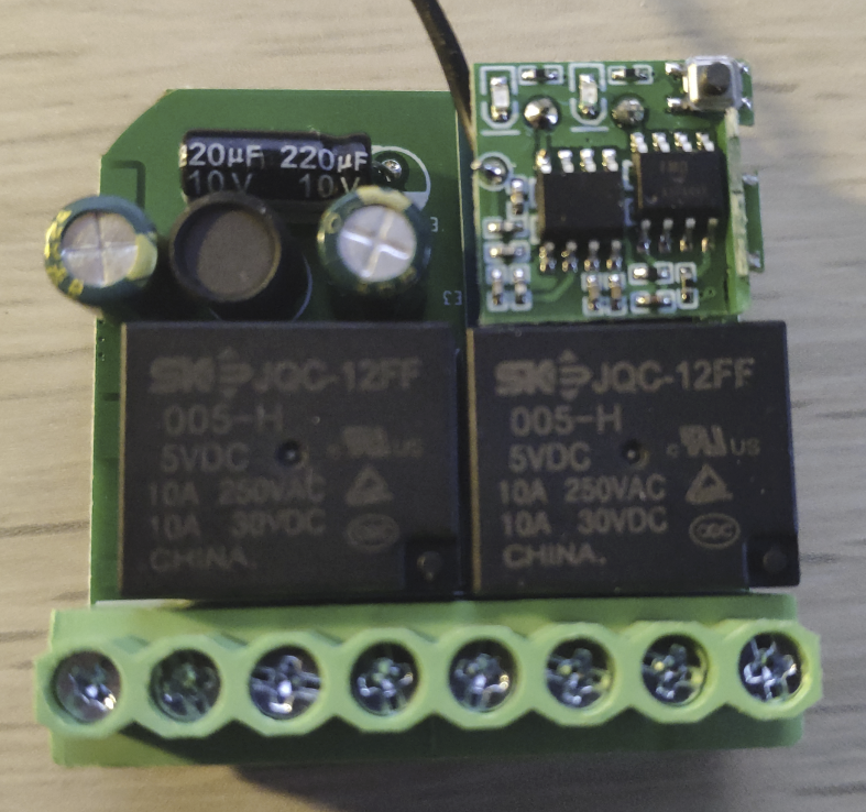

    The radio modules are stacked with a jumper board. The Wifi module is under the RF module, from the side it is visible that it is a CB2S.
    Close-up of an electronic module showing the label CBE, circled in red.

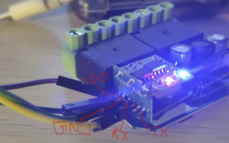

    The module does not have to be desoldered to flash OBK, the contacts are easily accessible on the jumper board. Flashing with BK7231Flasher.exe is very easy, even all GPIOs are recognised correctly.
    Close-up of a WiFi module with RF 433 MHz remote, showing GND, VDD, RX, and TX labels.
    The Pin layout is as follows:
    PinSetting
    6Relais 1
    7Relais 3
    10WifiLED
    23Button 2
    24Button 1
    26Button 3
    Configuration:
    I have entered the following autoexec.bat (I have copied the script from here):

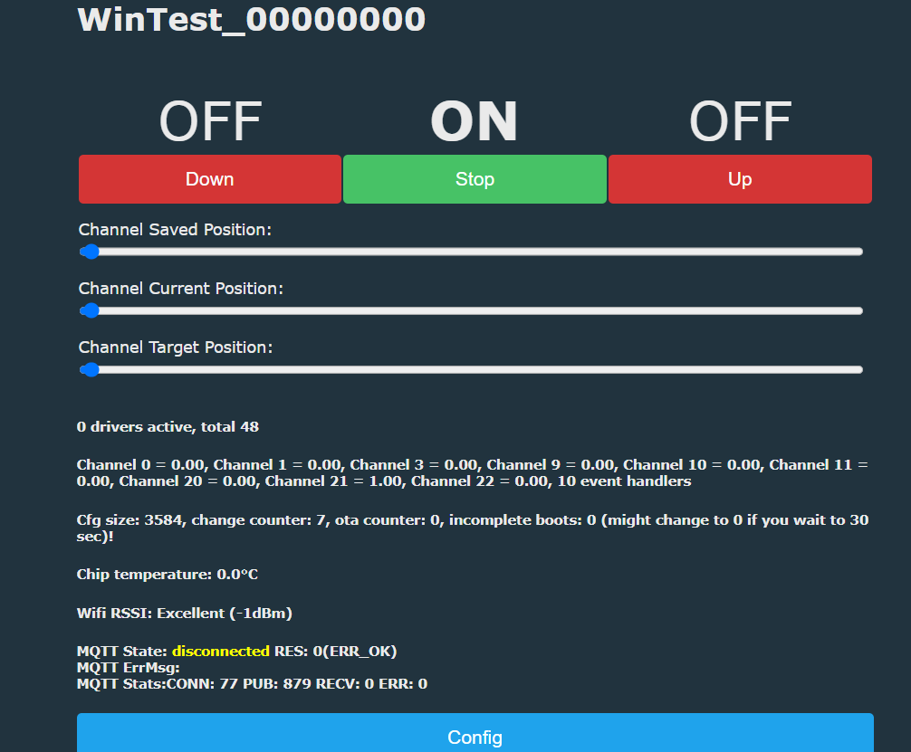

    Everything has worked wonderfully so far, the RF remote control works on the three buttons, so it can also be used. The control times in the script still need to be adapted to the respective roller shutter.
    I still have to work on a nice integration in Home Assistant. If anyone has any good advice on this, I would be happy to hear it.

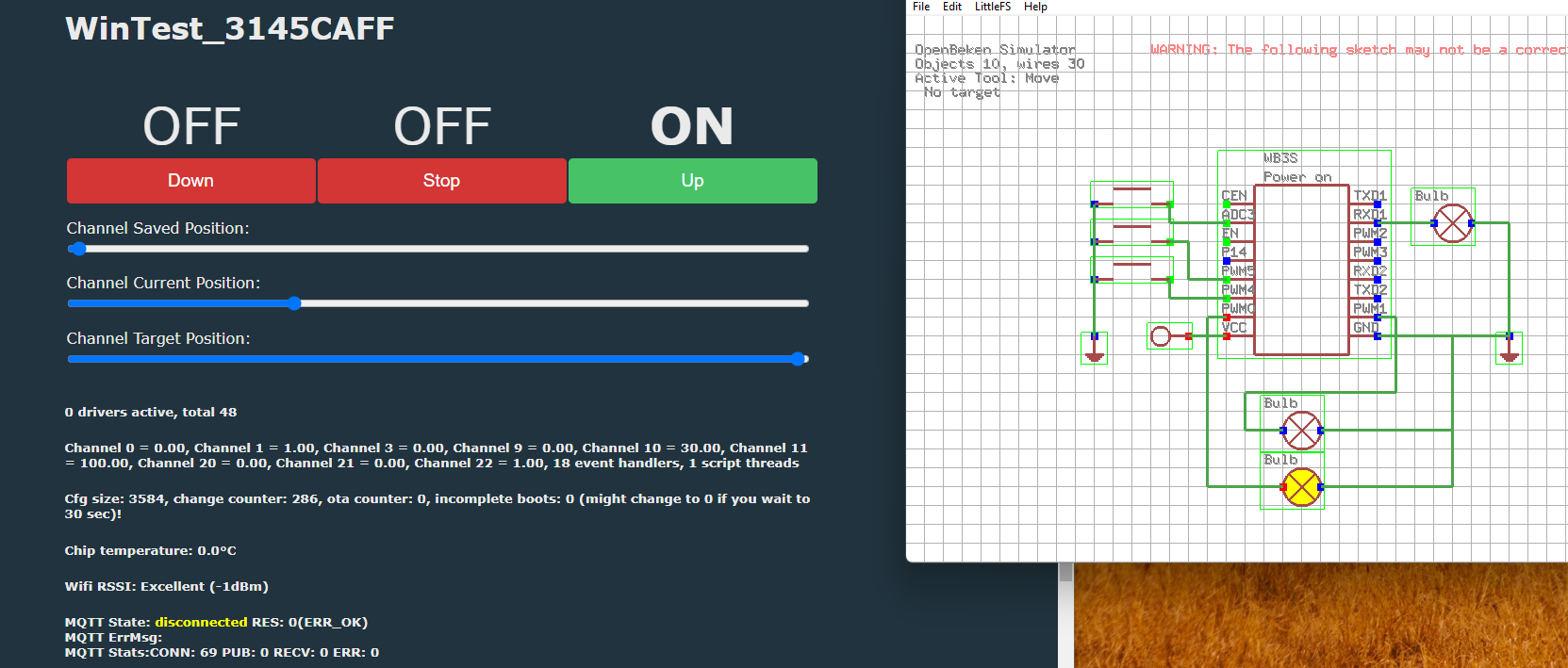

  • HA integration with custom curtain autoexec.bat
    #2 20910126
    rodionzhitomirsky
    Posts: 10
    Hi!
    Your post was very helpful in exploring the same device on my side! Thanks!

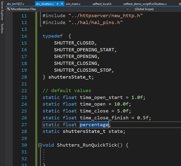

    I went a bit further and fully integrated it into the HA. Here is my autoexec.bat (it also sets up the Channels, but in a little bit different fashion):
    clearIO
    // ====== CONFIG ======
    // Used to hold the delay value in millis for sleeping during closing or opening loop
    // Play with your curtain and find the right value for this delay
    SetChannel 8 100
    // Delay to wait (millis) before starting to move the curtain after we close both relays
    // maybe it is not necessary, but I prefer it to be to ensure we do not have
    // both open and close relays powered simultaneously:
    SetChannel 7 500
    // MQTT stuff
    MqttClient lr_curtain_2
    MqttHost <YOUR_HA_MQTT_HOST>
    MqttUser <YOUR_HA_MQTT_USER>
    MqttPassword <YOUR_HA_MQTT_PASSWORD>
    // ====== END OF CONFIG ======
    // set channels 7, 8 and 9 to be private, so that we do not spend resources to publish their values:
    SetChannelPrivate 7 1
    SetChannelPrivate 8 1
    SetChannelPrivate 9 1
    // We start the main opening/closing loop with a delay
    // and than immediately have a calibration delay
    // so, let's decrement the calibration delay to not have them both
    // at the beginning of the loop:
    addChannel 7 -$CH8 0 5000
    PowerSave 1
    startDriver ntp
    // set pins and channels
    // Pin 6 is connected to opening relay
    SetPinRole 6 Rel
    // we also connect it to channel 1
    SetPinChannel 6 1
    SetChannelLabel 1 "Up"
    // Pin 6 is connected to closing relay
    SetPinRole 7 Rel
    // we also connect it to channel 3
    SetPinChannel 7 3
    SetChannelLabel 3 "Down"
    // 23 - stop button (virtual button emitted when open or close buttons are pressed for some time and then released)
    SetPinRole 23 Btn
    // 24 - opening button
    SetPinRole 24 Btn
    // 26 - closing button
    SetPinRole 26 Btn
    // CH9 - saved position for reboot
    // CH10 - current position
    // CH11 - target position
    SetChannelLabel 9 "Saved Position"
    setChannelType 9 Dimmer
    SetChannelLabel 10 "Current Position"
    setChannelType 10 Dimmer
    SetChannelLabel 11 "Target Position"
    setChannelType 11 Dimmer
    SetStartValue 9 -1
    // read position saved before reboot:
    SetChannel 10 $CH9
    SetChannel 11 $CH9
    // Setup LED:
    SetPinRole 10 LED
    SetPinChannel 10 4
    // ============= MQTT ============
    // Let it shine when MQTT connection is established:
    addEventHandler MQTTState 1 SetChannel 4 1
    addEventHandler MQTTState 0 SetChannel 4 0
    // [2] Always set MQTT Retain flag to all published values;
    // [7] Broadcast self state every N seconds:
    // [10] Broadcast self state on MQTT connect
    flags 1156
    // Inform HA about our values every 30 seconds, publish 2 values per second
    mqtt_broadcastInterval 30
    mqtt_broadcastItemsPerSec 2
    alias Set_Stop backlog setChannel 3 0; setChannel 1 0
    alias Start_Opening backlog stopAllScripts; startScript autoexec.bat openSkylight
    alias Start_Closing backlog stopAllScripts; startScript autoexec.bat closeSkylight
    alias Stop_All backlog stopAllScripts; startScript autoexec.bat stopSkylight
    alias Open_To_Target backlog stopAllScripts; startScript autoexec.bat openSkylightToTarget
    alias Stop_Clicked backlog Set_Stop; Stop_All
    // Click and fast release will effect in fully closing or opening.
    // If during this process we click on the same button again, it stops
    addEventHandler OnClick 26 if $CH03==1 then Stop_Clicked else Start_Closing
    addEventHandler OnClick 24 if $CH01==1 then Stop_Clicked else Start_Opening
    addEventHandler OnClick 23 Stop_Clicked
    return
    // === OPEN TO GIVEN PERCENTAGE ===
    openSkylightToTarget:
    	Set_Stop
    	delay_ms $CH7
    openSkylightToTarget_again:
    	delay_ms $CH8
            if $CH10<$CH11 then goto continue_opening
            if $CH10>$CH11 then goto continue_closing
    	// we are done, we reached our target
    	// If we were opening or closing fully, we let the motor
    	// run for 3 seconds for the case we are uncalibrated:
    	if $CH10==0 then goto calibrate
    	if $CH10==100 then goto calibrate
    	goto openSkylightFinished
    continue_opening:
            // Unset_Close
    	setChannel 3 0
            // Set_Open
    	setChannel 1 1
    	// increment:
            addChannel 10 1 0 100
    	goto openSkylightToTarget_again
    continue_closing:
            // Unset_Open
    	setChannel 1 0
            // Set_Close
    	setChannel 3 1
    	// decrement:
            addChannel 10 -1 0 100
    calibrate:
    	delay_ms 3000
    	Set_Stop
    	SetChannel 9 $CH10
    	return
    openSkylightFinished:
    	Set_Stop
    	SetChannel 9 $CH10
    	return
    // === CLOSE ===
    closeSkylight:
    	SetChannel 11 0
    return
    // === OPEN ===
    openSkylight:
    	SetChannel 11 100
    return
    // === STOP ===
    stopSkylight:
    	Set_Stop
    	SetChannel 11 $CH10
    	SetChannel 9 $CH10
    return

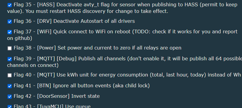

    Thanks for this. I have just bought the same module, and was relieved to find this thread.
    I have implemented your scripts, and the module is working mostly correctly when triggering it through HA, but the physical buttons to open/close the shutter are not working. After digging a bit, I saw that the Flag 41 - [BTN] Ignore all button events (aka child lock) is being set each time the module reboots.
    I noticed that your autoexec.bat sets flags to 1156 - I assume this is a bitmap of flags 2,7 and 10, which are also set - so I'm not sure what is setting the other flags:
    Screenshot showing a list of flags with settings related to module operation and publication in a home automation system.
    When I turn off Flag 41 and click the submit button, the physical switches now work, but after a reboot, flag 41 is turned back on.
    I'm new to OBK, and hope that someone here will be able to help me understand what it is that I've not set up correctly.
    Added after 1 [hours] 36 [minutes]:
    Hi Again,
    A bit more playing around and I saw that when I flashed the module, I used an older firmware: OpenBK7231N_QIO_1.17.308, after upgrading to OpenBK7231N_QIO_1.17.427 - Flag 41 is no longer set, so the buttons are working after a reboot of the module.
    Thanks again for your work on this module.
  • #6 20933040
    Posts: 14770
    Rate: 12913
    That's a very strange issue.
    I tried to replicate that in a self test:
    flags 1156
    here:
    https://github.com/openshwprojects/OpenBK7231...mmit/620df5ffe055e9e951d5bf2b5d323d3a0d28993b
    but it seems to work correctly. Only the expected flags are set. Can you provide more information how to reproduce your issue?
  • Flag 41 caused physical switch failure
    #7 20933371
    dawsonlebrown
    Sure, what I did was:
    using BK7231Flasher.exe 1.1.6 and with an identical "curtain module as in the OP", I clicked the "Do backup and flash new" button without having first downloaded the latest firmware and selecting it in the drop down list. The first fimware I downloaded was OpenBK7231N_QIO_1.17.308.bin - so each time I open the application, this is the default firmware selected in the "Select firmare:" drop down. ( perhaps it would be more useful if this defaulted to the most recent instead of the oldest firmware in the folder? - i'll raise an issue on github in case the devs agree with me :) )
    From memory, the steps I then followed were:
    Connected to the wifi hotspot of the board
    I then copy/pasted the json config from the OP - but as best as I can remember, I couldn't see how to upload this JSON to the module, so I selected the (Tuya) WiFi + RF Curtain Module (HFY-CL02WF+RF) option in the Devices list and used the Copy Device Settings button then Save Pins button to save the config to the module.
    I created an autoexec.bat file and copy/pasted the contents from the OP
    To configure it in HA, I then updatd my mqtt.yaml, scripts.yaml and config.yaml based on the followup post by rodionzhitomirsky. I had renamed my components from skylight to shutters, so after getting it to the point where the HA buttons would trip the relays, I installed the module - but could now only control the shutters by HA, and not the switch.
    I switched over to the autoexec.bat file supplied by rodionzhitomirsky - but could still only control by HA
    When I saw Flag 41 set, I tested unsetting it and straight-away the physical switch was working, but after rebooting the device, either by cycling power or by using the restart button in the web interface, the flag was reset - I also noticed that Flag 39 was set and indeed was sending a lot of noise to my MQTT broker.
    By the way, as you will have noticed in the pic I uploaded, Flags 35,36,37,39,41,42 and 43 were all set and seem to be automatically reset after each reboot. With the latest firmware now installed, flags 37,44,45 and 46 are all set and in the same manner are reset autmatically at each reboot.
    By the way, at the top of the flags screen, the current value is shown as 1156, even though these extra flags are shown as set further down the page - this was the same with the older firmware:
    Screenshot of flag settings for OpenBK7231N.
  • Flags 0 command triggers reboot issue in 1.17.432
    #8 20935106
    Angel0fDeath
    Posts: 118
    Rate: 33
    I found the same issue and reported here:
    https://www.elektroda.com/rtvforum/topic4022907-60.html
    However by me that occurs after issuing flags 0 command (to clear all flags)
    If I clear them manual,y, save and reboot they are not set back. Used firmware is 1.17.432
    About number in the flags page - also already reported. The number is counting only the first 32 flags. With all flags there will be overflow of int variable. Still not fixed. My suggestion was just to list active flags, since to decode this number you will need calculator, especially when few flags are set

  • Questions about OBK shutter state handling and UI draft
    #14 21353218
    Posts: 14770
    Rate: 12913
    I see... now, how should it be implemented in OBK? Can you make a draft (in Paint or on paper) of OBK web panel for shutter controller?
    What if there is a power outage during opening/closing? Should OBK remember current % and state in flash? Or should it somehow "reset" on reboot?
    Added after 9 [minutes]:
    GAAD wrote:
    because the first few seconds are for the lamels opening and after then the blind starts.
    GAAD wrote:
    1 - time for clearance before the bottom of the blind starts to rise
    GAAD wrote:
    1 - time for closing.
    So this extra time is only when shutters either begin to open or finish to close? And not when they stop opening and start closing...
    Added after 5 [minutes]:
    I've did such draft so far:
    Screenshot of source code in an editor showing shutter state definition and default values for opening and closing times.

    Hi,
    I’m trying to enhance the autoexec.bat file mentioned above. I’d like to add three buttons to the web interface that work in sync with the physical buttons, and I also want the physical buttons to affect the slider. My code is almost working, but I can’t get the stop button to synchronize with the end stops.
    Please help me solve this issue. See my autoexec below.
    Thank you in advance,
    Peter
    User interface for managing curtain positions with three buttons: Down, Stop, and Up.

    Hi, does anyone know if this .bat file still works in the new version? I have the simulator, and I configure the pinouts, create the autoexec.bat, save, and restart. The buttons don't appear correctly, nor do the maneuvers work. I'm a complete novice and would appreciate any help or guidance. Thanks.
  • Buttons appear in latest simulator build
    #19 21480083
    Posts: 14770
    Rate: 12913
    Hey I've checked with latest simulator and I guess buttons appears for me?
    I am referring to this autoexec.bat:
    https://www.elektroda.com/rtvforum/topic4015497.html#21362566
    Not the one in earlier post.
    See:
    Screenshot of the WinTest interface with control buttons.
    Built on Mar 14 2025 22:27:37 version Win_Test
    Online for 24 minutes and 59 seconds
    Device MAC: BA:DA:31:45:CA:FF
    Short name: WT00000000, Chipset WIN32
  • #20 21480170
    antonioriosarroyo
    Posts: 15
    Thank you so much for responding. That one works for me, but the stop button doesn't. That's why I was trying to use the other one.
  • Working BK7231N curtain control script with relay mapping
    #21 21482463
    antonioriosarroyo
    Posts: 15
    Hi @gliga69 , I've been looking and tweaking things, and it seems to be working now. It's not finished, but I'm leaving it here in case anyone improves it or needs it.
    I have no idea how to program; it's been trial and error. I'm not responsible...

  • Modified BK7231N curtain script with reactive slider and relay protection
    #27 21925923
    xionfr
    Hi,
    just thank @antonioriosarroyo, @rodionzhitomirsky and @gliga69 for your code. I modified it. Both the physical and web buttons work correctly, and the blind percentage seems great.
    Some optimisations, remove some wait, add protection on relay, and the slider is reactive (set the slider value to move)
    clearIO
    startDriver SSDP
    startDriver NTP
    PowerSave 1
    echo "Start program"
    // CH8  - Used to hold the delay value in millis for sleeping during closing or opening loop ( Play with your curtain and find the right value for this delay)
    SetChannel 8 453
    // MQTT stuff
    // MqttClient OpenBK7238_7A411925
    MqttHost 192.168.1.4
    MqttUser anonymous
    MqttPassword anonymous
    // ====== END CONFIG ======
    // set channels 8 and 9 to be private, so that we do not spend resources to publish their values:
    SetStartValue 9 -1
    SetChannel 10 $CH9
    SetChannel 11 $CH9
    // set pins
    // P26 / Relay (channel 1) Up
    // P6  / Relay (channel 3) Down
    // P9  / Button (no channel ) Down / closing
    // P1  / Button (no channel ) Stop
    // P24 / Button (no channel ) Up / opening
    // P10 / LED
    // opening relay // we also connect it to channel 1
    SetPinRole 26 Rel
    SetPinChannel 26 1
    //setChannelType 1 Toggle  // For THE TEST without PIN
    setChannelVisible 1 0  // Hide relays from GUI
    // closing relay // we also connect it to channel 3
    SetPinRole 6 Rel
    SetPinChannel 6 3
    //setChannelType 3 Toggle   // For THE TEST without PIN
    setChannelVisible 3 0  // Hide relays from GUI
    // down / closing button
    SetPinRole 9 Btn
    // stop button
    SetPinRole 1 Btn
    // up / opening button
    SetPinRole 24 Btn
    // set channels
    setChannelType 20 Toggle
    SetChannelLabel 20 "Down"
    setChannelType 21 Toggle
    SetChannelLabel 21 "Stop"
    setChannelType 22 Toggle
    SetChannelLabel 22 "Up"
    SetChannel 21 1
    // Setup LED:
    SetPinRole 10 LED
    SetPinChannel 10 4
    SetChannel 4 0
    setChannelVisible 4 0  // Hide  from GUI
    //addEventHandler MQTTState 1 SetChannel 4 1
    //addEventHandler MQTTState 0 SetChannel 4 0
    flags 1156
    // Alias
    alias Set_Down  if $CH03!=1 then backlog setChannel 1 0; delay_ms 100; setChannel 3 1;
    alias Set_Stop  backlog setChannel 1 0; setChannel 3 0;
    alias Set_Up    if $CH01!=1 then backlog setChannel 3 0; delay_ms 100; setChannel 1 1;
    alias Start_Closing  backlog stopAllScripts; startScript autoexec.bat closeSkylight;
    alias Stop_All       backlog stopAllScripts; startScript autoexec.bat stopSkylight;
    alias Start_Opening  backlog stopAllScripts; startScript autoexec.bat openSkylight;
    alias Open_To_Target backlog stopAllScripts; startScript autoexec.bat openSkylightToTarget;
    alias Stop_Clicked backlog SetChannel 21 1; Stop_All;
    // Handler
    // Down / Close event
    addEventHandler OnClick 24 SetChannel 20 1
    addChangeHandler Channel20 == 1 if $CH03==1 then Stop_Clicked else Start_Closing
    // Stop event
    addEventHandler OnClick 1 SetChannel 21 1
    addChangeHandler Channel21 == 1 Stop_All
    // Up / Open event
    addEventHandler OnClick 9 SetChannel 22 1
    addChangeHandler Channel22 == 1 if $CH01==1 then Stop_Clicked else Start_Opening
    // Target change
    addEventHandler OnChannelChange 11 Open_To_Target
    // Button change status event
    addChangeHandler Channel20 == 1 backlog SetChannel 21 0; SetChannel 22 0
    addChangeHandler Channel21 == 1 backlog SetChannel 20 0; SetChannel 22 0
    addChangeHandler Channel22 == 1 backlog SetChannel 20 0; SetChannel 21 0
    // protection relay
    addChangeHandler Channel1 == 1 setChannel 3 0
    addChangeHandler Channel3 == 1 setChannel 1 0
    return
       // run for s seconds for the case we are uncalibrated:
       if $CH10==0 then delay_ms 3000
       if $CH10==100 then delay_ms 3000
    continue_opening:
       Set_Up
       // increment:
       goto openSkylightToTarget_loop
    continue_closing:
       Set_Down
       // decrement:
       Set_Stop
       SetChannel 21 1
       SetChannel 9 $CH10
       return
    // === CLOSE ===
    closeSkylight:
       SetChannel 11 100
    return
    // === STOP ===
    stopSkylight:
       Set_Stop
       SetChannel 11 $CH10
       SetChannel 9 $CH10
    return
    // === OPEN ===
    openSkylight:
       SetChannel 11 0
    return
