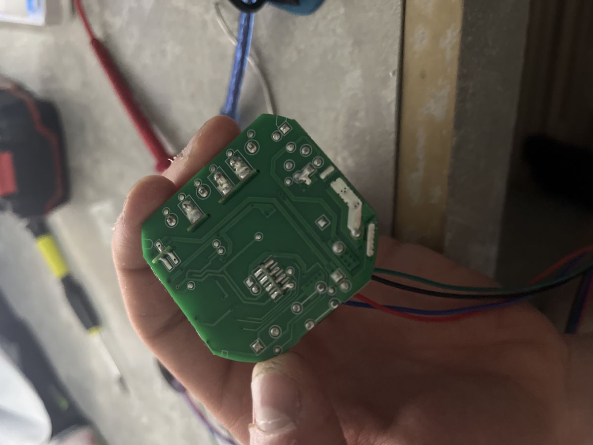

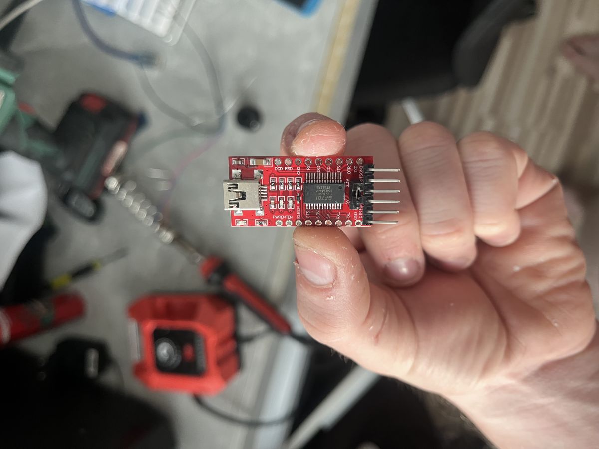

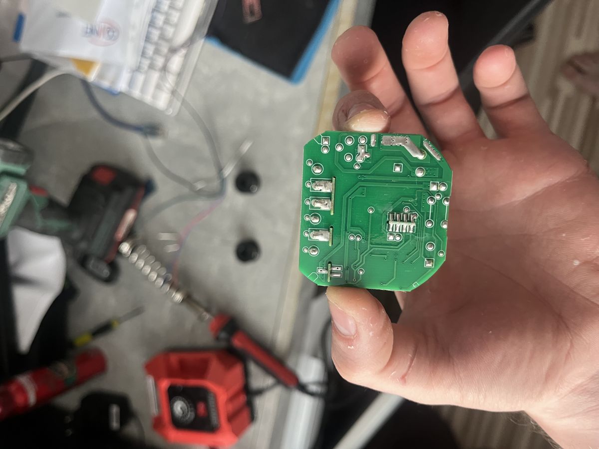

    Hello. I bought MOES MS-104B s WB2S and I need to link it to TTL FT232RL but idk how to connect it. I need to flash the Moes switch with OpenBK7231T to work it with Shelly plus 2PM
    Wiring MOES MS-104B s WB2S to TTL FT232RL for OpenBK7231T Flashing
    AI: Do you know which pins on the MOES MS-104B s WB2S are TX, RX, GND, and VCC for connecting to the FT232RL?
    no
    AI: Is your FT232RL set to 3.3V or 5V, and do you know what voltage the MOES MS-104B s WB2S needs for flashing?
    yes
  • #2 21577832
    Posts: 14622
    Help: 655
    Rate: 12641
    Can you show the lower side of the board?
    Well, the most reliable approach includes desoldering the daughter board with WB2S... but maybe we could flash without it. It depends on whether RX/TX pins of WB2S are used.

  • #4 21577937
    Posts: 14622
    Help: 655
    Rate: 12641

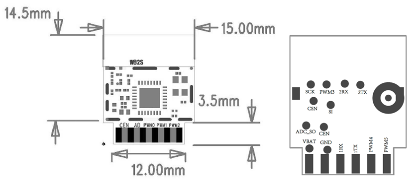

    WB2S RX/TX is on the bottom side, so not visible from the top of the board:
    Maybe try desoldering here first? Use flux and solder wick?

  • #8 21578303
    Posts: 14622
    Help: 655
    Rate: 12641
    You need use RX, TX, GND and 3.3V, just like on the video. Let me know if you have any specific questions.

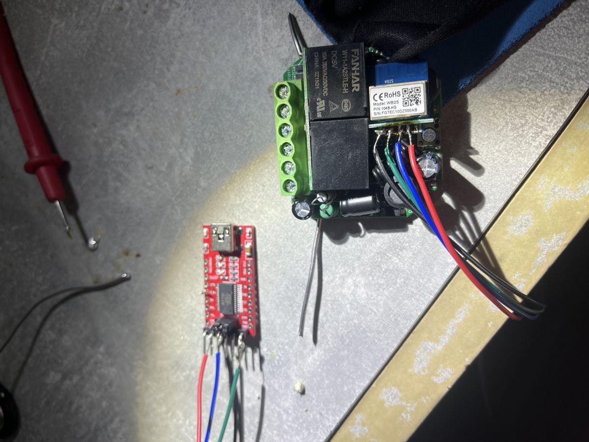

  • #9 21578611
    dominikgaspar123
    Posts: 10
    I hope I did it correctly Wiring MOES MS-104B s WB2S to TTL FT232RL for OpenBK7231T Flashing
  • #10 21578633
    Posts: 14622
    Help: 655
    Rate: 12641
    I am afraid this is incorrect. You've soldered to wrong side of the module. Check my previous post. You soldered to: CEN, AD, PWM0, PWM1.

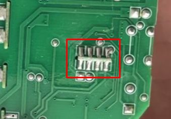

  • #11 21578636
    dominikgaspar123
    Posts: 10
    Then where are they
  • #12 21578655
    Posts: 14622
    Help: 655
    Rate: 12641
    I don't know this particular converter board. I would desolder it from main board along with WB2S and then flash.

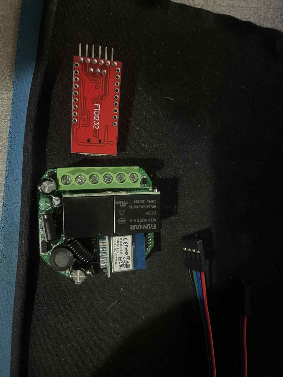

  • #13 21578657
    dominikgaspar123
    Posts: 10
    Am gonna give it a try I will desolder it, thank you for helping

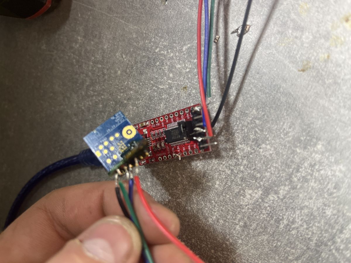

    Added after 1 [hours] 6 [minutes]:
  • #14 21580195
    Posts: 14622
    Help: 655
    Rate: 12641
    The photo is a bit blurry, but it's better than before. Make sure to connections are correct. Do not accidentally swap wires. Also, you should not solder to USB to UART converter pins...
    Futhermore, flashing procedure requires you to disconnect and reconnect 3.3V quickly, how will you do it with wires soldered? Hm
  • #15 21580235
    dominikgaspar123
    Posts: 10
    I fixed it, chatgpt helped me. And now it's working very well. Thank you so much for your help

  • #17 21580243
    dominikgaspar123
    Posts: 10
    It worked through USB, no problem. I already installed it on the ceiling and the switch is working good
