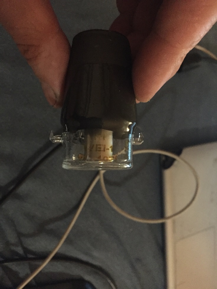

    Posts: 8

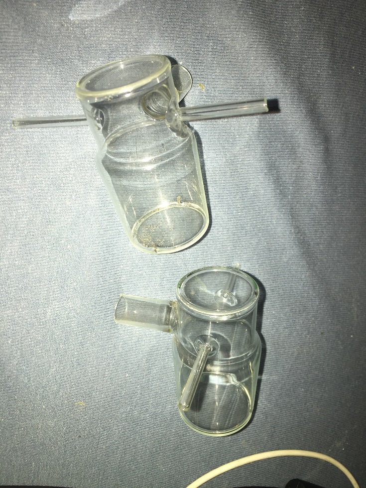

    Fortunately, silicone is relatively soft. Unfortunately, it breaks into thousands of pieces when removed. But it should be removable.

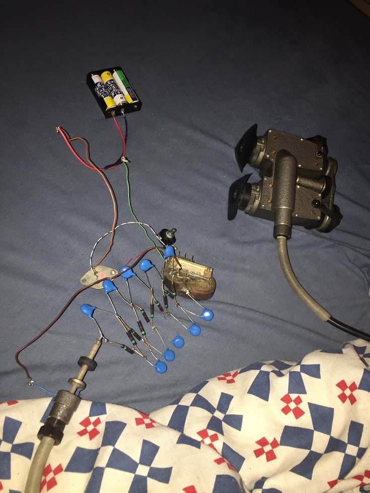

    The question is, what caused the problem? Never had this problem before!
    At the very beginning, shortly after I purchased it, I operated it on 12 volts for a while. Later I noticed that it is only allowed for 6 volts. But in theory, that doesn't destroy the insulation, right?
    Unfortunately, the current problem also occurs at 6 volts.
    Should I try to remove the old silicone and replace it with a new one? And what exactly is this silicone for insulation called. Here in Germany, I have not yet been able to find a suitable one on the Internet.
    Any ideas how can I measure the high output voltage? I just have a normal multimeter up to 250 volts here.

    @NiclasLindner Does it pierce with or without the lamp connected? Connect the lamp and gradually increase the voltage to obtain a correct picture. I guess that's about 4-5 volts.
    Why not ??? Voltage increase at the inverter output! Old, cracked silicone!
    Yes, only before that this arc (spark) could create a carbon path on the PCB. You need to clean it thoroughly.
    Search - "Hochspanung proof silicone gel". They are for sealing cable joints.

    I measured it once. Lightning came from around 3V at the entrance. This can't be normal.
    But now there is probably one more, much bigger problem.
    I was just about to read the input current. Exactly the same test settings as when shooting the movie. This means 6V at the input, optics as a load at the rear. In addition, a thin wire from the minus at the input to the shielding of the high voltage cable. Exactly the same goddamn deal.
    And suddenly ... ... the battery is on ... It burns one of the tracks on the board ... I cut off the power as soon as I could.
    Then I quickly measured it with a multimeter - now it seems that there is a short circuit at the input between positive and negative ...
    I have no idea why, no idea why or especially why, now. Tried this setting dozens of times, nothing happened ...
    That's annoying...
    I don't think I can fix this board anymore. Only a new construction remained.
    Theoretically, it is not difficult to build something like this. With the help of the Internet, I came up with a diagram. My only concern is that high voltage cascades at the 15kV output with too much current could kill me. As a layman, the risk is too great for me without an accurate and proven expert circuit.

    I do not know what the properties of this power supply are - whether it has output voltage stabilization or not. If not, then plugging in a higher voltage battery likely created higher voltage and breakdown - however, usually the breakdown reserve is assumed to be large enough that if the silicone were new it would not have happened. But if it was old, if there were cracks in it, it could have happened - especially cracks, even microscopic ones, are of great importance because they make the electric field locally stronger (just like a blade).
    There are several readily available materials that are good insulators - paraffin, rosin, probably also celluloid and polystyrene. The first two can be melted and poured, besides the paraffin dissolves in gasoline, you need to be careful with rosin, because at a temperature slightly above the melting point, it starts to char and the insulation properties deteriorate, and both must be very clean so that they insulate well and withstand high temperatures. tension; I think celluloid dissolves in acetone, polystyrene also dissolves in something. Probably the easiest way is with paraffin, but it must be clean, bought in a chemical store, and not from a paraffin candle (such a candle usually has impurities and it insulates much worse). But "hochspannung gel" should be better. One of the best insulators, but generally impractical, is sulfur (unfortunately it is corrosive to metals so cannot be used). Teflon is good, but you won't flood the system with Teflon.
    As for PNW-57 - make sure that it will not be overloaded.
    Voltage measurement: basically you need a resistor (or resistor array) that can withstand this voltage. Up to 3kV, I used a few (I don't remember, I think 6) 10M resistors (probably 1/2 W or 1W) connected in series. But be careful with their placement on the board - it must provide good insulation. And you need to determine how many resistors you need not to exceed the permissible voltage (for resistors there is some acceptable voltage, with such a high resistance, the power is "fictitious" - supposedly 3kV at 10M will give 0.9W power, but the 10M 1W resistor cannot be connected to 3kV , it will destroy it - the permissible voltage is specified in the catalog note). And you need to know which output the high voltage is at - it's not like the "voltage" and "ground" outputs are equivalent, "ground" may not have good insulation. Measure the current flowing through these resistors and calculate the voltage.
    Note: it is better not to connect the resistors to a working power supply, but before turning it on - charging the mounting capacities may break the resistor. Can I do so that there are (small) capacitances parallel to the resistors - so that when the voltage suddenly changes, it is transferred evenly to all resistors? But then this voltage change will give a current impulse to the meter, you need to protect it somehow, e.g. by connecting a capacitor (not so small) to it between its terminals.
    In general, the technique of 15kV voltages is difficult - some conductor may discharge into the environment (into the air) because it is too thin.
    Do you have information about the current you need to power this lamp? The current below 1mA should not be felt (it does not matter from what voltage), but touching the capacitor charged to 15kV you will probably feel a lot already at a capacity of e.g. 100pF.

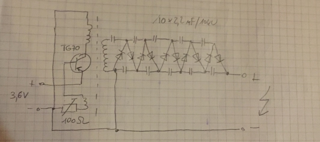

    I quickly put together such a layout as in the pictures. Horizontal deflection transformer from the Soviet TV Junost 402W. Transistor - historic germanium TG70 (ADP670). Diodes - I know the type, some high voltage. I chose the number of duplication levels for the best image. I don't know what condition I have these converters in, so the high voltage value may not be optimal for the better ones. The advantage of the system is that with higher irradiation the accelerating voltage decreases, which to some extent protects the transducers against damage in the case of strong lighting.

    @NiclasLindner Due to the principle of operation, these "tubes" consume from almost zero (dark current) to a dozen or so microamperes, i.e. a few watts.
    PNW-57 night vision device – can new electronics be built?
    @AlekZ Turn on the microammeter in the negative multiplier lead and you will know.
    Repeat :!: - Miniature converters are available to power CCFL lamps to illuminate LCD matrices. Such a converter has an output of approx. 3-4 kV AC, with a frequency of approx. 60 kHz. It is enough to add a three-stage duplicator. The whole, with proper assembly, takes up the space of a matchbox. I did it myself once, but the power supply has to be filled with paraffin due to the high voltages.
    https://pl.aliexpress.com/item/32418968693.html

    You don't need to measure. I know from my own experience that microamps will flow there. Anyway, it results from the sensitivity of typical photocathodes (here, probably, polyalkaline is used). After turning off the power of the converter, the image is visible for quite a long time, although - of course - it gets darker and darker.
    There are two possible production sites for WEI 1 transducers in Poland. It could have been a branch of the Industrial Institute of Electronics in Warsaw (ul. Ciołka 8) (then OBREP), ul. Długa 44/50 in Warsaw or the Wrocław branch of PIE (ul. Grabiszyńska) (then OW OBREP).
    The production of night vision transducers was discontinued after 1990. Where did this information come from? When I came to work at ul. In the long one, I found empty folders with titles. There were image sensors there, including cascade ones. This means that several drivers were put together to provide more amplification. Here is the screen of the first one illuminating the photocathode of the second, etc. On Dluga Street I also found an unfinished converter, probably WEI 3 larger than WEI 1. It was military production, hence probably the contents of the files were destroyed and only the covers remained.
    There are also unfinished pickups of another type (they are in one cabinet), which were certainly made at ul. Długa.
    Oral reports of employees say that these converters were previously made at ul. Ciołek.
    I got a bag of unfinished converters from Wrocław. It seems, however, that they were some samples. They do not contain a focusing system, which cannot be mounted anymore - both glass panes are already there, and the electrodes of the focusing system cannot be inserted through the side tubes.
    A few days ago I received an unused WEI 1 converter in a box. The production date is August 1971, so the production is still PIE.

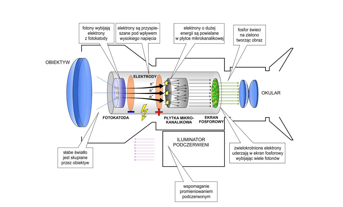

    One more thing: the drawing shown by the user Krzysztof Kamieński does not apply to the WEI 1 converter. This converter is of an older generation and does not have a microchannel plate. As far as I know, it was one of the reasons for the end of the converter production. We have not been able to make such a PCB, and drivers like the WEI 1 have simply become obsolete.
    The diagram of the lamp does not show the focusing electron-optic system and calls it phosphorus phosphor, which is not correct in Polish.

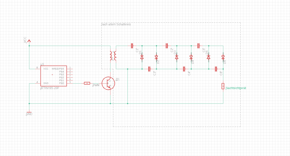

    I designed some schematic in Eagle. I have combined all your suggestions into one big one.
    My plan was to use the old transformer from the now broken night vision goggle. This is the easiest and most hassle-free way for me. Let's see if it needs to be cast in epoxy if necessary.
    I used Attiny-85 as a clock generator. I don't know yet if it's fast enough. Needs to be replaced with a faster chip if necessary (or I'll build a Royer circuit).
    I can test the high voltage for a night vision device with different multipliers and increase it bit by bit (as said @AlekZ ). So I can look experimental for what's best. Besides, I could save myself on measuring.
    You think it could work that way? So far, I have not found such an approach on the Internet.

    I do not know if it is worth using a microcontroller here. Moreover, it may be sensitive to a relatively strong electric field from the high voltage part.

    The NE555 could be used as a generator of the signal controlling the transistor - it gives a higher output current, it can switch the transistor faster, this will reduce the switching losses.
    When switching off the transistor in the primary winding, high voltage is generated (the leakage inductance plays a role here) - it is advisable to use a circuit that will limit it, so that it does not damage the transistor (and bipolar transistors are more susceptible to damage in such a way, for MOSFETs usually stated what pulse energy they can withstand).
    The secondary winding has a certain capacity which, at a low load current, will be important for the operation of the system. The duty cycle of the inverter is as follows:
    * when the transistor is turned on, the primary winding current increases; in the multiplier system, some diodes are conductive (in a system with one diode, they are not conductive);
    * when the transistor is turned off, a high voltage pulse appears on the collector from the leakage inductance of the transformer; at this time, the primary winding current decreases quickly, and the secondary winding increases rapidly, initially charging its capacity;
    * after charging the capacity of the secondary winding to the appropriate voltage, some diodes (or a diode, because there are versions with one) start to conduct, charging the capacitor (s), and the current begins to decrease (in this cycle, in the version with a multiplier, there are two states in which the diodes conduct - sets of conductive diodes in both states are disjoint);
    * when the current approaches zero, the diodes stop conducting; the charged capacity of the winding contains the energy that remains in the winding system (its inductance and capacitance form a resonant system) - it oscillates;
    * it would be best if within these oscillations the voltage across the collector of the transistor would reach zero (the primary voltage was equal to the supply voltage but had the opposite sign) when the current within these oscillations passes through zero, and at this point the transistor was turned back on (if when the transistor is turned on, the voltage at its collector is zero, so we avoid losses caused by charging the winding capacitance).

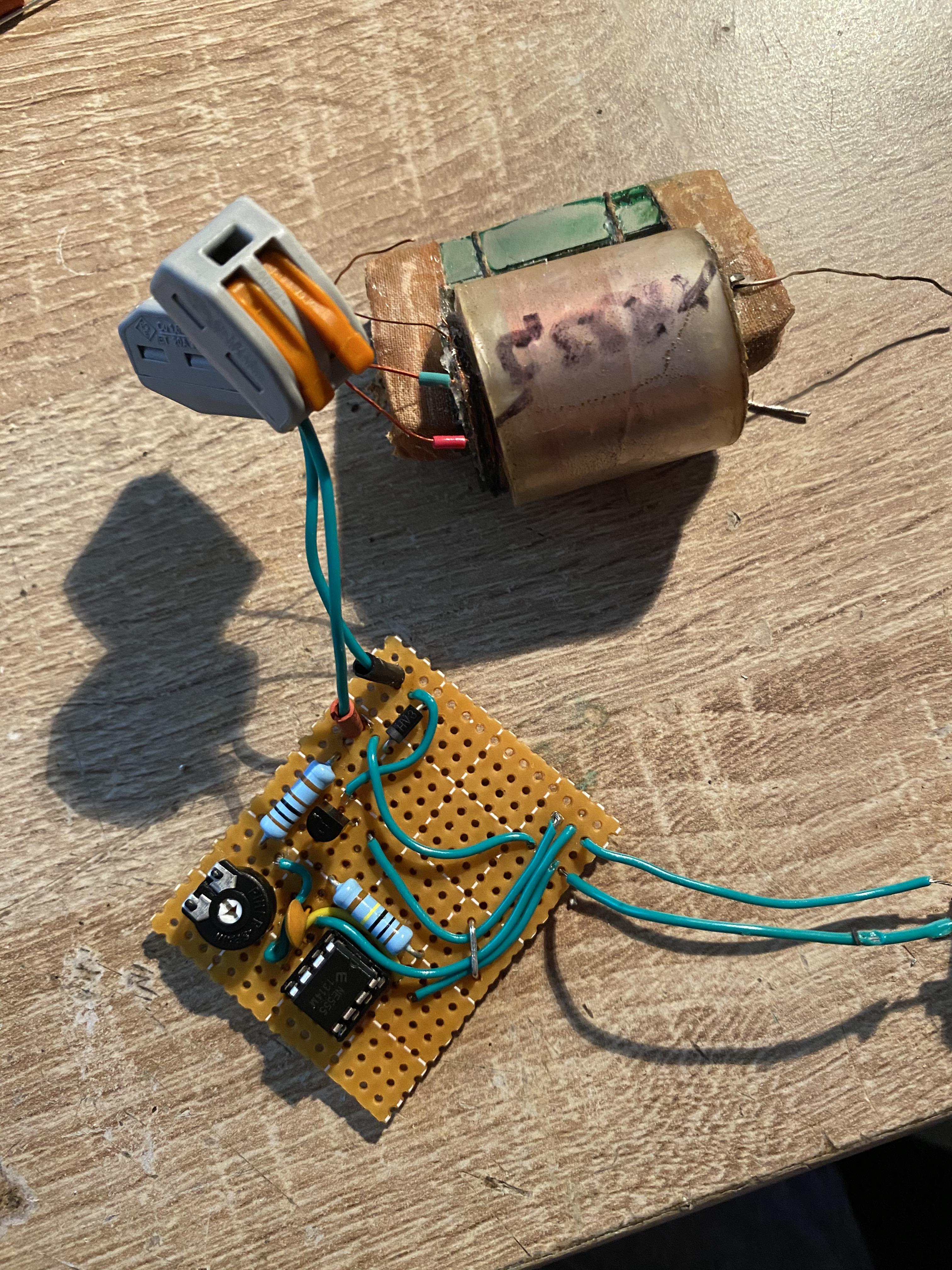

    thank you for your constructive feedback and ideas. Now I just built a circuit from your suggestions and simulated it in LTSpice.
    Today the parts have been delivered. Originally I wanted to etch the board for the low voltage part - but on the bread board I figured it would be faster and easier for something so small.
    It's all over for a few minutes - it even works amazing!
    As a transformer, I took the original transformer from the original high-voltage block. It directly converts 6V to 5kV.
    On the low voltage side, I decided to use a 555-Timer. Together with the transistor and diodes protecting the circuit, the whole thing is even quite small and compact.
    Thank you so much for help!

  1. Salvage the USB plasma-ball driver; its secondary gives ≈5 kV from 5 V input.
  2. Feed that node into a 4-stage capacitor-diode multiplier using 27 pF / 3 kV SMD caps and 5 kV DO-15 diodes [Elektroda, krakowmichal, #14970418; #15045979].
  3. Run the board on 3 V (2 × AA) to land at 14 – 18 kV. Space parts >6 mm or arc-over occurs [Elektroda, krakowmichal, post #15028993]
One eyepiece is brighter than the other—can I equalise it?
You cannot trim gain electrically; each tube’s photocathode ages differently. Swapping tubes left-to-right confirms the culprit. Replace the dim tube or live with the mismatch; lowering supply voltage darkens both [Elektroda, Dolby*, post #3436157]
Are PNW-57 and NS-71 tubes interchangeable?
Yes. WEI-1 tubes from a PNW-57 can replace a failed NS-71 unit, provided wear levels match; mismatched gains hurt image quality [Elektroda, harrymx1, post #18968552]

Quick 3-step guide to adding more multiplier stages?
  1. Add one 27 pF / 3 kV cap and one 5 kV diode per extra stage.
  2. Maintain capacitor-to-diode orientation identical to the previous stage.
  3. Re-check output; each stage raises peak DC by the AC input amplitude [Elektroda, krakowmichal, post #15028993]
Can I drive the stock transformer with an NE555?
Yes. Set NE555 as astable at 20 – 30 kHz, 50 % duty. Use a power BJT or logic-level MOSFET plus snubber across primary. dj_volt revived a dead PNW-2 this way [Elektroda, dj_volt, post #15045636]
