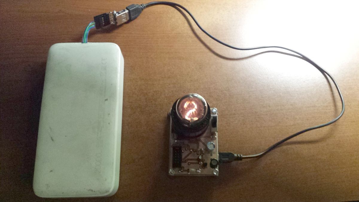

  • A pocket USB-powered tester checks DOLAM LC-513 and resin-based LC-516 Nixie tubes before purchase, allowing flea-market use from a power bank.
  • An ATmega8 both multiplexes the tube cathodes and regulates a 5 V-to-180 V boost converter through ADC voltage feedback; USB also provides PC telemetry.
  • The boost stage runs PWM at 31.2 kHz with an 85% duty cycle and delivers approximately 1.2 mA maximum current.
  • The tester cycles digits automatically or holds a selected digit manually, while PC readings can identify cathodes that fail to light or draw excessive current.
  • A few initially sluggish digits usually recover after several seconds due to cathode poisoning; the LC-516 socket also requires inconvenient insertion force.

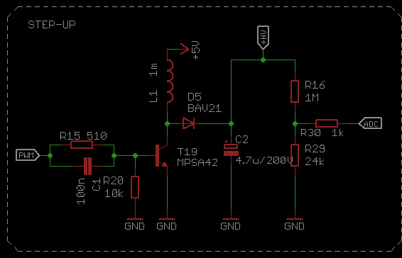

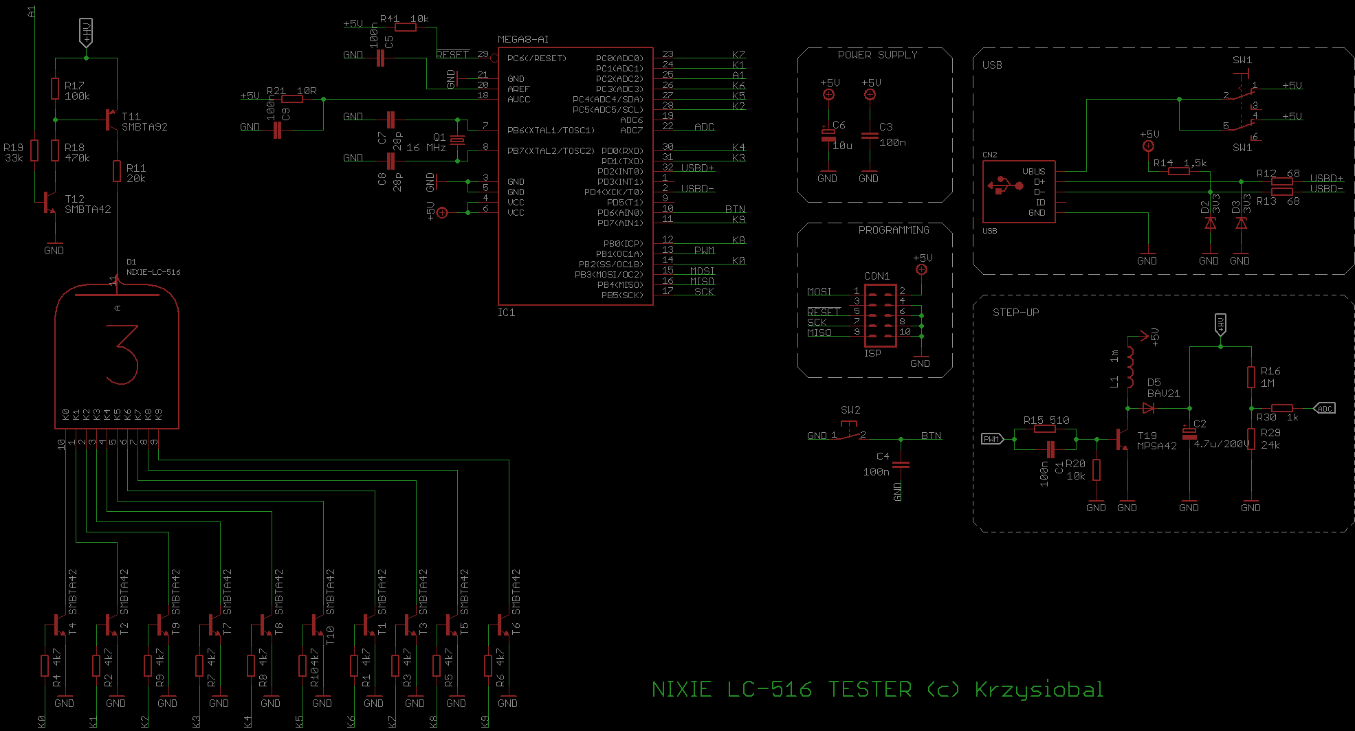

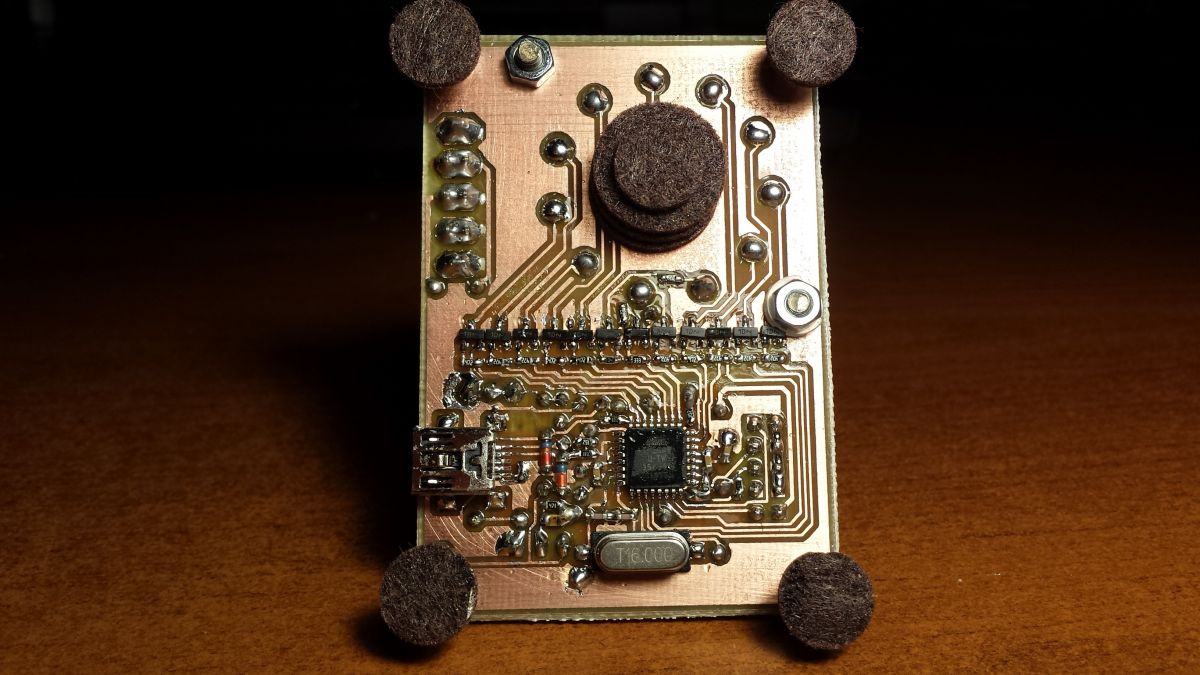

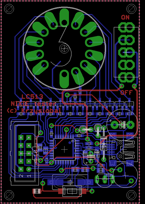

    The whole thing is managed by the only integrated circuit on board: Atmega 8. And it`s not boring at all, because in addition to controlling the cathodes, it also serves as a voltage converter. And it`s not easy - increasing 5V from USB to 180V was implemented in the form of a simple Boost converter. PWM frequency is 31.2 kHz, duty cycle is 85%. The increased output voltage is monitored by the microcontroller with one of the ADC inputs, thanks to which the feedback keeps the output voltage at a set level.
    Although I tested even without feedback and in this system I was not able to get more than about 180V (without load). Maximum current efficiency approx. 1.2 mA.
    Electrical schematic of a Boost converter for powering Nixie tubes.

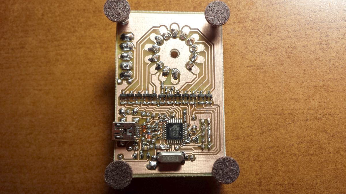

    The microcontroller is clocked with an external 16 MHz crystal for USB purposes - because the system uses USB not only for power, but also has the ability to communicate with a computer. Using a PC, you can, for example, read the voltage produced by the converter when powering various cathodes, so you can detect, without looking, which of the cathodes have any problems (e.g. they do not light up at all or consume excessive current).

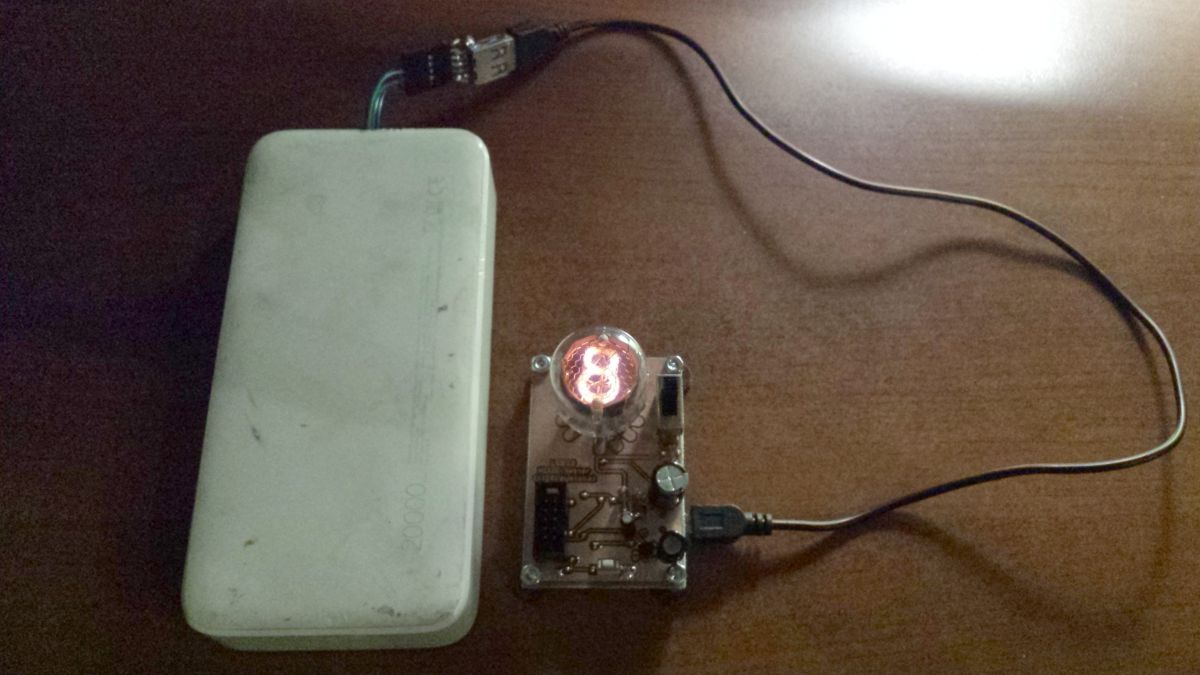

    There is also a button - by default, when turned on, the device displays each digit in a circle. However, by pressing the button you can change the control to manual, thus keeping a given digit longer.
    Circuit diagram of the Nixie tube tester LC-516 with Atmega 8 microcontroller

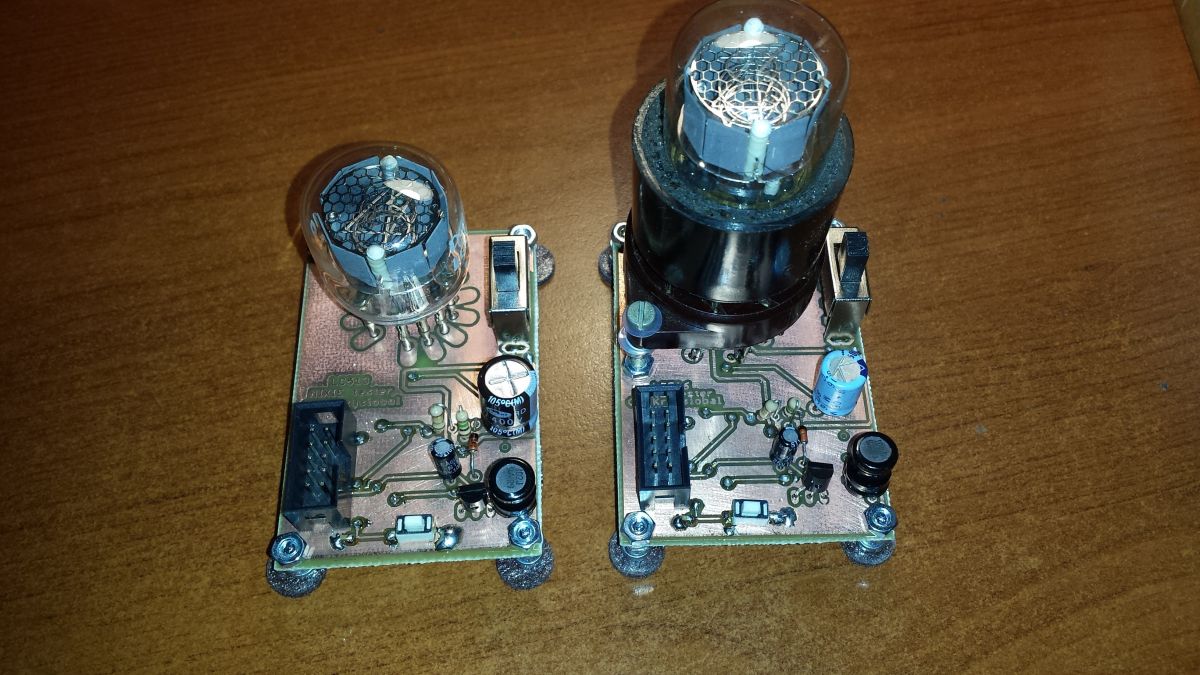

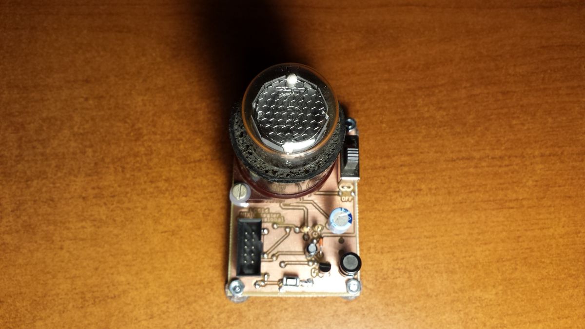

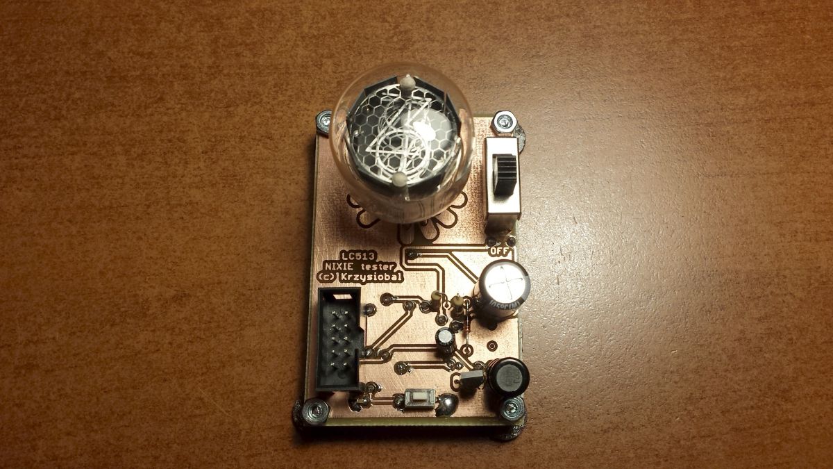

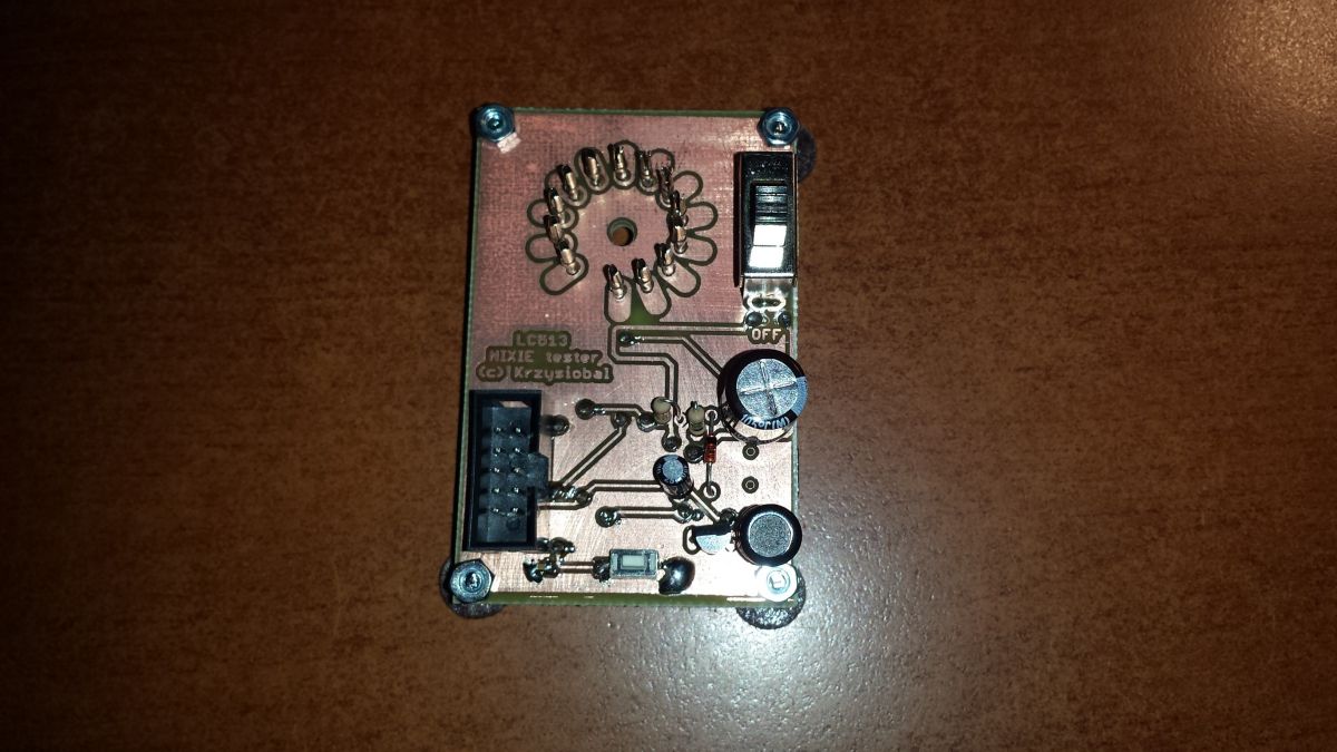

    As a socket for the LC-513 lamps, I used extended connectors from the DB socket. They work perfectly.
    Nixie tube tester LC-513 on a finished PCB Nixie tube tester with visible circuits and connections. Nixie tube tester LC-513 on a wooden background PCB design for a Nixie tube tester labeled LC513 with SMD components. Nixie tube tester connected to a power bank via USB.

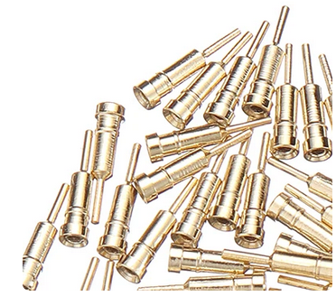

    DownI used a dedicated stand for the LC-516 lamp, but I am not satisfied with it - quite a lot of force is needed to place the lamp in it.
    Nixie tube tester module with a tube mounted on a circuit board. Prototype of a Nixie tube tester with PCB and integrated circuit Nixie tube tester connected to a power bank via USB.
    Fortunately, there are also single pins with a thicker diameter on Aliexpress, which I will probably replace in the future:
    Set of metal pins with a gold-plated finish.
    https://pl.aliexpress.com/item/1005004071932217.html

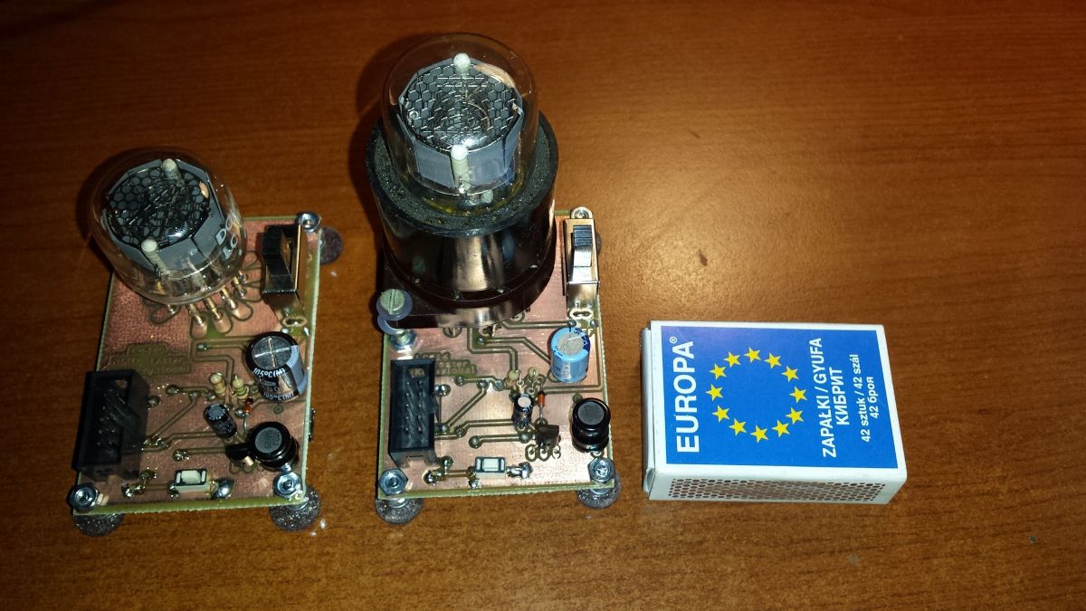

    And finally, a comparison of both testers - it is basically an identical design, the difference is only in the upper part of the board on which the tested lamp is placed. Thanks to the use of SMD elements, the device is very small and handy. Some more casing would be useful...
    Two Nixie tube testers on a wooden surface, with different bases for the tubes. Two Nixie tube testers next to a box of matches.
    As an interesting fact, it took me half a day to build the second one - the microcontroller was unable to generate high voltage, it reset itself if I changed the fill factor in the interrupt function. After replacing it with another identical chip, the problem disappeared.

    I noticed that most of the lamps, when turned on for the first time after many years, glow "sluggishly" - some of the digits seem to have missing fragments. Only after a dozen or so seconds everything starts to "normalize" and the lamp, put aside and then tested, e.g. after an hour, works normally. So it is not some form of "heating up", but rather a phenomenon known as cathode poisoning - some oxides are deposited on the cathodes, which are "dusted" back from them only after some time. Apparently, when displaying digits on such lamps, it is worth displaying all the digits one by one from time to time to eliminate this phenomenon.

  • Initial sluggish glow in aged nixie tubes
    #4 20841766
    CMS
    Posts: 8469
    Help: 258
    Rate: 2603
    An interesting phenomenon. But where do the oxides come from if it`s a vacuum tube? I think it`s something else. Maybe my colleague @AlekZ will say something more about this interesting topic.

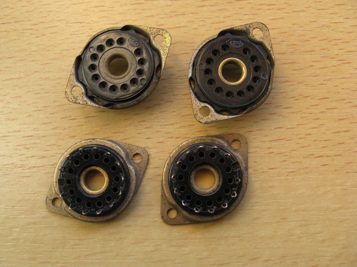

    I have some stands for the DL-531. Unfortunately, they are a bit tarnished :-(
    Four tarnished DL-531 vacuum tube sockets on a wooden surface.

In this build, the immediate cause was a bad microcontroller. The builder spent half a day on a second tester because the ATmega8 could not generate high voltage and reset itself when he changed the fill factor inside the interrupt routine. After he replaced it with another identical chip, the problem disappeared. That makes the edge case clear: repeated resets during PWM updates can come from a faulty MCU, not only from firmware design. [#20839537]
How can plug-in adapters be designed so one main tester board can support different Nixie tube types and pin circles?
Use one main board and make the lamp head a removable adapter. The builder replied that adapters could have male DB contacts arranged in a circle, matching the lamp contact pattern, instead of standard pin headers. That approach keeps the boost converter, ATmega8, button, and USB interface on one compact base while swapping only the top socket geometry for each tube family. It is the cleanest path from two fixed testers to one expandable platform. [#20842287]
