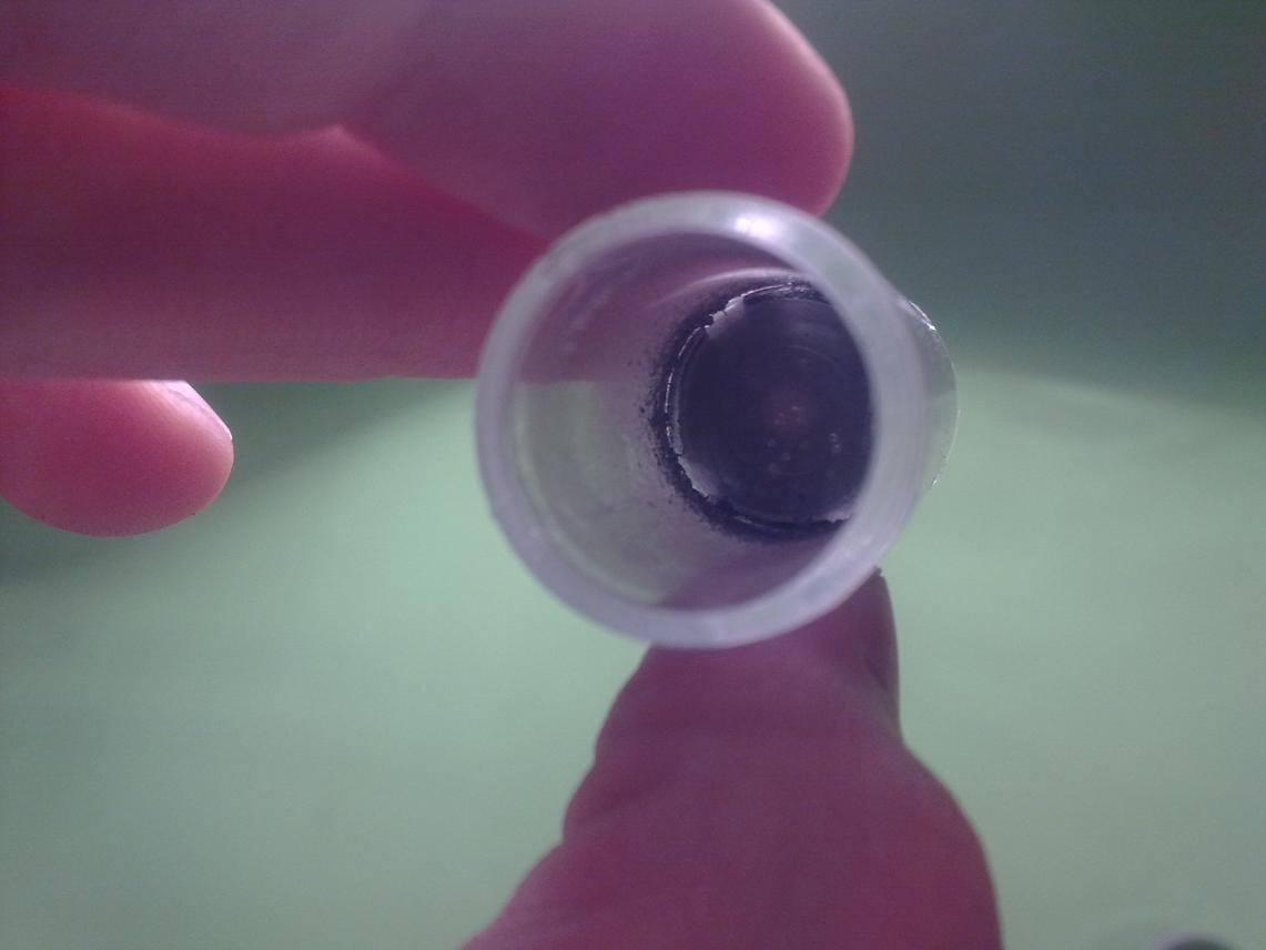

    Syntax
    Posts: 180
    Help: 6
    Rate: 30
    Do not bother you clogging a tin container? I immediately replaced him with a desoldering machine for a container from Denon SC-7000. All you need to do is cut it down a bit. Now much less often you have to empty it so you work more comfortably.

    Syntax wrote:
    Do not bother you clogging tin container? I immediately replaced him with a desoldering machine for a container from Denon SC-7000. All you need to do is cut it down a bit. Now much less often you have to empty it so you work more comfortably.
    stepawel what did you this station and how did you prepare the substrate?
    Can you give some photo with this container?
    I even created a thread about the clogged container, but few people spoke. In the end I do so that after cleaning I lightly spray the WD40 spring or silicone spray oil. Tin is better off.
    It does not change the fact that you have to clean often.

    Containers from Denon SC-7000 can be bought for about PLN 30 on Renex
    That's how it looked like it was new:

    Syntax, can you tell what the tin stops in this filter? Is there something like a polymer sieve?
  • #20 9525649
    krzysztofh
    Posts: 1557
    Help: 101
    Rate: 937
    Exactly. What is the baffle in the center of the sleeve before the sponge or nonwoven filter?
    Does it not block the air flow tin after a few aspirations?
  • #21 9525702
    Syntax
    Posts: 180
    Help: 6
    Rate: 30
    This partition inside is of the same material as the entire "container". The container is one whole, solid element. There are two filters on the compressor side: one - a thick and thick swab, the other - similar to the one in the cigarette, but I removed it because it did not fit into the ZD-915 pistol. In the image of the new filter, which I placed in the previous post, the second filter - "cigarette" is located on the front of the container (designation FRONT), but it really is mounted behind this filter - a cotton swab. Now the liquid tin falls into the container and stops in the middle of the barrier without blocking the air flow - on the partition near the edge. In the circle there are openings that allow free air flow, even when the container is full.
    Refined desoldering station ZD-915
