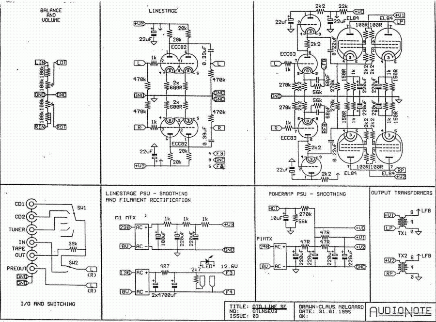

    Hello all! Maybe I'll get straight to the point. For some time now I have been intrigued by the scattered original schematics of Audio Note amplifiers and preamps. As the sound of these sets is one of the most fully reflective of the truth about music, which is reflected in the company's ideology (or vice versa - to choose from), I planned that the first tube amplifier that I will build will be the AN Oto SE project using el- 84 in the paralell s configuration, the diagram of which is attached. So I invite all fans of AN and DIY in general to build AN amplifiers, based on original schematics and component values, but also to search for new, perhaps better solutions. Although from what I can see (read, hear), the above-mentioned company knows what it is doing. I must admit that I myself have a few questions about the construction of the Oto Line SE, so I will be very grateful for any help.

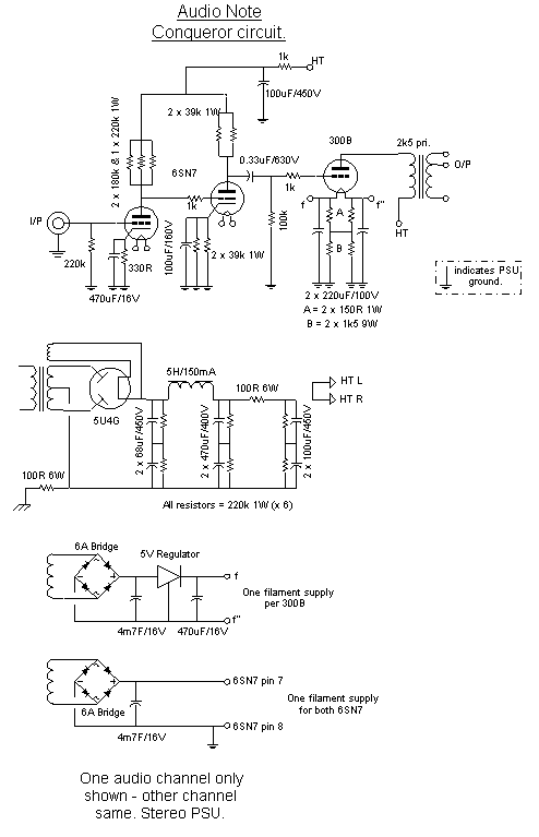

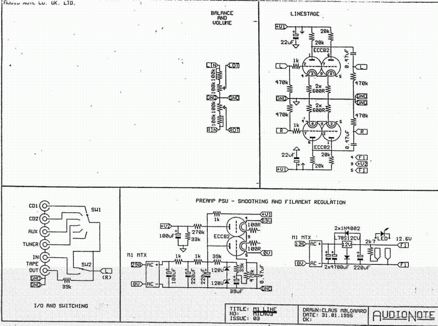

    Welcome back. This time I will present the Audio Note schematics that I have managed to find so far.
    To begin with, the single-ended tube integrated:
    Here is the SE
    Audio Note Amplifier Construction: DIY AN Oto SE Project with EL-84 Parallel S Configurations
    Now the preamps:
    M1
    M2 PHONO

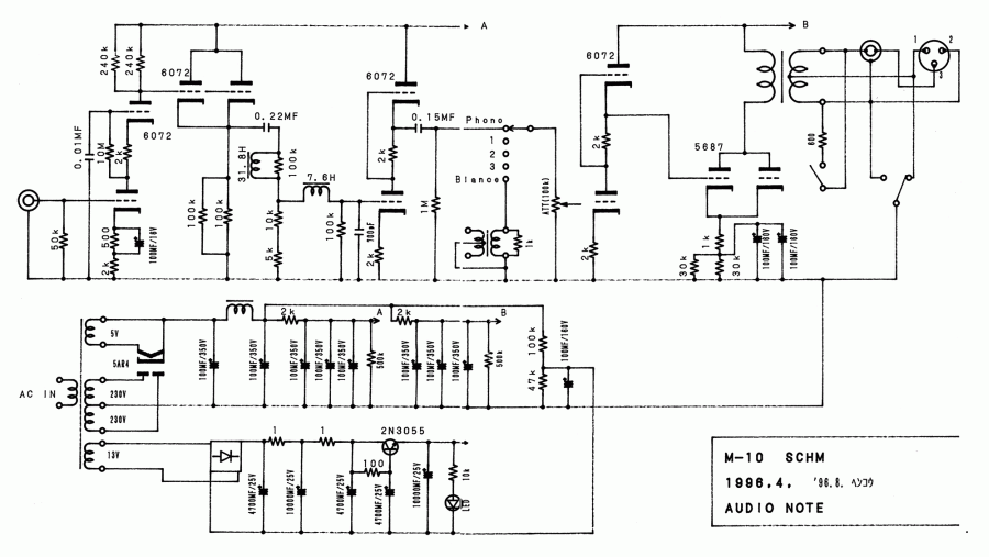

    M10

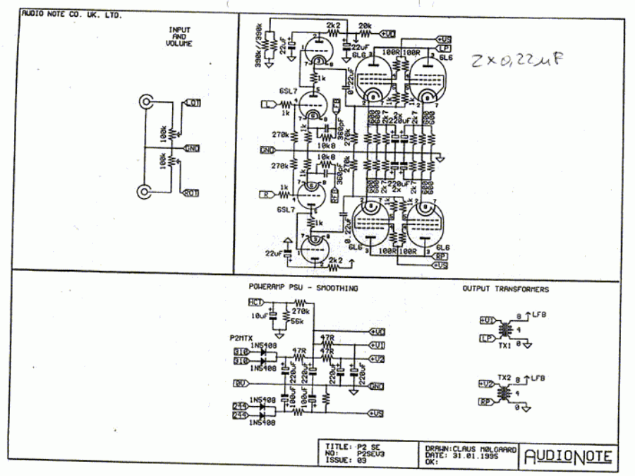

    P2 SE

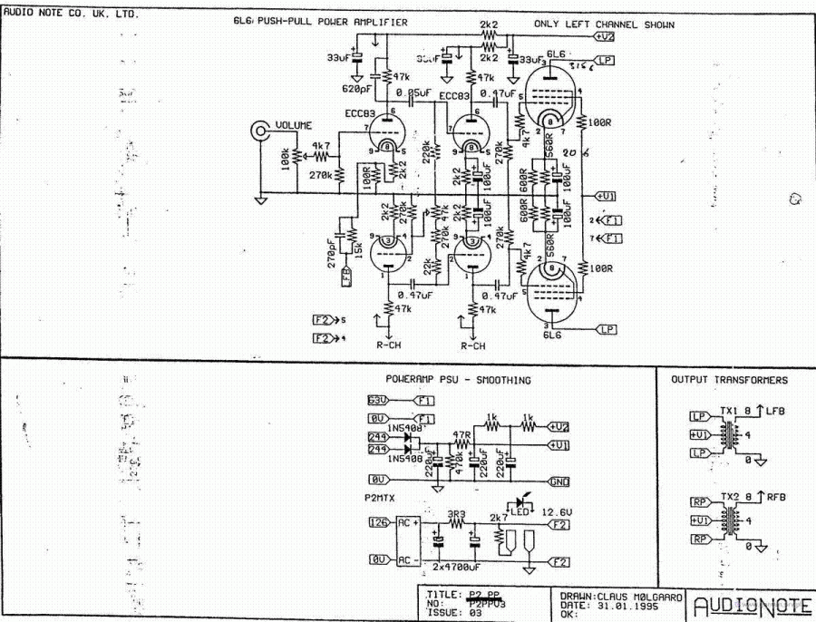

    P2 PP

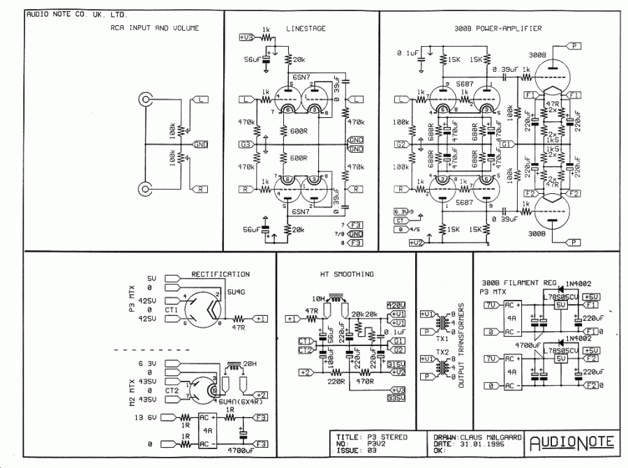

    P3

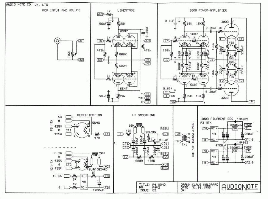

    P4 MONO

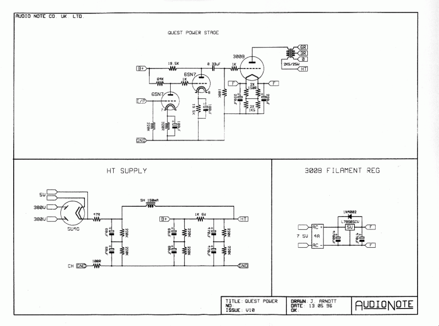

    QUEST

    CONQUEROR

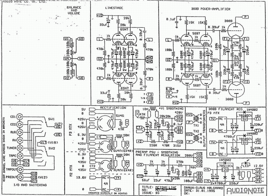

    MEISHU

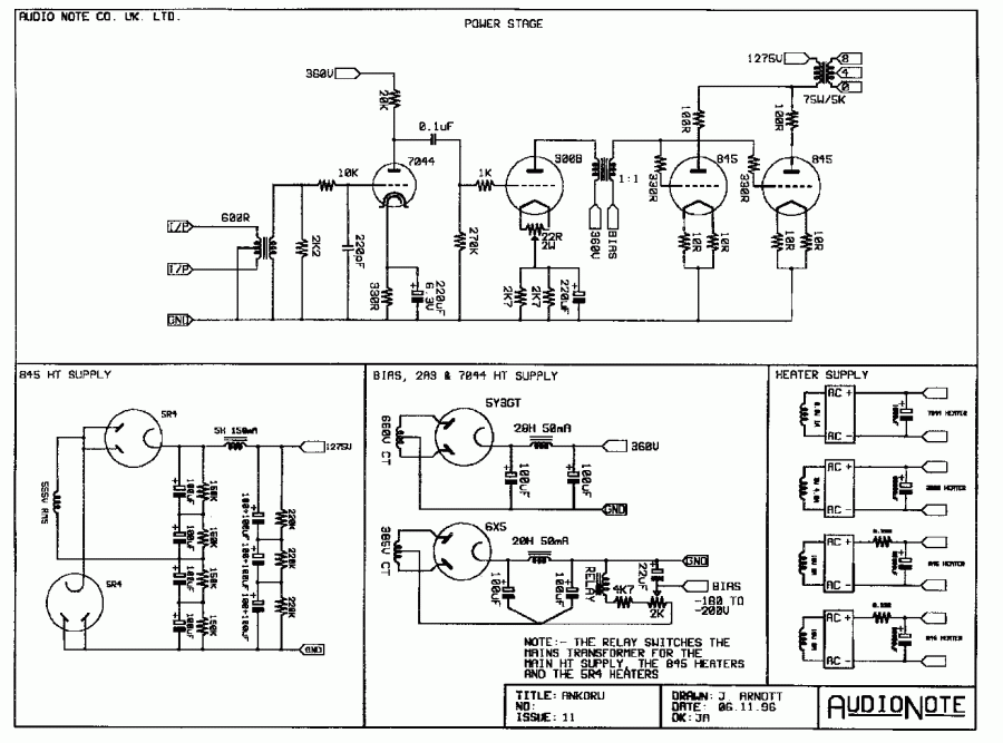

    ANKORU

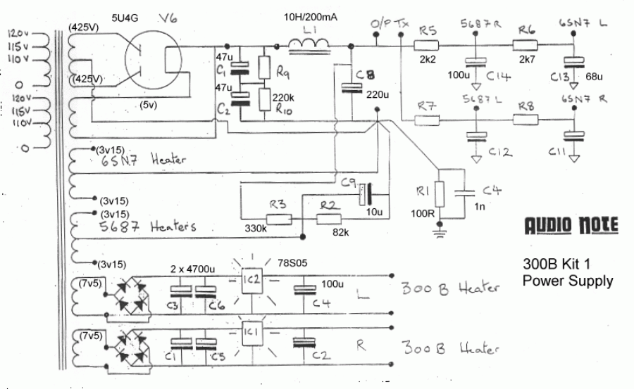

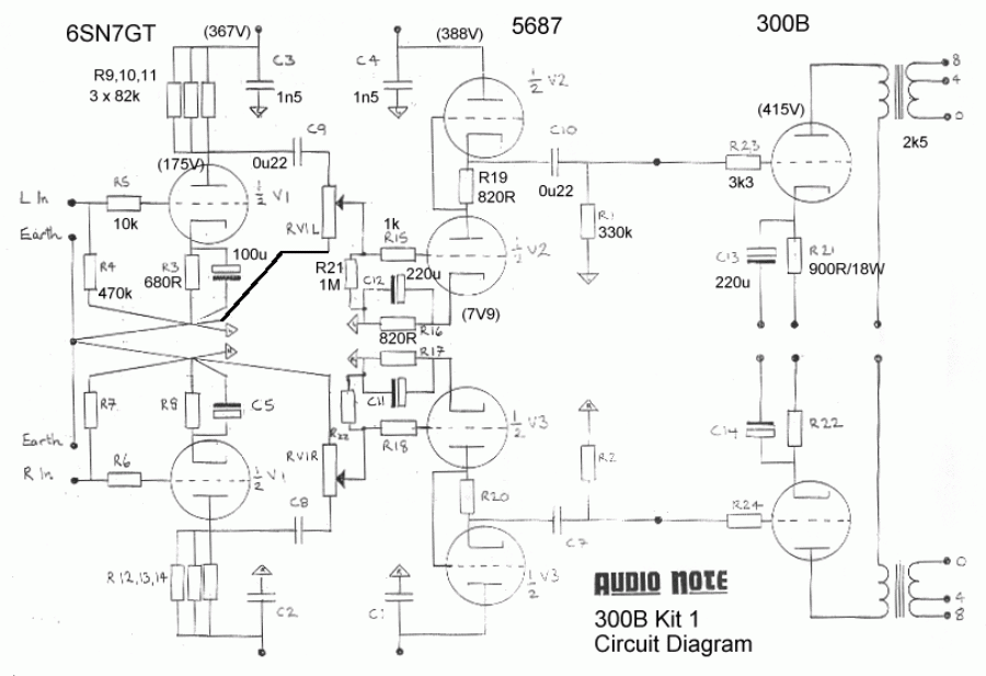

    Finally, I present the diagram of Kit No. 1 offered by Audio Note:
