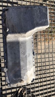

    I will refresh the topic a bit, gentlemen - I have a lot of elements in the engine, which I put together, water-germinated - they look perfect, like new - I have an oil pan - quite large and quite slightly exposed element - which would be expensive for beading - so I want to clean it myself - I washed it Dimer and chemicals for washing engines - it is completely clean, there are no black traces of oil and carbon deposits - but it is still gray and not uniformly bright.
    It has been written about some acids here - but I don't know how to get citric or ammoniacal acids - they are not in my toolbox - and I don't know how to harm - and does it have to be a bath? the bowl is quite large.

  • #21 18724359
    UscLuk
    Posts: 17
    Rate: 7
    Adaaskoone wrote:
    ewoo wrote:
    Adaaskoone wrote:
    Refresh the topic a little gentlemen - I have a lot of elements in the engine, which I put together with water sprouted - they look perfect, like new - I have an oil pan - the element is quite large and not exposed enough - which would be expensive for glassblasting - so I want to clean it myself - I thought it with Dimer and chemicals for washing engines - it is completely clean, there are no black traces of oil and carbon deposits - but it is still gray and not uniformly bright.
    It says about some acids - but I don't know how to get citric or ammoniacal acids - they are not in my toolbox - and I don't know how to be glazed - and does it have to be a bath? the bowl is quite large.
    Is it smooth or porous? Have you considered polishing with a polish and a polishing pad?
    As I mentioned - most of the elements are sprouted - they look like new - they are satin light gray - just bare aluminum - and this finish suits me best - so the polisher is not very much - and two - the bowl is cast - locally nicely finished - in other places a little less.
    Revamp Your Alternator Housing: Powerful Tips to Make Your Aluminum Shine!
    You can start with vinegar.
    If you do not take a bath, cover it with paper towels, pour over it "richly" and wrap it with foil or anything else so that it does not dry too quickly, and add vinegar every few hours. The process will take at least 24 hours.
    Bath much faster .... you can use a thick garbage bag as a "bathtub", it slightly reduces the required volume with larger elements ;)
    Possibly electrolysis, but it's also fun :)
