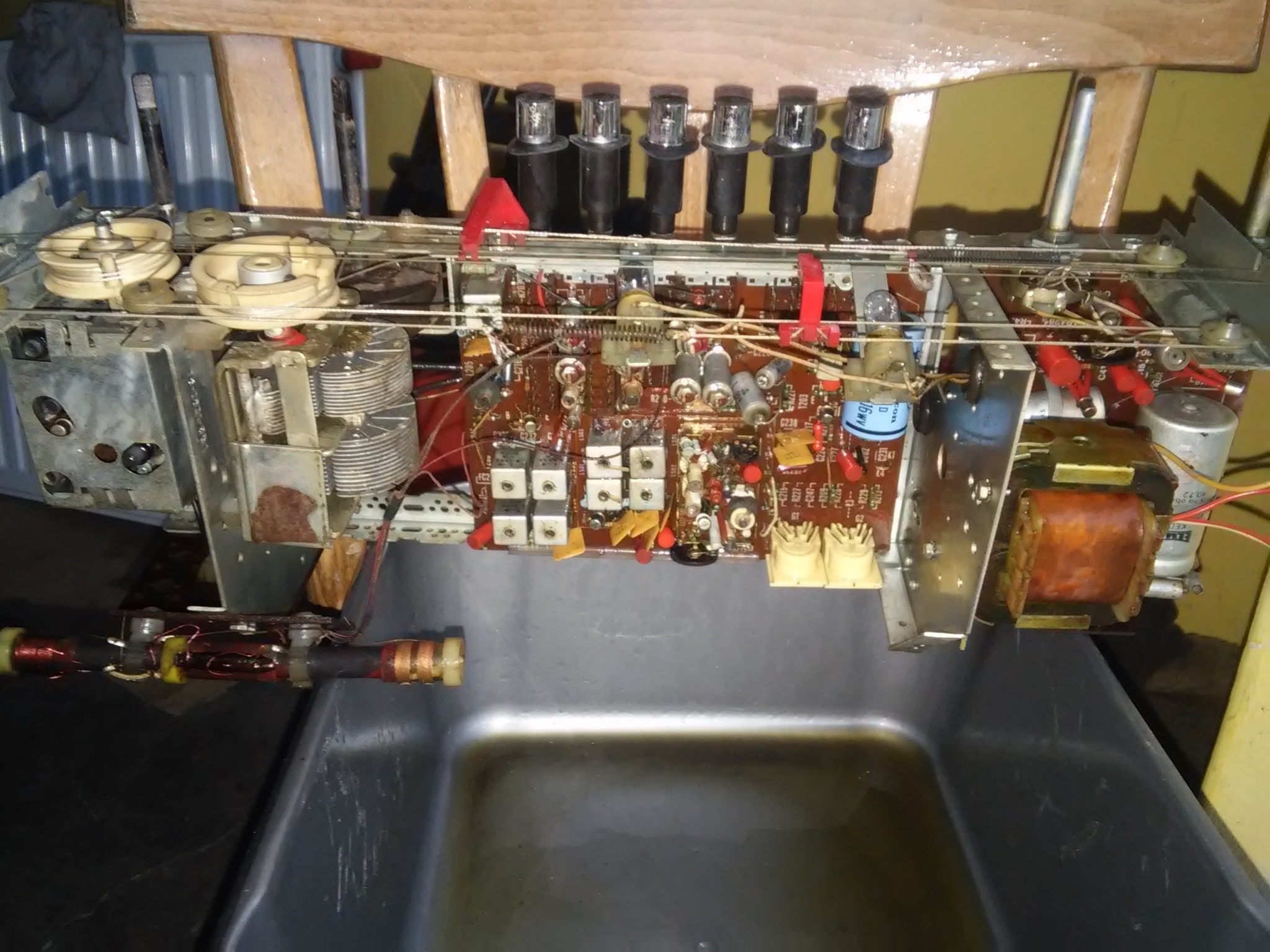

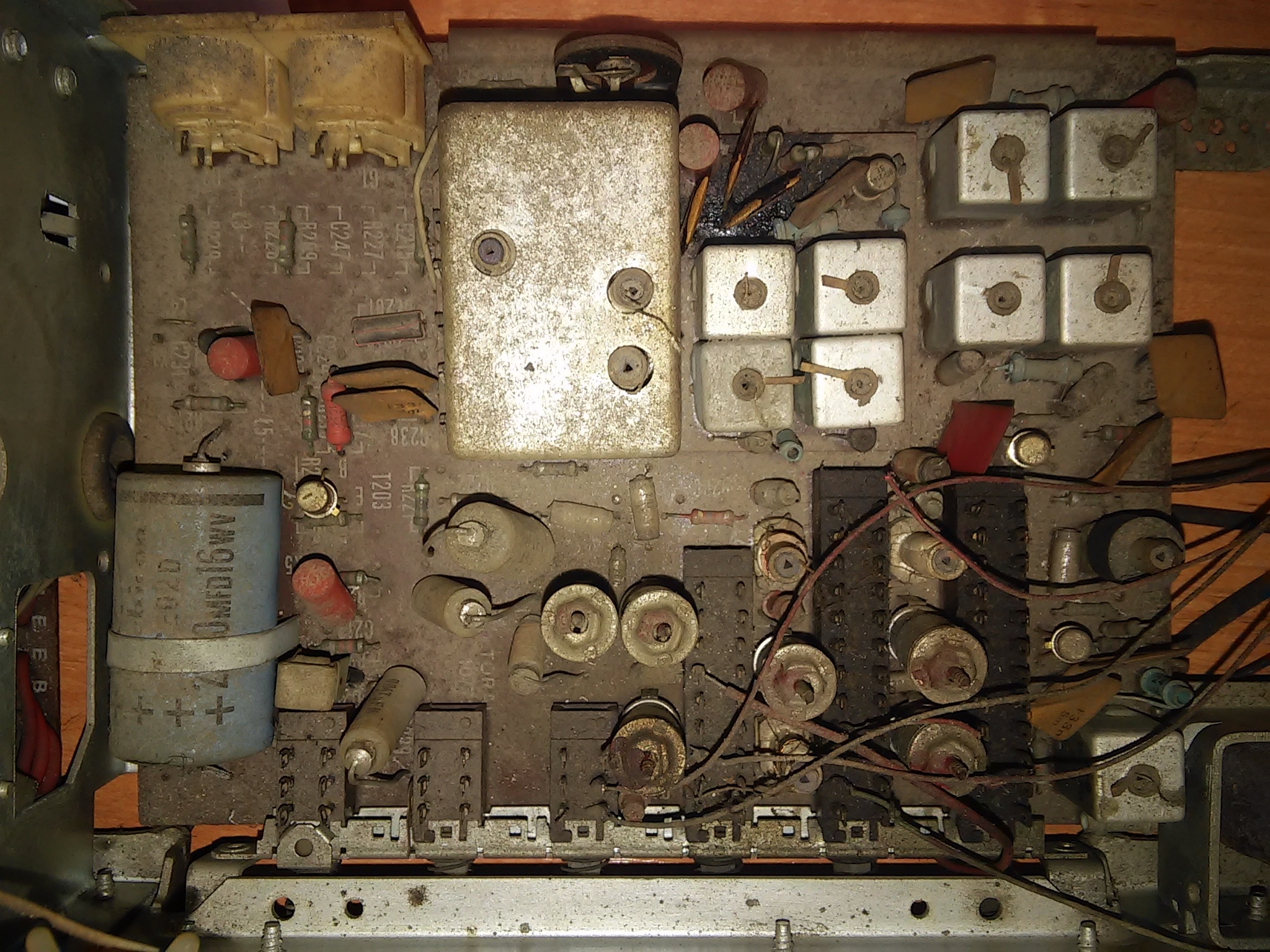

    That's what I thought, but I preferred to make sure :) Most often I just wash with isopropanol, sometimes with denatured alcohol, but as I mentioned the results do not satisfy me, especially when the electronics are soiled with a decades-old nicotine-dust mixture, for example. Such as here:
    Cleaning Aluminum and Plastic Panels from Nicotine Tarnish: Experiences with Older Audio Equipment
    And here the effect of washing and isopropanol, which changed the color:
    While it's wet, it looks nice, only after it dries, you can see the unwashed parts and often there is a white film on the laminate. Maybe there is a way to fix this?
  • #9 15426483
    398216 Usunięty
    Posts: 34318
    Help: 3925
    Rate: 9447
    In such a case (extremely "dried" tarnish) I helped myself (with the hair trimmed to half its length) with a brush. Such a slightly stiffer (than a normal brush) brush. Of course, first soaking in IPA, and then scrubbing.
    You just need to be careful with the more delicate components and mounting potentiometers (for known reasons).
  • #10 15428293
    398216 Usunięty
    Posts: 34318
    Help: 3925
    Rate: 9447
    bratyslaw wrote:
    after drying, you can see the unwashed parts and there is often a white film on the laminate. Maybe there is a way to do it?
    Wash again in a new batch of IPA. White tarnish is most often grease after reaction with IPA.
