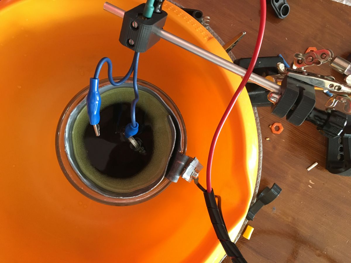

  • DIY electrolytic polisher for final processing of metal dental prosthetics, built as a laboratory device for removing “flash” from metal structures.
  • It uses 3D-printed FreeCAD parts for the stirrer, clamps, ventilation ducts, and a 60° front panel, all enclosed in a Hammond extruded-aluminum housing.
  • The build uses PLA printed at 0.2 mm layer height, an 80 mm fan stirrer, 10x3 mm magnets, and a 24V 6A modular power supply.
  • Current and time are adjustable, with 30-second steps, pause function, status LED, and sound signaling at the end of the process; working voltage is about 16V.
  • Precise control module with display and knobs in an aluminum case.
    I have a very useful device to present in the laboratory of dental prosthetics for the final processing of metal structures ("flash").
    3D printing made it possible to produce the most closely matched, necessary elements of a magnetic stirrer, adjustable rod clamps, ventilation ducts and a front panel frame inclined at an angle of 60 ° to the base plane for easy reading of displays. I made the projects using FreeCAD. The slicer is a SuperSlicer. I used PLA filament from Plast-Spaw. The layer height is 0.2mm.
    The whole thing is closed in a Hammond housing made of extruded aluminum.
    Smooth regulation of current intensity and step (encoder with button) regulation of working time in steps of 30 seconds, pause function, status LED indicator and sound signaling of the end of the process.
    Current regulation:
    https://leon-instruments.blogspot.com/2010/03/zasilacz-regulowany-20v-5a.html
    Ammeter:
    http://danyk.cz/avr_adc_en.html
    Timer:
    https://arduinoplusplus.wordpress.com/2016/02/27/led-display-relay-timer/
    Stirrer PWM controller:
    Circuit diagram for fan speed regulation using NE555 timer.
    The electrolyte I use is ELEKTROL by Chema (composition: ethylene glycol, sulfuric acid, hydrochloric acid).
    The anode is a polished piece and the cathode is a lead sheet formed into a cylinder. It can also be a copper sheet.
    An 80 mm fan works as a stirrer. 10x3 mm magnets. The "jumping" stirrer in the jar contains 3 pcs. 4x4 mm cylindrical magnets.
    The pendant with alligator clips is connected to the power cord by means of a connector from an electric cube hidden in a printed clamp.
    Instead of a mains transformer, I used a 24V 6A modular power supply.
    The working voltage is approx. 16V.

    A stirrer with these 3 neodymium mates does the same? Is it for sale? If so, how did he sink the magnets and in what material?
  • #3 19452133
    mycodename47
    Posts: 251
    Help: 15
    Rate: 53
    Nice made, but I have concerns about the air vent at the top of the case. I know that if you work carefully, you shouldn't spill anything, but there is a risk, and there is power inside.
  • #4 19452539
    Bobo[PL]
    Posts: 150
    Rate: 353
    Alone. An element with magnets, printed with PLA filament, fitted to the fan "press-fit" and glued with poxipol. Then I heated the places for the magnets with a propane-butane burner and flooded them. The magnets cannot be heated because they stop being magnetized.

    My colleague did not understand the question, or I asked incorrectly, so I will clarify it. I mean the stirrer in the vessel, as my colleague called it "jumping in the jar" made of 3 cylindrical 4x4 mm neodymium. Is it a ready-made solution or a proprietary solution, and if it's your own, is it something more about it?
  • #6 19453841
    Bobo[PL]
    Posts: 150
    Rate: 353
    adversus wrote:
    My friend did not understand the question, or I asked incorrectly [...]
    forgive :)
    Printed two halves of a cylinder with a cylindrical recess inside for magnets. Both halves stuck together with poxipol.

    And that's what I meant :) I have been playing with 3D printing for some time, but I am wondering, firstly, whether such a printout will be tight (with you a magnet can corrode) and secondly, whether printing materials, e.g. PLA, which is allegedly biodegradable or PET-G, are resistant for this type of baths?
  • #8 19454265
    Bobo[PL]
    Posts: 150
    Rate: 353
    Good question, but I must clarify that the stirrer element, in which the cylindrical magnets are closed, is made of PET-G. And I did so that first I pressed glue into the printed halves of the stirrer, and then I pressed magnets into the glue. I believe magnets are safe that way :)

    Why such combinations? Ready-made laboratory Teflon stirrers are available. They don't cost a fortune, chemically resistant Teflon.

    Cool equipment, tell what metals / alloys this electrolyte is suitable for, because on the manufacturer's website there is a note:
    Preparation for electrolytic polishing of Cr-Co-Mo dental alloys
    And I would have a few details to polish, where the main alloy components are copper and tin.
  • #13 19469609
    Bobo[PL]
    Posts: 150
    Rate: 353
    Different metal alloys require different electrolytes and bath parameters. For copper, the electrolyte component is phosphoric acid, chromic anhydride and thiourea. Unfortunately, I have no experience with alloys other than Cr-Co.

    The current is shown on the display, what is the voltage?
  • #15 19943554
    Bobo[PL]
    Posts: 150
    Rate: 353
    For chromocobalt around 15 ... 16V, so I took 15.8V.
  • #16 19944799
    jacki99
    Posts: 15
    Thanks for the answer, and what current should not be exceeded?
  • #17 19945181
    Bobo[PL]
    Posts: 150
    Rate: 353
    For dental technology purposes, 3.5A is ideal, but the current depends on the polished surface. You can experiment with the value of the current and the time.

    In all electrochemical processes of this type, the current density per unit area of the electrode is important.
    So the ampere alone is not enough ;)
