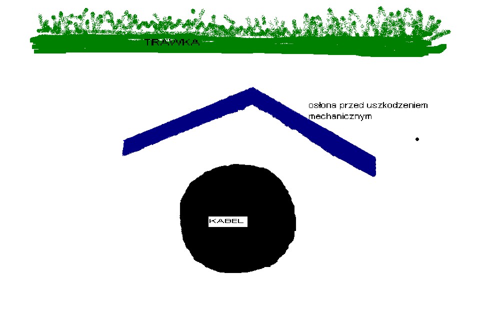

    #9 3885588
    shulc
    Level 22  
    Posts: 635
    Help: 37
    Rate: 109
    I join the speech Creapi , I just add that with a shallow trench, it is enough to lay a permanent cover over the cable, so that if in a few springs you may pitch a tent there, you will not damage it with herring :D
    This method is shown in a simple drawing
    greetings
