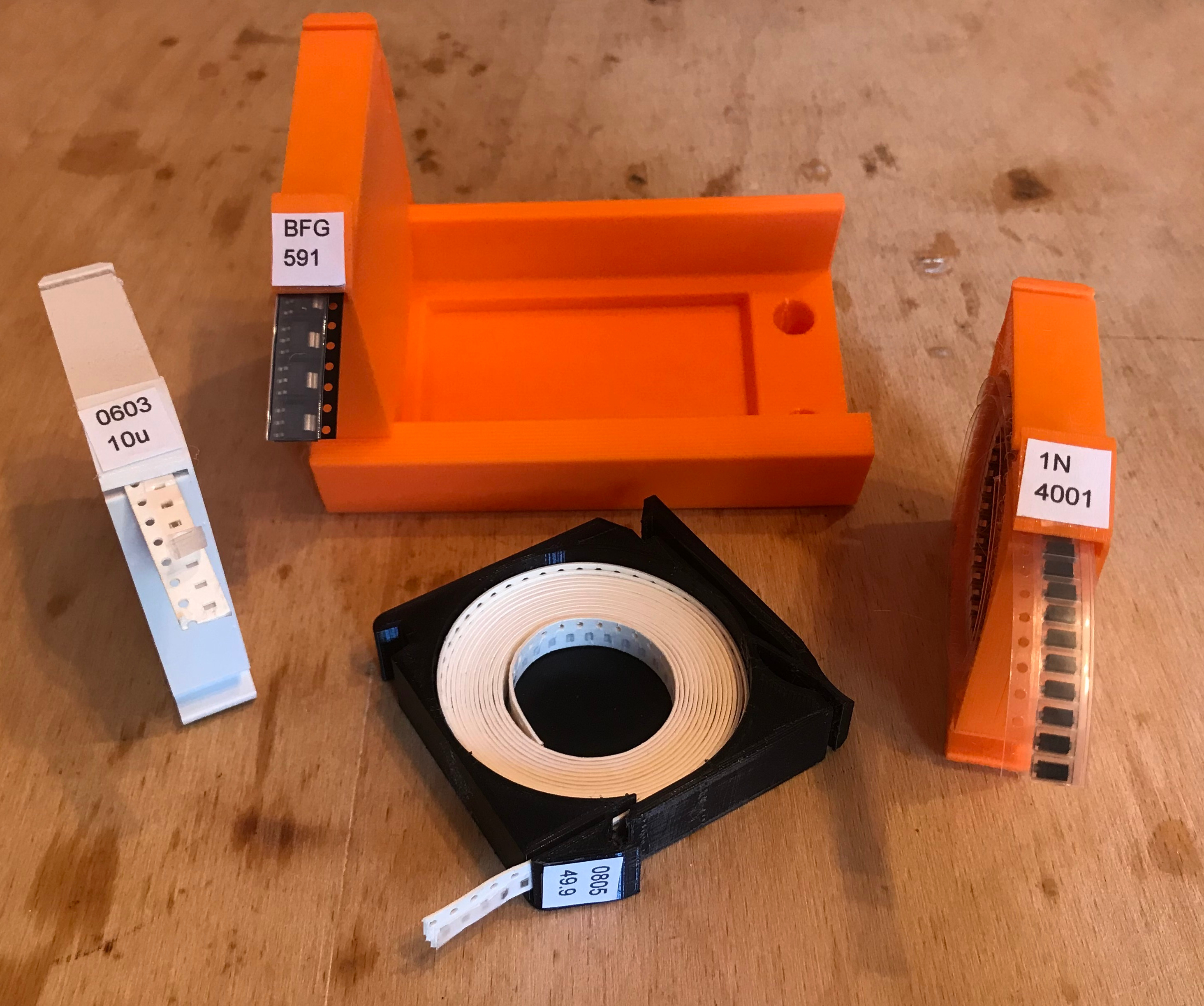

I recently found an interesting 3D printable object on the Thingiverse website and decided to do a short review of it here. I think the idea is quite good and worth promoting.
SMD Component Magazines by robin7331
All the information can be found on the model's author's page, on Thingiverse:
https://www.thingiverse.com/thing:3952021
This is a container for SMD components from which the end of the ribbon sticks out and we can gradually pull it out of the container and cut as much as needed. A very convenient and fresh concept compared to what I have seen before (also from us on the forum).
There are generally two types of container:
A stand for these containers is also included, along with holes for possible fixing. The containers also attach easily against the stand, using either a spring or the filament-based spring clip itself (known as 'compliant'). I have only tested it in the 'complaint' version and it works very well. The only thing you need to do is to clean the edges against which you hook this mechanism from any bumps, 'stringing' PLA.

I used PLA filament for the project, or more accurately its leftovers from other prints. I printed on an Ender 3D Pro. I printed various sizes of 'compliant' containers. I always printed a width of 15mm (there is 'Magazine_15' in the name), but different gap heights (1mm, 2.5mm, 2mm etc).
I made the following observations while printing:
- these models are quite easy to print, I printed some with old leftover filament and despite the large stringing everything is OK
- the printing of these models can be accelerated a bit (if only by changing the Feed Rate already on the running Ender 3 with the knob)
- these models can be printed with a larger nozzle

By the way, those white and black boxes were printed from old filament (from leftovers from larger prints) and the orange ones were printed from new filament. You can see the big difference. Well, a man is a lifelong learner, and I will still polish these boxes.

Pluses and minuses of the solution
After several weeks of use, I am able to list the following pluses of this solution:
+ very convenient access to the SMD component
+ everything is in view
+ containers are available for different SMD components
+ the 'compliant' mechanism based on the elasticity of the print is ingenious and works well
I also see some downsides:
- if we have very few components, these containers waste space (but I'm not likely to be affected by this, and if I have something small, I keep outside them)
- if the vendor sends us a cut SMD tape (it happened to me), then there is no way to put it inside this container in a sensible way
