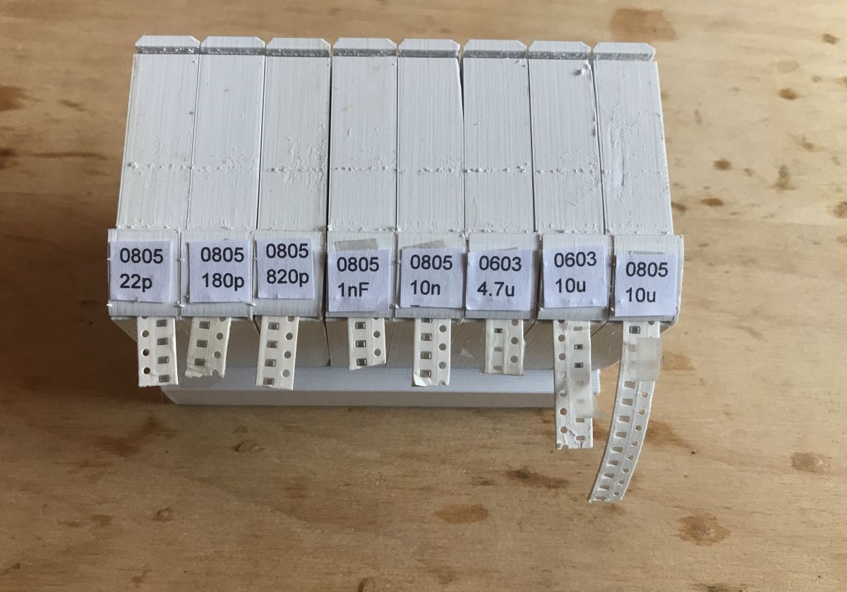

    Hello my dears
    I recently found an interesting 3D printable object on the Thingiverse website and decided to do a short review of it here. I think the idea is quite good and worth promoting.
    SMD Component Magazines by robin7331
    All the information can be found on the model's author's page, on Thingiverse:
    https://www.thingiverse.com/thing:3952021
    This is a container for SMD components from which the end of the ribbon sticks out and we can gradually pull it out of the container and cut as much as needed. A very convenient and fresh concept compared to what I have seen before (also from us on the forum).

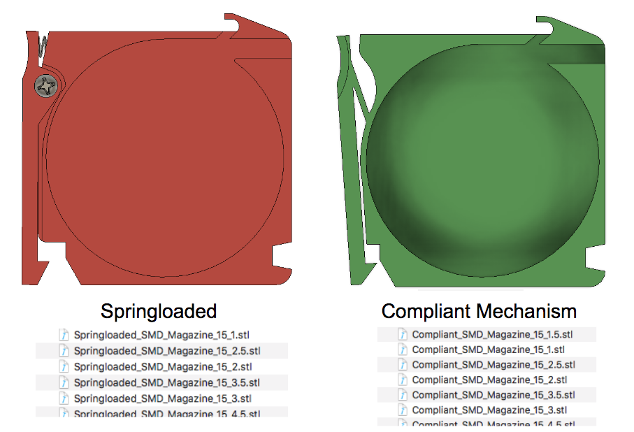

    SMD drum containers from Thingiverse - my review and print test
    There are generally two types of container:
    A stand for these containers is also included, along with holes for possible fixing. The containers also attach easily against the stand, using either a spring or the filament-based spring clip itself (known as 'compliant'). I have only tested it in the 'complaint' version and it works very well. The only thing you need to do is to clean the edges against which you hook this mechanism from any bumps, 'stringing' PLA.

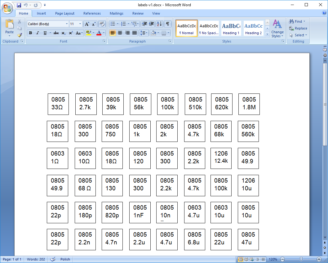

    My template for labels
    In order to sign the containers, I prepared myself a simple template in Word. There are squares of 15mm sides (when printed on A4 paper) into which you can write the abbreviated names of the items:
    I printed the labels on ordinary A4 paper and stuck them to the containers with double-sided adhesive tape.

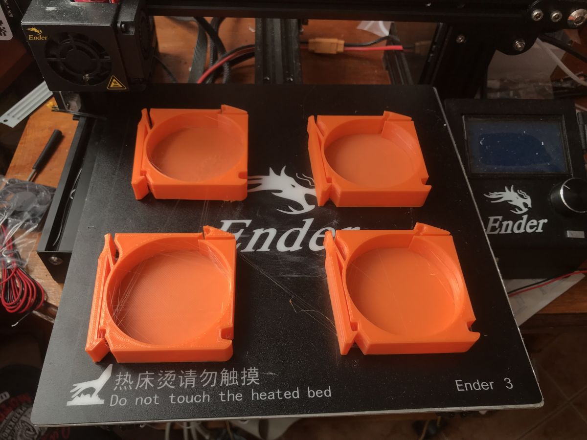

    My printout

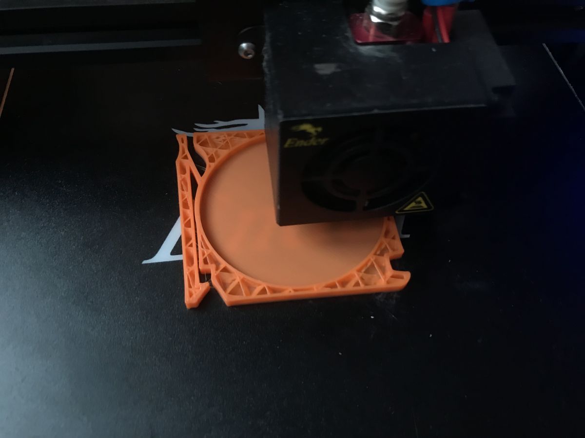

    I used PLA filament for the project, or more accurately its leftovers from other prints. I printed on an Ender 3D Pro. I printed various sizes of 'compliant' containers. I always printed a width of 15mm (there is 'Magazine_15' in the name), but different gap heights (1mm, 2.5mm, 2mm etc).
    I made the following observations while printing:
    - these models are quite easy to print, I printed some with old leftover filament and despite the large stringing everything is OK
    - the printing of these models can be accelerated a bit (if only by changing the Feed Rate already on the running Ender 3 with the knob)
    - these models can be printed with a larger nozzle
    During printing:

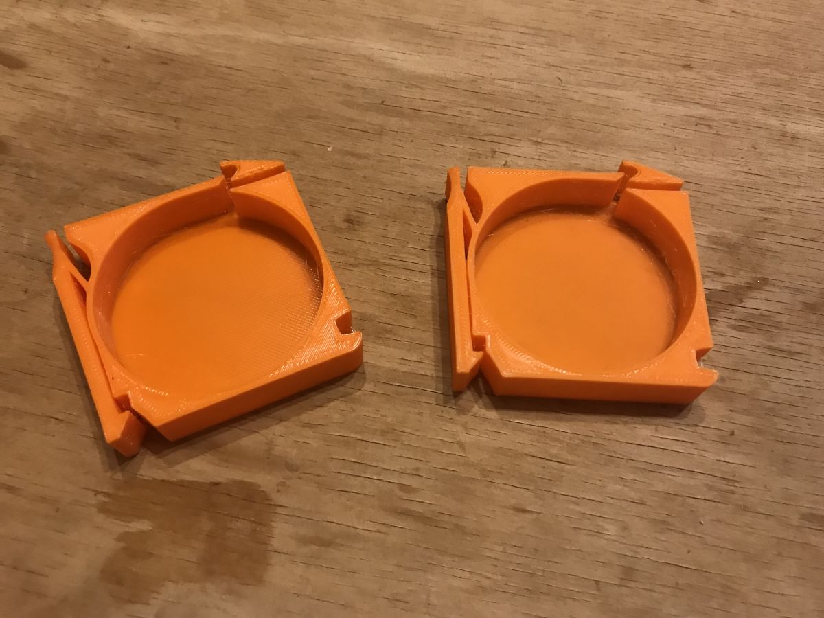

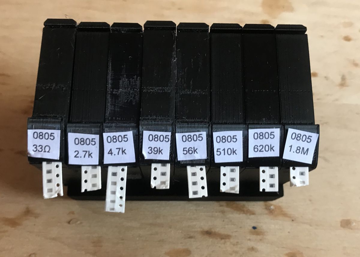

    Individual boxes after printing:

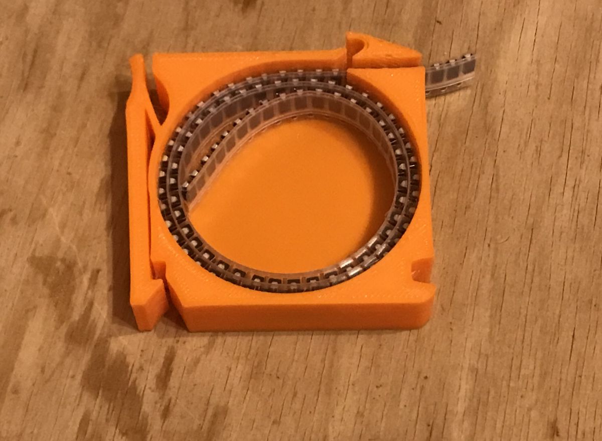

    Fitting:
    Printing four at a time:
    Signature card:
    Final version of the boxes on the stand (also included is a model of it):
    SMD drum containers from Thingiverse - my review and print test SMD drum containers from Thingiverse - my review and print test SMD drum containers from Thingiverse - my review and print test
    By the way, those white and black boxes were printed from old filament (from leftovers from larger prints) and the orange ones were printed from new filament. You can see the big difference. Well, a man is a lifelong learner, and I will still polish these boxes.

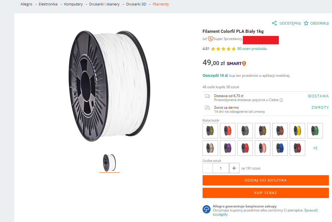

    Cost estimate
    (added a little later at users' request)
    You can easily calculate how much one box costs us - its weight is estimated in Cura. 'Low Quality' mode and 0.4mm nozzle (larger nozzle will speed up the print):
    This is the container I chose - 15mm wide.
    I've also experimentally checked that this 2h print can be whittled down to as little as 1h (200% Feed Rate) and the object still comes out fine (although this also depends on the quality of the filament and the condition of the printer).
    So we have:
    - 20g weight (19g, but I rounded up for clarity of calculation)
    - print time 1h
    Now the question is what kind of filament. I use the cheapest one and it is quite OK. I pay PLN50 for 1kg, I buy exactly that:
    (seller blurred because I don't like to do cryptic advertising).
    From 1kg spool we have 1000/20 = 50 boxes for 50 zł + shipping of filament + electricity, so one box costs just over a zloty .

    After several weeks of use, I am able to list the following pluses of this solution:
    + very convenient access to the SMD component
    + everything is in view
    + containers are available for different SMD components
    + the 'compliant' mechanism based on the elasticity of the print is ingenious and works well
    I also see some downsides:
    - if we have very few components, these containers waste space (but I'm not likely to be affected by this, and if I have something small, I keep outside them)
    - if the vendor sends us a cut SMD tape (it happened to me), then there is no way to put it inside this container in a sensible way

    Summary
    I really liked this type of container for SMD components. It is much better than the containers I have seen before (also on Elektroda) and I am already using it at the moment. The components can be removed easily and quickly.
    What do you think of these containers? Do you know of any better alternatives?

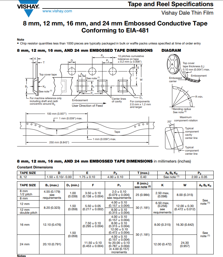

    Freddy wrote:
    After all, the width of the SMD tape is standard, you're probably referring to the label size :)
    I may be exaggerating the accuracy, but even in the title photo:
    you can see that the width of the ribbon with 1N4001 is different from that of the ribbon with 0603 10u, well the height of the elements is also different. Am I seeing poorly though?

    There are several tape widths with SMD components but they tend to stick to standards. The project itself cool ! :)
