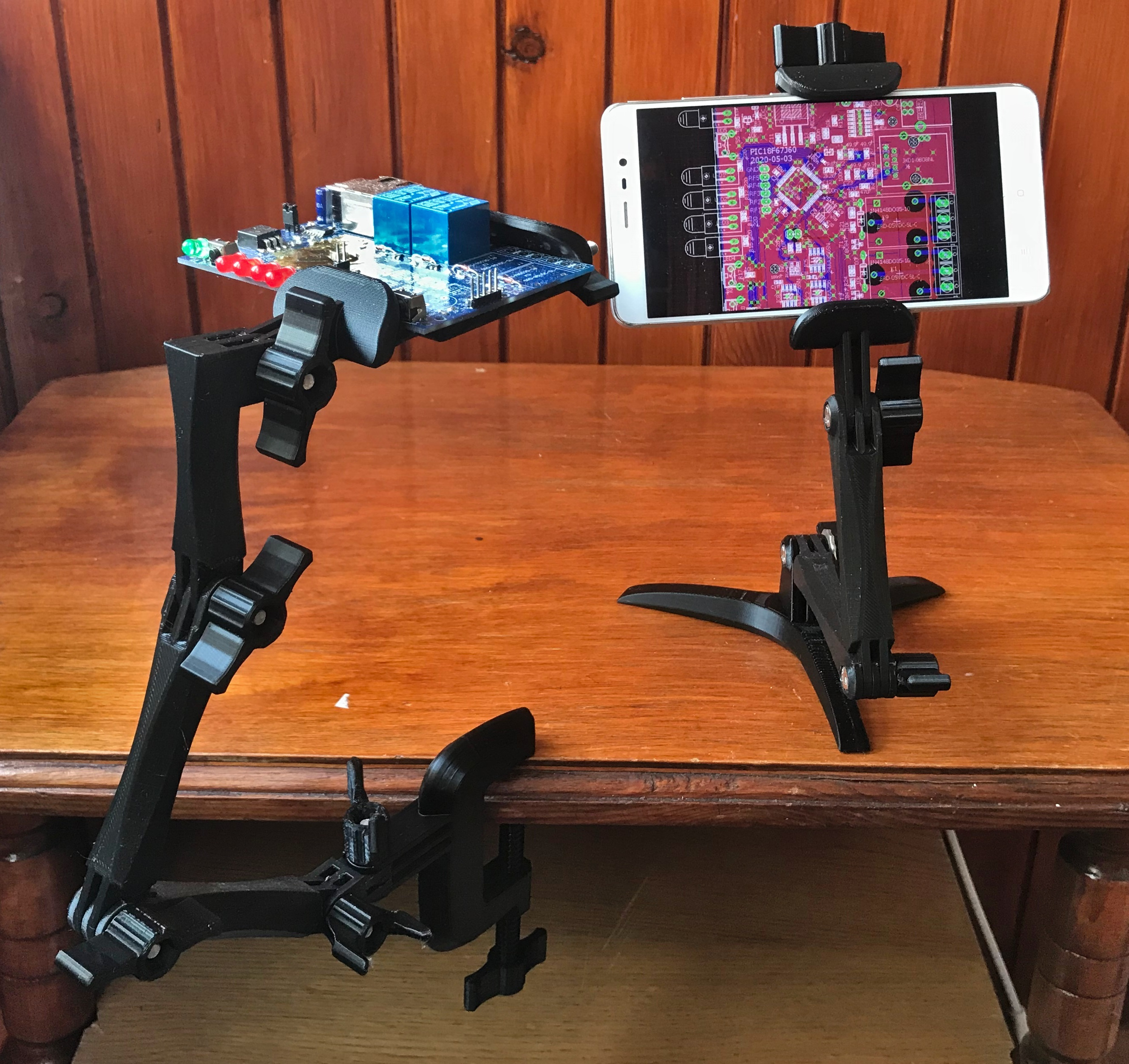

Final design - gallery Final design - gallery Final design - gallery
Finally, I made myself two 'third hands', one to hold the PCB while soldering and the other to hold the phone (e.g. with the schematic displayed):
In use:
Alternative version (the one with the plate clamp; this is the one I used the male-to-male adapter for):
If we have the right number of elements it only takes a few minutes to convert our third hand into another version. You can even make a version that has clamps on both sides.
