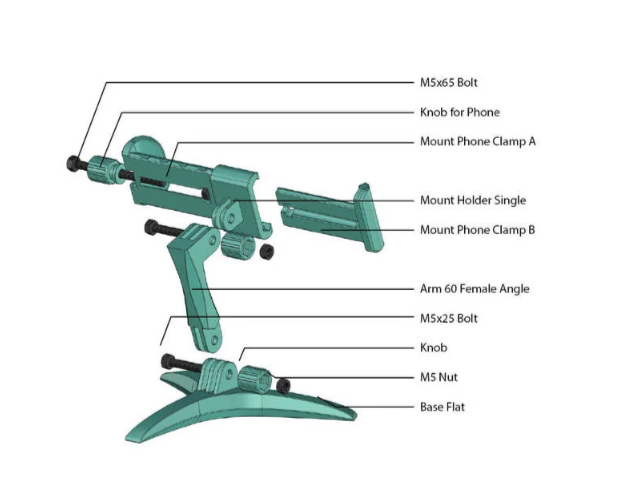

    The third hand here is built from a set of components that we can print on a 3D printer and connect freely with additional M5 screws.
    The author shows examples of tripod configurations on the project page:

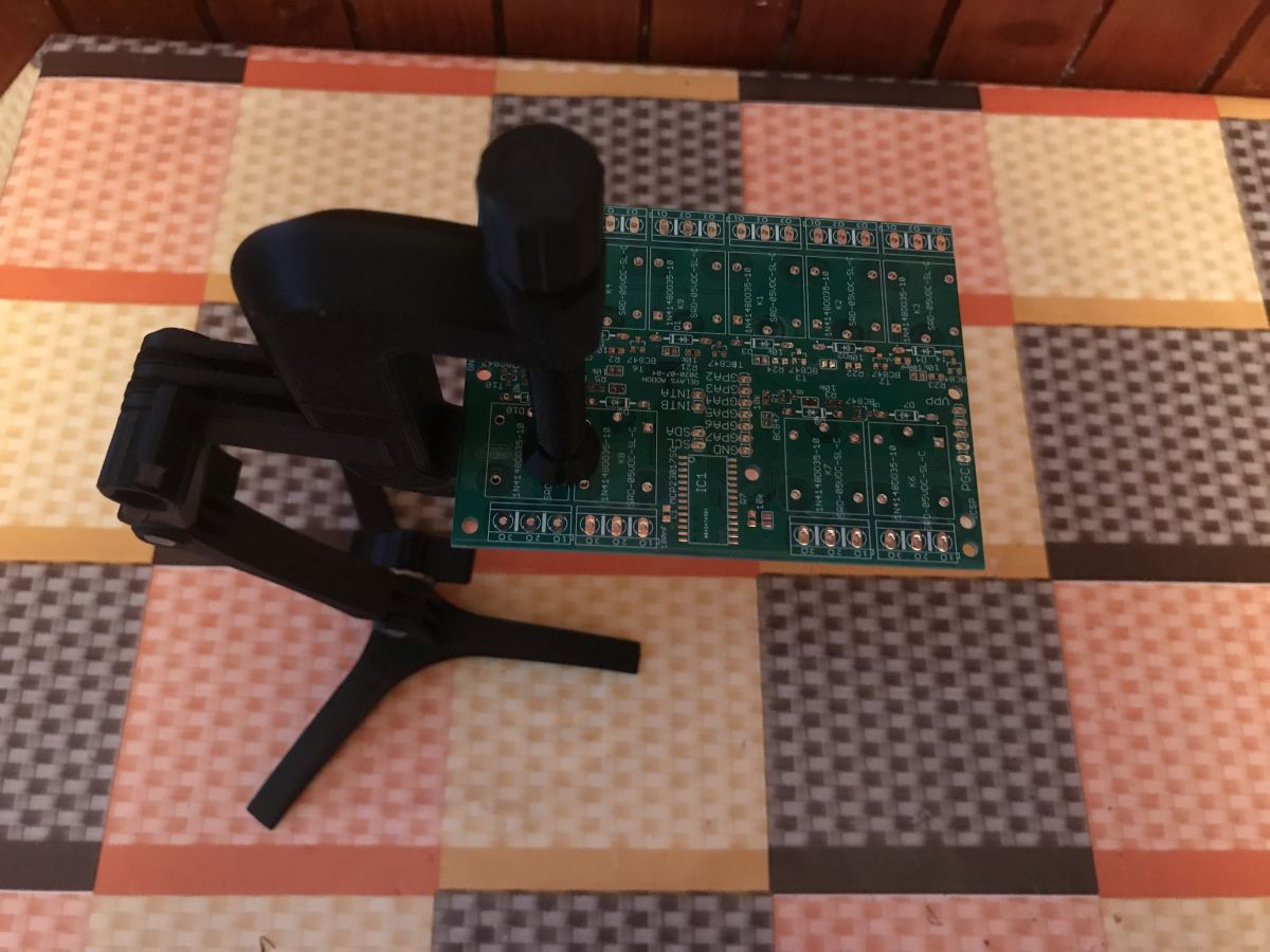

    The hardest part is assembling the phone holder (the PCB will do too), although you can just press one part into the other, the PLA filament is malleable enough that it won't break.

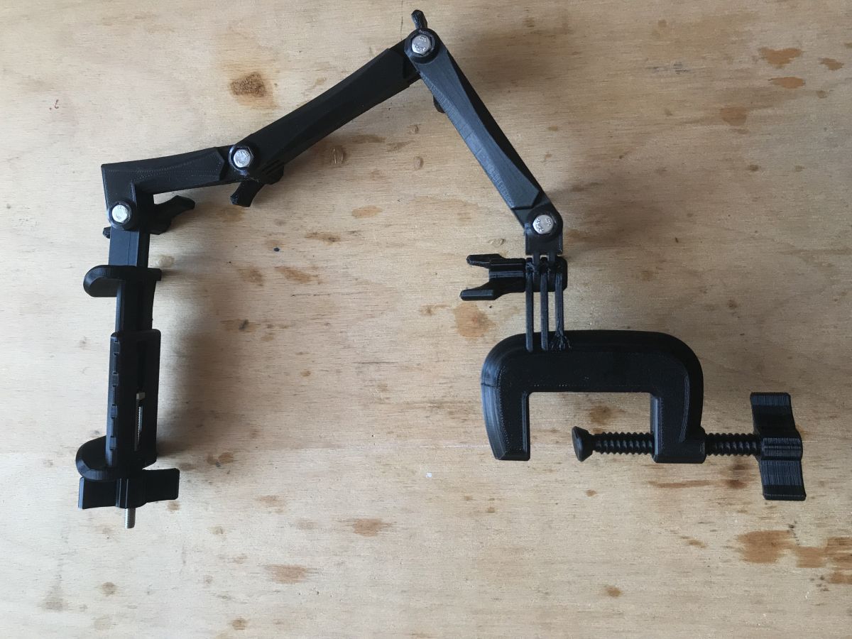

    Finally, I made myself two 'third hands', one to hold the PCB while soldering and the other to hold the phone (e.g. with the schematic displayed):
    Modular third hand, tripod, phone holder from Thingiverse - improvements Modular third hand, tripod, phone holder from Thingiverse - improvements Modular third hand, tripod, phone holder from Thingiverse - improvements Modular third hand, tripod, phone holder from Thingiverse - improvements Modular third hand, tripod, phone holder from Thingiverse - improvements Modular third hand, tripod, phone holder from Thingiverse - improvements Modular third hand, tripod, phone holder from Thingiverse - improvements Modular third hand, tripod, phone holder from Thingiverse - improvements
    In use:
    Alternative version (the one with the plate clamp; this is the one I used the male-to-male adapter for):
    If we have the right number of elements it only takes a few minutes to convert our third hand into another version. You can even make a version that has clamps on both sides.
