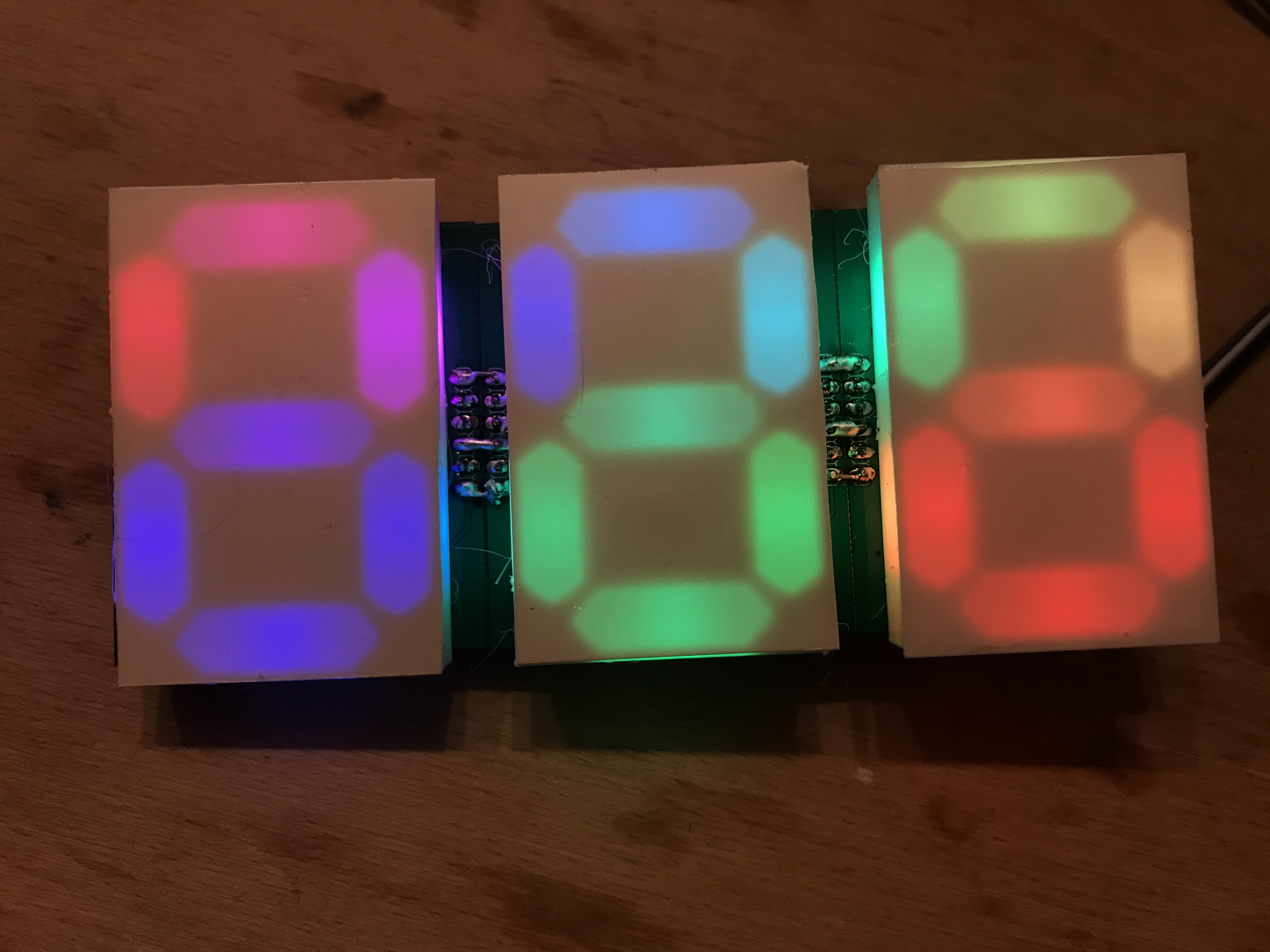

Hello my dears I would like to present here my attempts to make a self-contained 7-segment display based on WS2812B colour LEDs, my own PCB and a case printed on a 3D printer.
The display shown here I will test with an Arduino and give full operating codes for download.
Heart of the display - WS2812B LEDs The display is based on WS2812B 'smart' coloured LEDs, a large number of which can be controlled by a single pin. These diodes only require a power supply (5V and ground) and one signal, they are connected like this:
(in the case of long wires, it is still worth giving a resistor on the data line before connecting to the microcontroller)

Board design I started the design of my own display by planning the board. For this I used the free version of Eagle software.
The tile represents a single digit. The digits can be connected together and have more digits (controlled by a single pin anyway) by using the WS2812B.
I have tried to make the whole thing no larger than 5cm by 5cm, as most PCB shops will accept panels up to 10cm by 10cm at a cheaper price, which will allow me to order more of my tiles (4 tiles per panel) more cheaply in the future.
There is a small error on the board - the distance from the goldpin connectors on the right and left side to the edge of the board is a bit too large, making it impossible to connect the two boards together with jumpers alone. This is necessarily to be corrected in the future.
I exported the boards to Gerbers and had the board shop make them (as a start without a panel - this is the first version).

The 3D design of the display I then started Blender and took to designing a 3D overlay for the diode board to shape the digit parts. I started by transferring the holes from the PCB (I will use these for assembly):
I then decided on the size of the segments and applied their initial shape:
Then I refined their shape and prepared the final element (in Blender I used the Boolean operation to cut the segments out of the cube):
This is how I gave the whole thing a third dimension (the central two cylinders are the holes; the four on the corners are the tabs):
Display 3D printing and fitting The component came out right the first time. On the board it looked like this:
But that's not the end of the story, because you still need to make some sort of overlay that diffuses the light at least a little and gives the effect of whole segments (rather than individual LEDs) shining through.
I wasn't sure what was best to use for this, so I used one of the layers from the inside of an old LCD matrix (whose teardown I described recently in the 'device interiors' section). I chose the layer that gives the best effect, white/milky:
I applied it to the printed part using droplet/superglue, as I was no longer planning to change it.
I attached the printed component to the PCB using laptop screws:
Final result:
Combining subsequent panels I designed the panels so that they could be joined together. Unfortunately, however, they turned out to have slightly too thick edges and I couldn't use the typical 2.54mm jumpers to join them, but I managed in another way. This will be corrected in the next version.
Ultimately I wanted to use the prototypes I made as a temperature display, so I connected the three modules together:
(in the meantime I also switched from Arduino UNO to Nano) The module in action (highest possible brightness):
Colour test (50% brightness):

Mistakes made, what could be improved, etc This was my first attempt at making my own displays based on 3D printing, so a few things could be improved here:
- first of all, you need to improve the edges of the boards so that the goldpins would reach each other (there would be a gap of 2.54mm between them) in order to be able to connect them with ordinary two-pin jumpers
- the number of WS2812B could be doubled to increase the brightness of the segments (although they are now clearly visible)
- you could think about using the other side of the PCB, e.g. give space for the microcontroller there (but of course only use it for the first module, and not solder in the others)
- this 3D printed element could be printed with more infill or thicker, because a little bit of its side walls let the light through and they should not
- a better light diffusing coating could be used, maybe someone has an idea what kind?
- the board from the photos in the topic was obviously missing the description layer, it simply got lost during the export to Gerbers, in the next version you should remember to add it
Summary The first attempt was essentially successful - I am happy with my display. It is comfortable to use and looks good in a dark room. I will definitely make a second, improved version of it. From the version shown here, I think I will in turn make a thermometer and use the RGB possibilities to somehow also reflect the displayed temperature through the colour of the digits.

It's good that people are trying to create such constructions themselves. It stimulates the brain to think. [Read more]
androot
11 Sep 2020 18:21
A PCB with white soldermask would probably be more expensive, but the lighting effect would be more visible.
This printed piece with the shapes of the digits could have the recesses for the LEDs not perpendicular,... [Read more]

In my opinion, what is missing here is simply good 'optics', but making them at home is not easy. [Read more]

Regarding the improvement of the uniformity of the segment surface illumination (uniformity), there are several possibilities:
- these diodes are generally not suitable for this purpose (small beam angle),... [Read more]
yogi009
11 Sep 2020 19:13
This is probably the main design obstacle and a well-made matt optic on the final surface takes care of the issue. [Read more]
Loker
11 Sep 2020 19:18
Believe me - it doesn't take care of :( In the case of a small LED-surface distance even if "bare" LED structures (bare die) are used only the appropriate resin (dissipative resin) will do. But this applies... [Read more]
