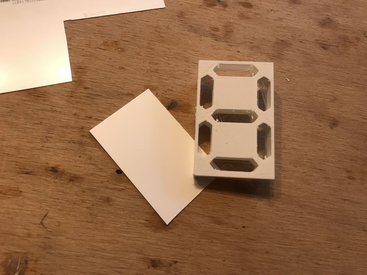

    But that's not the end of the story, because you still need to make some sort of overlay that diffuses the light at least a little and gives the effect of whole segments (rather than individual LEDs) shining through.
    I wasn't sure what was best to use for this, so I used one of the layers from the inside of an old LCD matrix (whose teardown I described recently in the 'device interiors' section). I chose the layer that gives the best effect, white/milky:
    Proprietary 7-segment colour display based on WS2812B
    I applied it to the printed part using droplet/superglue, as I was no longer planning to change it.

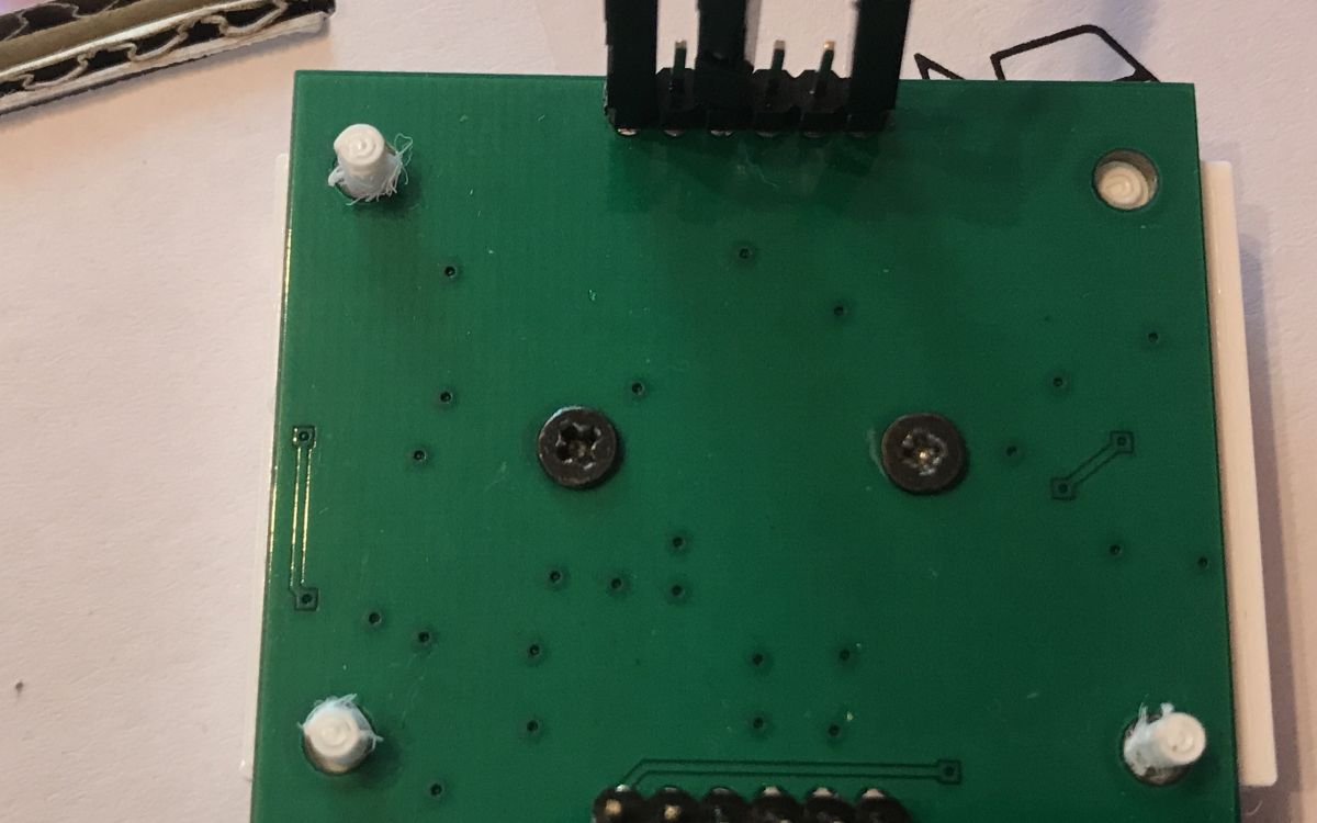

    I attached the printed component to the PCB using laptop screws:

    This was my first attempt at making my own displays based on 3D printing, so a few things could be improved here:
    - first of all, you need to improve the edges of the boards so that the goldpins would reach each other (there would be a gap of 2.54mm between them) in order to be able to connect them with ordinary two-pin jumpers

    Help: 54
    Rate: 635
    A PCB with white soldermask would probably be more expensive, but the lighting effect would be more visible.
    This printed piece with the shapes of the digits could have the recesses for the LEDs not perpendicular, but slanted to reflect more light from the LEDs.

    In my opinion, what is missing here is simply good 'optics', but making them at home is not easy.
  • #7 18918746
    Loker
    Posts: 3368
    Help: 575
    Rate: 722
    Regarding the improvement of the uniformity of the segment surface illumination (uniformity), there are several possibilities:
    - these diodes are generally not suitable for this purpose (small beam angle), but other types of WS2812 are probably not,
    - two diodes per segment will improve the situation,
    - increasing the distance display surface - diode surface will improve the situation,
    - filling the empty space with a light scattering substance (some milky plastic/resin) will improve the situation, but technically difficult,
    - a more diffuse film (or simply thicker) will improve the situation - but then the risk of cross-talk between segments. Although in this case it is rather irrelevant. And of course it will blur the edges of the segments.

    increasing the display surface - diode surface distance will improve the situation,
    This is probably the main design obstacle and a well-made matt optic on the final surface takes care of the issue.

    Believe me - it doesn't take care of :( In the case of a small LED-surface distance even if "bare" LED structures (bare die) are used only the appropriate resin (dissipative resin) will do. But this applies to commercial solutions, with uniformity requirements of 1:1.15 ;)

    I have used glugan in similar situations. Simple and (stubbornly) reversible (can be hollowed out in case of "W").

    What struck me immediately was the lack of possibility to assemble the modules without gaps.
    A smaller pcb and connectors on the other side of the PCB - male=>female would have taken care of it.

    When making some luminous lettering I solved this in a different way. I omit the shaping of the lettering itself because here the Author printed and I milled in hard PU foam. In order to get sharp and clear edges, I painted the inner walls of the LED recesses with black spray paint, and after mounting the LEDs, I poured road glass beads into the recesses. Once the LEDs were in place, I sprayed the board lightly with nitro clearcoat (you can put a few drops in the recesses) to stiffen the glass beads. On top of this, frosted (on one side) Plexiglas or glass with the smooth side facing outwards. We have evenly distributed light and sharp edges for the letters/pictures. These glass beads are added at the stage of painting the horizontal markings and it is these that 'glow' at night giving good visibility of the lines.

    I used to paint roads and that's why this idea occurred to me :D First there were experiments with other materials and, for example, coarse crystal sugar also gives decent results. Such a bag would last for a long time; https://sklepdrogowy.pl/farby-drogowe-malowarki/mikrokulki-szklane-25-kg unless you have connections in the road company. I recently bought 5kg on Allegro for a dozen or so zlotys and used maybe a soup spoon.
    WS2811 solves the problem.

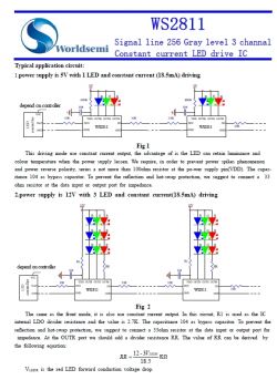

    @kaczodp Well, tell me what's the difference, apart from the fact that the WS2812 is a WS2811 with embedded diodes?
    Apart from that using a WS2811 will complicate the circuit considerably.
  • #24 18929749
    kaczodp
    Posts: 110
    Help: 6
    Rate: 29
    Several leds can be connected to the WS2811. It is then easier to diffuse the light.
    Freddy wrote:
    In addition, using the WS2811 will complicate the circuit considerably.
    To what extent does it complicate things? Diodes and possibly a resistor on the WS2811 supply. Better than fitting several WS2812 per segment.

    It does, however, get more complicated, because there is an integrated circuit, additional resistors and tracks.
    However, everyone can do what suits them better.

    Freddy wrote:
    Well, it complicates things, though, because there is an IC, additional resistors and paths involved.
    When leds were expensive, fibre optics were used to make them visible from several sides of the device. Now that they are cheap you mount several leds controlled from the same output.
    What will be cheaper, use WS2811 + several leds etc and a piece of plastic to diffuse the light or one WS2812 and develop a suitable diffuser and manufacture it later? At what quantity will the cost of developing the diffuser be recouped?

    kaczodp wrote:
    What will be cheaper ....
    I assure you that using for example 2x WS2812.
    Don't forget that the PCB designer also has to get paid and will lose much less time for a board with WS2812.
    There is also the cost of the laminate.

    Freddy wrote:
    Don't forget that the PCB designer also has to get paid and will lose much less time on a board with WS2812.
    This is not a commercial project and the designer is doing it for pleasure so time does not count.
    In a large scale project yes, on the small scale in question here the cost of the laminate is irrelevant.
    For small volumes, developing and making a good diffuser will be expensive and rather more expensive than modifying the electronics.
