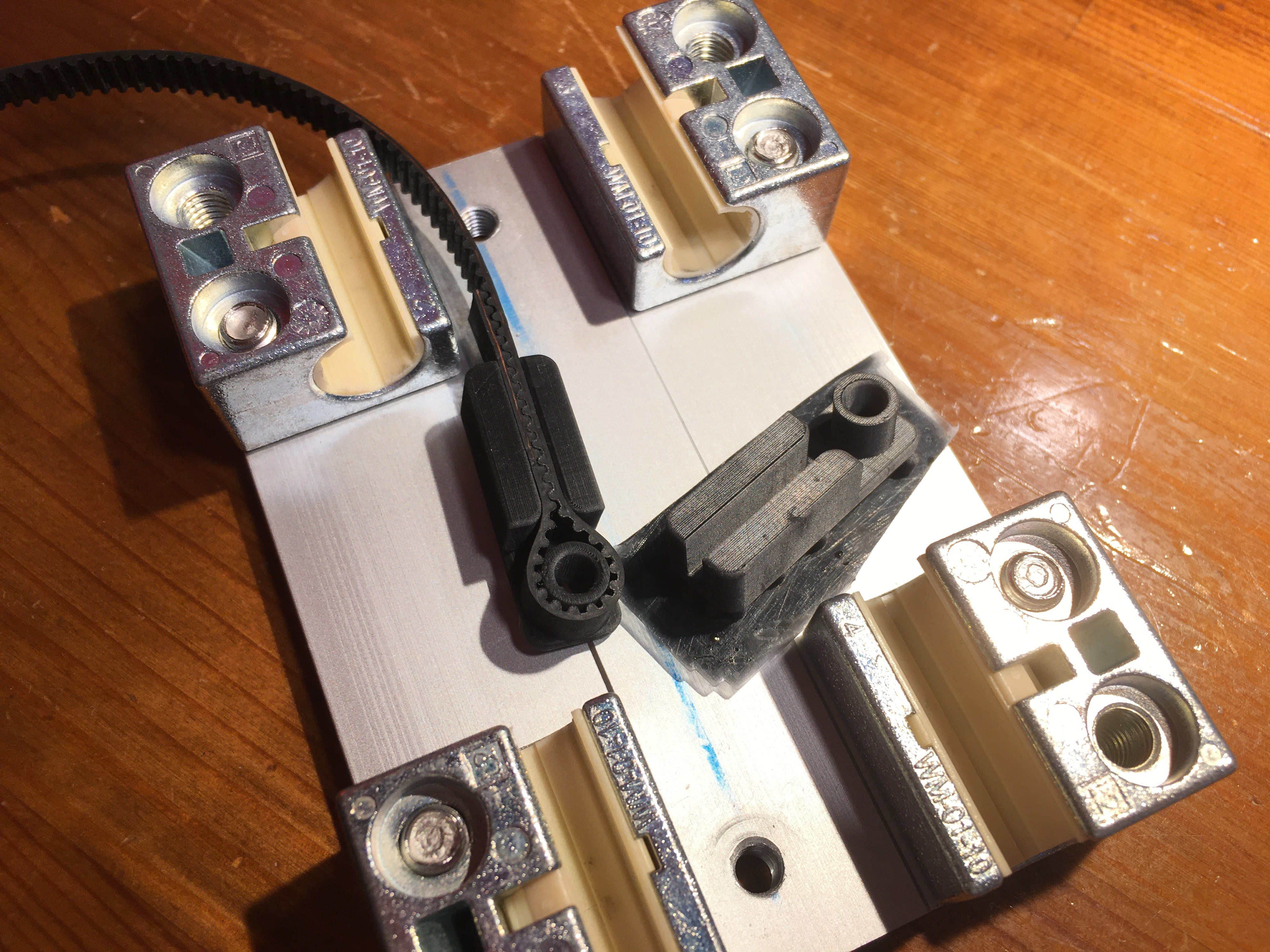

A DIY filament 3D printer was built from T2040 and v-slot profiles, an IGUS linear guide for the Y-axis, and stepper motors from storage.
The design used a BigTreeTech SKR1.3 controller, TFT43 display, TMC2208 3.0 UART drivers, M8 threaded rods for Z, and FR4-made mounts and belt tensioners.
Core parts included an MK8 extruder and an E3D v6 hotend, while an early CD-ROM-drive concept was dropped as too limited.
After quick calibration of the table, extruder, and Z-axis, the amateur prototype started working perfectly.
The first prints were made on a table with no cable tidying, and a primitive filament cleaner was added later from a tissue and paper clip.
The 3D printer is a subject that has interested me for a long time. I thought my own 3D printer was completely out of my reach, until I had my first exposure to an Anycubic Photon resin printer that I got for repair. Once the equipment was up and running I was able to play around with printing. I went nuts However, the time to print a part took too long for me, so I became interested in the subject of filament printers. I had a couple of T2040 and v-slot profiles in stock with rollers and gantry plates, so I set about bolting them together. I also had a 'sample' linear guide with carriage from IGUS-this was my Y-axis. I purchased a BigTreeTech SKR1.3 controller with TFT43 display and TMC2208 3.0 UART motor drivers. The stepper motors had been lying in my cupboard for a few years. Now they have come in handy. For the Z-axis I used M8 threaded rods (ordinary, rolled ones from the market). I made all the necessary motor mounts, belt tensioners (and more) from FR4 2mm laminate. I bought an MK8 extruder and a HOTEND E3D v6 and a few small things and after a few days the launch took place. I should add that I had originally thought of an experimental design based on old CD-ROM drives, but I now know that this would have been pointless due to the very slim possibilities. The printer, after a quick calibration of the table, extruder and Z-axis, started working perfectly immediately (perfectly for an amateur design built "on the knee"). Today this machine is in the process of being expanded, on components printed by itself but I would like to present what was then created driven by dreams. At the time, as it was a prototype, I didn't think about tidying up the cables - I put everything together on a table and the first prints were created under these conditions.

Bravo for your self-denial in creating your device.
What kind of working area did you come up with?
Think about replacing the screws with trapezoidal ones. [Read more]

Although the table was 235x235mm the range of movement was limited to 150x200mm. [Read more]

I do the levelling "on a piece of paper". I do this with the table and nozzle warmed up to operating temperature.
Exactly. My guide is also so short :) But I later replaced the guide with linear... [Read more]

Of course, I had to calibrate the Z-axis movement. I established an initial reference point and used the controller to raise the Z-axis by a few cm and then measured with a calliper by how much the height... [Read more]

TL;DR: A DIY FFF printer ran on Marlin 2.0 with SKR1.3+TMC2208, and the control bundle cost 127.71 PLN; the builder "measured with a calliper" to dial Z-steps. [Elektroda, Bobo[PL], post #19008176]
