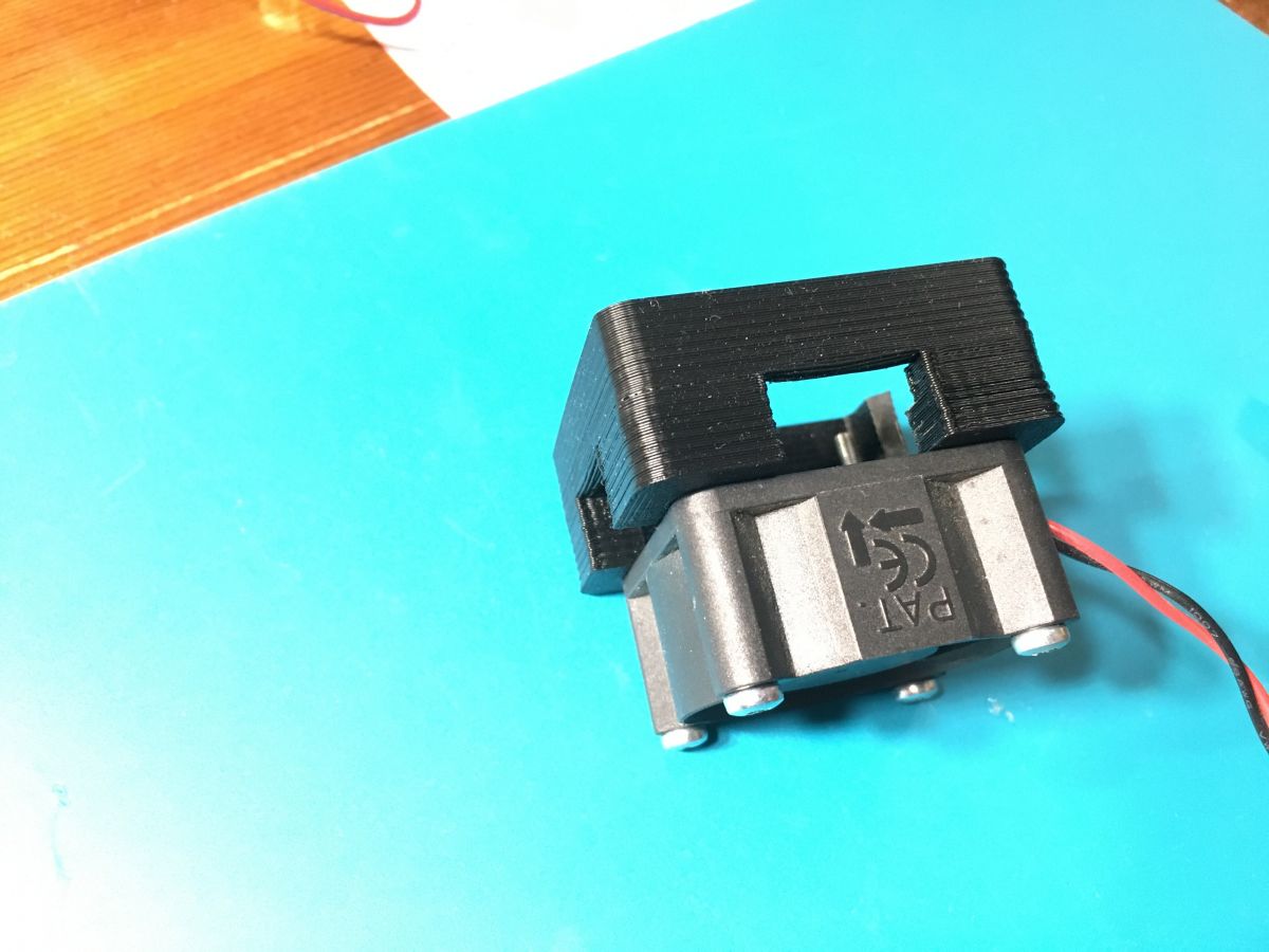

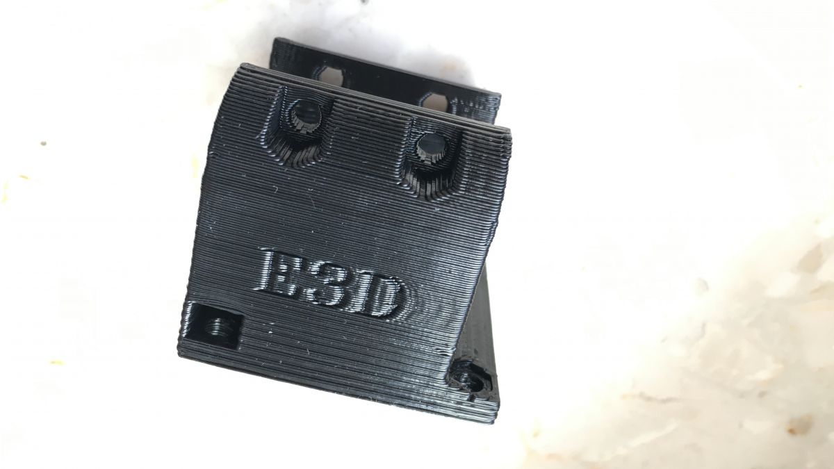

    edit: some more photos:
    i made a primitive filament cleaner out of a tissue and clipped it with a paper clip ;)

    After mounting the fan for cooling the filament, I had to thermally insulate the heating block of the head. For this I used a cotton pad and kapton tape. Excellent results :)
