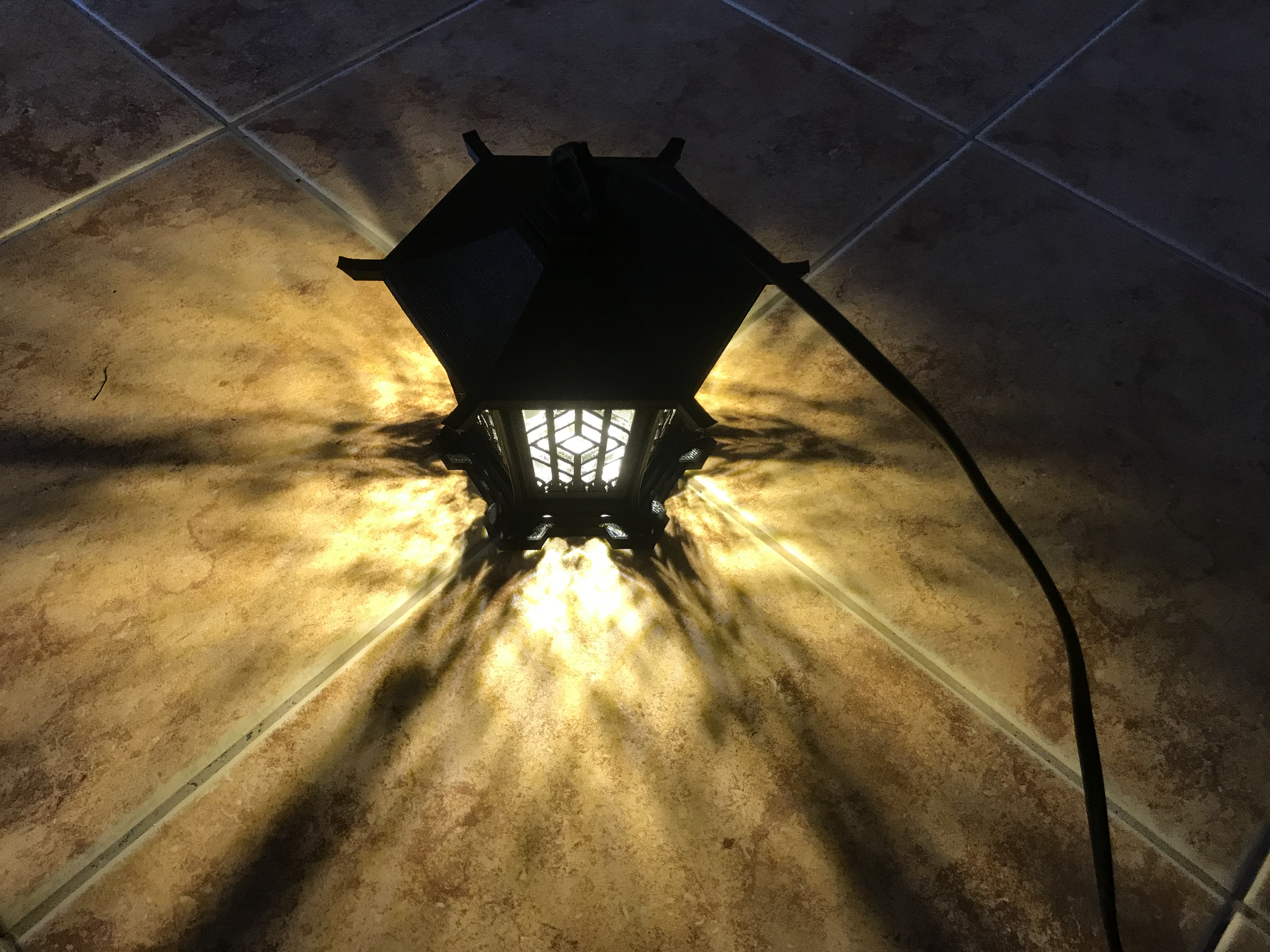

To celebrate the upcoming holidays, I would now like to present a slightly looser project. This will be a 3D printed lantern based on a 3D model available under a CC licence and my various improvements.
Used 3D model
The design is based on the 'asian lantern' model by Keenan from Thingiverse, from here:
https://www.thingiverse.com/thing:65837
This model is available for free under a Creative Commons licence:
This model consists of two parts - a canopy and a base. The canopy attaches to the hooks, with a press fit.
But just printing it out is only the beginning, so below I will describe in detail the whole process of making my lamp.
First printout
I made the first print still using black PLA filament, then switched to white. The object does not require any support:
Print of white, larger:
At first, I printed the objects with the default fill value (infill):
but you don't need that much of it, even at 5% it holds everything solidly.
I printed everything on my 3D printer Ender 3 Pro.

Lighting connection - bulb and E14 thread
In the end, I decided to fit E14 threaded fittings to the centre:
For this purpose, I designed my own nut/thread for E14. It also has screw holes to connect it to the 'cap' from the lantern:
Assembled:
The bulbs I had on hand; the largest one does not fit into the housing, while the milky LED one is just right:
Final result:
Same, but with a white mount:

An important issue - heating of the filament
In the case of the bulbs I used, the heating of the printed component is not noticeable at all, there is no problem with it. Nevertheless, it is worth pointing out that if one uses a stronger light source then by all means PLA can warp and melt, especially if the lamp is lit for a long time. This can partly be solved by using a more heat-resistant filament, such as ABS.

Black lantern with LED module:
I'll add more photos when the opportunity arises.
Summary Summary
I am as happy as possible with the printed lights - in fact, I printed them as a gift for someone (on a specific request, having already selected the model in question from Thingiverse). For this reason I will give more pictures when I get the chance. The lights look good and don't get hot at all, and the use of 3D printing makes them even more attractive and easy to modify and customise. There is also no problem with making another lamp for the set - all you need is a filament of the same shade, print and you're done.
