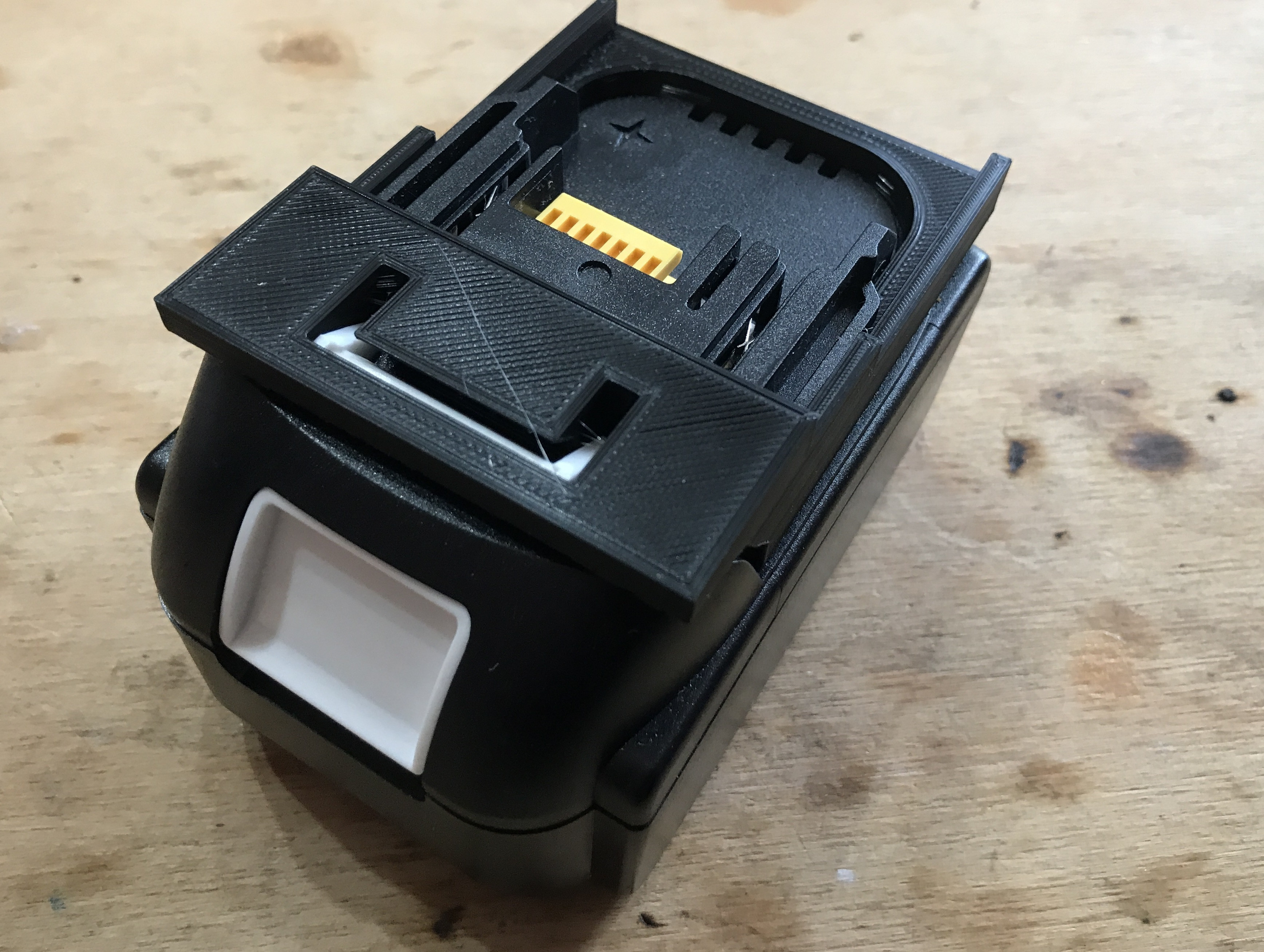

I designed the adapter from 0 in Blender 2.79.
I will show the steps here with a short commentary.
I did the whole project with the Mirror modifier (mirror image), as both sides of the adapter are symmetrical.
I started with this section:
Fitment. The hitch works, the printed adapter holds solidly to the battery.
I did the rounding using the Bevel tool:
Guides (I use Extrude to build the model, also I often add walls/edges by hand using F):
The build-up and space for the abutment:
Print:
Fitting:
Now the contacts have to be made. I only had an old (cheapest possible) soldering iron stand at hand:
In terms of attaching it, I decided on a single screw hole, as long as the sheet metal matched the print that was enough. I made the holes using a Boolean modifier:
Just the thickness of this sheet metal fits:
Cut the plate and the adapter base is ready.
