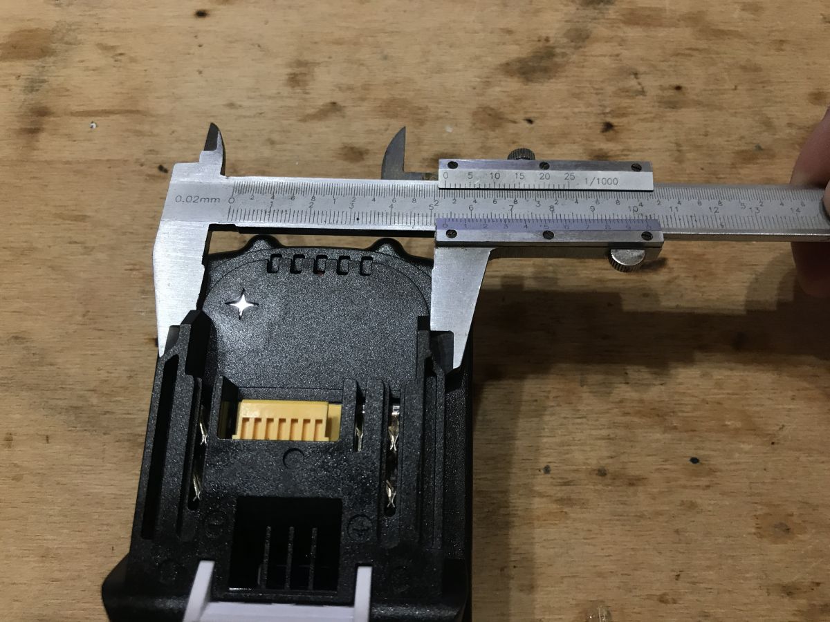

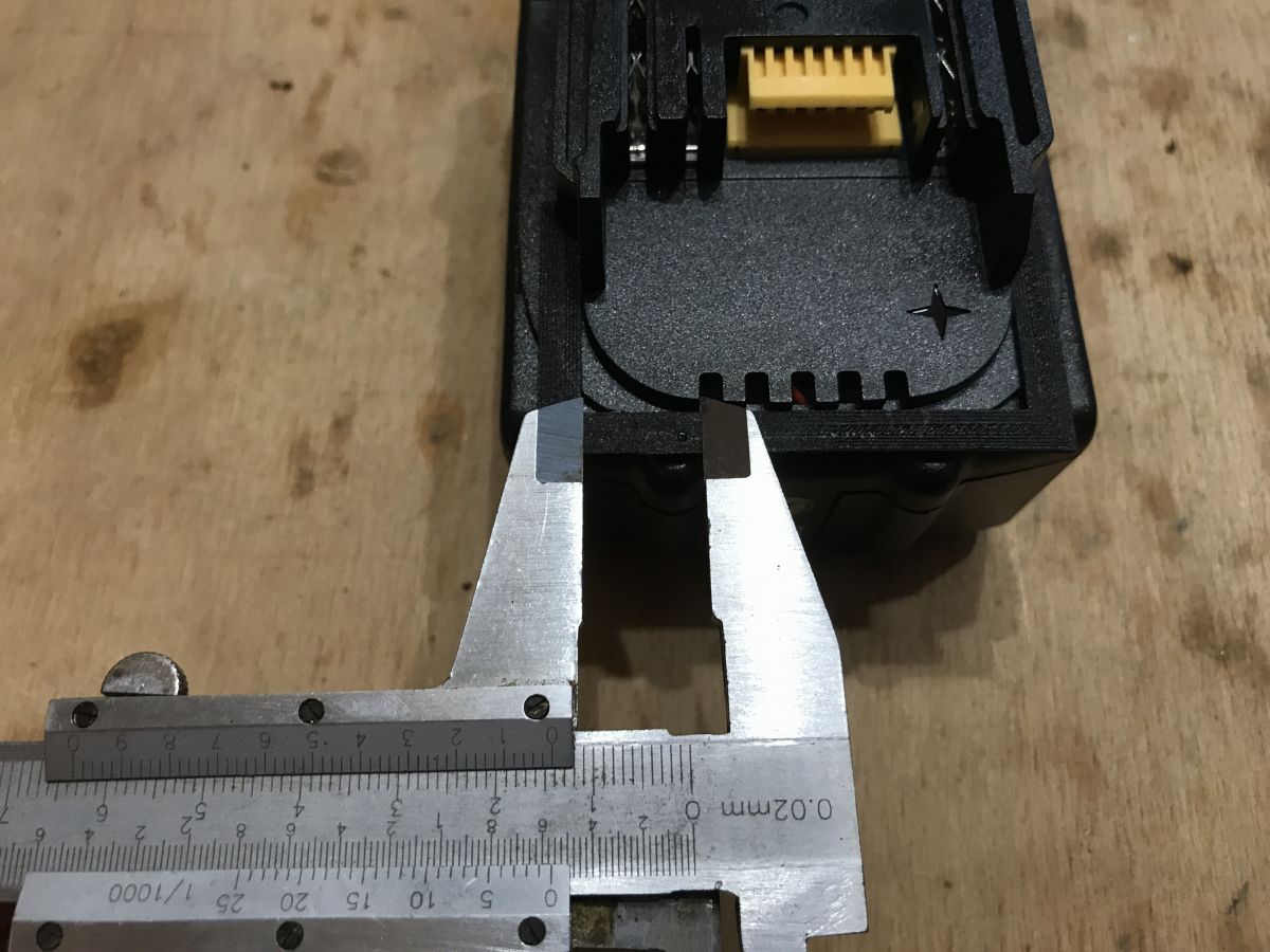

    How does the connection to the battery look like?
    The connection is very simple. The battery slides into the two guides, the screwdriver has two metal contacts and a recess for the clip:
    Design and printing of an adapter/cap for the Makita BL1830 18V battery pack Design and printing of an adapter/cap for the Makita BL1830 18V battery pack
    We will need to design our 3D object so that it has these guides of the correct dimensions, so that it can be fitted with contacts (cut from sheet metal of a certain thickness) and so that it has an indentation for the battery clip.

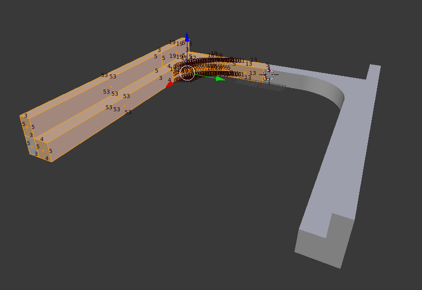

    Design the adapter in Blender
    I designed the adapter from 0 in Blender 2.79.
    I will show the steps here with a short commentary.

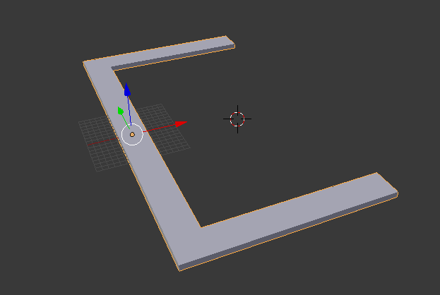

    I did the whole project with the Mirror modifier (mirror image), as both sides of the adapter are symmetrical.
    I started with this section:

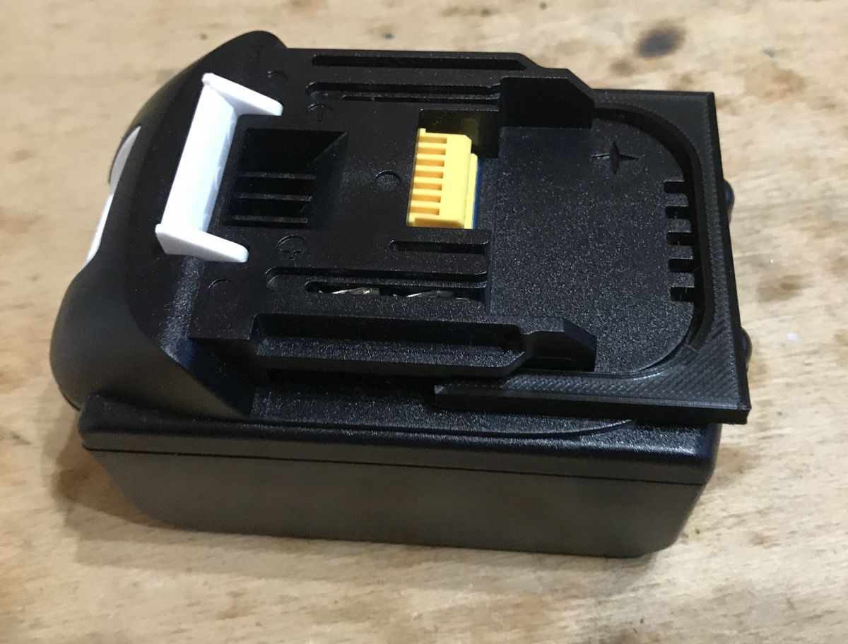

    Fitment. The hitch works, the printed adapter holds solidly to the battery.

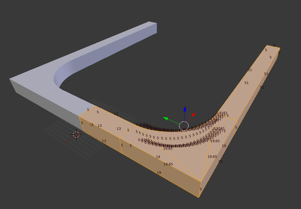

    I did the rounding using the Bevel tool:

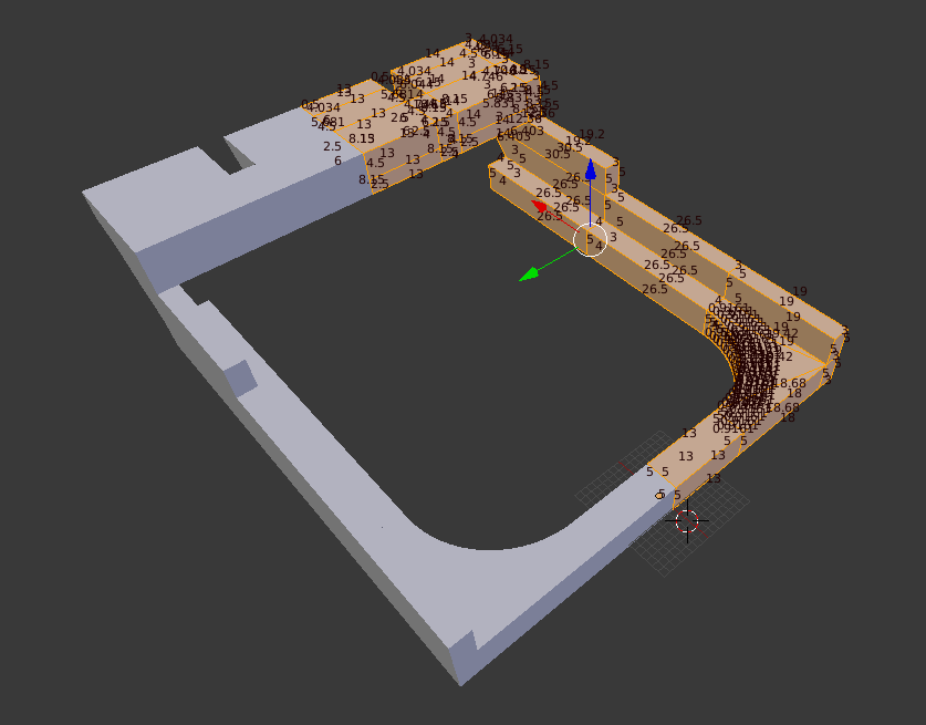

    Guides (I use Extrude to build the model, also I often add walls/edges by hand using F):

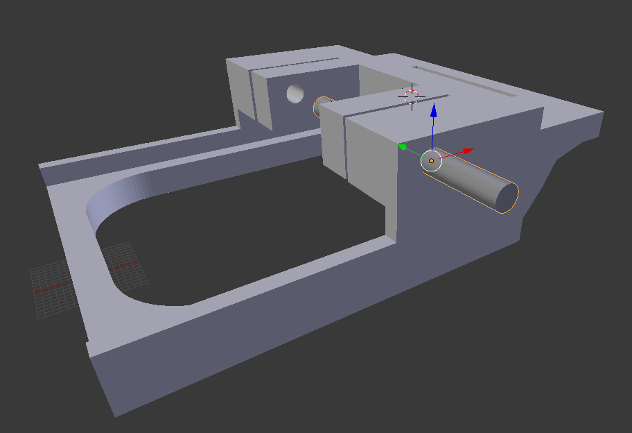

    The build-up and space for the abutment:

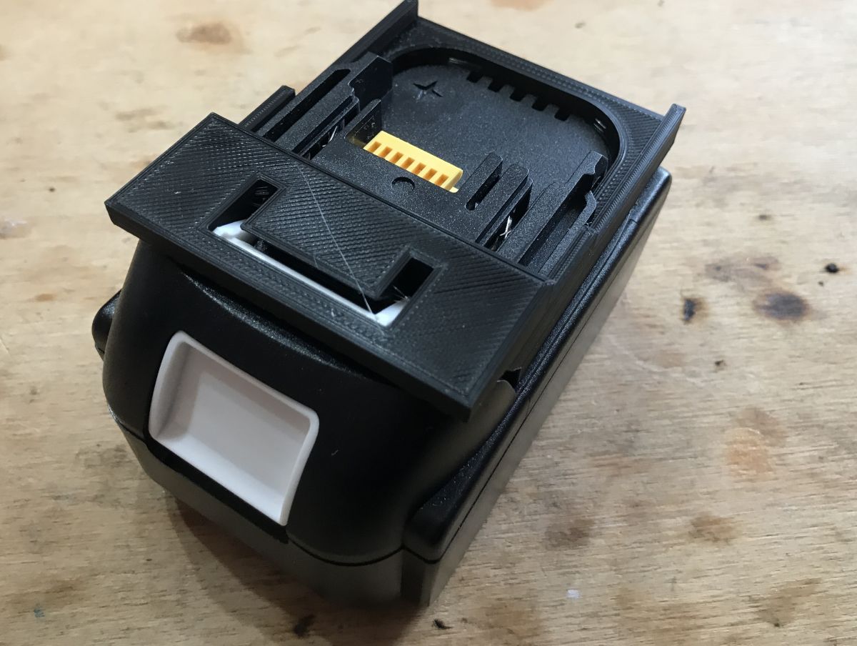

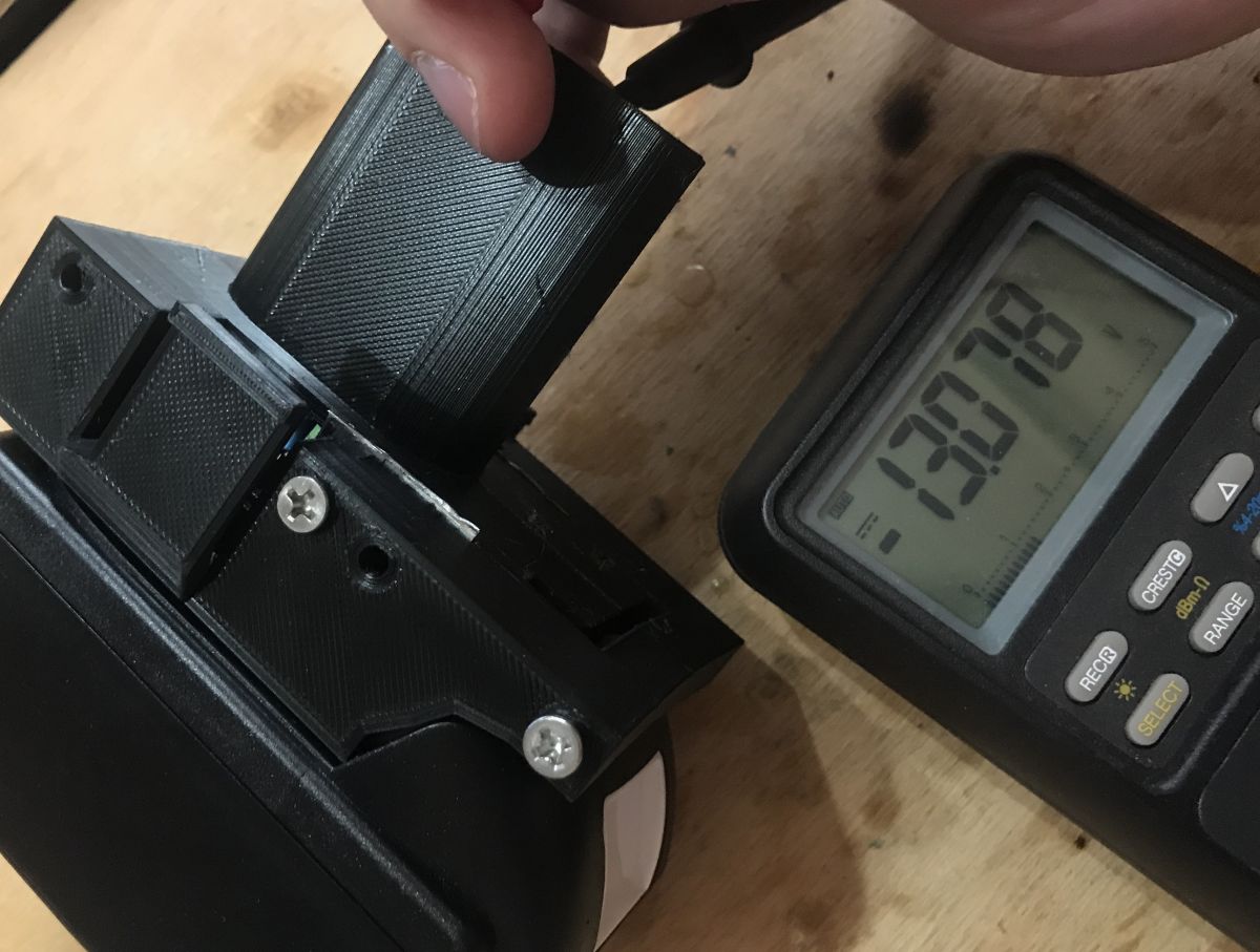

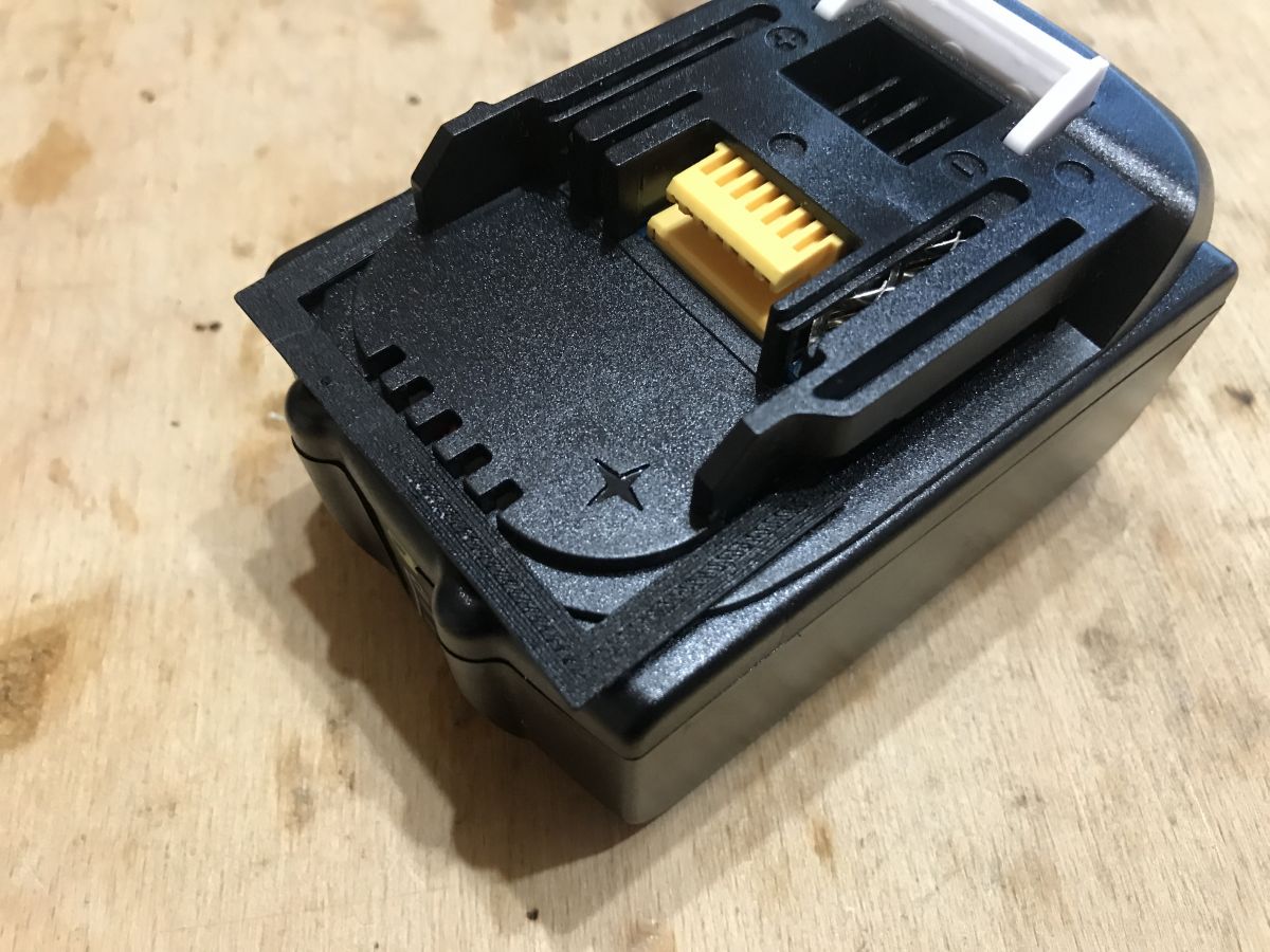

    Print:
    Fitting:

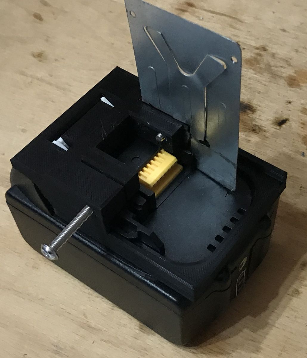

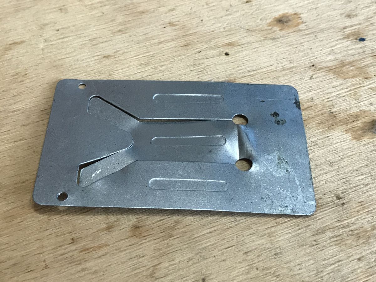

    Now the contacts have to be made. I only had an old (cheapest possible) soldering iron stand at hand:
    In terms of attaching it, I decided on a single screw hole, as long as the sheet metal matched the print that was enough. I made the holes using a Boolean modifier:
    Just the thickness of this sheet metal fits:
    Cut the plate and the adapter base is ready.

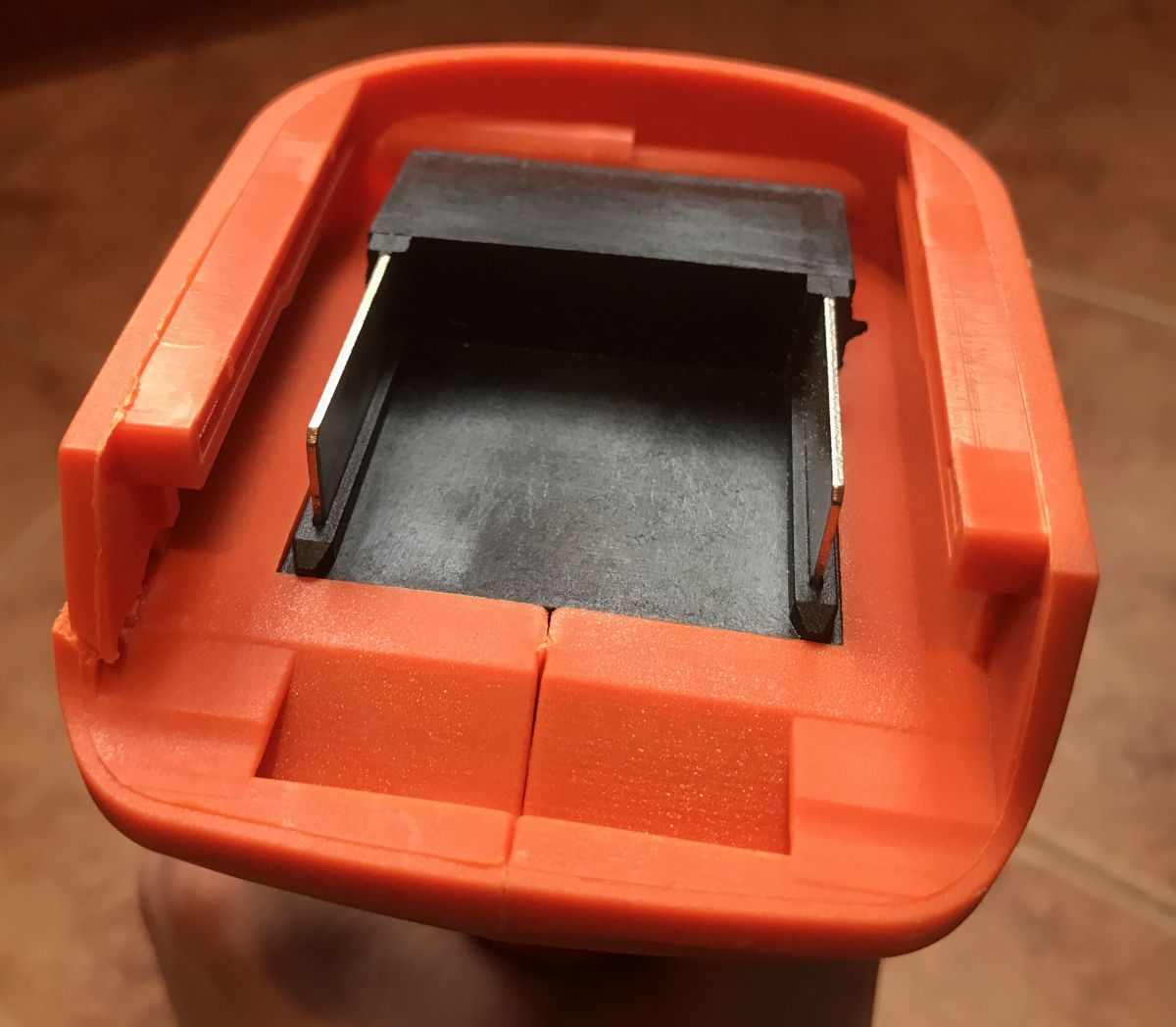

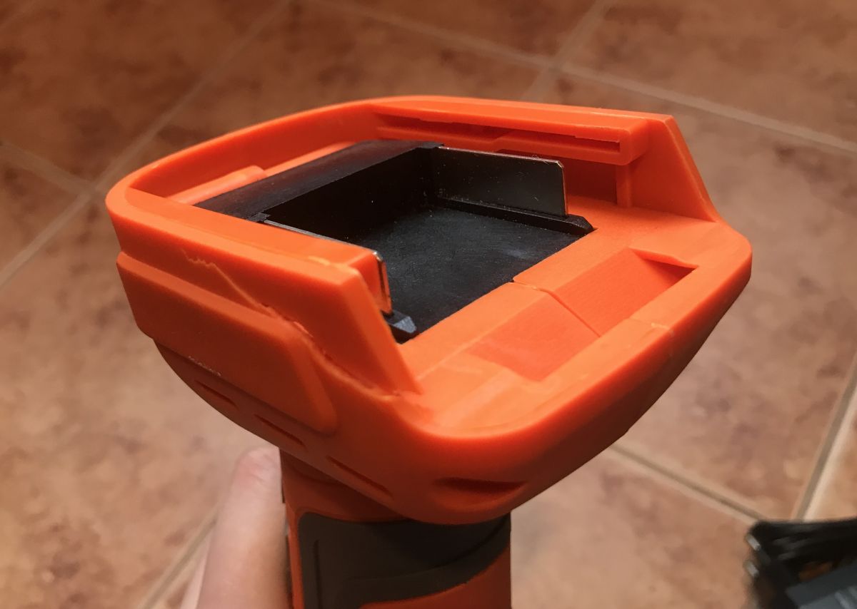

    Personally, I have started working on the first idea on the list, which is a Makita adaptor for an old (found on the electro junk) Skil 12V:
    In the photo above, the adapter already includes a step-down converter, as the Makita gives 18V. But about that already in another topic.
