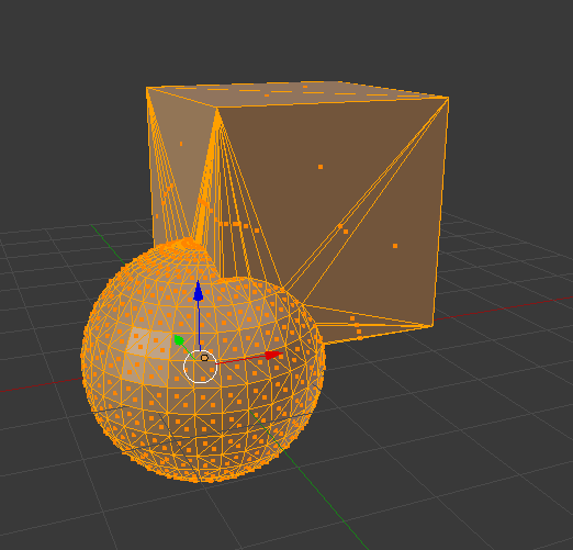

Demonstration of three boolean modes
I think it is still worth showing on simple shapes what the three boolean modes are.
NOTE: in the examples I have only used a cube (cube) and a sphere (sphere), these are convex solids, but in Blender boolean works on other shapes too, they don't have to be convex!
Two objects:
Their sum:
Common part:
Difference (cube subtracted from sphere):
I think this is a good illustration of how Booleans work in Blender (and beyond).
