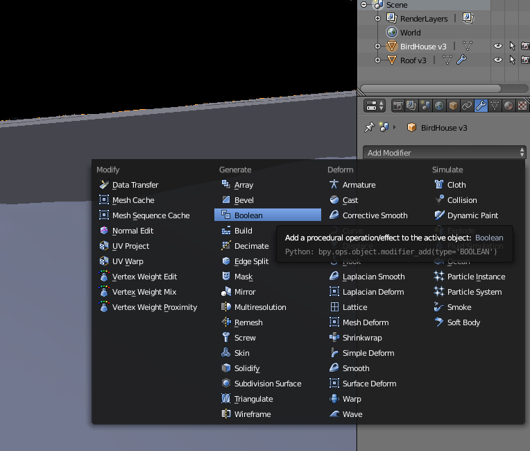

    Just use the boolean modifier. In Blender it works on even arbitrary shapes, even with a lot of triangles:
    Blender/Boolean - How to fit two STL print elements together
    In the newer Blender it looks like this:
    Boolean performs a boolean operation on two shapes. It adds, subtracts or combines the current object with the given selected object.
    The result (after Blender has been running for a while):

    Then you can possibly accept the boolean (replace the modifier so that its changes are saved permanently in the mesh, then the modifier itself disappears from the list):
