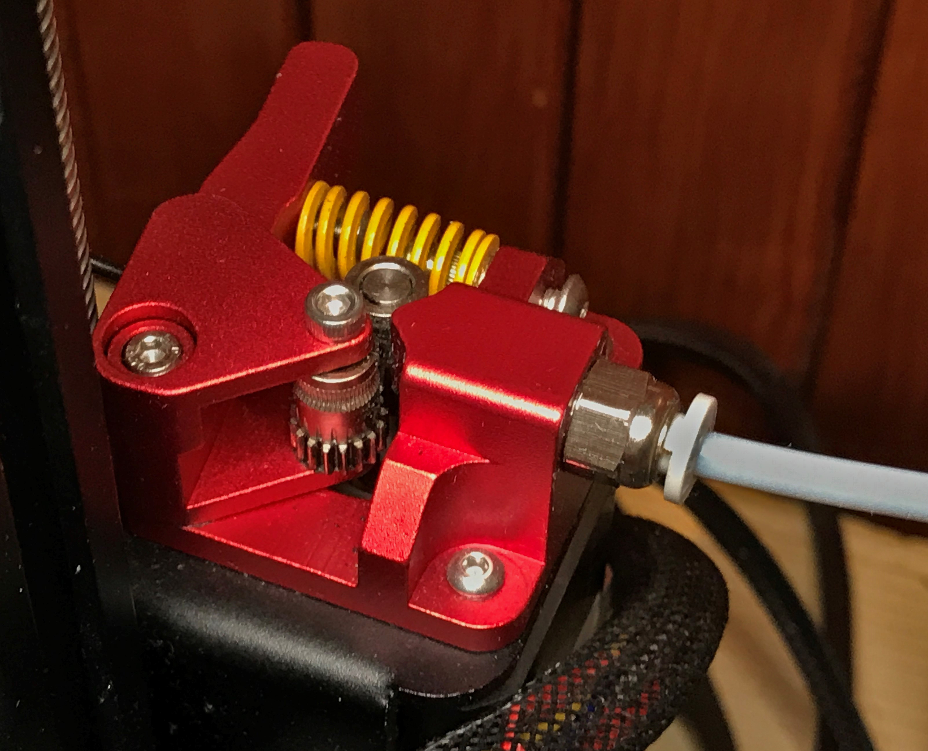

After some time I heard positive feedback about the dual gear extruder and decided to try it out:
In the end, however, I bought it in our country. It is time to describe its installation.
Installing the dual gear extruder
Installing this extruder requires unscrewing the stepper motor (when unscrewing, hold it so it doesn't fall), as well as removing the gear from the motor shaft (it's held on by a small screw), and (of course) removing the bowden tube.
Below are some photos of the assembly.
Kit:
Kit contents:
Bearing and arm assembly:
Before removing the old extruder, of course we warm up the hot end to remove the filament (we do not remove the filament "cold" by pulling it out by force, I hope we know that this is not the right thing to do):
Disassembly of the previous extruder. You can clean everything by the way:
If you unscrew these screws the engine will drop. It needs to be held in place.
Disconnect the cables:
I used a trace amount of WD40 to lubricate the bearings (the two black parts shown in the photo) as I didn't have anything better at hand, although I know it's not a good solution (lithium grease, for example, would be better):
Removing the cog from the extruder stepper motor shaft. The little black screw needs to be removed:
Remember to use screws with a flat head (otherwise the extruder arm will snag on it):
Dual gear extruder base pre-screwed already with motor:
Prepared cog for the motor shaft (small screw visible at the end of the screwdriver):
Adjusting the height of the cog. It must be in line with the line of the filament (I put white in the bowden tube for a test):
Only after levelling do we press the cog onto the motor shaft with the screw.
Assembly of the movable arm. The second cog must be at the height of the first one:
Tightening the screw (first we need the one in the photo holding to the motor base):
Done:

After fitting the dual gear extruder I specifically waited a good 4 months of printing (and the printer works for me a lot) to finally give a verdict. I didn't want to judge in advance, and additionally I waited until the famous "rubbing" of the cog against the arm appeared, however it didn't happen at all in my case, even though I took a relatively cheap (cheapest?) dual gear extruder.
Perhaps this is because I raised both cogs appropriately and matched their height to the filament line.
In any case - revelation . The quality and convenience of prints has permanently improved. Previously, I had occasional problems with the bowden, sometimes with the hot end, every few weeks I had to unplug it, or I saw, for example, that the extruder motor "ticks" (loses steps, 'extruder skipping'), or even the filament slips, extrusion or retraction does not extend/retract the filament as much as the printer would expect (and I had calibrated e-steps)....
And now the problems are practically non-existent - this new extruder solidly holds and feeds the filament, it is not afraid of possible dirt or there older spools of plastic. I regret that I did not buy it earlier.
I don't know if your experiences are similar, but I still have to add something at the end - NOTE - swapping to a dual gear extruder should obviously not be used as an alternative to removing heat creep, levelling the table or cleaning the nozzle there. The table has to be leveled anyway, as well as the bowden should be properly fixed, etc. etc. The printer must be taken care of.
