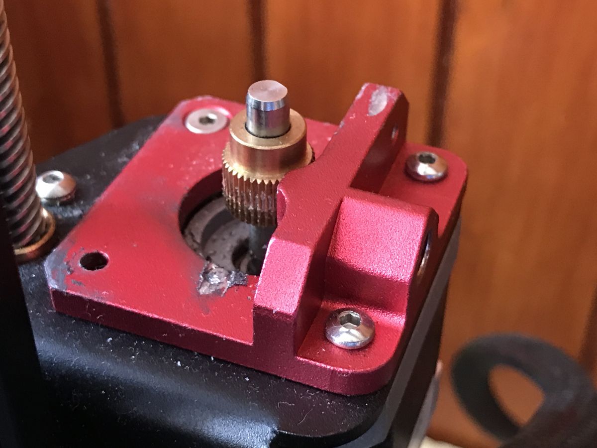

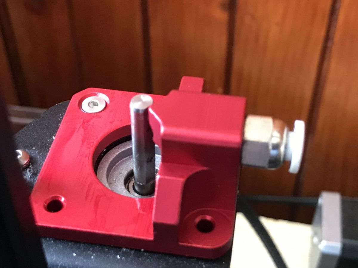

    Removing the cog from the extruder stepper motor shaft. The little black screw needs to be removed:
    A good extruder for the Ender 3 Pro? Dual gear extruder. My impressions. A good extruder for the Ender 3 Pro? Dual gear extruder. My impressions.

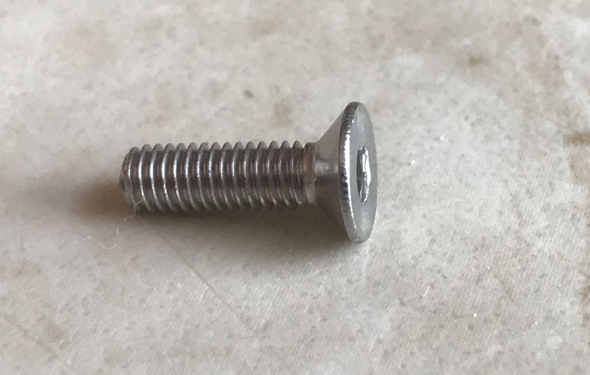

    Remember to use screws with a flat head (otherwise the extruder arm will snag on it):

    Prepared cog for the motor shaft (small screw visible at the end of the screwdriver):

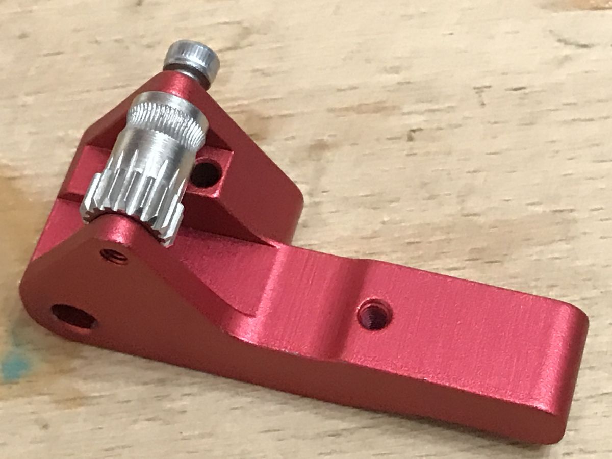

    Adjusting the height of the cog. It must be in line with the line of the filament (I put white in the bowden tube for a test):
    Only after levelling do we press the cog onto the motor shaft with the screw.
    Assembly of the movable arm. The second cog must be at the height of the first one:
    Tightening the screw (first we need the one in the photo holding to the motor base):
    Done:

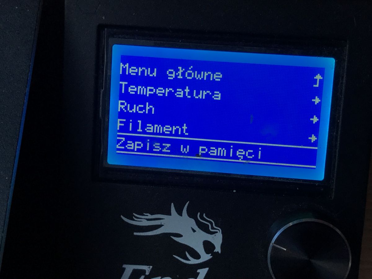

    8. Save changes to EEPROM
    A good extruder for the Ender 3 Pro? Dual gear extruder. My impressions. We save the calculated value also outside the printout
    We save the calculated value also outside the printer, on a piece of paper, in case we reset the EEPROM.

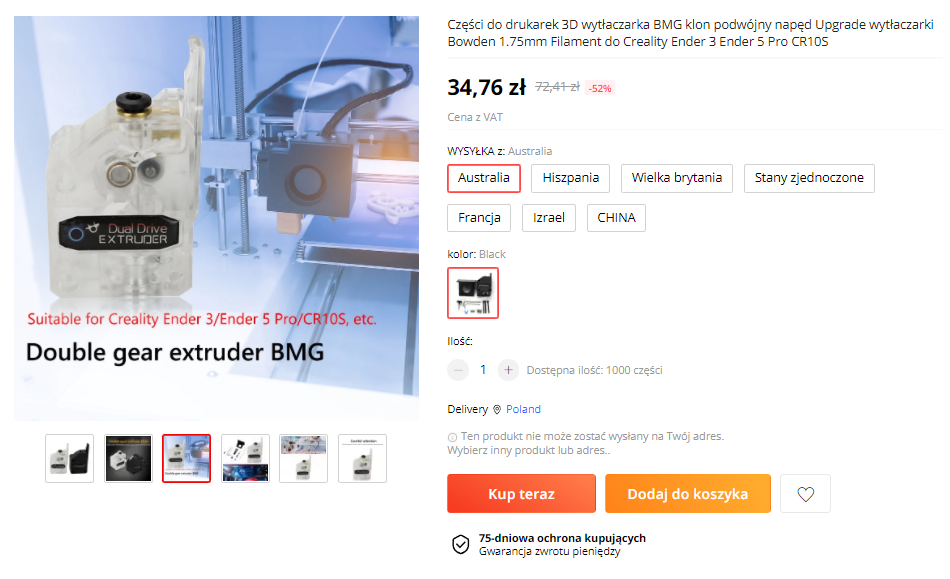

    @p.kaczmarek2 this extruder as presented by a colleague is total rubbish, well maybe not rubbish but shoddy, and it is slightly better than the stock one. The advantage is that it is dualdrive and does not skip. But the quality and accuracy of workmanship is poor. The clearance on the clamping arm is nightmarish and the needle bearing of the second knurl is mounted on a thread, not on a screw shaft. This extruder worked for me for about an hour I considered it a failure, it was replaced in favour of a cheap BMG clone. A cosmic difference in performance (not much in price, I gave about 20p for the red dualdrive and 32p for the cheap BMG clone) as if you had switched from a Polonez to a Mercedes. The BMG has a small disadvantage, it was too noisy with a high retraction value, but you can still see a big difference in the operating culture and prints in favour of the BMG.
    Therefore I agree 100% with the statement of my colleague @Fimek....
    After my tests of the cheap BMG clone I think that it is a good alternative in the ratio of quality and price, except that at fast retraction it goes too loud (even my neighbour pointed out to me and asked if it is at my place something all the time punch someone clicks :) ). I now have an M4 extruder printed from Voron on a belt and I will say this, it is luxus, seriously seriously seriously. Zero noise, just a gentle hum. I'm now thinking about another Vorona extruder on the strip to make a direct. But so far it's ok so the topic will probably wait.

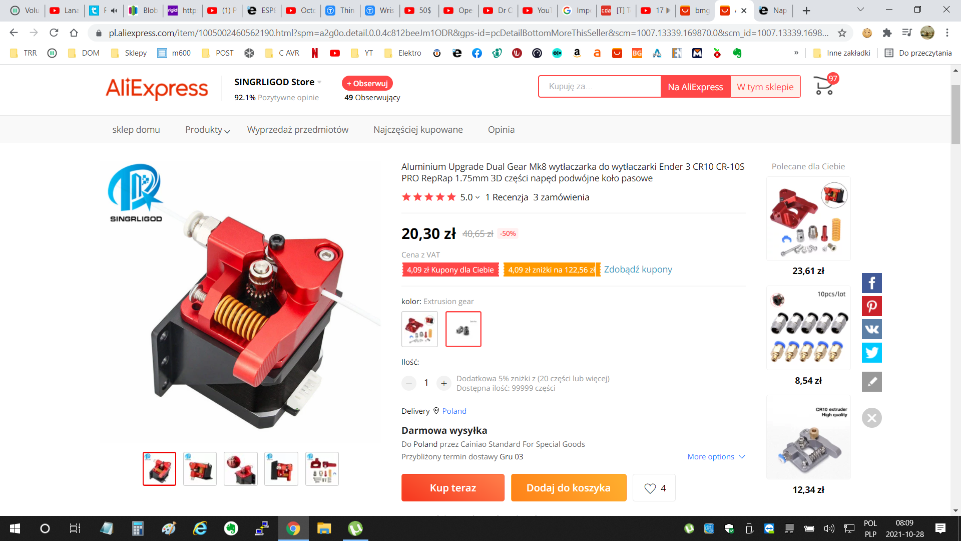

    @Fimek @adversus thank you for your suggestion, perhaps I'll try it out, although so far I'm not complaining about the one in the theme (still relative to the stock one)
    Fimek wrote:
    in favour of the BMG clone, which for PLN120 solves virtually all problems?
    The extruder pictured in the topic goes for 40-45PLN so it's a bit of a different price range though
    Fimek wrote:
    I'm not even talking about printers with a closed chamber, because such a basic extruder without a gearbox is simply not suitable for them (the motor has no way to cool down and problems arise even faster).
    Acctually at my place the printer is in a cool room and I didn't enclose it for PLA printing, so it's quite possible that these problems occur at my place but to an unnoticeable degree. I will check the heating you pointed out.
    adversus wrote:
    (at a small price, I gave about 20p for the red dualdrive and the cheap BMG clone at 32p)
    Where for 32 pln? I find offers supposedly at 32 pln but with blocked postage (some people are knocking down the ranking like that and you really can't buy for that price):

    Where for 32 pln? I find offers supposedly at 32 pln but with blocked shipping (some people so beat the ranking and you really can not buy for this price)
    @p.kaczmarek2 I didn't write when I bought, and the fact is that I bought before VAT was introduced, but in fact a quick search on Ali from today shows that it is possible to get a bargain (the black BMG clone is much cheaper). The other thing is that searching on Ali for cheap deals is fun because their search engine I have the impression doesn't quite work as we would expect.
    0Of course you also have to wait a bit for delivery as it happens with purchases on Aliexpress, but it is possible to buy cheap:

    And maybe one of you could help with the topic of fan selection for the Ender? I have set up a topic: https://www.elektroda.pl/rtvforum/topic3841610.html#19678553
    Today I put on the silent motherboard for the Ender from Creality v4.2.7 and it is heaven and earth :) Something to think about with the blowing.
  • #19 20197531
    czaczus22
    Posts: 61
    Rate: 25
    Hello,can someone share the Polish
    Firmware for ender 3 pro ver 2.4.7 .I can't find it anywhere and don't want to start a redundant topic.
