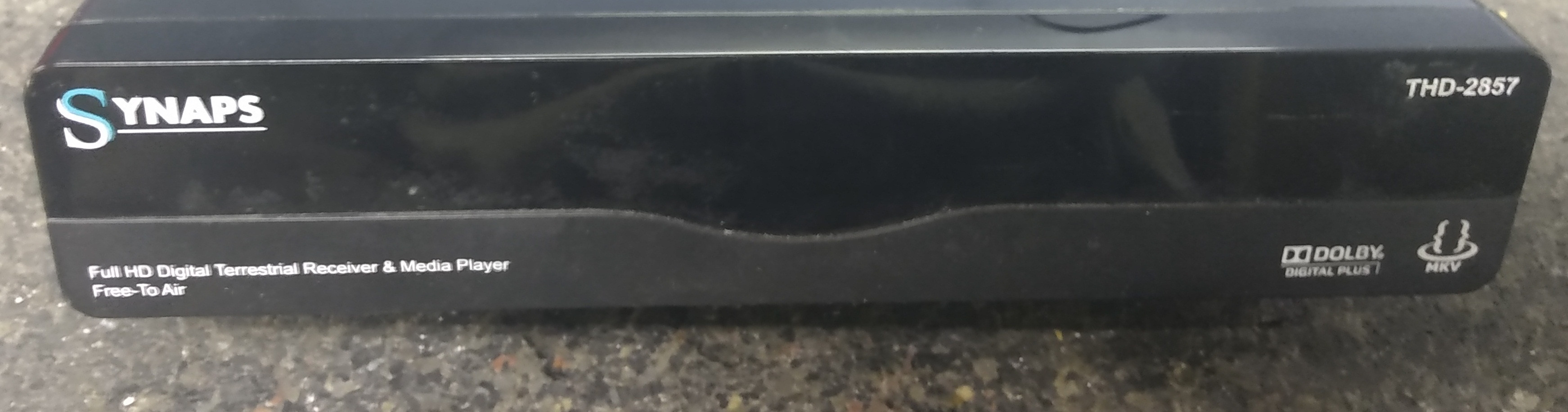

Nearly twelve years have already passed since the introduction of digital terrestrial television in Poland ( Digital Video Broadcasting - Terrestrial ) and a newer version, DVB-T2, is already being launched. The very introduction of DVB-T was a kind of revolution, and the complete switching off of analogue transmitters forced the purchase of new TV sets or external decoders. Any day now, the new technology will come into permanent use and the majority of current devices will be discarded or replaced with newer ones supporting the new standard.
A lot of completely working equipment will simply go to waste :-( . One of my neighbours has a habit of 'tossing' me all sorts of equipment that he wants to get rid of and I may be able to use something of it :D . Walking into the workshop this morning I saw the title character waiting for me;
The decoder is complete with remote control and completely operational. I don't use DVB-T (I don't even have an aerial) and anyway a change in broadcast standard will make reception impossible. The case is not a typical plastic box and is, apart from the front panel, made of steel, the first thing that came to mind was the use of the case. It even fits perfectly into this frequency killer .
Fitting
So let's take a look at what can be used in addition to the housing :D . The interior, as you can see from the photograph below, is relatively poor, which was to be expected given the manufacturers' use of highly specialised integrated circuits :D .
