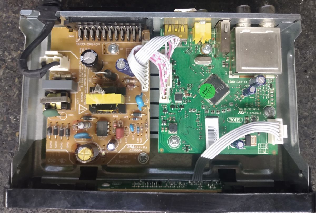

    So let's take a look at what can be used in addition to the housing :D . The interior, as you can see from the photograph below, is relatively poor, which was to be expected given the manufacturers' use of highly specialised integrated circuits :D .
    DVBT decoder Synaps THD-2857, looking inside

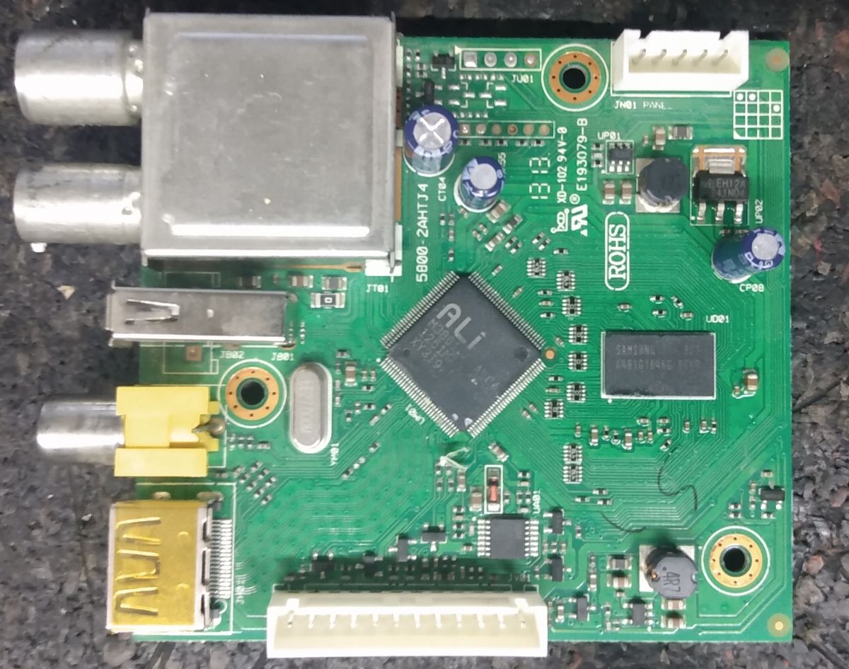

    So let's take a look at the main PCB;

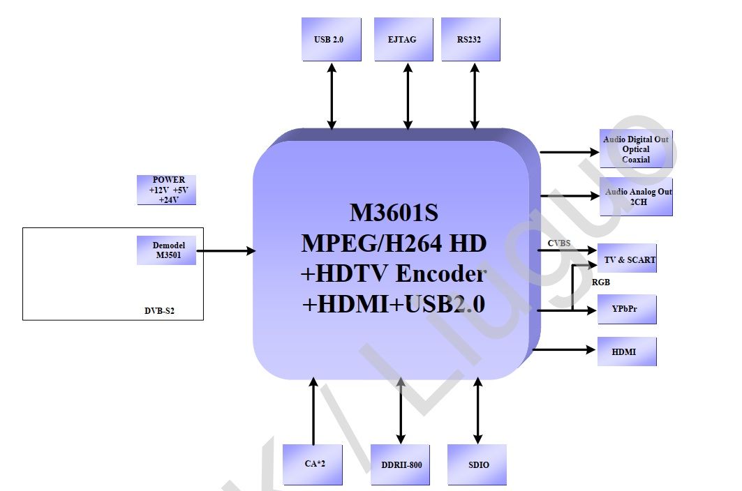

    At the heart of the decoder is the ALi M3801 ALCA, it is a so-called STB or Set Top Box. This is what manufacturers call complete decoders as well as specialised processors for video and audio processing. On the web I was only able to find information about the M3601S, but here there are probably no major differences;
    Right next to it is the RAM K4B1G1646G-BCK0 from Samsung, this is a 1Gb DDR3-based SDRAM in a 64M x 16bit organisation. Right next to the power/SCART connector is the SGM8903, this is a dedicated line buffer for stereo analogue audio;

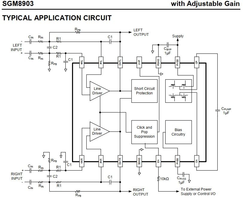

    This acts as a match for the differential signals from the output of the ALi M3801 DAC to a typical line audio input (SCART), below is a typical circuit application;

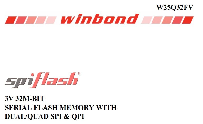

    This flash memory and SPI interface contains the decoder's firmware. Another component is the power supply unit which also contains the SCART connector;

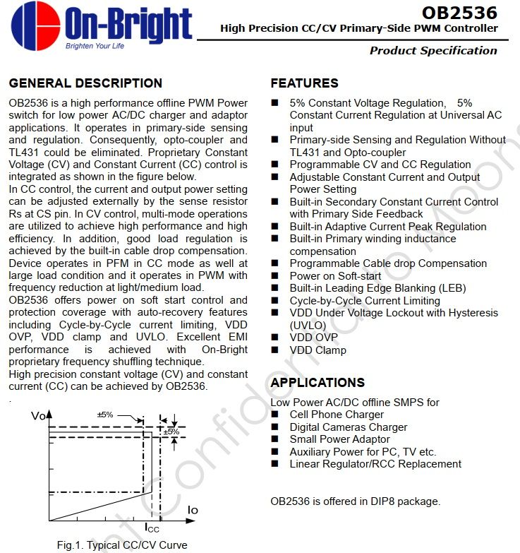

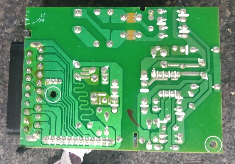

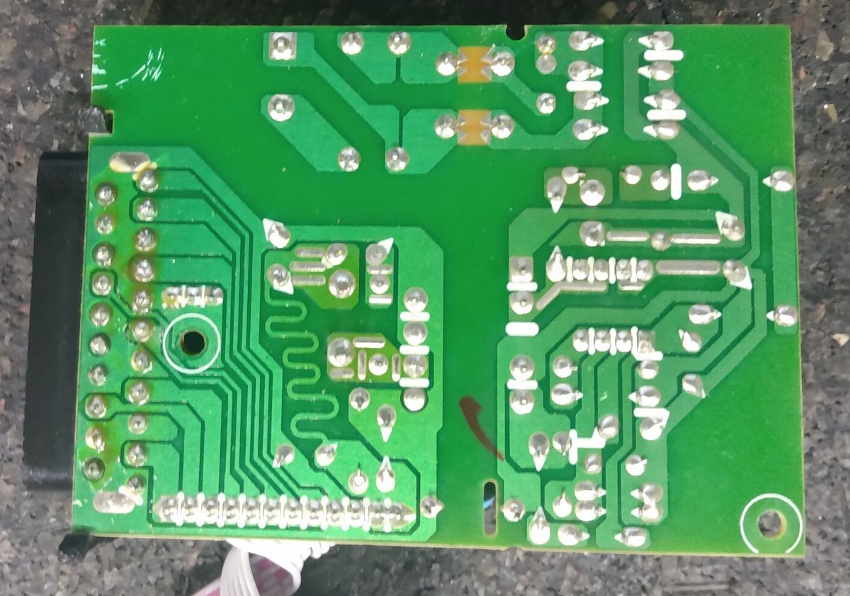

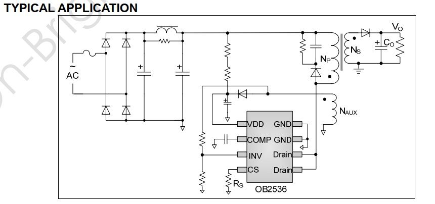

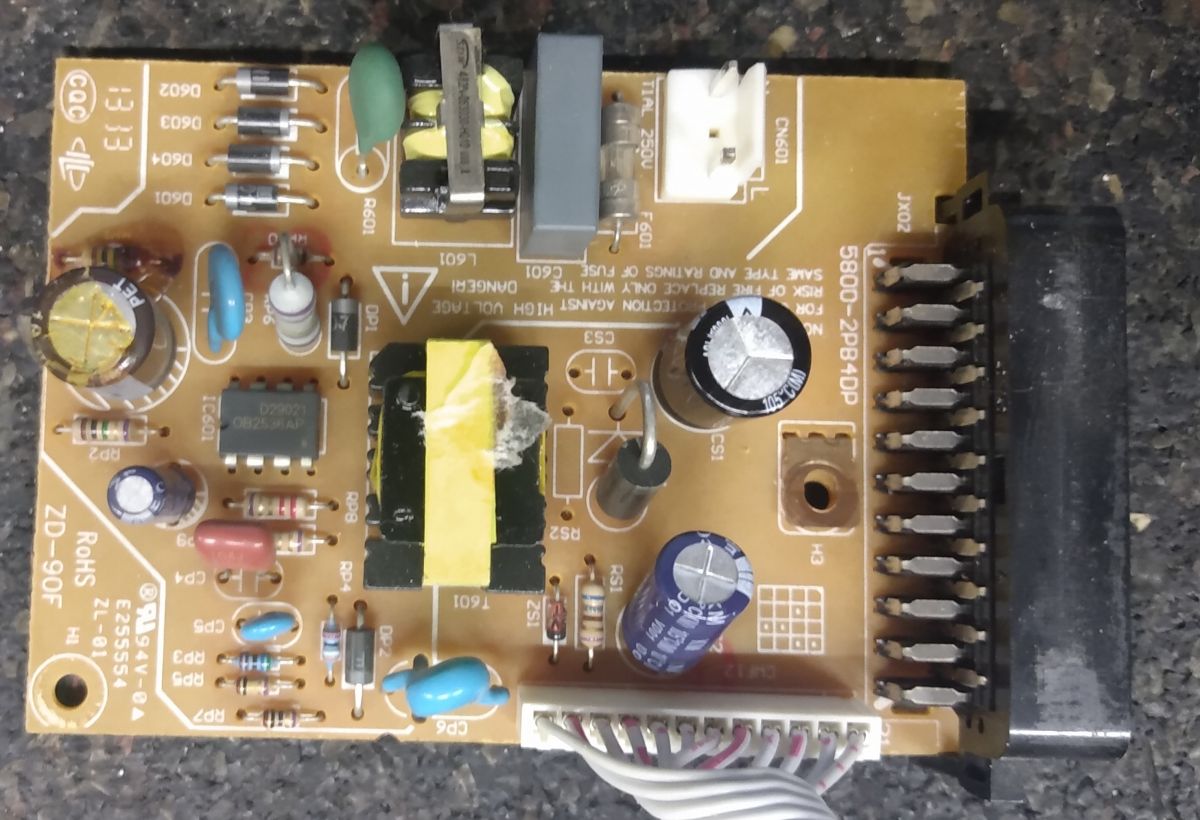

    The role of the power supply controller is performed by the OB2536 chip from On Bright, this is a specially designed driver for low-power power supplies or chargers;
    The power supply provides 5VDC and about 1.5~2A max, the SB360 diode (3A/60V) acts as a rectifier. According to the description on the decoder case, the power consumption from the mains is 12W max. The power supply board has been made quite decently with a sufficiently large insulation gap;
    The visible narrowing of the path is probably meant to act as a fuse :D There is still the front panel left, this one has been simplified to the limit;

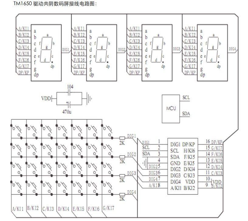

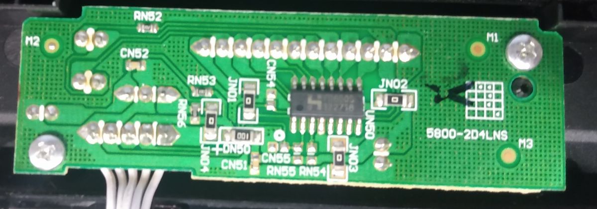

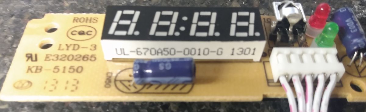

    Responsible for display control is the FD650S which is a clone of the TM1650S, it provides four seven-segment displays and a 28-button keypad, communicating via an I²C interface;

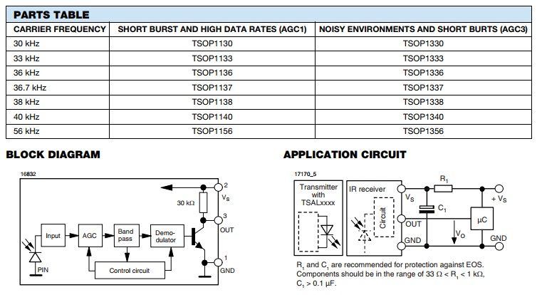

    The infrared receiver is a TSOP1338 manufactured by Vishay, admittedly not recommended for new devices but.... The receiver operates at 38kHz (IR carrier);

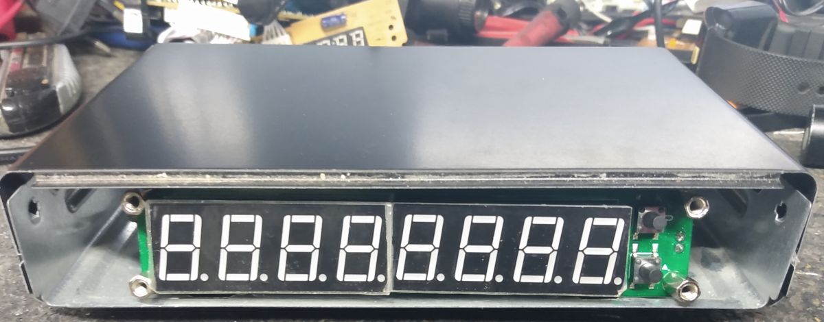

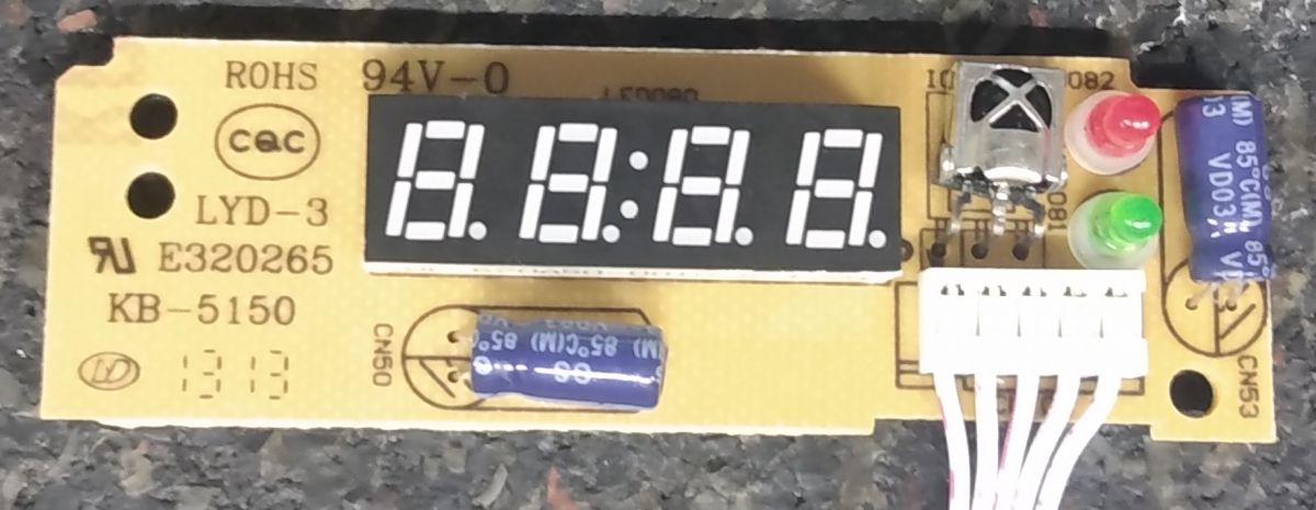

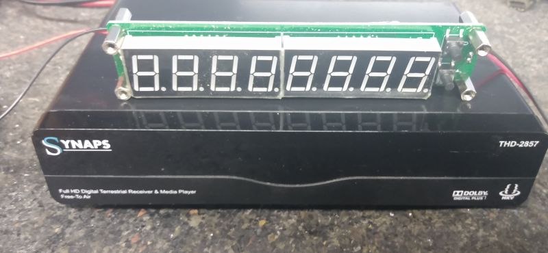

    The LED display is also interesting, the character and segment shapes are reminiscent of those used in communist times :D . We have a +5V power supply ready to go, and with the main board removed, there is room left to put in a couple of 18650 Li-Ion cells. Perhaps a battery-network version could be made?
    I need to look for material for the front panel acting immediately as a bezel for the very bright meter display. Let's not throw away immediately used equipment, let's first check what we can use :D .
    Maybe laminate? I'll post a topic any minute about the practical use of laminate as a case material - front panel too.
    https://www.elektroda.pl/rtvforum/topic3882992.html
  • #5 19954780
    ArturAVS
    Moderator
    Posts: 26433
    Help: 2303
    Rate: 7850
    398216 Usunięty wrote:
    Maybe laminate?
    Only as a mounting bracket. If the original panel had a homogeneous structure it would stay as it is itself a filter for the green display.

    As for the power supply, you should include an RC cell in parallel with the output rectifying diode, its function is to suppress parasitic oscillations caused by the transformer dissipation inductance. These elements need to be selected experimentally using an oscilloscope.

    Instead of the laminate, you could use 0.7-1mm thick galvanised steel sheet or an ABS plastic plate cut from an RTV case found in the woods.
  • Missing RC snubber on the power supply board
    #8 19954927
    ArturAVS
    Moderator
    Posts: 26433
    Help: 2303
    Rate: 7850
    żarówka rtęciowa wrote:
    With regard to the power supply, there should be an RC cell included in parallel to the output rectifying diode, its task is to suppress parasitic oscillations caused by the dissipation inductance of the transformer.
    Here apparently some savings have been made as there is space for these components on the board but unoccupied.

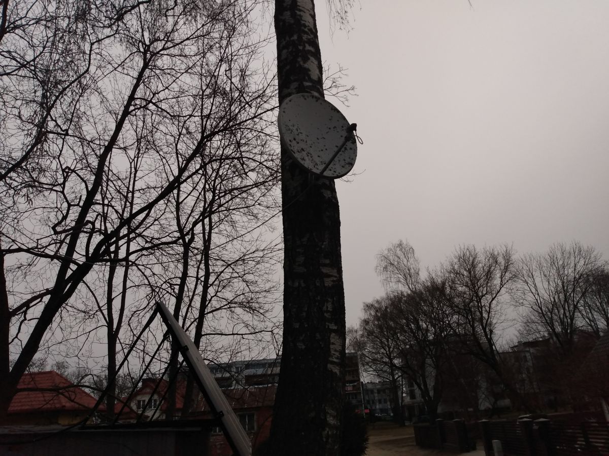

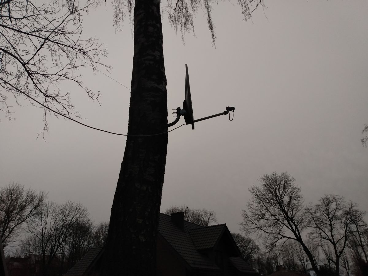

  • Tree growth attenuating satellite signal reception
    #17 19956855
    ArturAVS
    Moderator
    Posts: 26433
    Help: 2303
    Rate: 7850
    Fortunately I do not use terrestrial TV :D . I have such a location that no reception is an option, even in the days of analogue TV something with "snow" could be received. Even with SAT there were a lot of problems, but the installation of an antenna on a tree (birch tree :D ) solved the problem and for almost twenty years now it works :D . One problem is the growth of trees and, for example, last year neighbours had to raise their masts with SAT antennas upwards as the tops of the trees were effectively attenuating the signal.
  • Tree-mounted antenna reception is unreliable
    #18 19957173
    Pan.Kropa
    Level 35  
    Posts: 4191
    Help: 252
    Rate: 1181
    ladamaniac wrote:
    The transition from DVB-T to DVB-T2/HEVC encoding of channels is to be completed by 30 June 2022.
    This does not apply to TVP which can broadcast in DVB-T until the end of 2023.
    ArturAVS wrote:
    however, mounting the antenna on a tree (birch tree ) solved the problem and it has been working for nearly twenty years now .
    Forgive me, but I don't want to believe it. While a terrestrial antenna attached to a tree will receive. A satellite dish will not necessarily. However, the tree sways and grows. And as we all know, even a few millimetres of sway of such an antenna will result in a lack of reception.
  • Dish obstructed by tree growth and branch sway
    #19 19958051
    ArturAVS
    Moderator
    Posts: 26433
    Help: 2303
    Rate: 7850
    Pan.Kropa wrote:
    Forgive me, but I don't want to believe it. As far as a terrestrial antenna attached to a tree will receive. A satellite dish will not necessarily. However, the tree sways and grows. And as we all know, even a few millimetres of sway of such an antenna causes a lack of reception.
    You are partly right, however it is not just any "birch". At breast height I can't manage the trunk, about five years ago I slightly corrected the positioning because after quite a storm a fallen branch broke the cable and dented the plate a bit. Cloudy and a bit dark in the morning but this is more or less how it looks;
    As you can see the plate has already started to grow moss :-( , unfortunately I am not physically able to go in and clean it (partial paralysis/disability). This summer a familiar installer will be replacing with a new larger one and correcting the settings. In stronger wind/rain there are signal fades, plus the overhanging young branches sometimes already start to reach the dish. I still have to cut some branches because they will obscure the photovoltaics, but I need to organise a lift. Mounting it on a building would be even more troublesome, as it would require at least a five-metre high mast. Most of the surrounding trees still remember the Tsar :D . Interestingly, the base of the antenna mount grew into it for about 3~4cm.

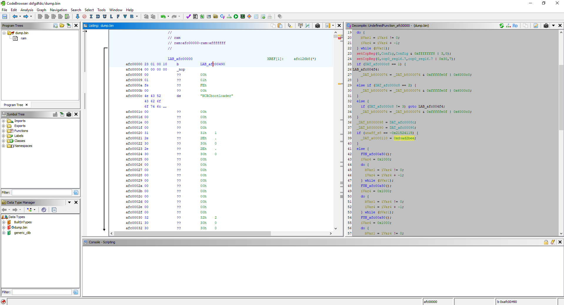

  • #25 21774650
    Posts: 14792
    Rate: 12937
    A topic more than three years old, but I'll try to ask.
    @ArturAVS do you still have that ALI M3801? Or the contents of the flash memory? In this topic I presented a project found on GitHub that compiles and starts:
    How to compile and run your own firmware for ALI M3801 and other chips from tuners?

    PCB with ICs, RCA connectors, USB port, and TV tuner module
    Write what is needed, I will take home and use CH341.

    I'll look for the power supply and front panel tomorrow (they were waiting to be unsoldered).
    I would love to see a dump of the 4 MB Flash memory
    That 25Q32? I'll solder in the adapter tomorrow and read it.
  • Ghidra analysis shows boot jump at afc00490

    I only sat down to this 4 MB today, but from the side not of partitions, but of machine code.
    I described the partitions here:
    Interior of Comsat TE 1050 HD tuner, firmware ripping, partition format from Flash memory
    I have now loaded a copy of the 4 MB from myself in Ghidr (mips architecture, base address afc0000) and I can see that this first "magic" value (4 bytes) is actually a jump instruction that jumps behind the header to offset afc00490:
    Screenshot of Ghidra analyzing dump.bin file in MIPS architecture
    There my attention was caught by the constant 0xdead2bee, quite distinctive, there you go:
    https://github.com/search?q=0xdead2bee&type=code
    Other interesting sources.

    Another problem has arisen, I have found a programmer, I have been looking for an adapter or clip for an hour, and cannot find :-( . It's been a long time since I used it, and I can't remember how to get it to work in Linux.
