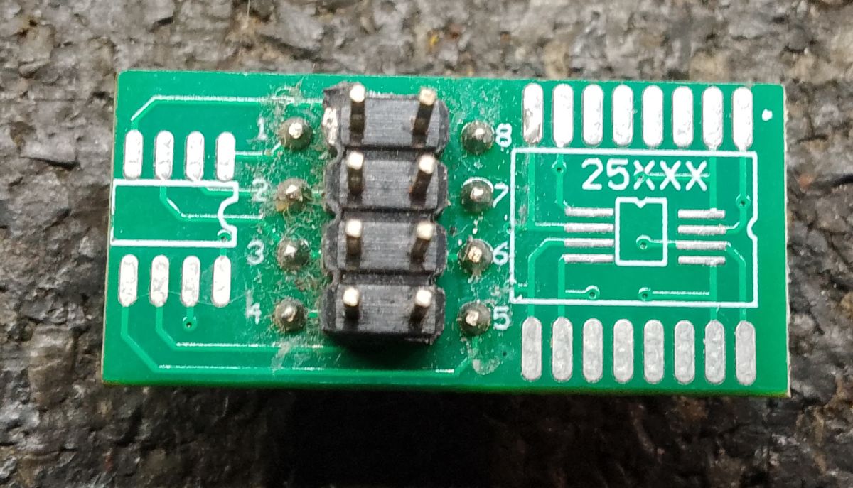

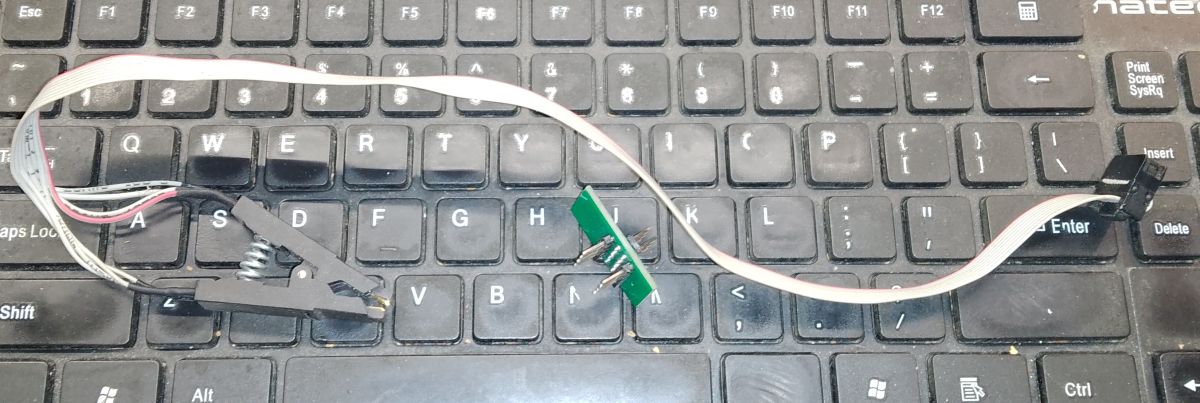

    Found it! The clip plugged into the adapter;
    SPI programmer clip connected to adapter, lying on a laptop keyboard
    I just don't know if one is suitable;
    PCB adapter with test socket and 25XXX memory footprint ed7f4494
    I'll try the clip first, if it doesn't go, I'll insert 25Q32.

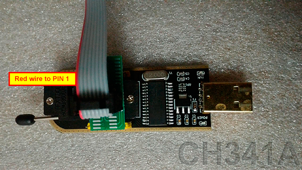

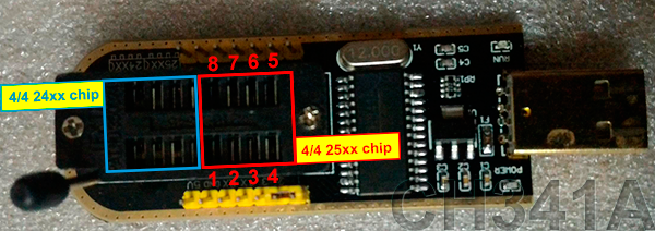

    CH341A programmer with labeled pins for 24xx and 25xx EEPROM chips
    CH341A adapter with IDC ribbon cable connected, red wire marks pin 1

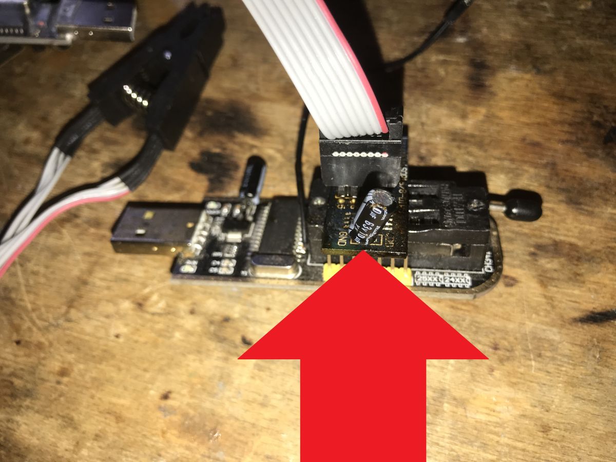

    Just out of curiosity, once you've managed to do a full 4MB read, write it to a file, just to be sure twice, and make sure it says NCRC bootloader in the header, can you try uploading something to that flash?
    I ask because with me the CH341 won't program (i.e. upload a new batch - reading works) until I add a capacitor on the power supply, and am very curious if others have this problem too:
    CH341 module with electrolytic capacitor connected and SPI cable attached

    Question, rebus, riddle... Via clip nothing, autodetect also nothing, only after soldering in the adapter and manually selecting the type something went. And an interesting thing, the keyboard in win stopped working. I think the drivers got messed up. What I've ripped is in the attachments;

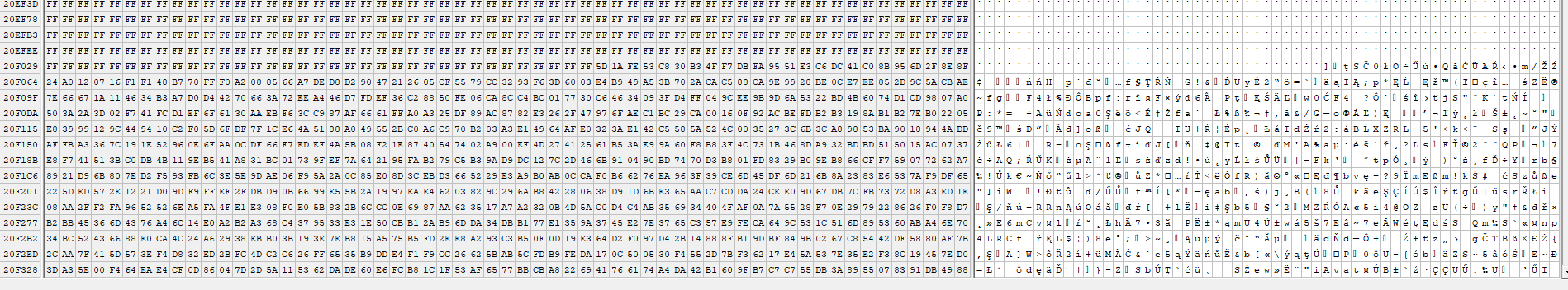

    Something must have gone wrong, the attached file is almost empty, but I will still check it. Most of it is bytes 0xFF. Either some kind of error, or it's not the program.
    Hex editor screenshot showing mostly 0xFF bytes with some non-zero data below
    Added after 16 [minutes]:
    I don't see a header there with NCRCBootloader etc.
