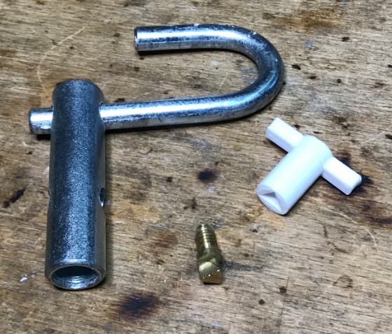

Today I'm going to show a short, emergency 3D print that might come in handy for someone - a "triangle" key for KS-17 security padlocks fitted to electrical boxes, for example. The key itself is readily available for a few zlotys, but what can you do when it's Sunday, the shops are far away and you need to open a box in an emergency? That's what you can do - you can use a 3D printer.
The situation was such that one of the padlocks wouldn't open with 'guerrilla' methods, and the other wasn't locked anyway, so I had a disassembled padlock as a model:
In Blender, I started with the shape of the triangle and its dimensions:
I then used it to cut a hole in the circle, boolean subtract:
At this stage I have made a few prints for the fitting, as a trial:
Successful fitting:
The next step was to give the project real depth:
I helped myself with the mirror tool. The triangle shape is cut out, so there are no problems with the supports and it saves a bit of material:
Finished print:
Fitment:
Weight and printing time with Cura:
Two grams and 20 minutes! That's very little indeed.

I would rather not normally print this, but an emergency situation forced me to do so and fortunately it went off without a hitch. Was it worth it? For the sake of time, yes; but even so, you have to admit that such a key itself is quite cheap, although the lack of a good stationary shop nearby also complicates things a bit, because then you have to add shipping as well. My printed key costs only as much as some two grams of filament , that is, with the price of 50 PLN per kilogram it is pennies, even if you add the electricity/maintenance of the printer, it still remains pennies.... I'm not counting design time (playtime) here.

I would not, however, give the hole through, but to the required depth. This will always strengthen the structure and, in the position in which you are printing this key, no slides are needed. [Read more]

The tube shape is the strongest for torsion :) There is no need to fill the centre ... [Read more]
kotbury 12 May 2023 08:26
Strongest for torsion yes, but made from the same amount of material - a tube made from 1 kg of steel will yes be stronger than a bar made from the SAME AMOUNT of material, i.e. a kilogram (which will... [Read more]

For the same outside diameters, a solid bar is stronger than a tube, this follows from the torsional strength formulae. After all, a rod is also a tube with a wall thickness equal to the radius, so it... [Read more]
