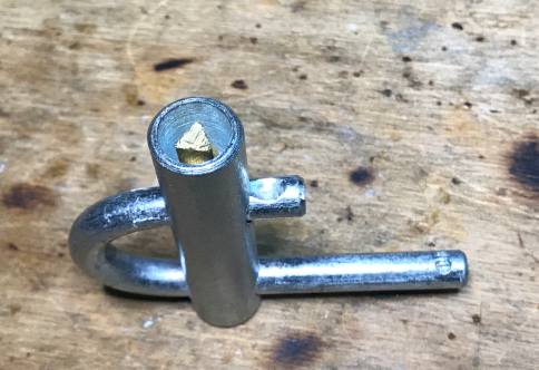

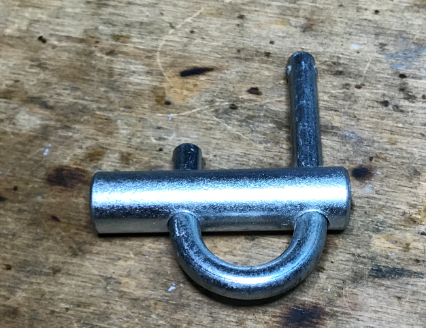

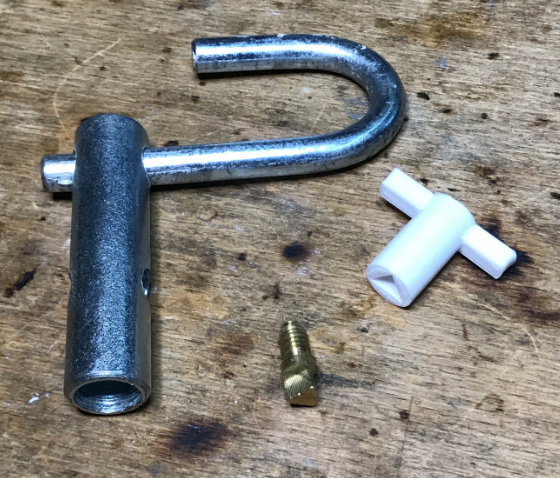

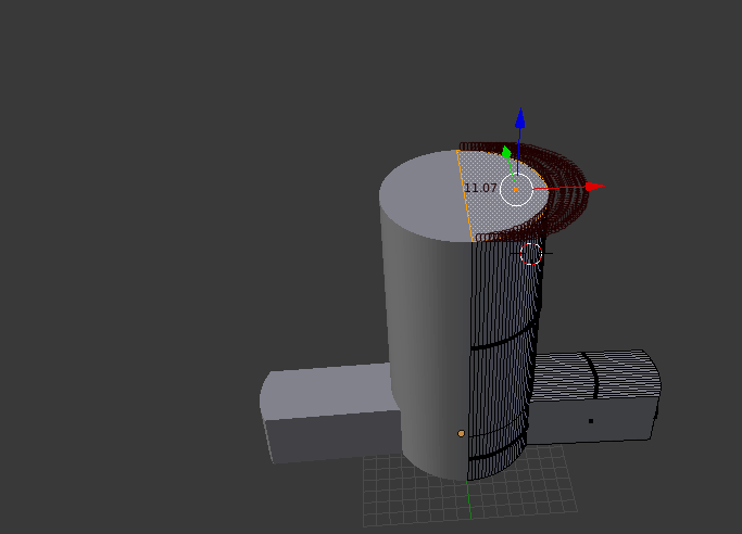

    Today I'm going to show a short, emergency 3D print that might come in handy for someone - a "triangle" key for KS-17 security padlocks fitted to electrical boxes, for example. The key itself is readily available for a few zlotys, but what can you do when it's Sunday, the shops are far away and you need to open a box in an emergency? That's what you can do - you can use a 3D printer.
    The situation was such that one of the padlocks wouldn't open with 'guerrilla' methods, and the other wasn't locked anyway, so I had a disassembled padlock as a model:
    KS-17 energy/gas key - triangular/triangular - emergency 3D printing

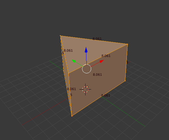

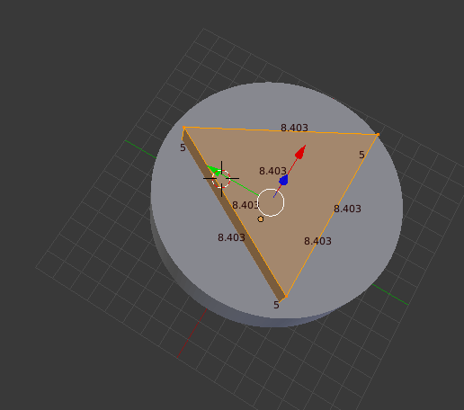

    In Blender, I started with the shape of the triangle and its dimensions:

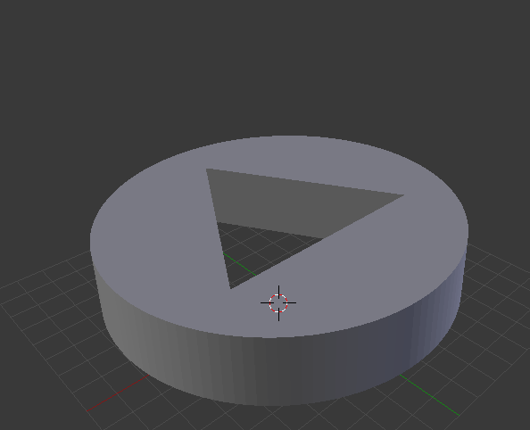

    I then used it to cut a hole in the circle, boolean subtract:

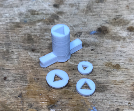

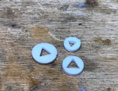

    At this stage I have made a few prints for the fitting, as a trial:
    Successful fitting:

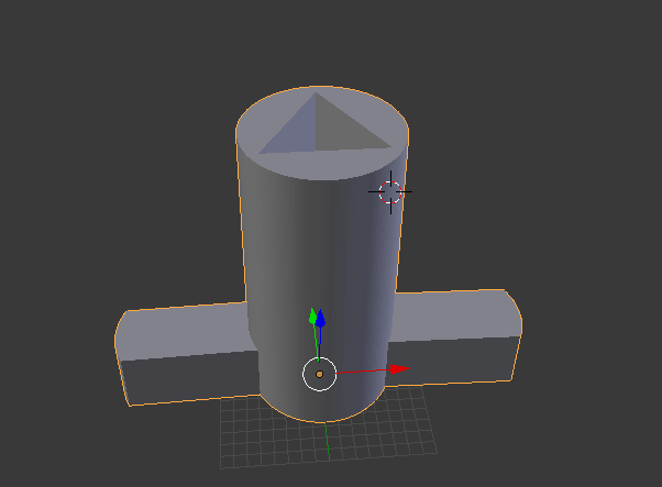

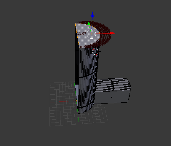

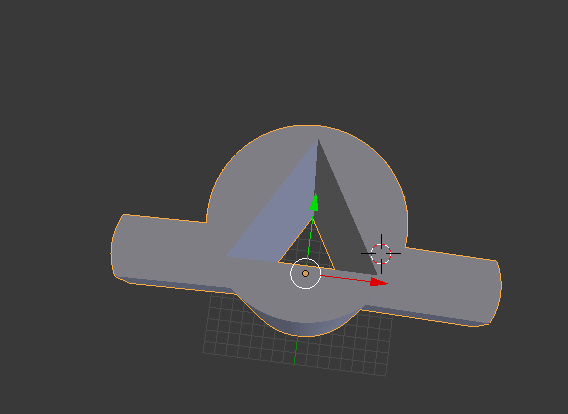

    The next step was to give the project real depth:
    KS-17 energy/gas key - triangular/triangular - emergency 3D printing KS-17 energy/gas key - triangular/triangular - emergency 3D printing
    I helped myself with the mirror tool. The triangle shape is cut out, so there are no problems with the supports and it saves a bit of material:

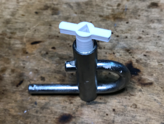

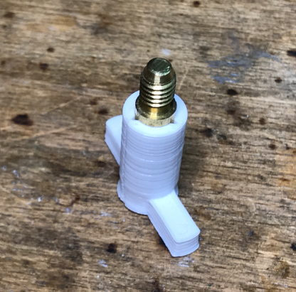

    Finished print:
    Fitment:

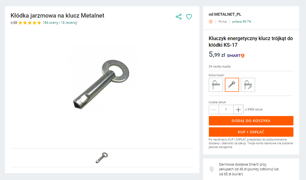

    Still to be seen - identical keys on a Polish auction site:
    So buying this key would cost me about PLN6, plus shipping costs (of PLN9?), and let's not forget the waiting time.

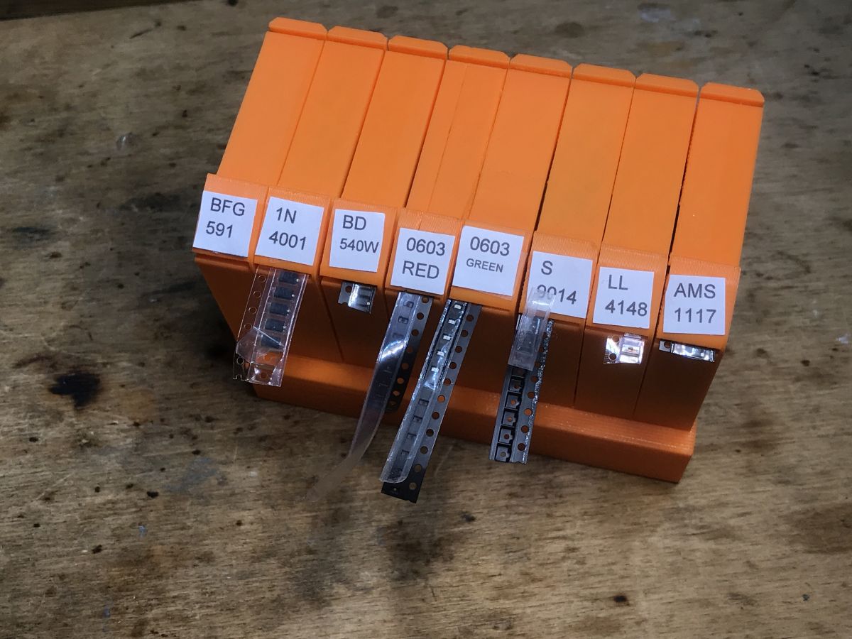

    I didn't optimise the printing time, everything went on the default settings, probably if the speed was set higher, it would also be shortened a few times. All in all, as I was printing bulk containers for SMD:
    Spoiler:
    that's when I played around with it and indeed, with simple shapes the Print Speed parameter can be increased significantly with no noticeable loss of quality. On my Ender 3 Pro (not sure about other printers), I can also increase the speed scale with the knob during printing.
