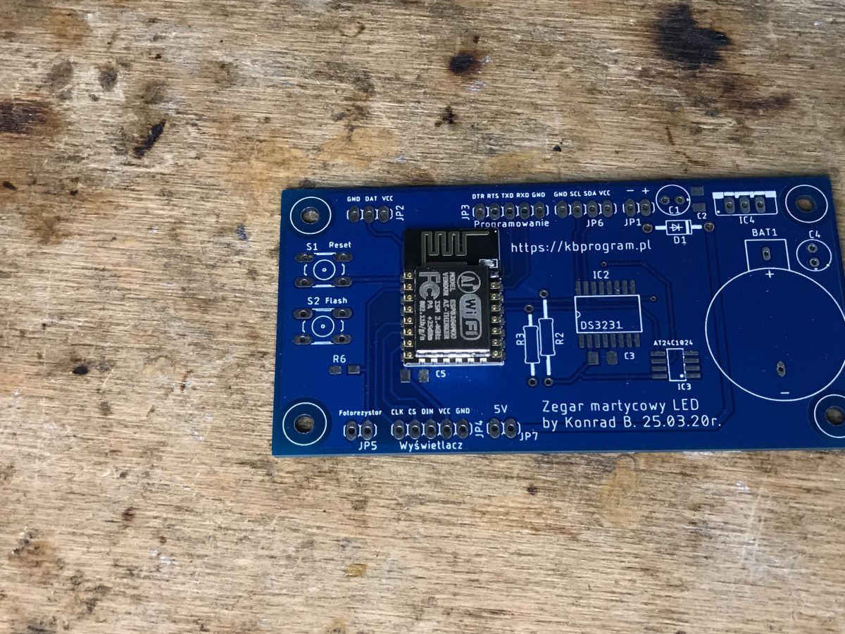

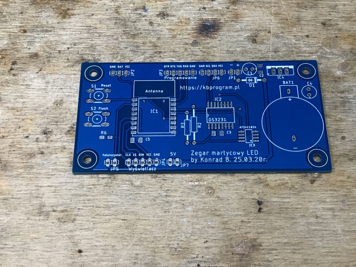

I will show here the design of a clock built on ESP8266 and MAX7219 based display, additionally enhanced with a relay module on MCP23017. The PCB under the ESP will come from the web, the relay module on the other hand I designed myself. I will assemble the firmware myself in PlatformIO from ready-made libraries. The time will be downloaded from the internet via NTP.

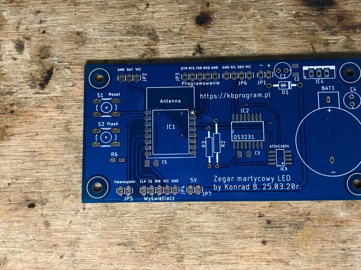

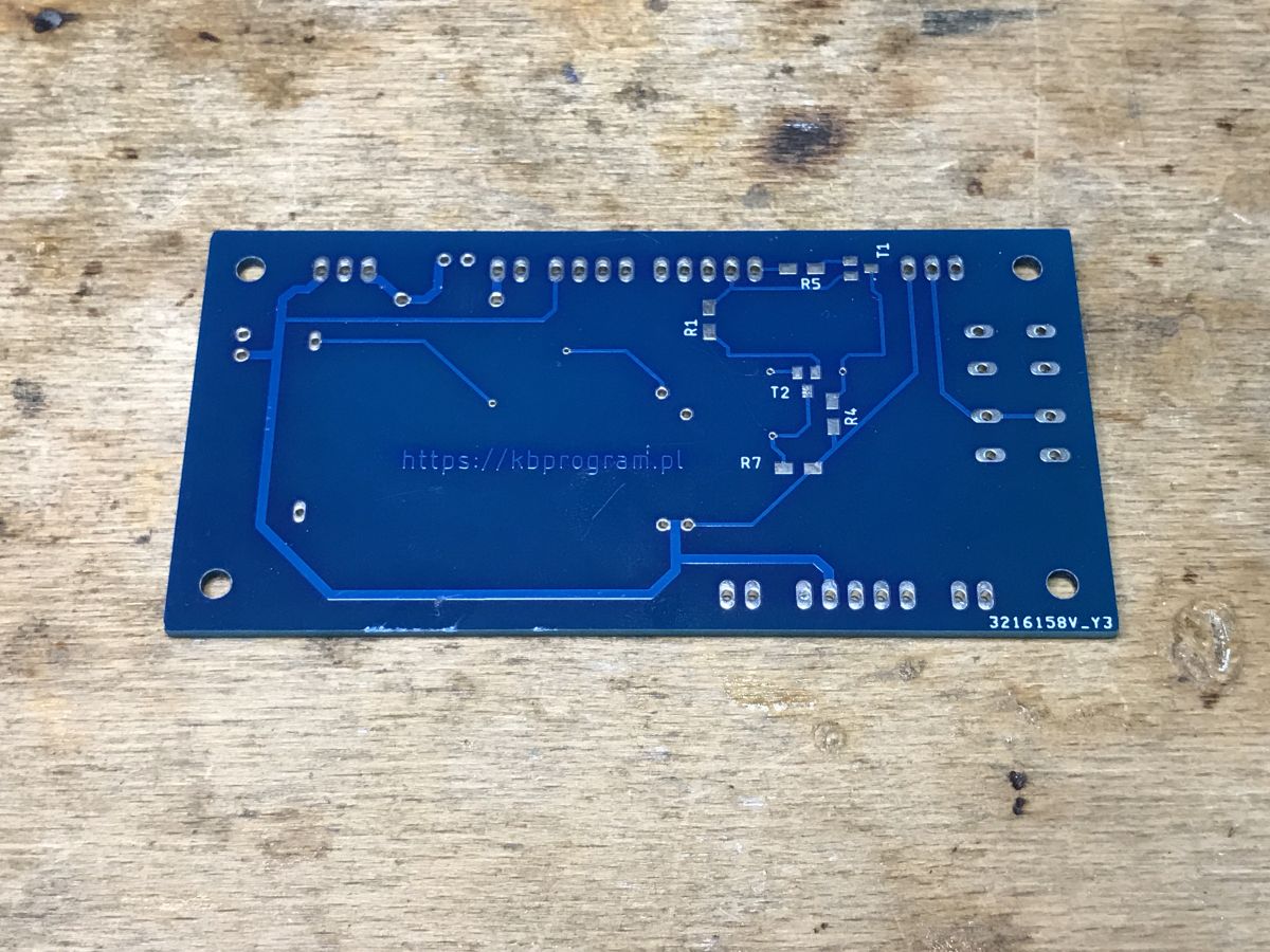

The main PCB for ESP12 used here is by "kbprogram" and was shared on his blog, and one of his pieces was sent to me by one of my readers (along with a bunch of other parts).

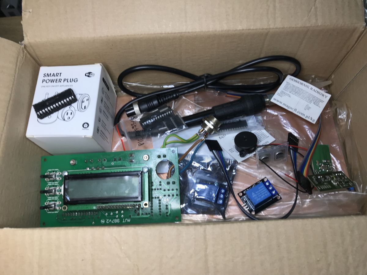

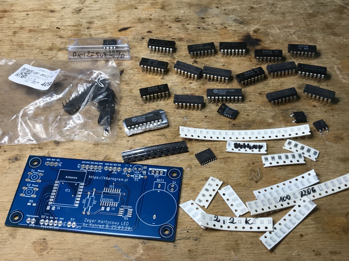

As a rule, ready-made kits (so-called kits) I never assemble and have never put together - even my first circuits made 6 or more years ago were DIY - including, for example, As a rule, I never put together a kit. with the TQFP tracing , or there with my PIC32 board , or with my Ethernet attempts on a PIC with everything I need built in .
In this case, however, since I had already received a PCB from a reader, I just decided to use it. Here are the contents of the whole package I received (I will try to describe something else from it in the future):
Thank you for the package!

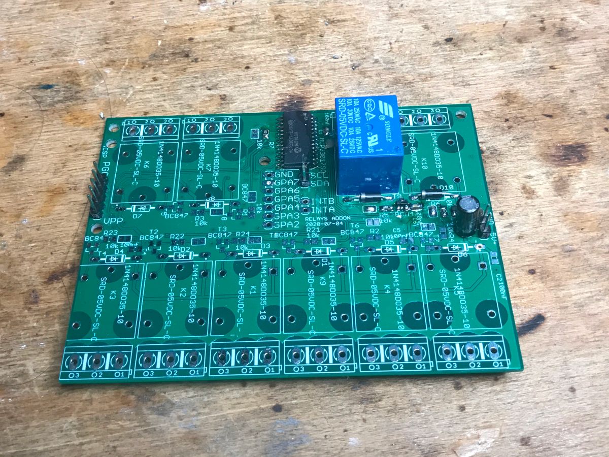

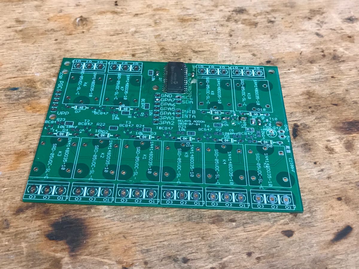

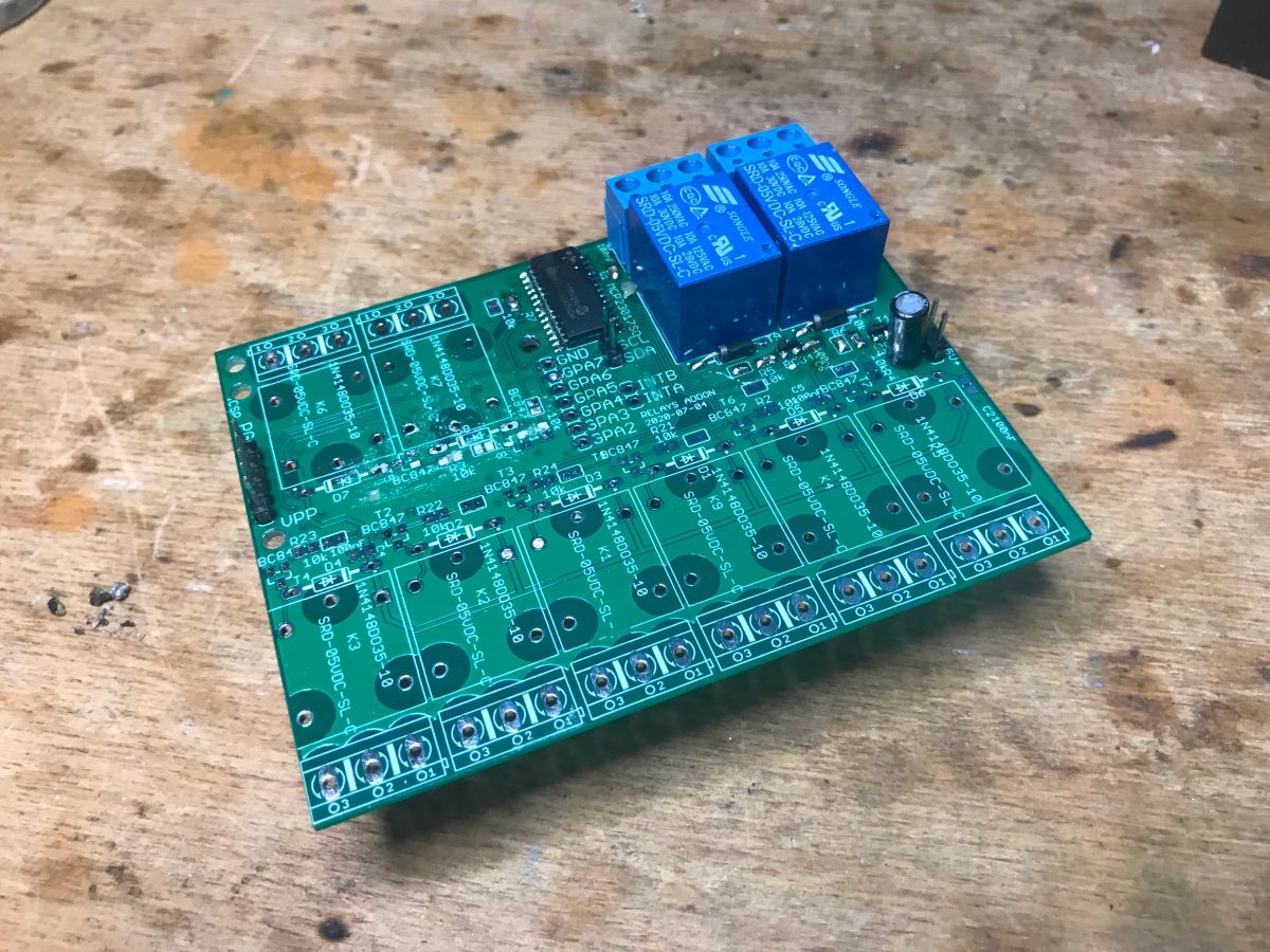

As for the relay module mentioned in turn, it was originally intended as an overlay for this project:
Home Assistant/Tasmota HTTP compatible relay controller + housing But when ordering the boards I got 10 pieces, so there are some left over for other projects.

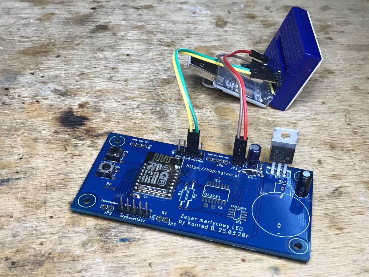

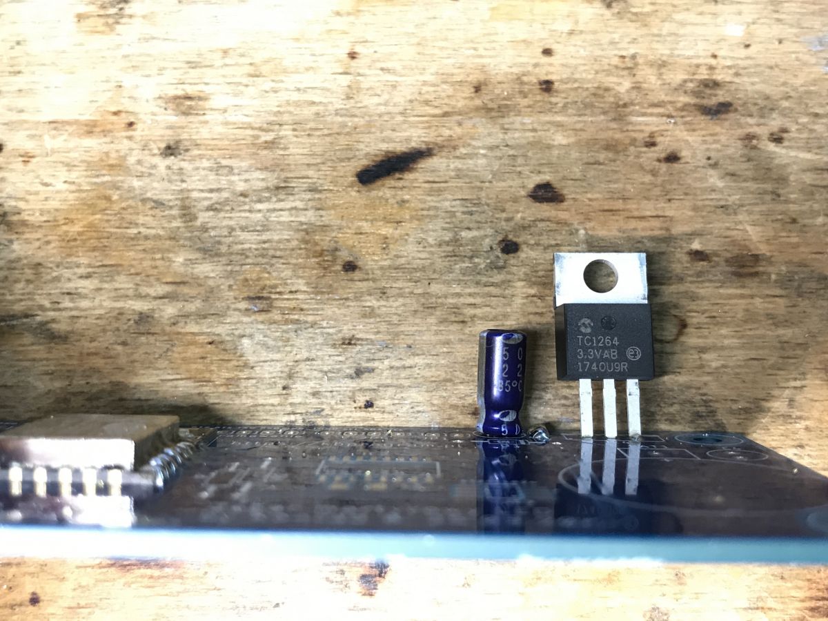

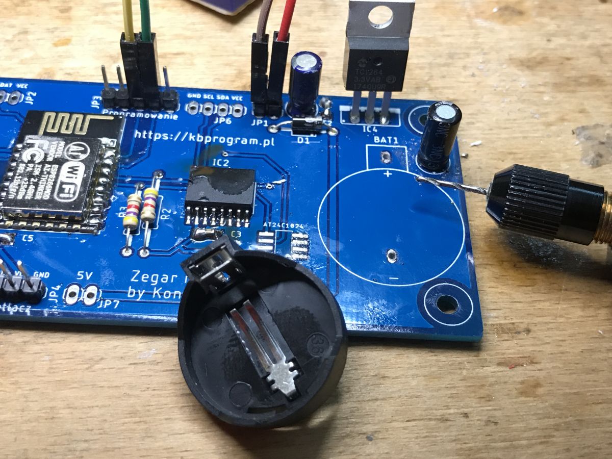

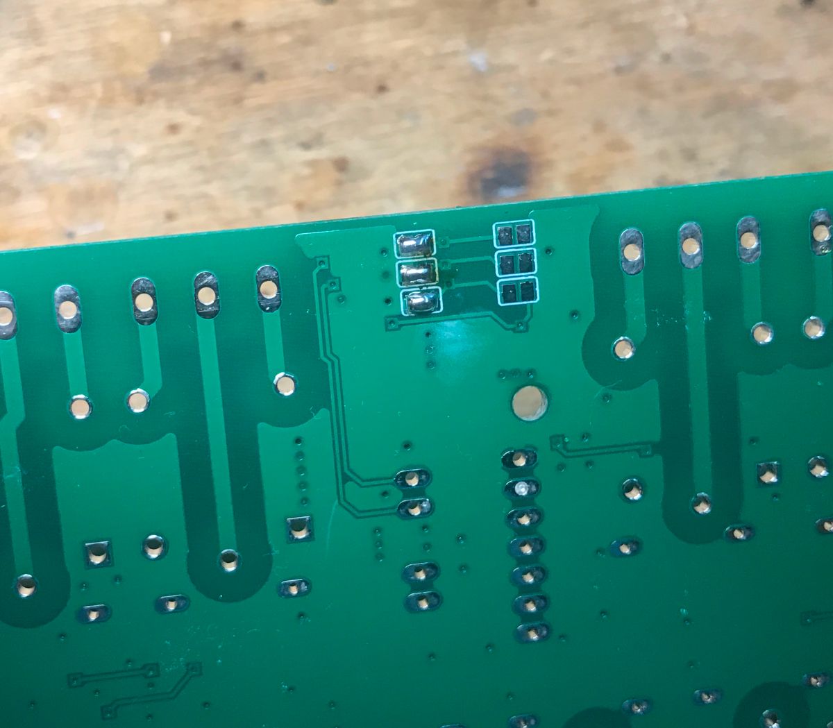

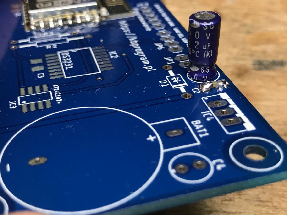

Soldering the board This board is a strange mix of THT and SMD. I don't know why exactly the author conceived it this way, maybe it was supposed to be a golden mean between size and soldering difficulty? You have the documentation of the project on the author's page given on the board. Basically, there is nothing to discuss here. Power block with a 3.3V LDO (I used a TC1264), ESP12, clock block with battery cage, I2C lines with pull up resistors, EEPROM also on I2C and basically that's it.
Those SMD transistors on the bottom of the board are only needed if you want to reset the chip with lines from the UART. I myself reset and entered the programming state with buttons.

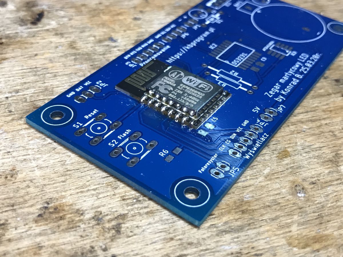

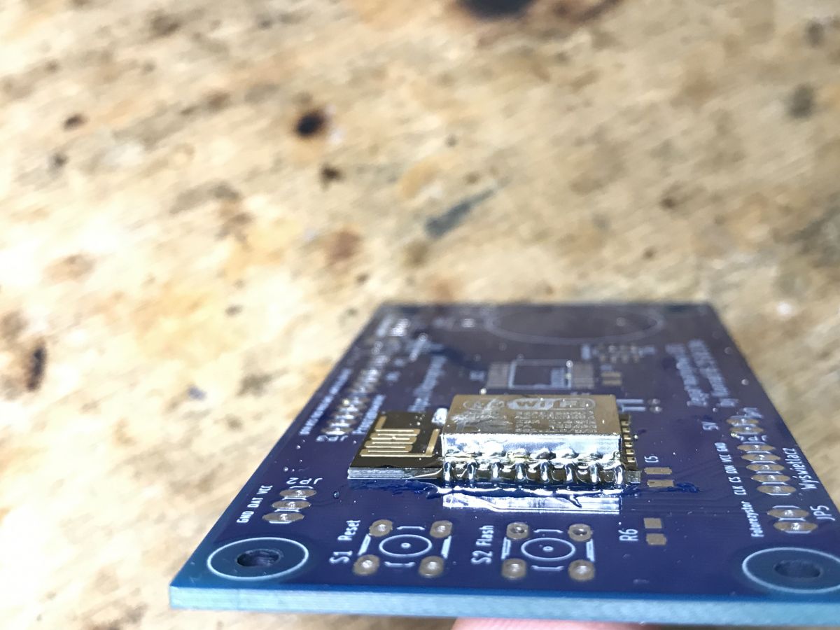

I soldered the WiFi module by making a drop of solder on one pad, grabbing that pad and then soldering the others.

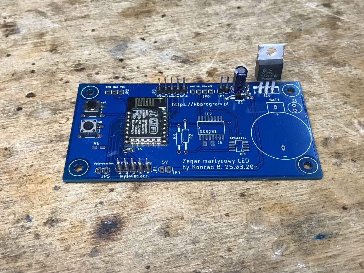

I had the 100nF decoupling capacitors in slightly smaller enclosures:
Almost ready, can be programmed:
I still soldered the components, unfortunately the holes for the cage legs for the watch battery to hold the time were too small, I had to drill :

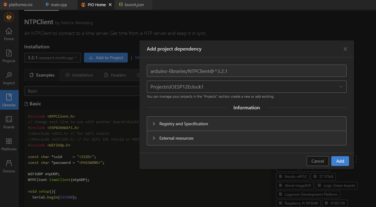

ArduinoOTA, or convenient batch uploading via WiFi For programming, I chose the PlatformIO platform. I have not been exposed to it before:
https://platformio.org/ Installation description for VSCode:
https://platformio.org/install/ide?install=vscode The installation is done in two steps. First the VSCode and then the PlatformIO addon. It went without any problems.
For uploading the batch, I chose ArduinoOTA - that is, uploading the batch over WiFi.
Here is the platform.ini file used:

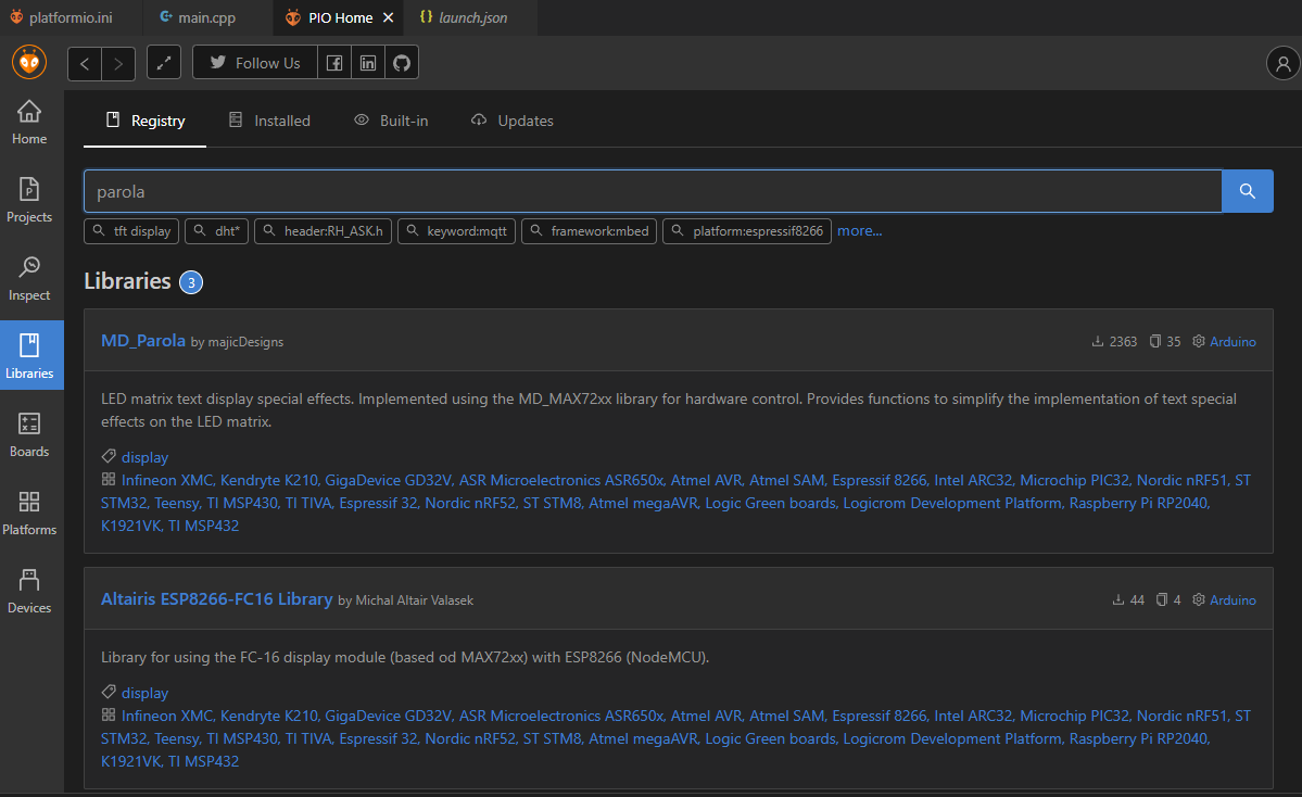

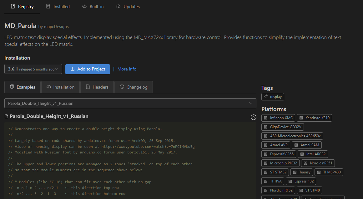

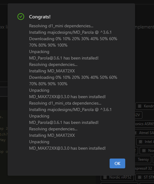

Library MD_Parol For the control of the MAX7219, I have chosen the MD_Parola library. It can be installed very easily via PlatformIO. Basically you just have to search for it and click through the installation process. Everything is automatic.
Once you have searched for the library, you can select the version and click "Add to Project".
Using MD_Parol is really quite simple. The documentation is here:
https://github.com/MajicDesigns/MD_Parola We define the type of display and its SPI pins (although this is truncated in his case, the communication is one way):

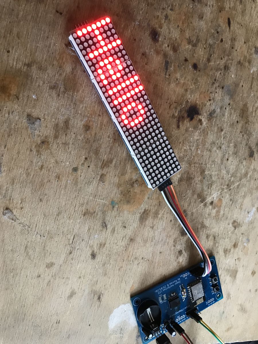

Effect:

All I had to do was add a few lines of code and there you go - we have a time display:

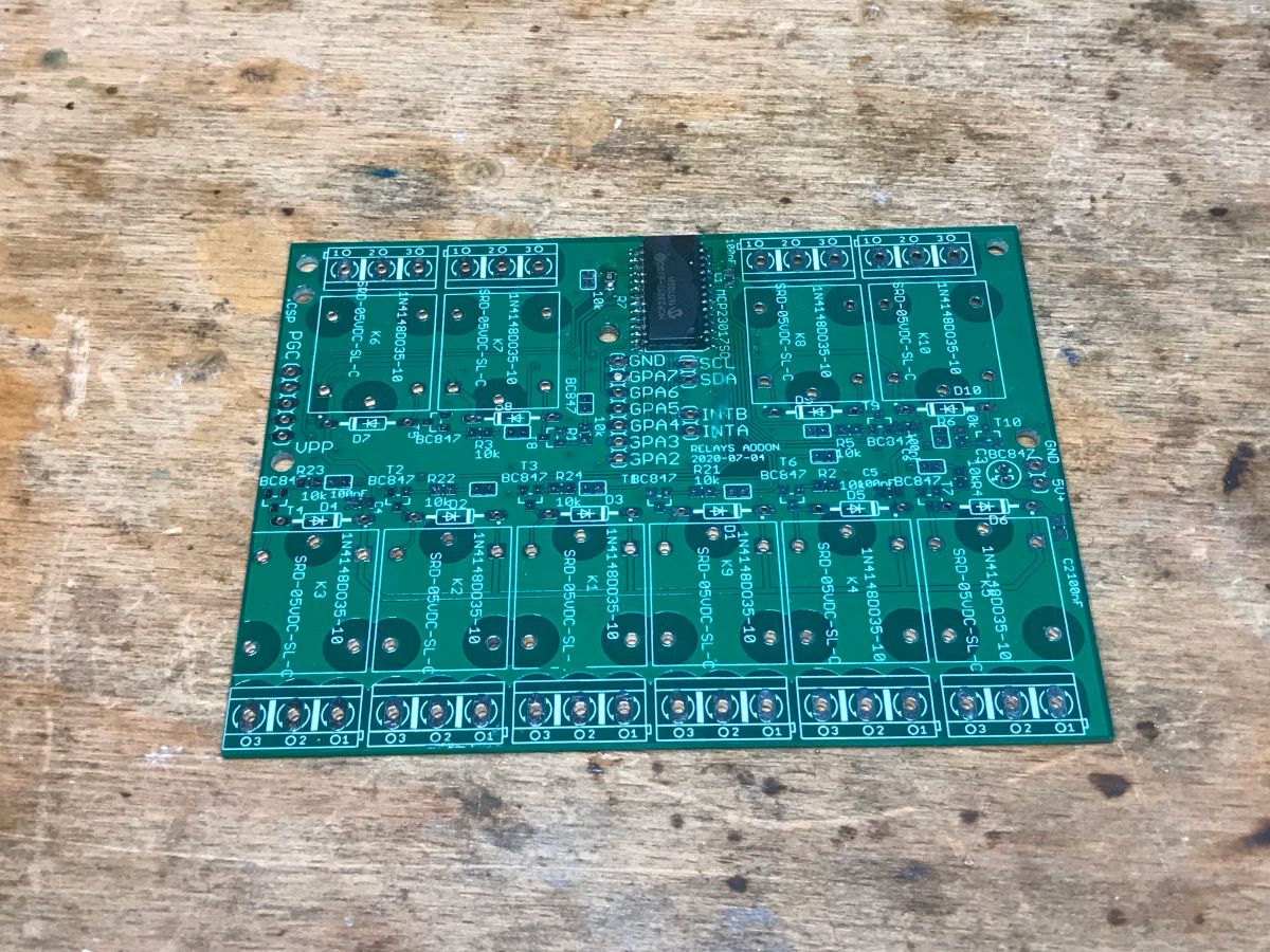

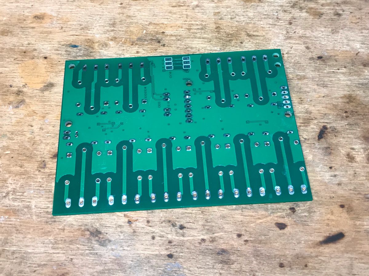

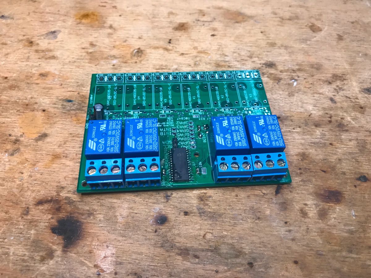

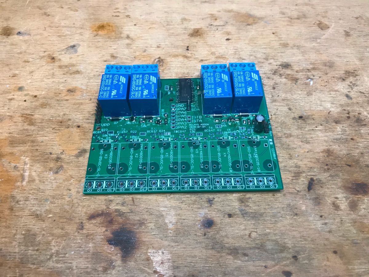

Relay board - MCP23017 As mentioned, this board is of my own making and on board it contains a port expander (16-bit) MCP23017 with I2C interface. For its control we need two lines - SDA and SCL. In addition, we need VDD - here 3.3V and relay supply - 5V. Some of the MCP23017 leads are brought out on goldpins, as I did not fit as many as 16 relays on the PCB. In addition, on the board there are pads allowing you to select the address of the expander (three address pins - A0, A1, A2), we can choose as many as 2^3 address combinations, so some of these expanders can be connected to the I2C bus.
Time for soldering - I soldered the SMD in such a way that I first put the solder on one pad (with flux), then positioned the component with a pesette and melted this solder with a soldering tip, and then soldered its other leg.
Binder jumpers for address selection:
I used surface-mounted S9014 transistors:
Almost done:

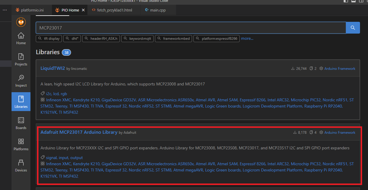

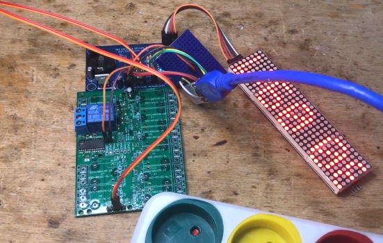

The library assumes by default that we have connected all address pins to ground, as I also did, so you don't even need to specify the address. It really surprised me too, here everything is simplified to the absolute minimum, it's so very friendly novice that a beginner doesn't even need to know about I2C addresses to use MCP....
It remains to modify my flashing condition in the main loop:
Code: C / C++
Yes - that's really all it takes, just mcp.digitalWrite!
Result (need to include audio):
You can hear the relay working - blink works.

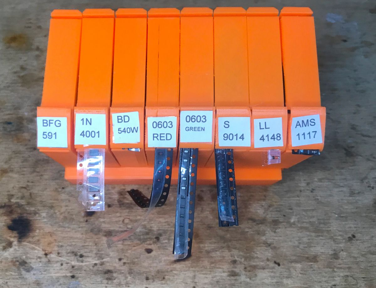

Nice project, but I have a question from another side - what are these SMD component feeders ? Can you elaborate ? ;-) [Read more]
30 Nov 2023 14:08
@speedy9 PlatformIO is really convenient and easy to use. Additionally, it resides in VSCode, which I also use for purposes other than microcontroller programming. For example, it is convenient to write... [Read more]
