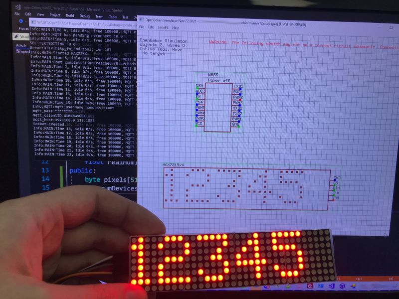

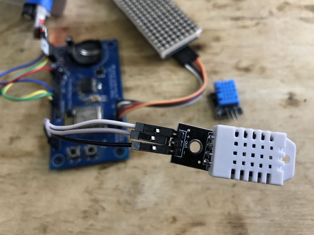

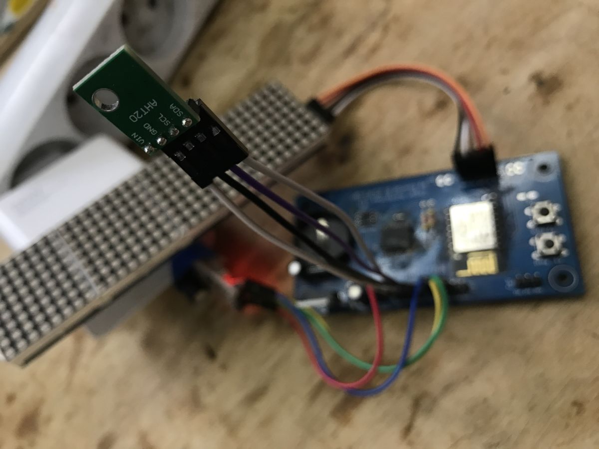

    Update after two years - I am working on this project again:
    ESP module with DHT11 sensor, LED matrix, and USB power supply on a wooden tableDHT11 sensor module connected to a development board with jumper wiresAM2301 sensor module connected to an ESP8266 board on a workbenchPCB with ESP8266 module, potentiometer, and connected jumper wires
    @max4elektroda what's the status of DS3231 in OBK now?
  • DS3231 support switched to Clock_GetCurrentTime()
    #10 21759171
    max4elektroda
    Posts: 758
    Help: 49
    Rate: 189
    Working - just synched today and fixed the berry part with NTP (since I changed to a general time source, using g_ntpTime directly is no longer possible (nor sensible), it's "Clock_GetCurrentTime()" now). And I switched to "obktime.h" to avoid time.h function like gmtime.

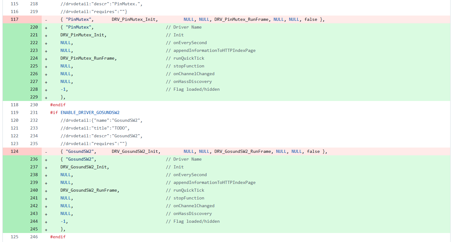

    So this is the code now (original code only commented out) - not tested, but selftest is o.k., so I expect it's working:

    And here is my preparation for running MAX7219 clock on Windows:
    LED display showing the digits 12345 in front of schematic and debug console

    Right now I am focusing on developing clock in Berry on Windows:
    PCB layout with HELLO written in a grid of red dots
    autoexec = module("autoexec")
    def myLogic()
          runCmd("MAX72XX_Scroll 1")
          runCmd("MAX72XX_refresh")
    end
    runCmd("startDriver MAX72XX")
    runCmd("MAX72XX_Setup 10 8 9 5")
    runCmd("MAX72XX_Clear")
    runCmd("MAX72XX_Print Hello")
    setInterval(myLogic, 100)
    return autoexec

    To achieve this, I slightly changed struct "driver_t" in drv_main.c : Instead of "bool bLoaded" I used "int8_t LoadedFlag".
    This way I can assign negative numbers which will decide how to handle the driver:
    A negative number means: Not loaded
    A positive number means: Loaded
    During start/stop the number is inverted (* -1)
    A 1 (as before) means: Driver loaded and shown
    Any number > 1 means: Driver loaded, but not shown in GUI (so we might use this for other "flags")
    I think this will only slightly change the code, but give more flexibility.
    BTW: Changing the "false" to "-1" in the driver lines showed some nasty bugs we had for some month:
    When "void(*onHassDiscovery)(const char *topic);" was introduced, some lines where forgotten to be extended, too.
    I added the missing "NULL" entries and rewrote the lines, so you now can easily see the struct members:
    Modified PinMutex and GosundSW2 driver definitions in C source code
    I also fixed the last "XXX_AppendInformationToHTTPIndexPage" where the addition of arg "int bPreState" was not added...
