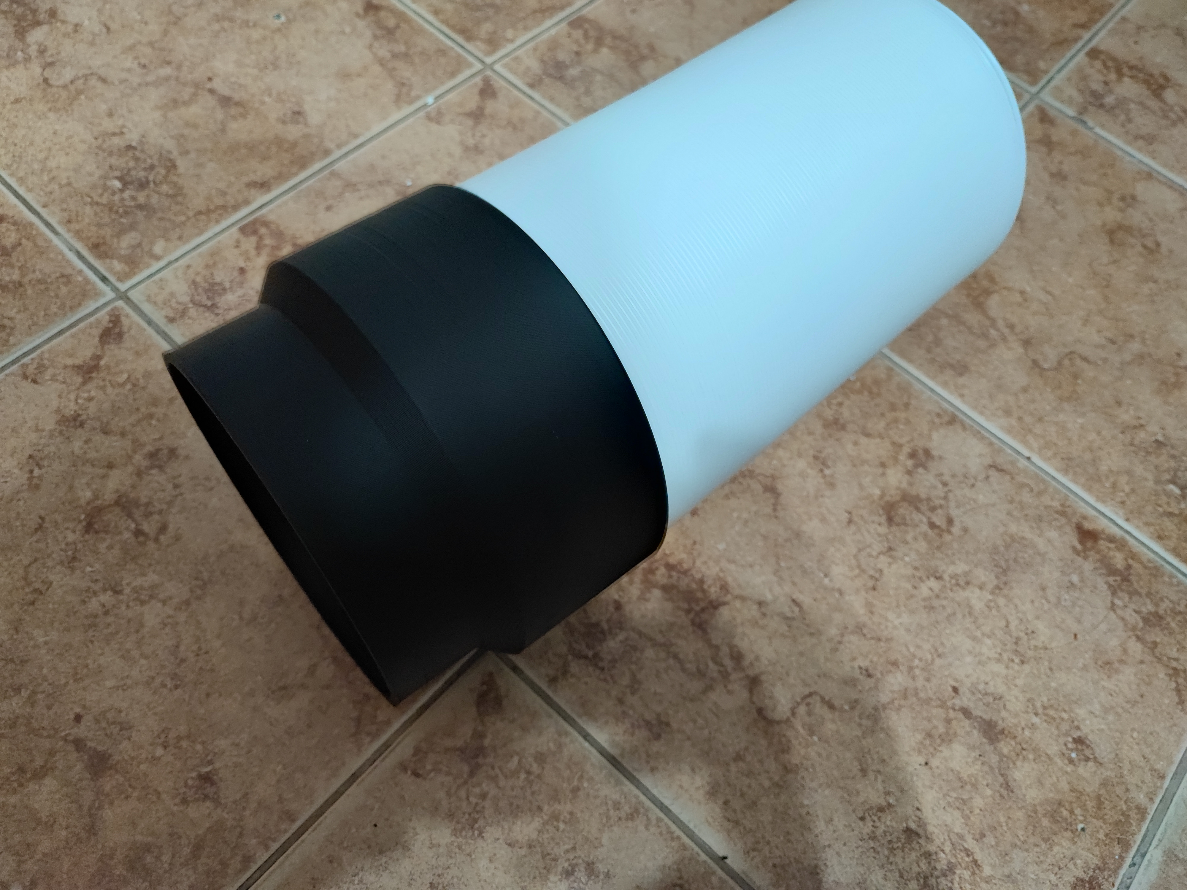

The hot weather is coming, so you need to run the air conditioning - all the more so when there is a computer constantly running in the workshop stubbornly heating up the room. The situation gets complicated, however, when you don't have permission to install a full-fledged air conditioner and have to limit yourself to a portable version. In my case, I managed with difficulty to get permission for just a single pass-through hole for ejecting warm air, so I have nothing to complain about anyway, and the only problem left was the installation of the ejection pipe, or more precisely.... the lack of its adapter.
Here this problem I will try to solve, and immediately, as the warm days start practically tomorrow.
First a few words about my situation - I have a 15cm ejection hole made, but the air conditioner does not come with a matching adapter:
On the other side there is a flexible hose from the air conditioner, but it doesn't even fit in this hole (it's too big in diameter, it won't go in).
Something has to be thought of, this is where 3D printing comes to the rescue.
I started by fitting the component going into my ejection tube:
A test printout confirmed that I had the dimensions correct:
I then selected a matching threaded component from Thingiverse:
Thread source:
https://www.thingiverse.com/thing:4519730
I connected the pieces properly, making sure I centred both accurately:
I decided to make the print without the supports:
I sped up the print time by changing the feed rate already during the print - I hit 160% FR.
During printing on my Ender 3 PRO:
The print took only about 16 hours in the end, which is confirmed by calculations (24/1.6 = 15...)
Does it fit?
Of course it does, after all I did a test print of both sides beforehand:
The thread is also:
Final fitting:
Everything fits and works perfectly.
All in all, the game cost me about 5 minutes of time in Blender and about PLN15 in filament (or probably even less, as I remember fiddling with the settings when printing). The whole thing came out perfectly from PLA filament, with no support, my Ender 3 PRO handled it brilliantly. In addition, I managed to solve the problem basically in one day (I put the print in the morning and today the air conditioning is already test-blowing).
Do you also already run the air conditioning or do you deal with the heat in the studio in a different way? Feel free to discuss.
