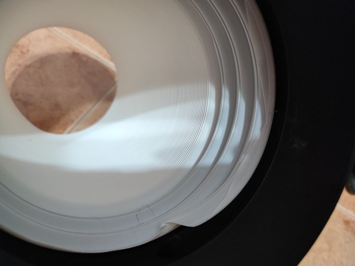

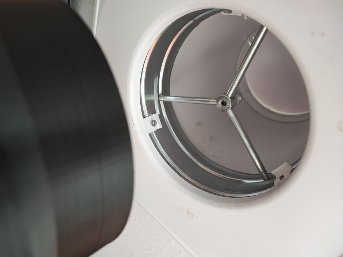

    First a few words about my situation - I have a 15cm ejection hole made, but the air conditioner does not come with a matching adapter:
    Adapter to lead out a pipe from a portable air conditioner - DIY 3D printing
    On the other side there is a flexible hose from the air conditioner, but it doesn't even fit in this hole (it's too big in diameter, it won't go in).
    Something has to be thought of, this is where 3D printing comes to the rescue.

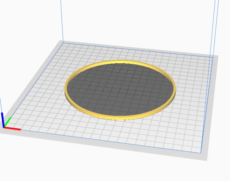

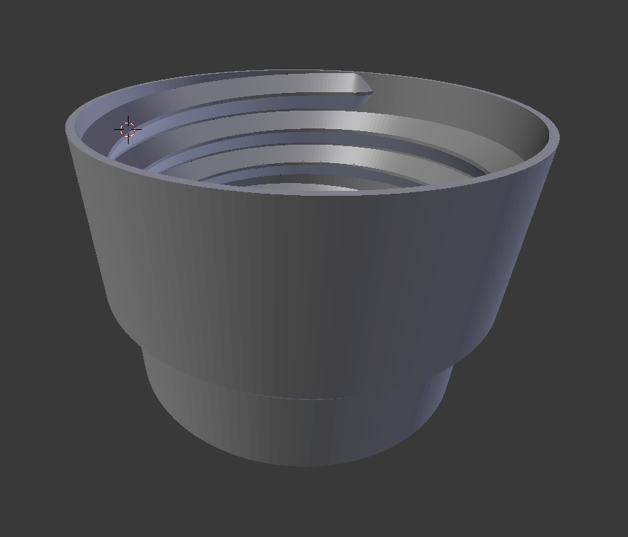

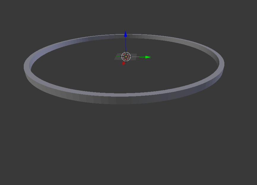

    I started by fitting the component going into my ejection tube:

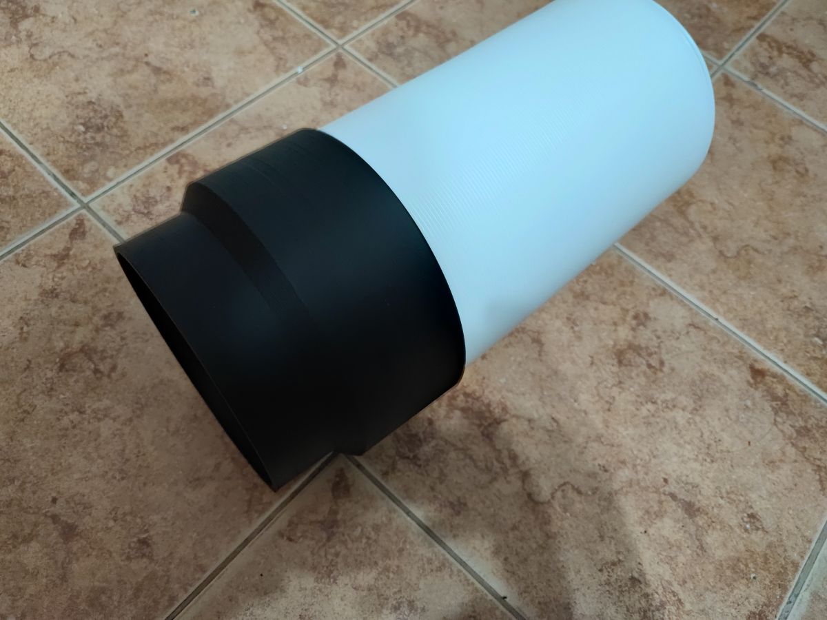

    A test printout confirmed that I had the dimensions correct:

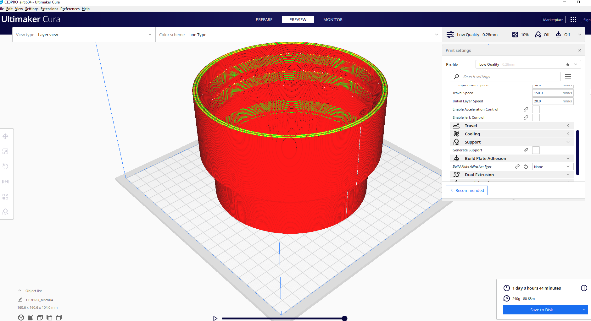

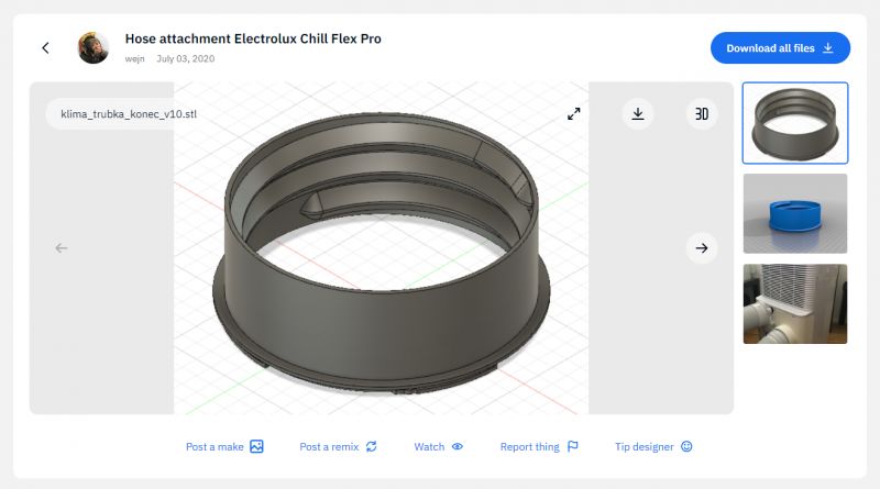

    I then selected a matching threaded component from Thingiverse:
    Thread source:
    https://www.thingiverse.com/thing:4519730

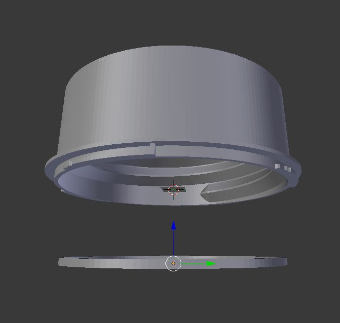

    I connected the pieces properly, making sure I centred both accurately:

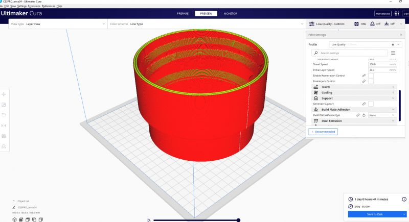

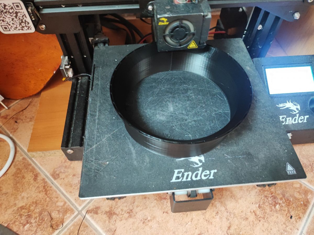

    I decided to make the print without the supports:

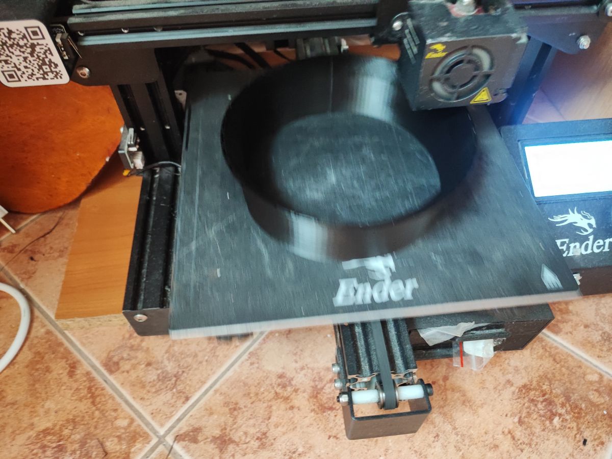

    I sped up the print time by changing the feed rate already during the print - I hit 160% FR.
    During printing on my Ender 3 PRO:
    Adapter to lead out a pipe from a portable air conditioner - DIY 3D printing Adapter to lead out a pipe from a portable air conditioner - DIY 3D printing
    The print took only about 16 hours in the end, which is confirmed by calculations (24/1.6 = 15...)

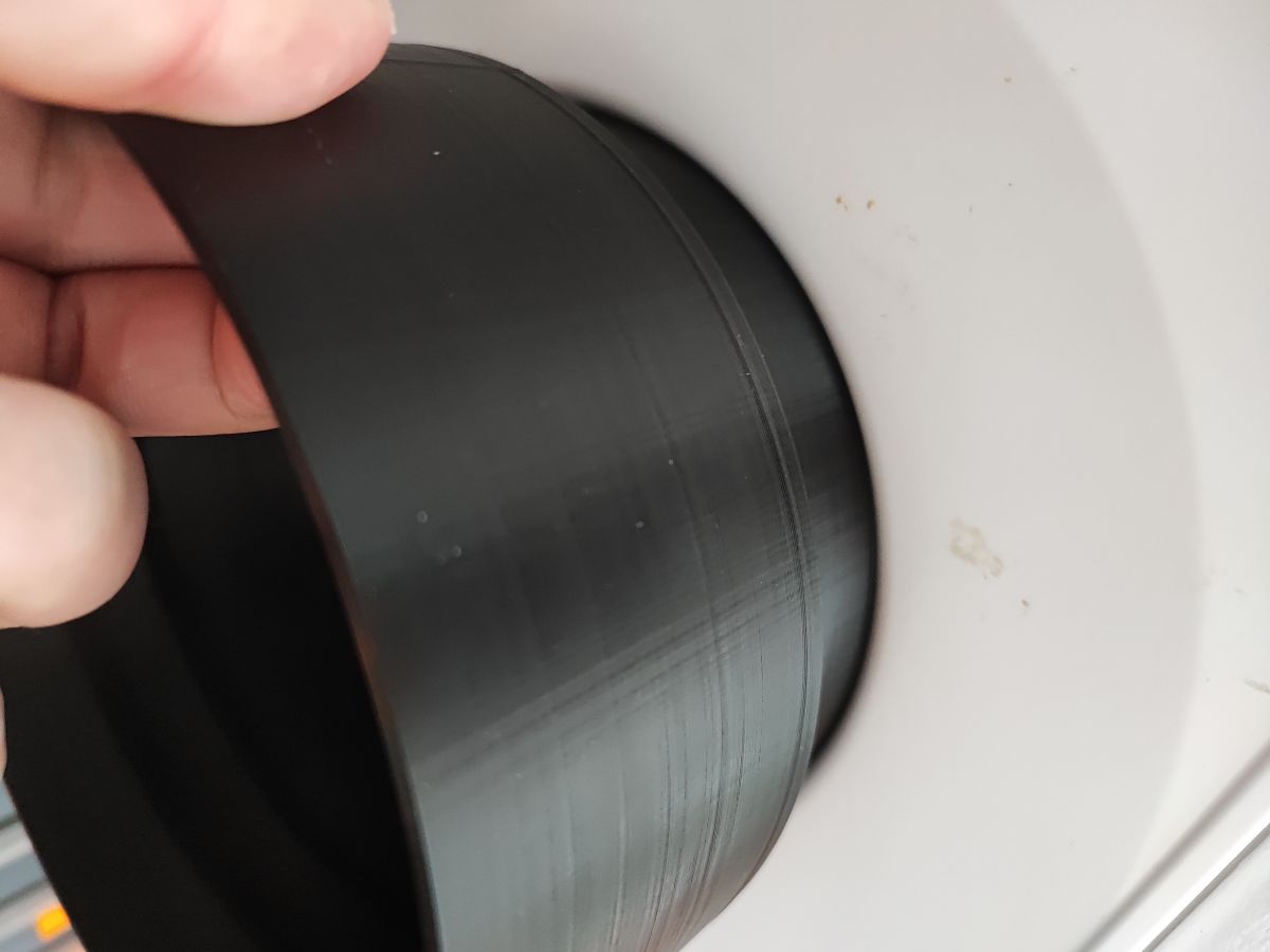

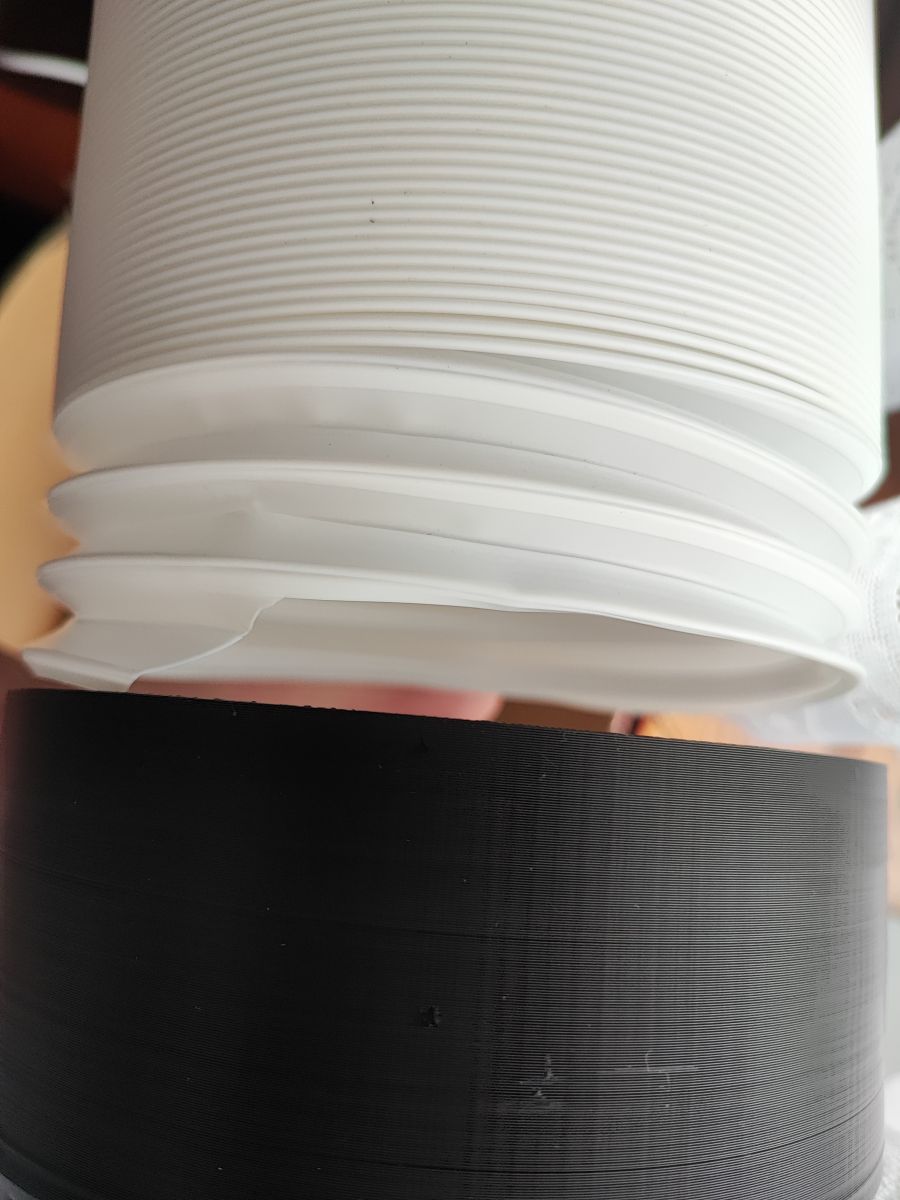

    Does it fit?
    Of course it does, after all I did a test print of both sides beforehand:

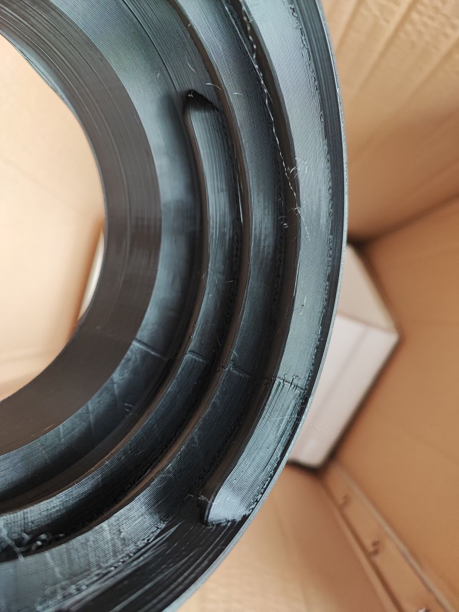

    The thread is also:
    Final fitting:
    Everything fits and works perfectly.
