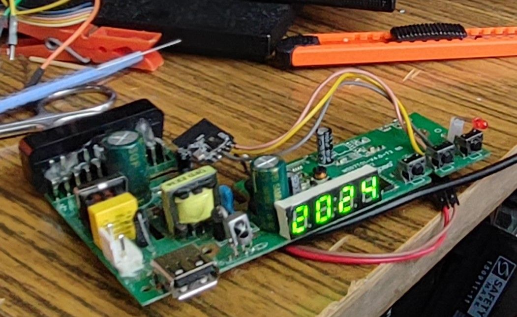

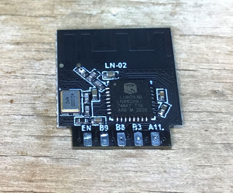

OpenBeken has been recently ported to LN882H platform, and I have received few such WiFi modules from our readers, so it was a good time to think about some kind of "dev board" for this new Lighting Semi platform. The modules I received were unfortunatelly not in TYWE3S/ESP12 format, so I was not able to just place them on NodeMCU, that's why I decided to take a slightly different path. And that path was.... an old sat tuner "hack"!

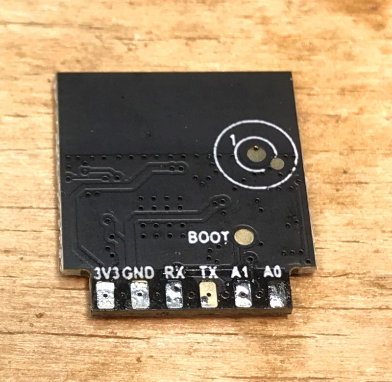

A typical LN882H module looks somewhat like this:
WiFi module with Lightning LN882H chip on a wooden surface. LN882H module with visible pads and pin labels.
It requires only 3.3V to work, but for ease of development purposes, some extra peripherals like buttons can be also useful.
That's why I decided to use old sat tuner, the one that I have already described in the past, see related topics:

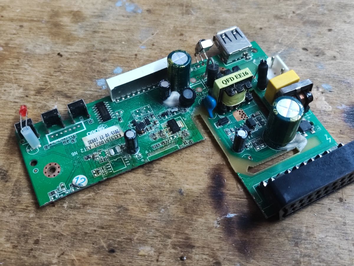

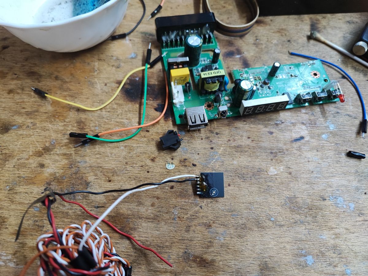

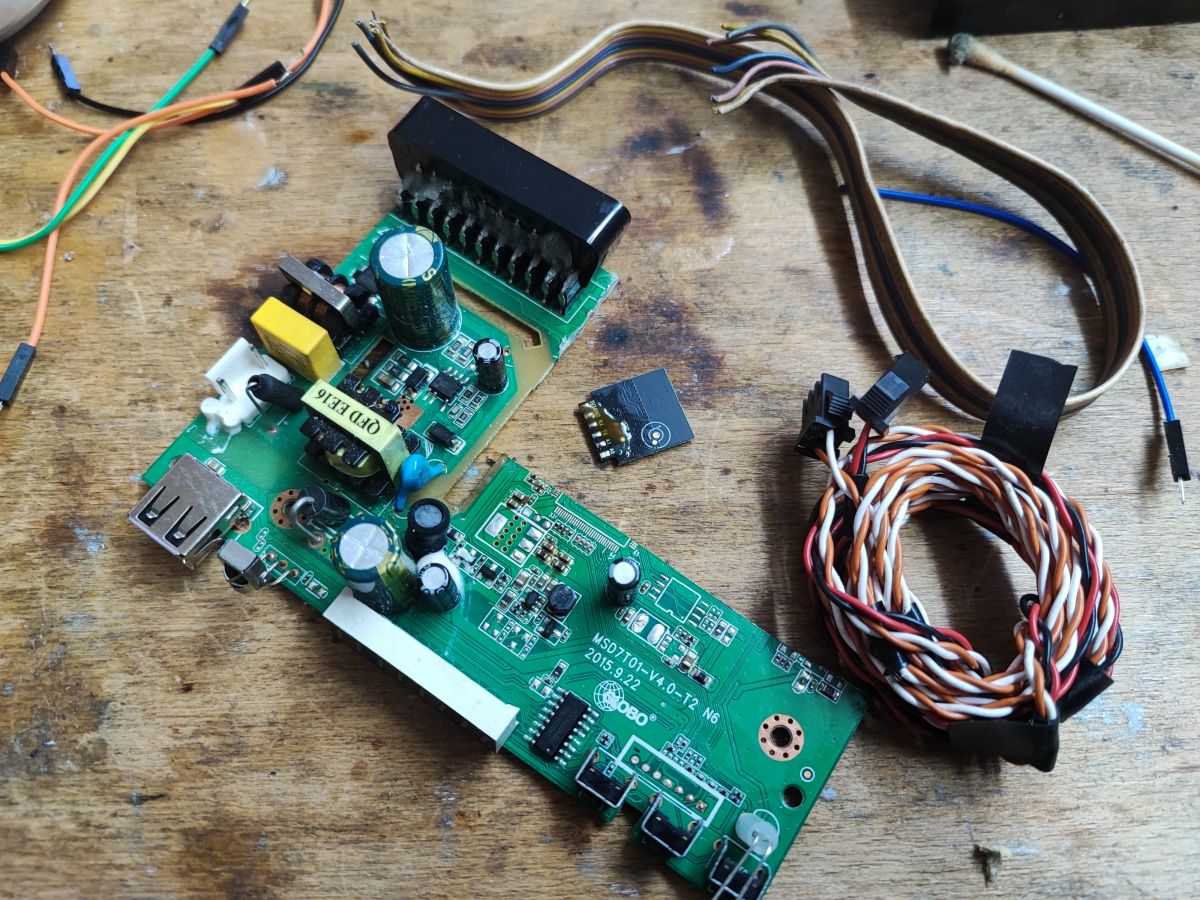

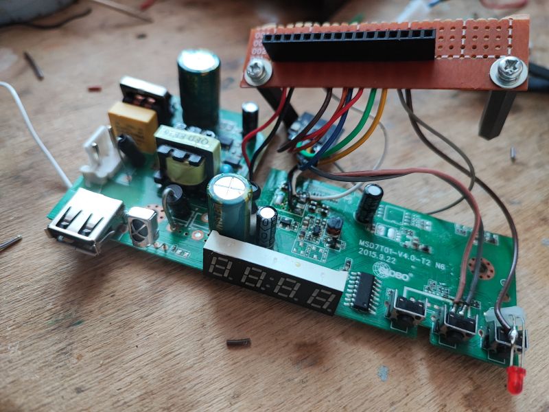

My first step was to remove the not needed parts - I have removed RF and HDMI circuits. SCART will be also removed soon:
Two pieces of a modified circuit board on a wooden table.
I have also removed the old MCU.

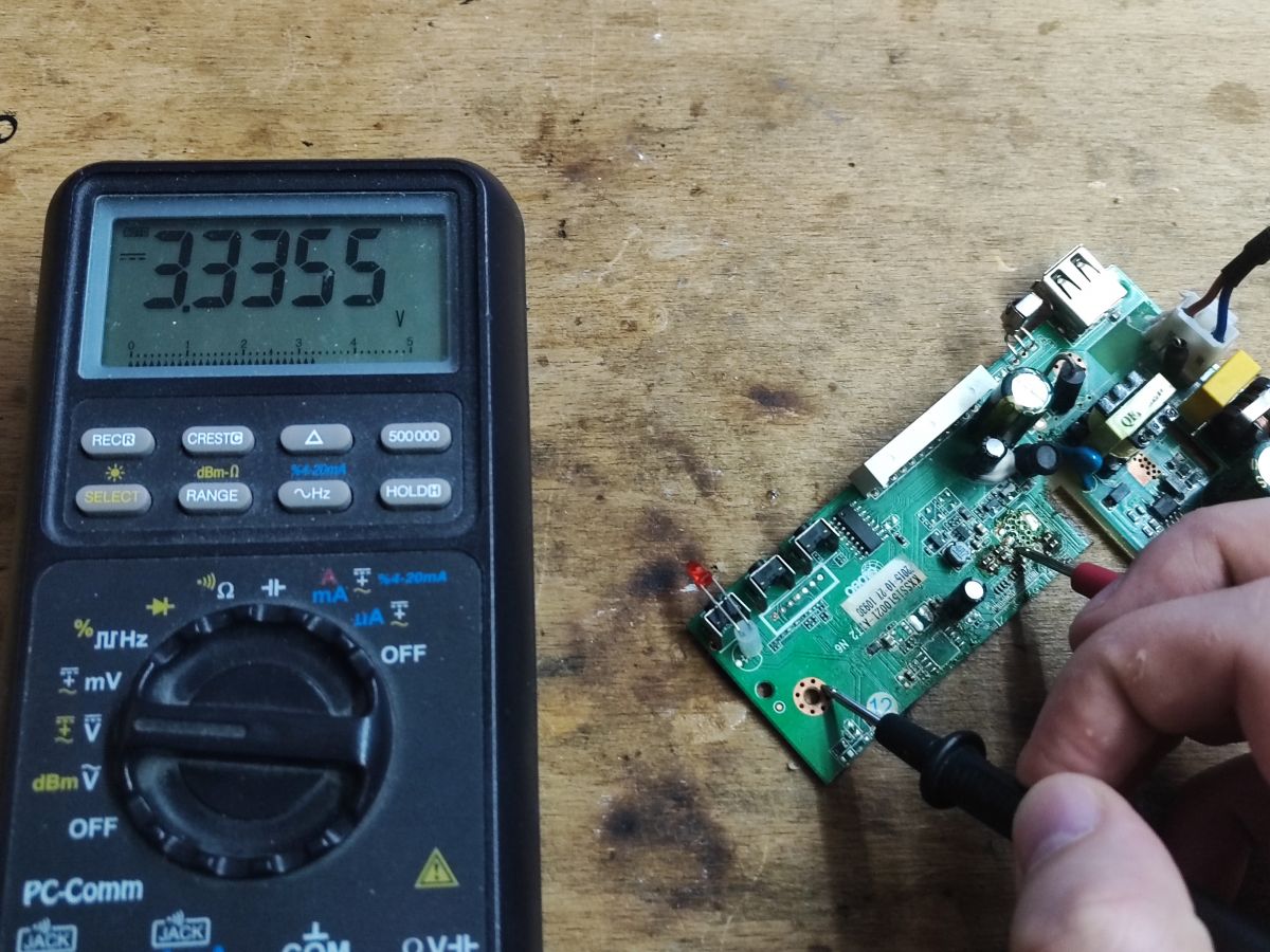

Then I checked if the board is still working. Of course, 3.3V is still present. This is good, because 3.3V willbe needed for WiFi module.
Voltmeter and circuit board during voltage measurement

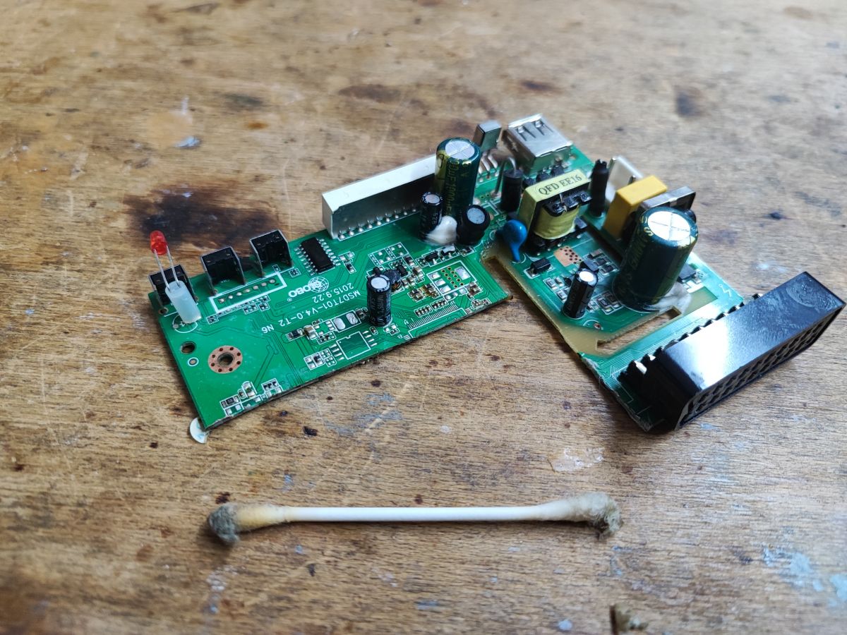

Cutting board is messy and may introduce some shorts, so extra caution is needed. I have also cleaned the board after desoldering.
Dismantled and modified satellite tuner board on a wooden table, with several removed components and the SCART removed.

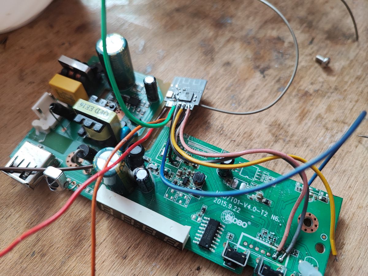

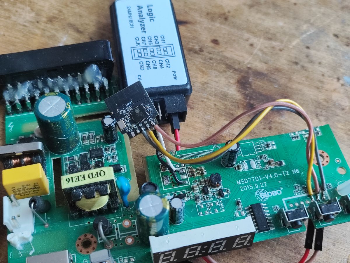

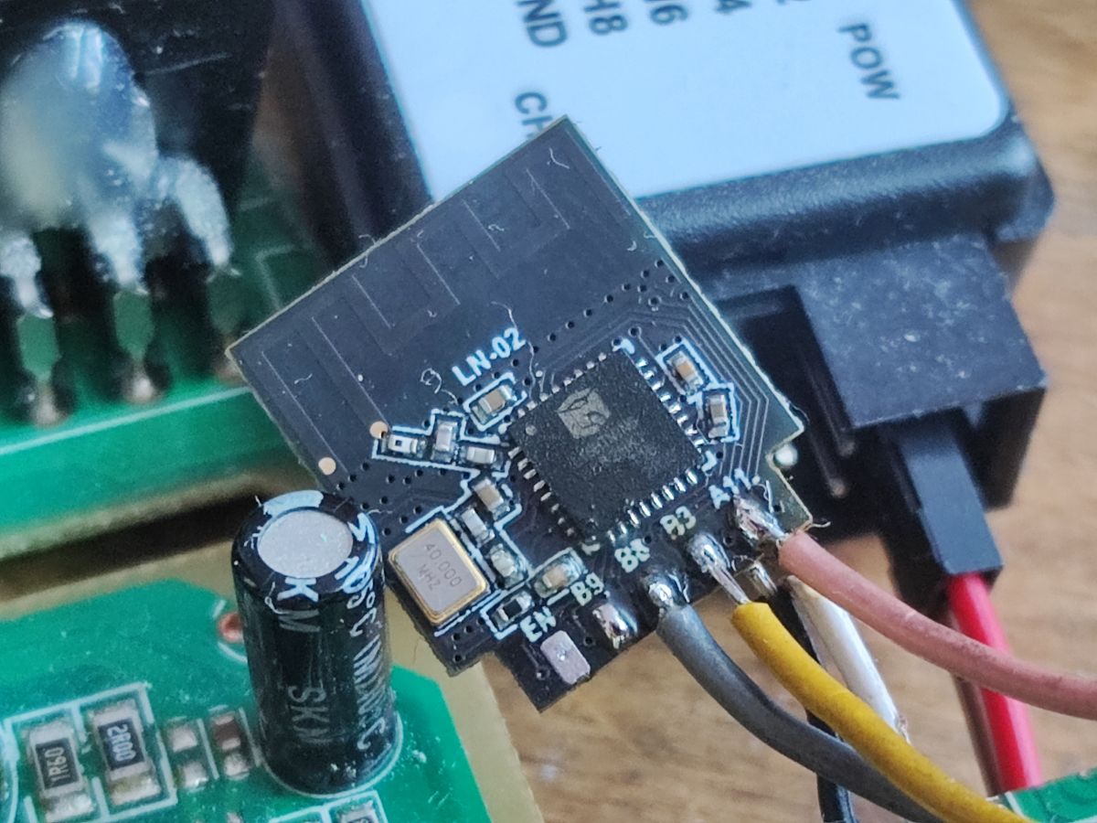

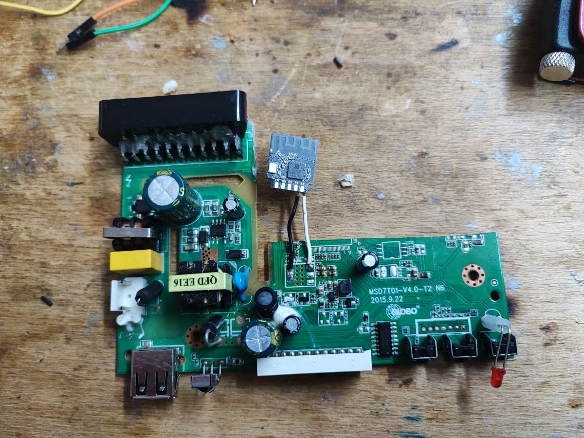

Finally, it was the time for some soldering. This step requires some patience. You also must be extra careful to avoid misconnecting the wires.
Modified satellite tuner board with electronic components and cables.

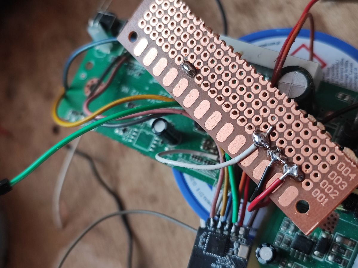

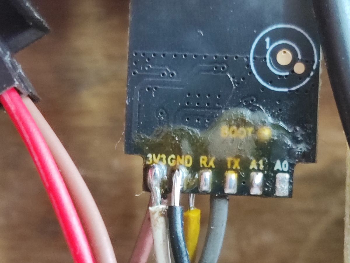

In my case, I decided to connect GND and 3.3V to the pads of old 1.8V LDO regulator, which I removed earlier. The 3.3V on this board comes from a step down converter, and step down is fed by 5V from main-powered flyback power supply.
So, soldering time:
Circuit board with soldered LN882H module and wires on a wooden table. Electronic board with soldered wires on a wooden table.
Using wire colors can help to remember their roles, white is 3.3V, black is ground.
Then I soldered wires to HD2015 7-segment LED display controller, which is already supported by OpenBeken:
Photo of a modified board with LN882H WiFi module and LED display Close-up of an LN882H WiFi module connected to a circuit board with wires. Close-up of a circuit board with soldered wires.

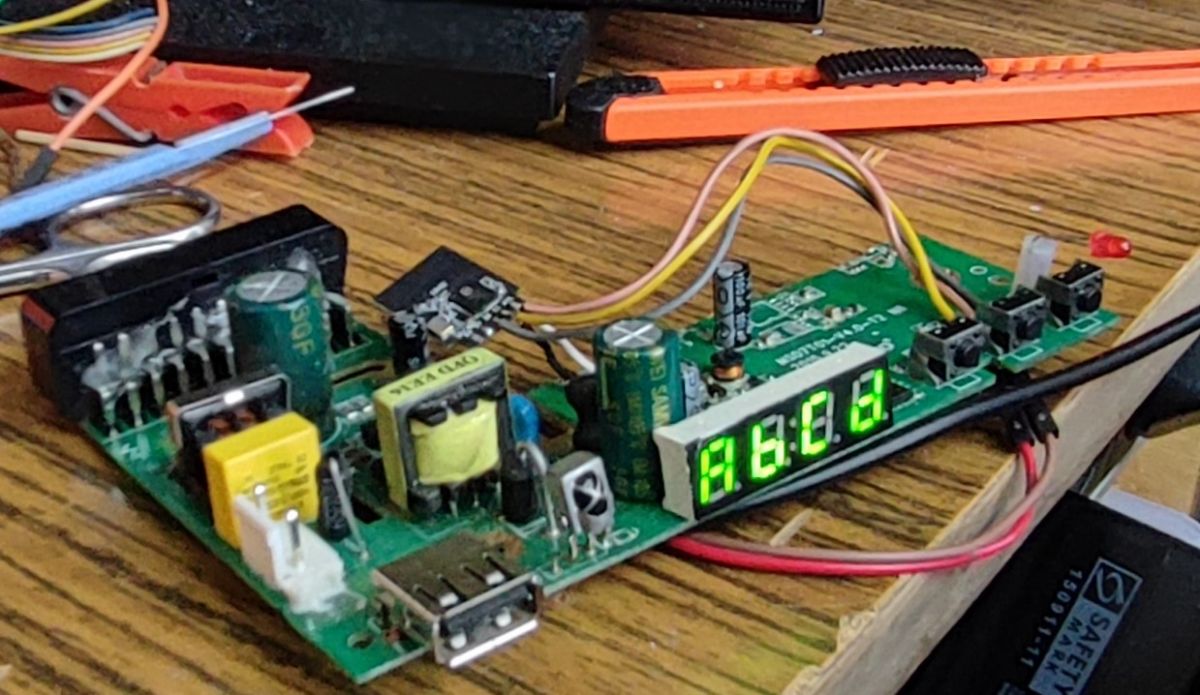

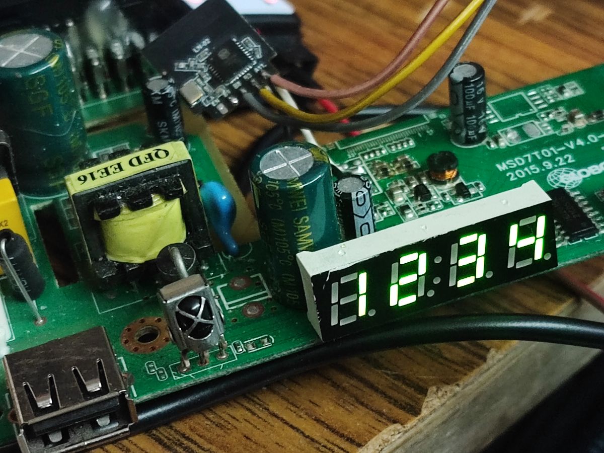

A quick test (after enabling necessary driver in OBK online build) has shown that it indeed works quite well:
Modified satellite tuner board with a connected LED display. Board with LED display and electronic components

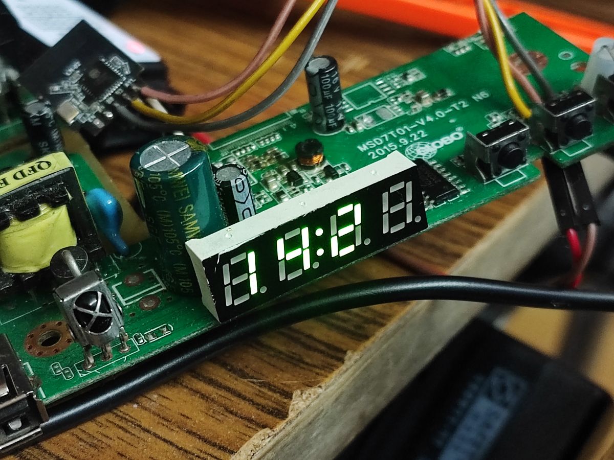

OBK provides an united "TMGN" driver for such displays, that can draw numbers and some letters:
Modified old satellite tuner with an LED display. Modified satellite tuner with LED display.
Display works, so it's time for the next part.
I have decided to also connect the IR receiver and extra LED, which is not controlled by HD2015:
Circuit board with wires connected at various points.
Finally, I have routed the remaining pins out, to the female goldpin header:
Circuit board with attached wires, LED display, and USB port. Printed circuit board with soldered wires

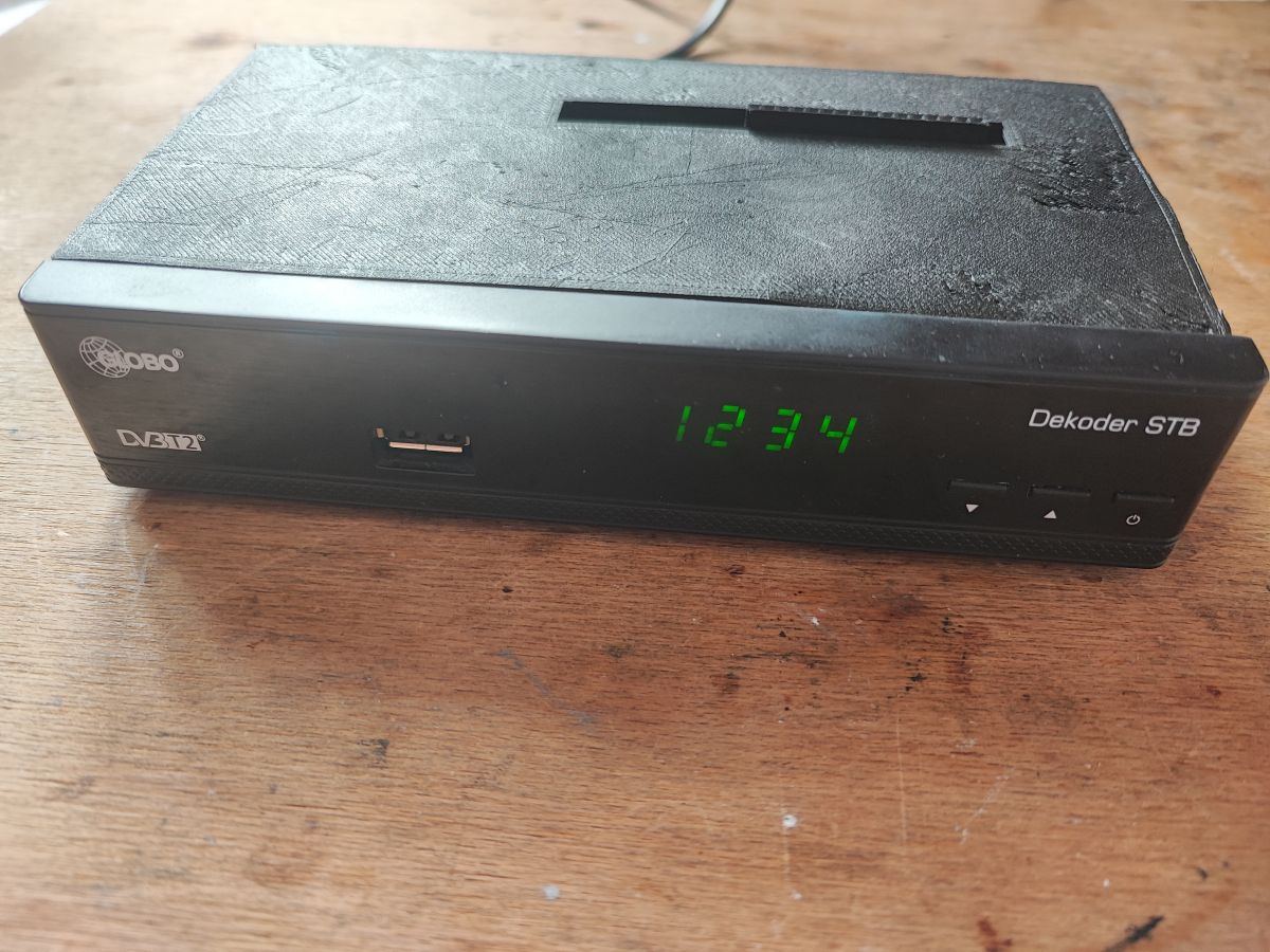

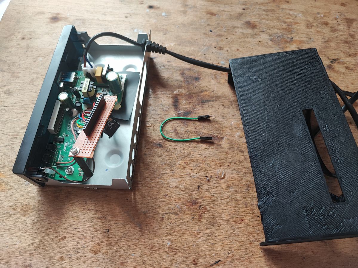

The last thing was to put everything together in the case. I couldn't use metal cover, it could have reduced the WiFi range. Futhermore it would be hard to cut that. That's why I have printed a replacement:
Open case of a modified satellite tuner with visible circuit board and wiring on a workbench.
Satellite tuner with a green display showing the numbers 1234.
