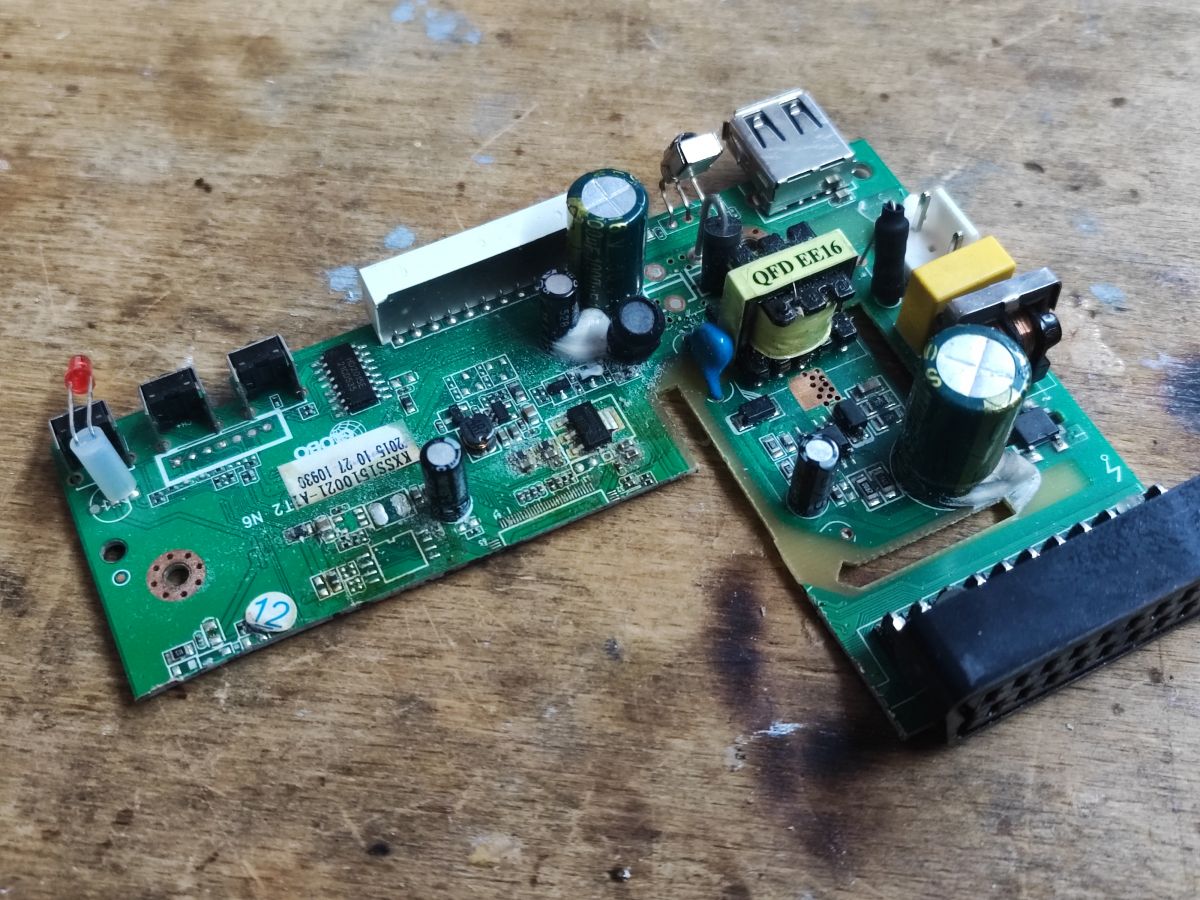

    There was chaos at first

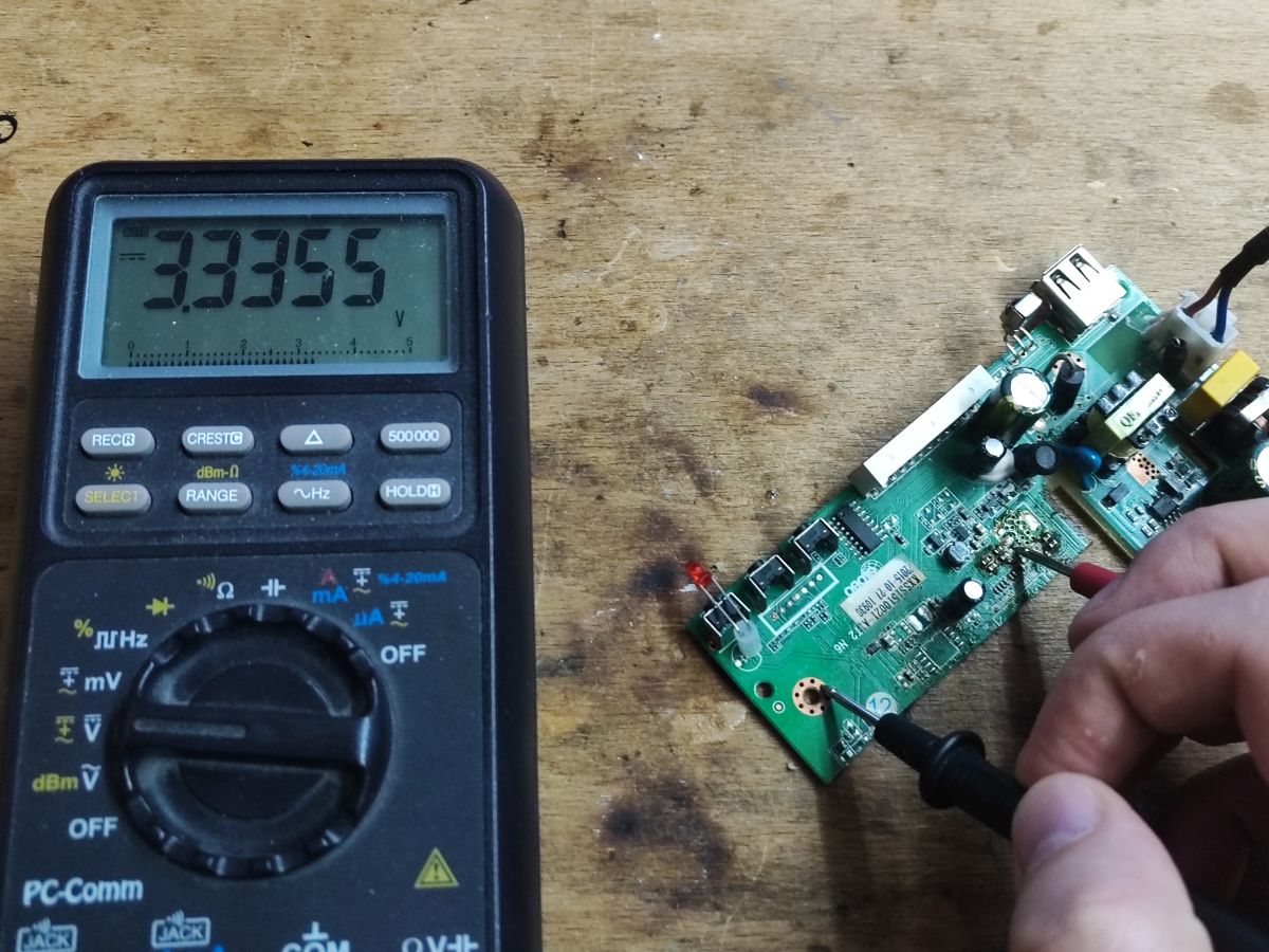

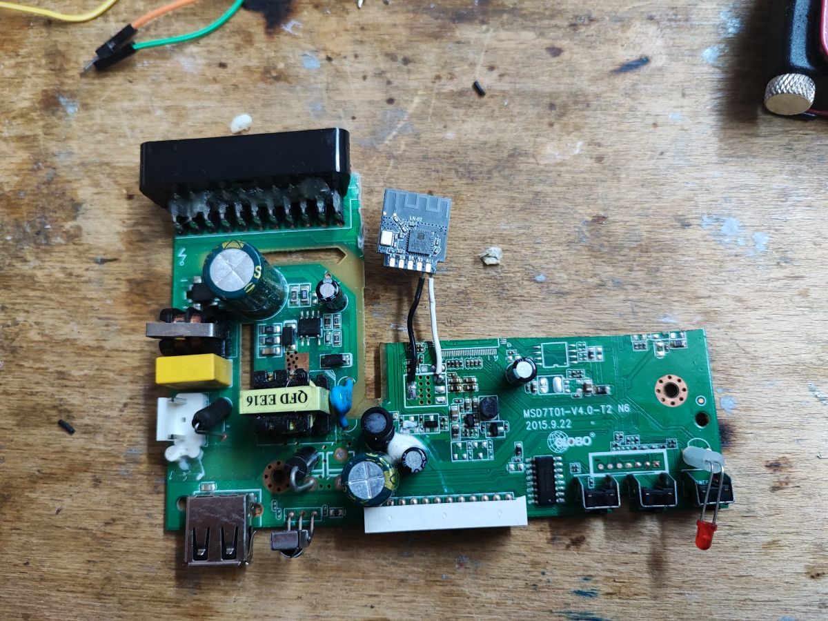

    There's not much to comment on here, but my fun is to remove what is unnecessary from such electrical junk and revive it with new microcontrollers, preferably WiFi. This is better than desoldering ICs which are then often not used at all anyway.... so first I removed what was unnecessary from the patient:
    Two PCB boards with various electronic components on a wooden surface.
    I left the 5V power supply and the inverter providing 3.3V on board. I will remove the SCART connector later. The 1.8V LDO I removed, because it is redundant for me:
    Multimeter measuring voltage on a PCB

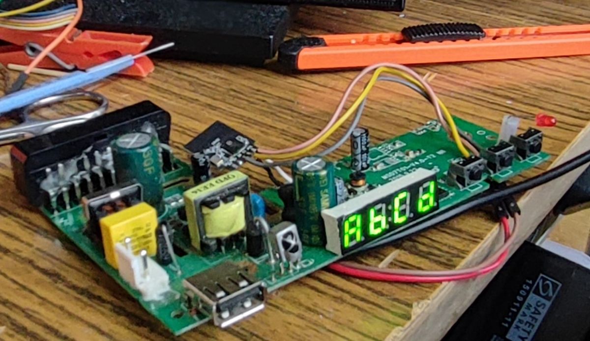

    As a new heart I soldered the LN882H WiFi module:
    LN882H datasheet, leads, WiFi modules (LN882HK, LN882HKx, LN882), firmware
    How to sflash the LN882H with software OpenBeken to free from the cloud
    PCB with soldered WiFi module LN882H
    First communication
    In the previous section I collected the packages responsible for displaying the time 14 on the display, so here I simply tried to send them. I program the LN882H WiFi module via OTA in OpenBeken. and I compile online on Github , because it's more convenient that way.

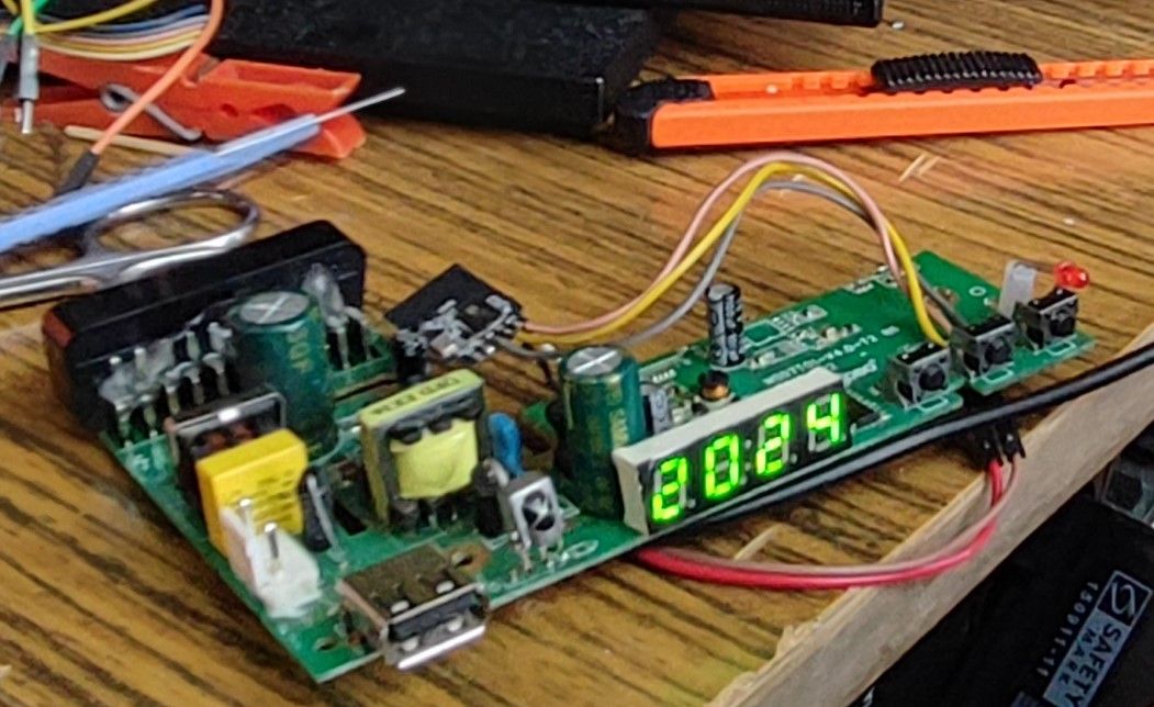

    In OBK I have a simple software I2C based on the bit-bang method:
    Code: C / C++
    It's worth mentioning here that, again, it's not really I2C because, as I found out during the protocol analysis, this chip doesn't support addressing multiple devices on a single bus, it just immediately gets the address of the command (or register?) with only the R or W bit set accordingly, but that doesn't actually change anything for me. By calling Soft_I2C_Start I am therefore specifying not the address of the device itself, but of the target register, and without the bit offset.
    The bytes sent are from the subject line:
    Salae 24MHz logic state analyser for PLN40 - analysis of unknown LED display protocol Here's the result:
    Close-up of a green PCB with an LED display showing 8:8.8 and connected wires.
    That is, I captured the communication well. Everything works.
    I'll just add one important tip here - when sending, it's a good idea to verify with a logic analyser that you are sending what you think you are sending.

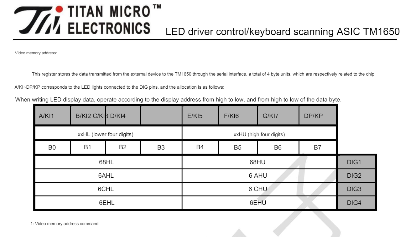

    I was about to give up with the search, but something touched me to check still TM1650:
    Video memory address table and display data for TM1650 driver.
    Wait, after all, the address of the digit register agrees - 0x68! The subsequent registers also agree...
    And the control register?

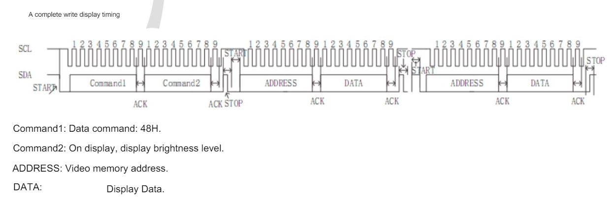

    Timing diagram for display data transmission
    0x48, also agrees. I think that's it! That's even better for me...

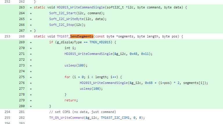

    You only need to change the function that sends the segments:
    Code: C / C++

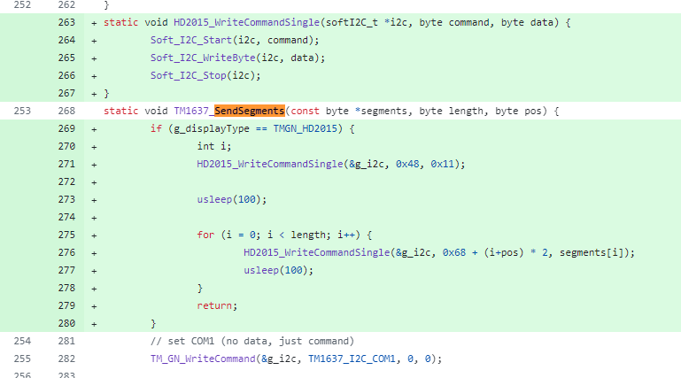

    The above function is the version that supports TM1637, TM1638 and GN6932, for these LED drivers the registers match. The HD2015 has slightly different registers, so for a test I simply added a condition to it:
    Fragment of C code for handling data transmission to an LED display.

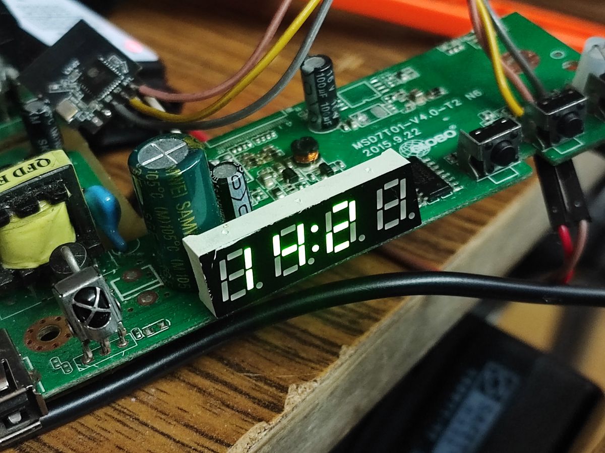

    This type of plugging in with a new display into a pre-existing driver has a lot of advantages. Thanks to this, all auxiliary functions I have (setting characters to a position, cleaning, flashing text, countdown) can handle several displays at the same time even "not knowing" what they handle.
    I tested the controller and all characters work:
    Electronic board with an LED display showing AC:CA on a table.
    Buttons I also pre-tested and the read values change when I press them.

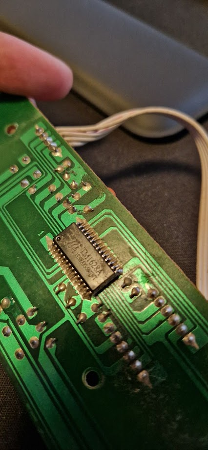

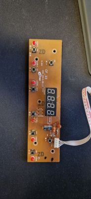

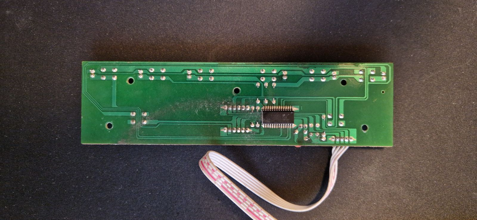

    What's next? A fellow from Serbia @DeDaMrAz has a module with TM1628:
    Close-up of TM1628 integrated circuit on a printed circuit board. Back side of a circuit board with an integrated circuit. Electronic panel with an LED display and buttons I will soon check if his protocol is also similar to those controllers I have already dealt with.
